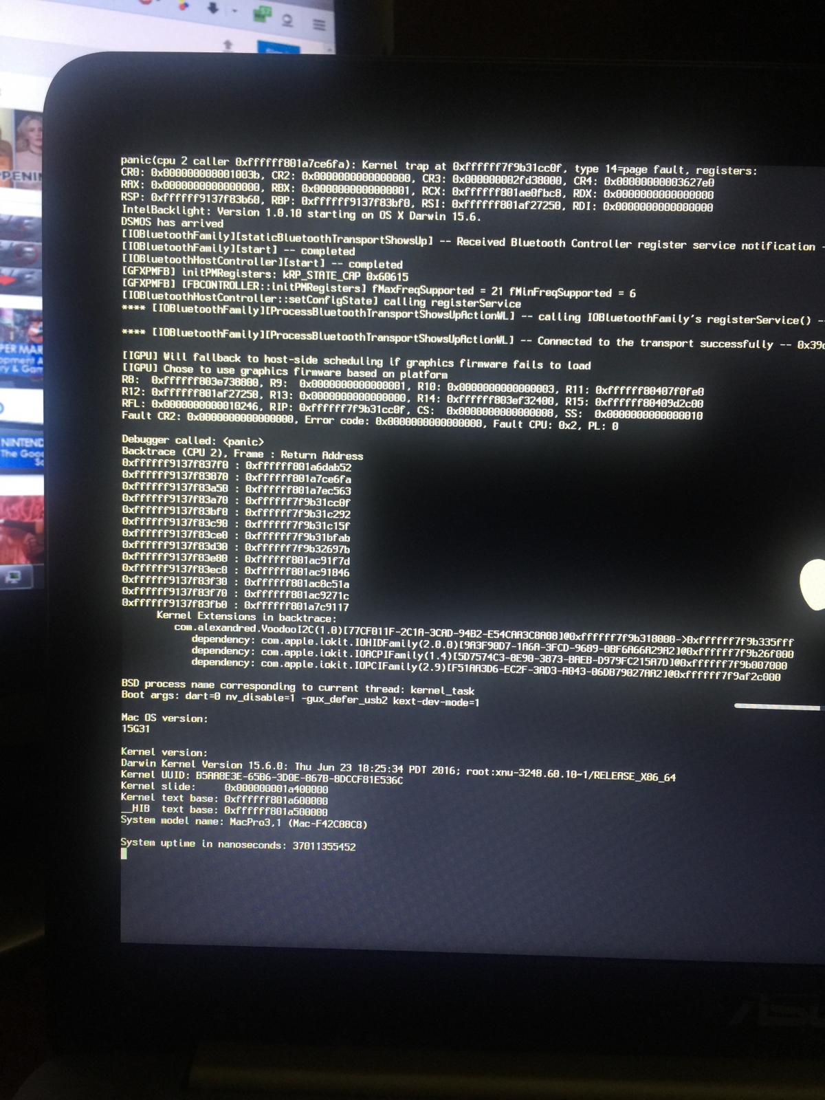

I am fairly new to the scene and recently successfuly installed El Capitan 10.11 on the Asus K501UX
The specs are: Core i7-6500u, 8GB RAM, GTX 950M (DISABLED), HD520
Everything seems to be in good working order thanks to Ludwig Bartholomew for guiding me and helping me through the process.
But, I keep recieving a Kernel Panic everytime I have the VoodooI2C kext installed for the trackpad to function. If I remove it everything works fine except for the trackpad which is the issue.
Note: I also removed all of the LPSS kext files from the S/L/E to no avail.
Any help would be greatly appreciated.

Hey, some reason your computer is using the Mac Pro smbios.  That is evidently going to cause a bunch of random issues with mobile skylake hardware.  I have mine set to MacBook Pro (Retina, 13-inch, Late 2013) and it works fine.
