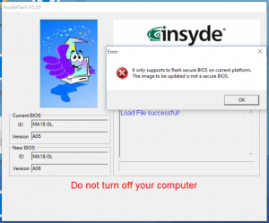

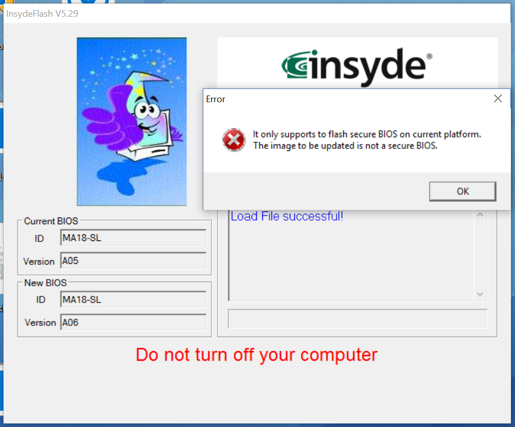

I've a friend in china with a mi book pro 13 and he asked about the bios to official xiaomi support and they said is only preinstalled on new machines, not for download and they don't even update it in official stores...
Have you tried using the insydeflash tool and that bios dump from AlbertAlpha?
Do you get the size mismatch error too? maybe a bad dump, or we need a new version of the flashing tool...
let me know.... thanks
P.s.
The tool recognized correcty both bioses and show same machine type, says A5 on chip A6 on file, but fails as said before...
To try it, just change the bios file extension to .fd and place it on tool's folder.

Have you done some kind of modification? I get this error when trying to flash...
Probably you did not, and extracted bios did not get the signature...
If is like this we should find some tool to sign it, or probably flash it from DOS with a different tool...

@Claudes Of course i haven't mod the bios file. I've only used the command "InsydeFlash.exe xxx.fd /g" from Windows. If you know how to dump it with signature or a way to sign it..
Here is dump of my BIOS. But I also have the same error in InsydeFlash program. May be it is need to disable password in BIOS?
Other tools under Windows and Linux did not help me to dump BIOS. All of them reported me that this chipset is not supported.
A06.zip
mmhhh ok thanks for trying, but as said before, that sleep assertion shows even on real macs, and it's not whats causing our sleep issue.
About the bios, yes, the tool extract it correctly, but cant sign it so we can't do much, I'v not tried to flash it from dos, maybe it could work, but the best thing we could do is find some sort of tool to apply the signature...
