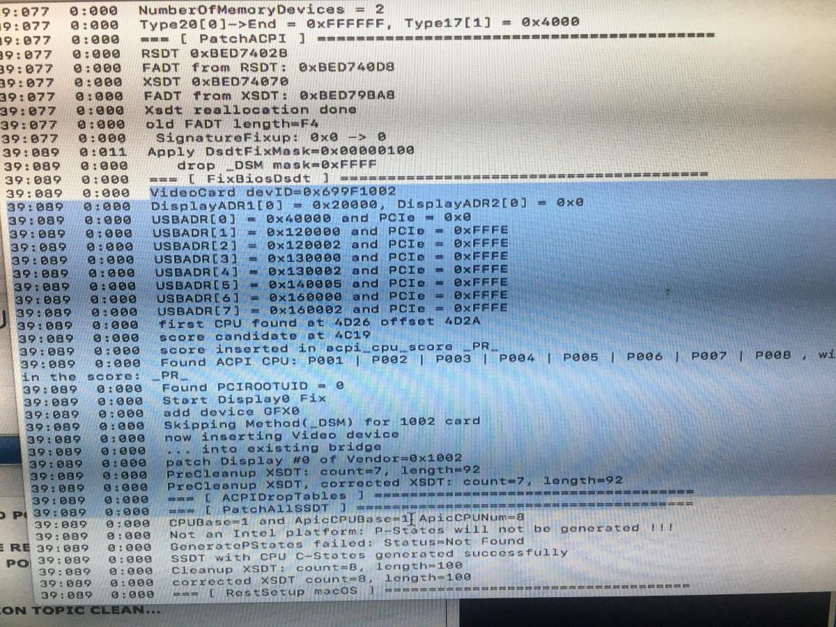

fagneroliveira Posted January 14, 2018 Share Posted January 14, 2018 Polaris 12 = Lexa gpu Clover work with him? My hackintosh ever Give me this output Dev os 0x699f1002 Link to comment https://www.insanelymac.com/forum/topic/317915-clover-test-and-patches-for-polaris-gpu/page/11/#findComment-2569109 Share on other sites More sharing options...
Slice Posted January 15, 2018 Share Posted January 15, 2018 Polaris 12 = Lexa gpu Clover work with him? My hackintosh ever Give me this output Dev os 0x699f1002 Set RadeonDeInit=YES in config.plist. What is a market name of your card? 1 Link to comment https://www.insanelymac.com/forum/topic/317915-clover-test-and-patches-for-polaris-gpu/page/11/#findComment-2569529 Share on other sites More sharing options...

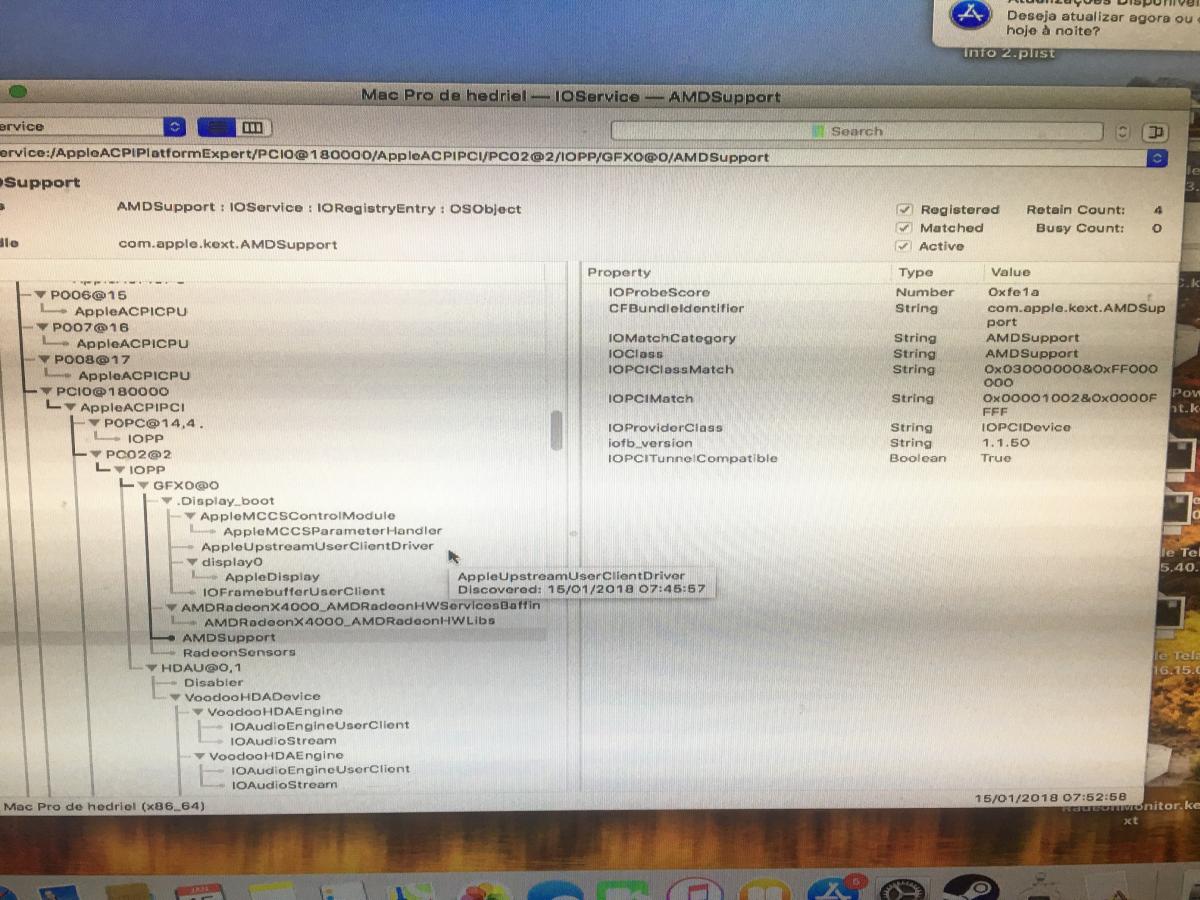

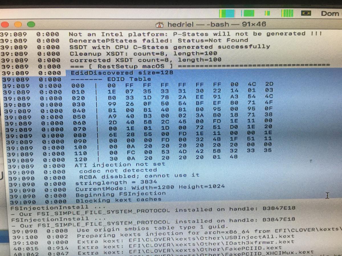

fagneroliveira Posted January 15, 2018 Share Posted January 15, 2018 My card is one Asus radeon rx550 A lot of fórum say that is one polaris 12 but when i search i discover one thing Is a lexa chipset. The id is 699f and i dont found notinhg in the kext with this id. Look the clover source of Clover 4330 for this gpu the id is 67EF. But my gpu dont load kext and stay with 5mb of ram Link to comment https://www.insanelymac.com/forum/topic/317915-clover-test-and-patches-for-polaris-gpu/page/11/#findComment-2569597 Share on other sites More sharing options...
Slice Posted January 15, 2018 Share Posted January 15, 2018 My card is one Asus radeon rx550 A lot of fórum say that is one polaris 12 but when i search i discover one thing Is a lexa chipset. The id is 699f and i dont found notinhg in the kext with this id. Look the clover source of Clover 4330 for this gpu the id is 67EF. But my gpu dont load kext and stay with 5mb of ram You may set FakeID=0x67EF1002 and FixDispaly=YES Link to comment https://www.insanelymac.com/forum/topic/317915-clover-test-and-patches-for-polaris-gpu/page/11/#findComment-2569634 Share on other sites More sharing options...
fagneroliveira Posted January 15, 2018 Share Posted January 15, 2018 I tried this and it did not work I also tried all fakeids from AMD and none made the board to be loaded. no kext is loaded I try fakeid and load vbios and nothing Link to comment https://www.insanelymac.com/forum/topic/317915-clover-test-and-patches-for-polaris-gpu/page/11/#findComment-2569696 Share on other sites More sharing options...
vandroiy2012 Posted January 15, 2018 Share Posted January 15, 2018 RX 550 don't work in macOS at all... 1 Link to comment https://www.insanelymac.com/forum/topic/317915-clover-test-and-patches-for-polaris-gpu/page/11/#findComment-2569864 Share on other sites More sharing options...
Slice Posted January 15, 2018 Share Posted January 15, 2018 I tried this and it did not work I also tried all fakeids from AMD and none made the board to be loaded. no kext is loaded I try fakeid and load vbios and nothing FakeID will work only with DSDT FixDisplay. Link to comment https://www.insanelymac.com/forum/topic/317915-clover-test-and-patches-for-polaris-gpu/page/11/#findComment-2569867 Share on other sites More sharing options...
Gigamaxx Posted January 15, 2018 Share Posted January 15, 2018 RX 550 don't work in macOS at all... True, I tested it over and over but nothing worked, fake ID, edit of every possible info.plist for controller and accelerator kexts + HW kexts, added vbios to Clover ROM folder and Load vBios. Nothing got more than Display status 7mb. It has half the CUs of the RX 560, lower ram frequency and lower GPU frequency. It just would not take no matter what I tried in High Sierra and HS betas as well. Maybe if someone rewrote the controller and accelerator + HW kexts for the card it would work but that would be a very large project for a little card. 3 Link to comment https://www.insanelymac.com/forum/topic/317915-clover-test-and-patches-for-polaris-gpu/page/11/#findComment-2569960 Share on other sites More sharing options...
Gigamaxx Posted March 30, 2018 Share Posted March 30, 2018 (edited) Update: There is a new version of the RX 550 that has the device ID 0x67FF1002 but it is very specific as far as a brand and model number. I will try to find it and link it later. It has the RX 560 ID but has lower Compute Units count so it may work. This is it a Sapphire RX 500 based on Polaris 21 similar to RX 560. https://www.techpowerup.com/241121/sapphire-intros-radeon-rx-550-graphics-cards-with-640-stream-processors Edited March 31, 2018 by Gigamaxx 1 Link to comment https://www.insanelymac.com/forum/topic/317915-clover-test-and-patches-for-polaris-gpu/page/11/#findComment-2606465 Share on other sites More sharing options...
