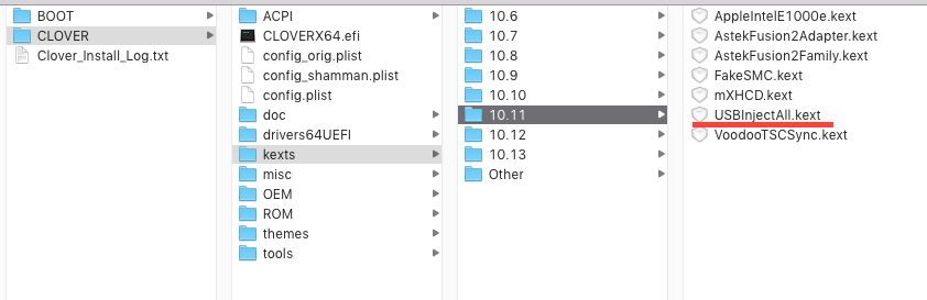

bilbo Posted February 17, 2018 Author Share Posted February 17, 2018 Done. It is an EFI folder which I use now. Seems I was inattentive again. My kext and kexts from X79 package have a slightly different size. Let me know if I can help with something else. I can´t understand your config files.. It's different in several aspects .. but what I don't understand is how your usb works ...without usbinjectall kext. I tried to copy your config without this kext and usb stops working ... how I expected. Btw, you have a 5,1 smbios ... ?¿?¿? Could you tell me what steps followed to fix usb? Link to comment https://www.insanelymac.com/forum/topic/314799-guide-z820-el-capitan-the-great-guide-sucess/page/7/#findComment-2594023 Share on other sites More sharing options...
shamman Posted February 17, 2018 Share Posted February 17, 2018 Don’t try to understand, it is a test versions, not final for work. Yes, I still have a 5.1 SMBIOS. I need to verify an one assumption (if it will be correct, I post it here). Could you tell me what steps followed to fix usb? Just remove GenericUSBXHCI.kext and add mXHCD.kext Kext only you can get in attachment to this post. but what I don't understand is how your usb works ...without usbinjectall kext Are you sure? Look at screenshot… mXHCD.kext.zip Link to comment https://www.insanelymac.com/forum/topic/314799-guide-z820-el-capitan-the-great-guide-sucess/page/7/#findComment-2594048 Share on other sites More sharing options...

Cass67 Posted February 21, 2018 Share Posted February 21, 2018 In general, I followed the guide, especially instructions about DSDT/SSDT. I hope it is obvious from the picture that I did it on Sierra, not El Capitan. I don't use raid, only a single Samsung SSD for target install and HDD instead of USB stick. BIOS version = 2.15.1229 Clover version = 2.4k rev 4077 DSDT/SSDT/config.plist in the attached file The system is very stable, everything works great (all software I use, for example: LightWave 3D, Cinema 4D, RealFlow, FinalCut Pro, LogicPro X ...). As far as I can see the only glitch is when the system resumes from sleep animations in GUI are a bit laggy - probably this goes to NVidia driver. It would be nice if someone tests my configurations (in the attached file) since I think there might be a room for improvements. What I miss the most, are working USB3 ports. As I can see, only two USB2 ports are working. Regarding ssdt.aml, first I created SSDT for my CPU E5-2670v1. Power management seemed to work and power consumption of the system was 140W (Wattmeter is always pluged-in), but Geekbench (Multicore Score around 22k) and my renders were too slow compared to Win7. HWMonitor was showing the lowest frequency of CPU was 2.2 GHz. I was playing with the ssdtPRGen.sh script further and eventually it worked out (not sure though) with E5-2670v2 setting. ssdtPRGen.sh script parameters that I succeeded: sh ssdtPRGen.sh -cpus 2 -target 0 -l 32 -c 3 After that, the lowest frequency was correct (1.2 GHz) and full performance was regained (renders as expected, i.e. 3-5% faster than Win7, Geekbench showed almost 39k). That's it. Tests and reports by other users are more than welcome. Big thanks to author's tutorial, I wouldn't manage without it. I made at least 400 reboots with previous OS X versions in the past but power management never worked that well. What kexts did you use ? both in refi folder and /S/L/E ? I see in your clover folder there is patches in config.plist for AICPUM, did you patch the kext or just use the clover patching? I have basically the same setup (3.91 bios though, Sierra 10.12.6) but with a pair of 2690 v1 cpus and I cannot for the life of me get this thing turn on PM.. I can get the cpu to scale back if I use nullcpupm but this is no use really. The rest of the z820 guide is spot on for patching DSDT and installing and setting up all that good stuff but the PM part I'm struggling with, no idea why I can't get this to work when I see reporting like this that it does on your Z620.. Feels like I tried everything and failing, I must be missing something stupid I patched AICPUM with the perl patch, tried it also vanilla with clover patches, no joy I try it was almost all ssdtPRGen flags it seems but pretty much the last run I used the same flags as you .. My ssdt looks same but for cpu diffs I guess.. I have tried in clover many an option from the one in Z820 guide, which would be my preference and many options up to what you have, you seem to have too many I think. Enabling the c and p states like you have in the config.plist seems to only give me 2 states 28 and 29, which is max... Any info appreciated.. (from all working z620 owners) (hopefully one with 2690 v1 cpu too) Cheers Link to comment https://www.insanelymac.com/forum/topic/314799-guide-z820-el-capitan-the-great-guide-sucess/page/7/#findComment-2596103 Share on other sites More sharing options...
