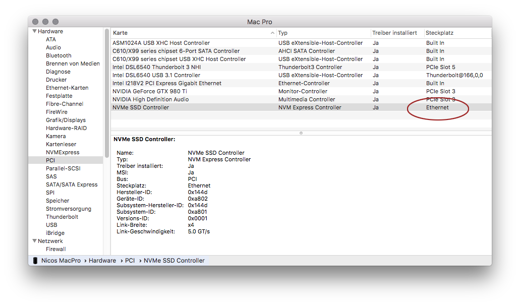

Yes exactly. Why is this so fixed - and how can I change that?

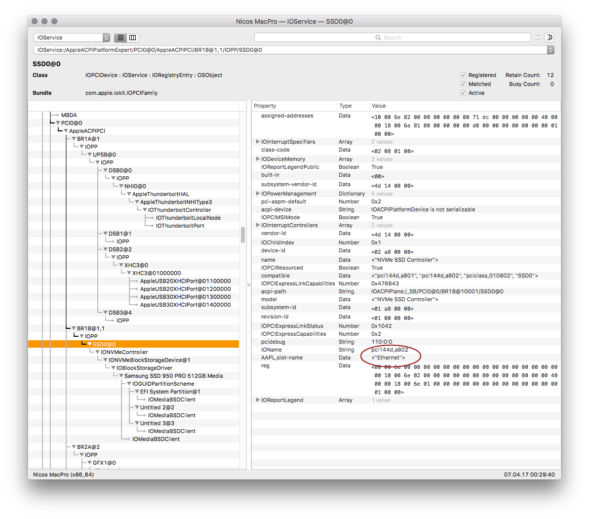

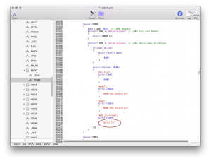

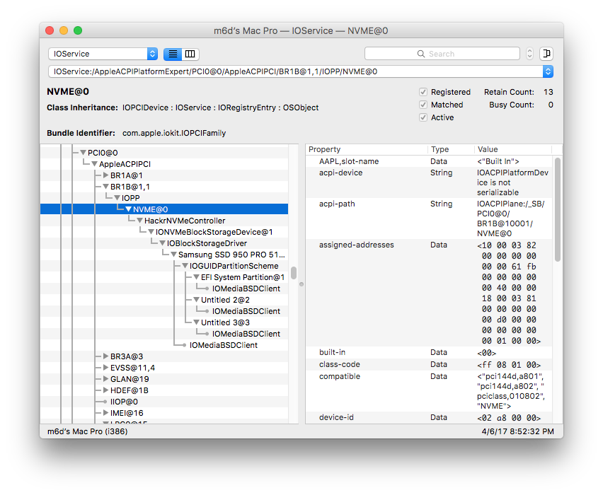

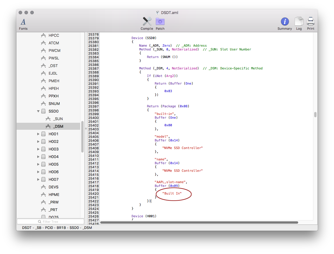

1. Find NVME ACPI Path (SB.PCI0.XXXX.XXXX) ==> for example, (BR1B.H000)
2. Find device tree (SB.PCI0.XXXX) ==> for example, (BR1B)
3. Find any D0xx devices located at bottom of the device tree (BR1B) --- open your DSDT.aml (while at Clover Boot Manager screen, press F4, wait 5 seconds, then boot into OS-- mount primary drive, find the DSDT.aml in: EFI->CLOVER->ACPI->origin, open with MaciASL, and search for device tree (BR1B), stop when you've hit the "Device (XXXX)", click it to update the left side, then on the left, scroll down and look at the bottom of the device tree ==> for example, D075 and D081
4. Set (a scope to) NVME ACPI path and the D0xx paths to a status of 0 (which removes them)
5. Set a scope to the device tree (SB.PCI0.XXXX) (BR1B)
6. Create a new device (NVME) to replace the NVME APCI path (instead of BR1B.H000 it becomes BR1B.NVME)
7. Add a _DSM method with return properties (now you can inject AAPL,slot-name)
*Note - I'm using a spoofed class code, you can probably ignore that if you're not using Rehabman's HackrNVMeFamily.kext
My ssdtGen script now will do this for you!
DefinitionBlock ("", "SSDT", 2, "hack", "NVMe-Pcc", 0x00000000)
    External (_SB_.PCI0.BR1B, DeviceObj)    // (from opcode)
    External (_SB_.PCI0.BR1B.H000, DeviceObj)    // (from opcode)
    External (_SB_.PCI0.BR1B.D075, DeviceObj)    // (from opcode)
    External (_SB_.PCI0.BR1B.D081, DeviceObj)    // (from opcode)
    Scope (\_SB.PCI0.BR1B.H000)
        Name (_STA, Zero)  // _STA: Status
    Scope (\_SB.PCI0.BR1B.D075)
    Scope (\_SB.PCI0.BR1B.D081)
    Scope (\_SB.PCI0.BR1B)
        Device (NVME)
            Name (_ADR, Zero)  // _ADR: Address
            Method (_DSM, 4, NotSerialized)  // _DSM: Device-Specific Method
                If (LNot (Arg2))
                    Return (Buffer (One)
                         0x03
                Return (Package (0x0A)
                    "AAPL,slot-name",
                    Buffer (0x09)
                        "Built In"
                    "model",
                    Buffer (0x10)
                        "NVMe Controller"
                    "name",
                    Buffer (0x10)
                        "NVMe Controller"
                    "class-code",
                    Buffer (0x04)
                         0xFF, 0x08, 0x01, 0x00
                    "built-in",
                    Buffer (One)
                         0x00

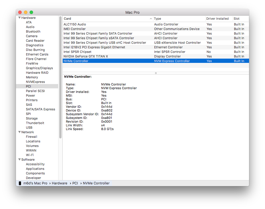

I see, no problem :)
I don't think anyone has managed to get Thunderbolt to show up correctly in System Prefs. I played around with injecting all the device properties from a Macbookpro13,2 and it didn't have any effect. The best I can get is to have Thunderbolt show up under PCI. I'm messing around with a Z270X motherboard which has the same TB chipset as the latest MacBook Pro's (the X99's use an older chipset from 2015) so we'll see if that is any different. Right now I'm just stoked that my USB 3.1 ports (Type-A and Type-C) both work at 10Gb speed and sleep/wake correctly via the ssdt I posted. I did tweak it a little bit more with correct device properties, so it's attached here.
SSDT-BR1B.aml.zip
ah i see. Maybe someone will find a workarround soon. I can see my devices in the PCI section,
and now it works to power on the soundcard when i got logged in to osx. Before i needed to turn on the card before i boot osx.

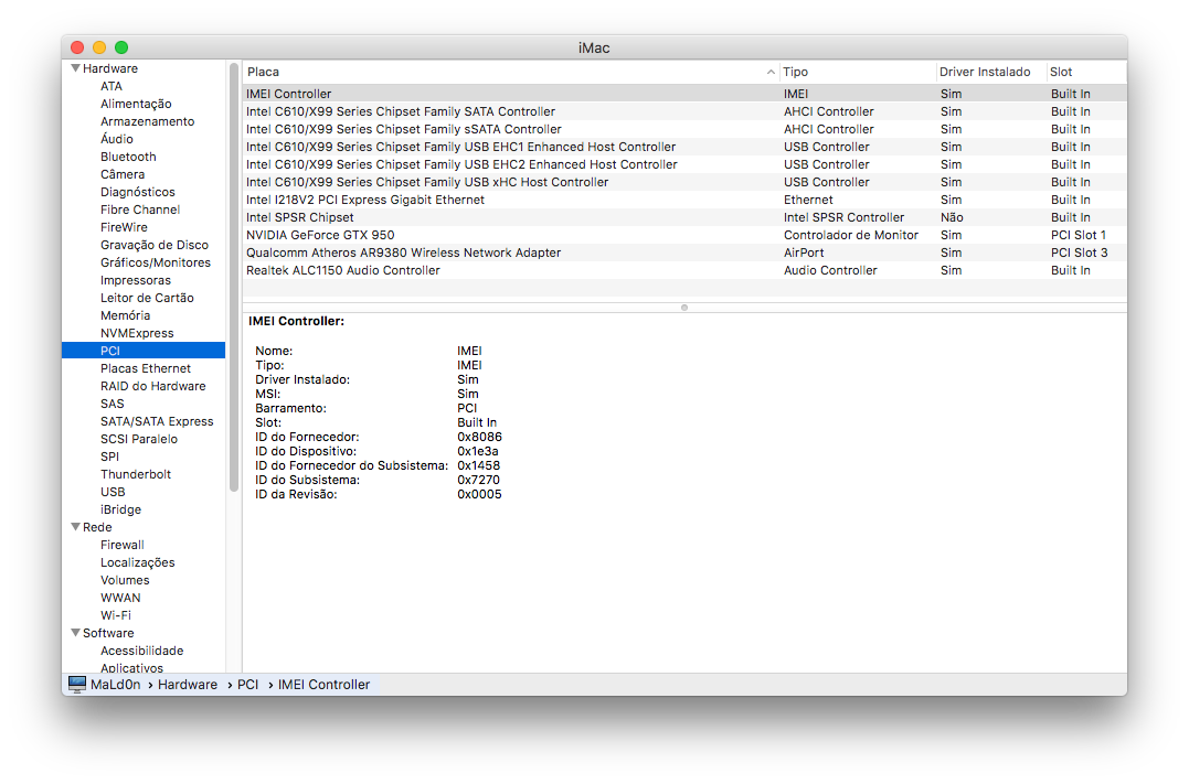

Hey guys, is there a reason that my IMEI controller under PCI says Drivers Installed: No?
Wrong "device-id" and/or wrong "compatible" injected. I've found IOReg shows an incorrect value.
Some motherboards use this:
"device-id" - 0x3A, 0x1E, 0x00, 0x00
"compatible" - "pci8086,1e3a"
Regardless of what IOReg displays:
"IOName" - "pci8086,8d3a"
