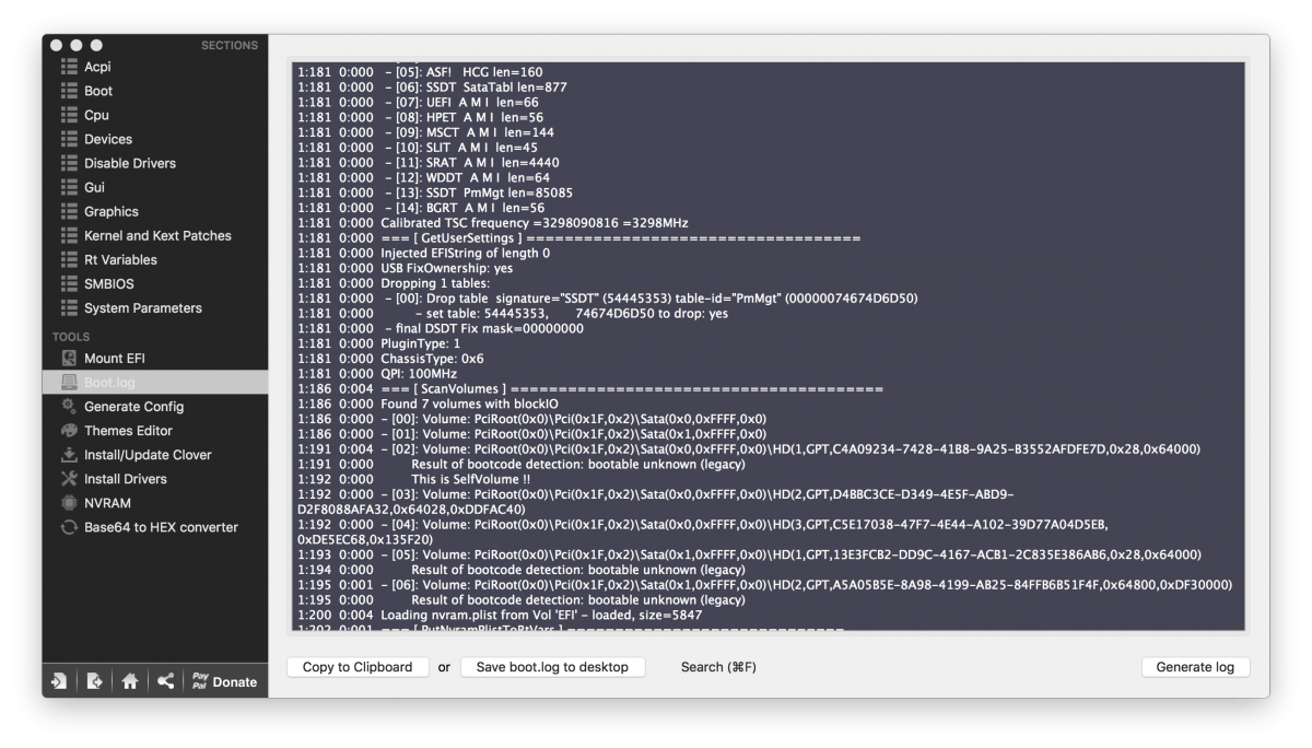

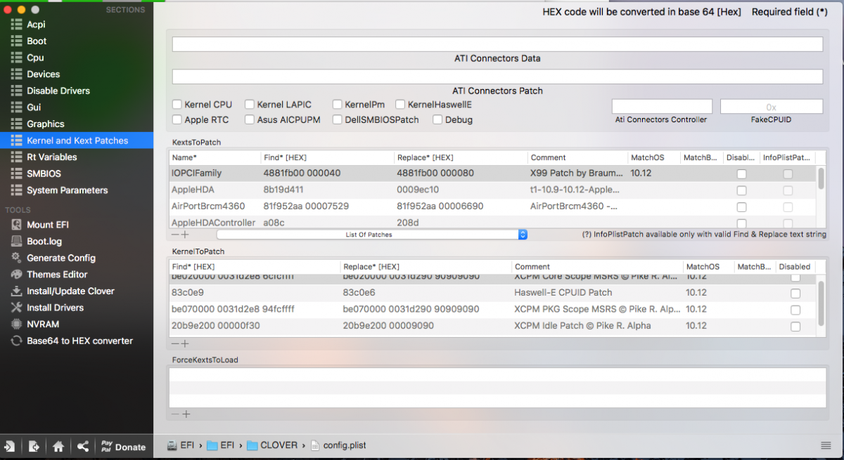

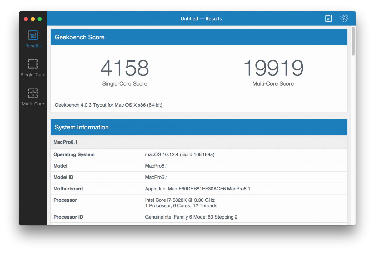

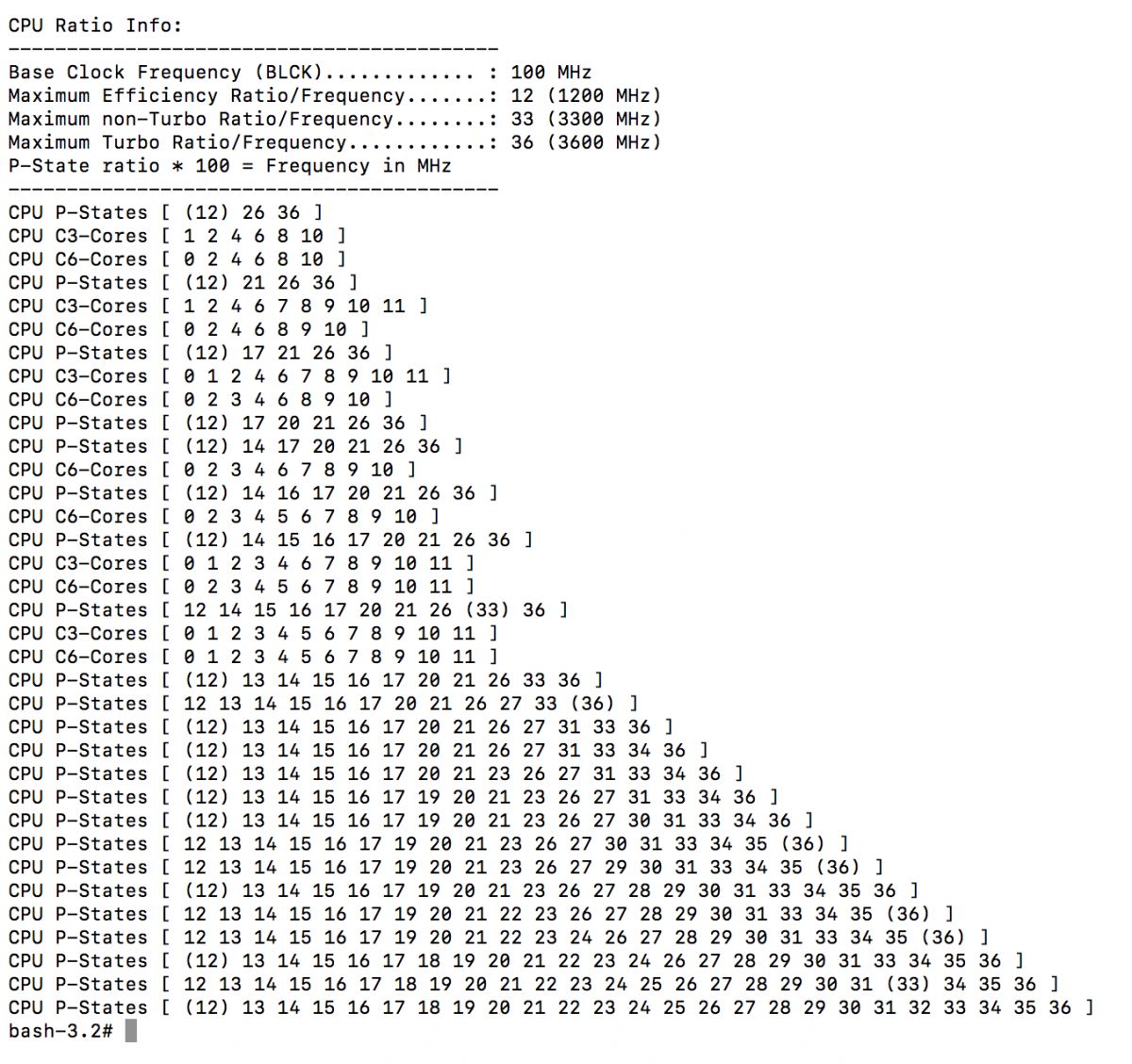

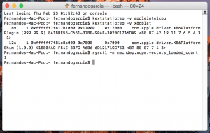

In order to optimize the system, I did some more testing with two and more xcpm patches. As I said, the system works well in both ways, but the biggest performance I got was with three patchs. The two I already used and more xcpm performance fix 1. So I get more performance and the advantage of continuing to have all the steps C3, C6 and P-States active. In fact some of the patches are only needed for those who do not have Bios unlocked.
Tests made with GB 4.0.3, Clover r4035, Sierra 12.4 beta 6, without NV graphics acceleration and without any overclocking.

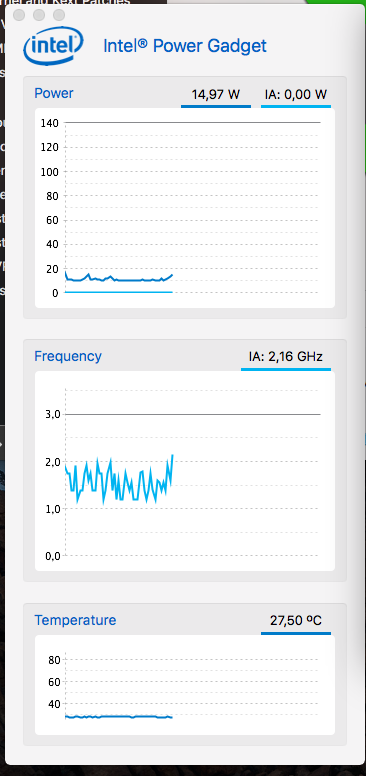

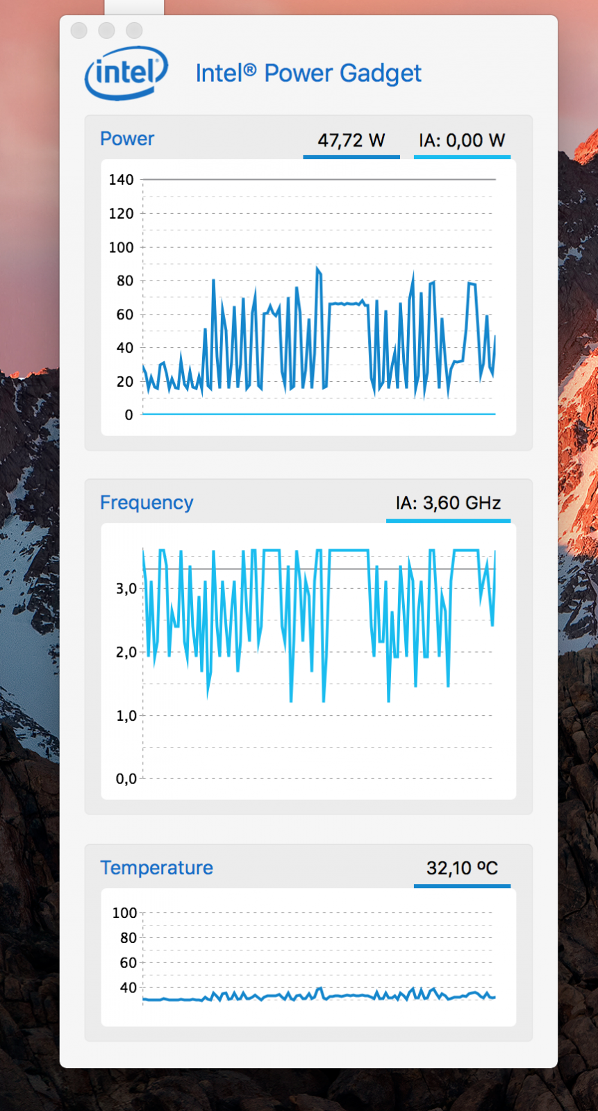

Na Bios: EIST Disable, Sync All Colors, USB Auto-Enable-Enable-Enable.
Attached is my EFI folder and FreqVectors, but I notice that it will only work well with same Board, Processor and Graphics as I have, since DSDT and SSDT were created specifically for my hardware. Even FakeSMC itself incorporates some kexts and fixes, namely for the Wi-Fi and MP6,1 black screen to avoid having to apply them whenever there are OS updates.
The IPG print was made during the course of GeekBench.
Ps: About mfc88 SSDTs, yes I agree with what it says and I understand the arguments it uses, but my problem is turning my big fat DSDT into several thin SSDTs... :D
EFI.rar
FreqVetors to Install in SLE.rar
Patchs and Kext for ALC1150.rar

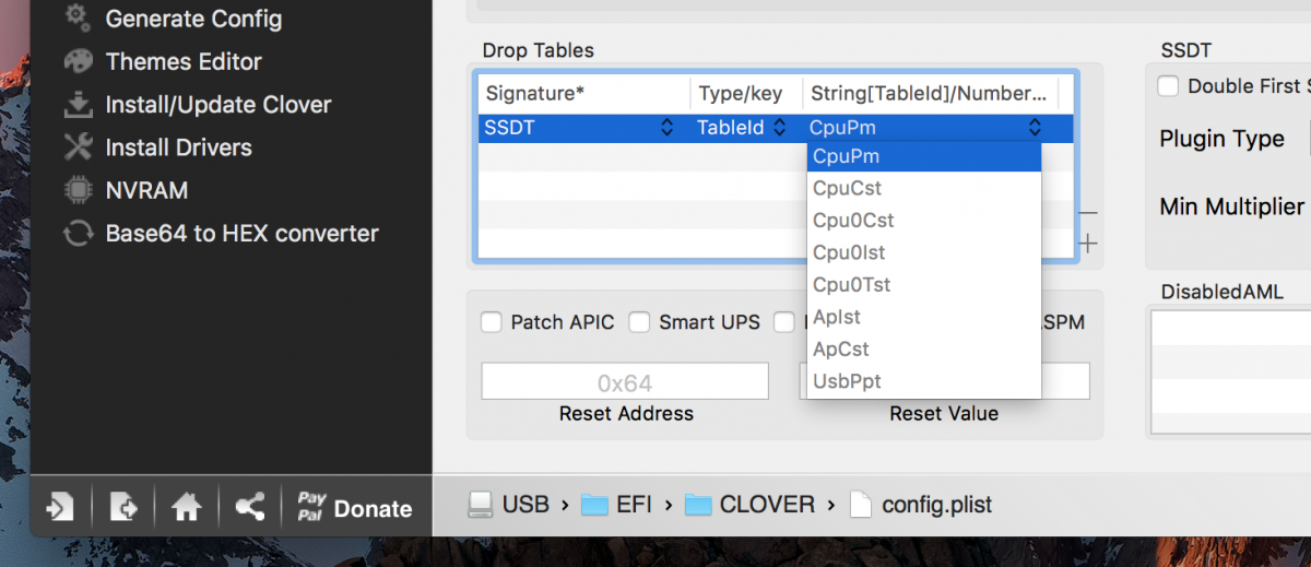

Here's my way of paying you back for helping me out many months ago when I was first getting my hack up and running...
What's included (cross-referenced to your DSDT device paths):
ALZA (HDEF)
BR3A (GFX1 + HDAU -- specified to inject your 960 Strix)
EVSS (sSata Controller)
GLAN (Ethernet)
LPC0 (AppleLPC)
SAT1 (AHCI controller)
SMBS (SBUS)
Not included:
UIAC (USB port injection)
RP04 (pci14e4,43b1 should be supported w/o _DSM -- check IOReg to confirm)
You'll have to make your own SSDT-UIAC.aml because your USB layout is different than mine. I've already set up your config.plist to inject all ports into XHC but I recommend that you follow Rehabman's guide (if you plan on using devices EH01/EH02) or my guide (if you only plan on just using XHC). Once you've created it, you can disable the USB port limit patch.
I also fixed your config.plist Drop Tables. You should be dropping "PmMgt" and not "CpuPm". You can double check this by dropping ACPI tables and then opening each dropped SSDT-x.aml and checking the Table Id at the top (since we share the same board, it should be the same):
Fergarth-EFI.zip

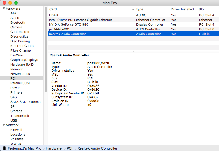

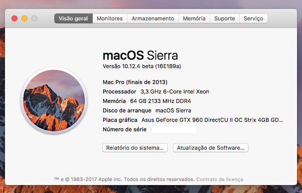

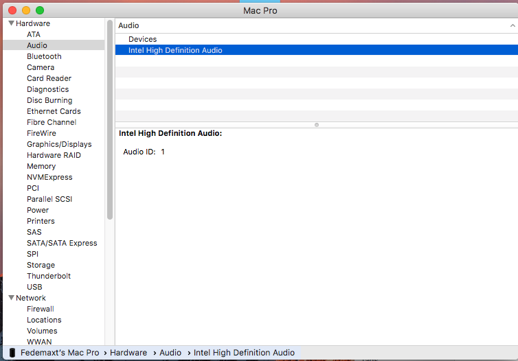

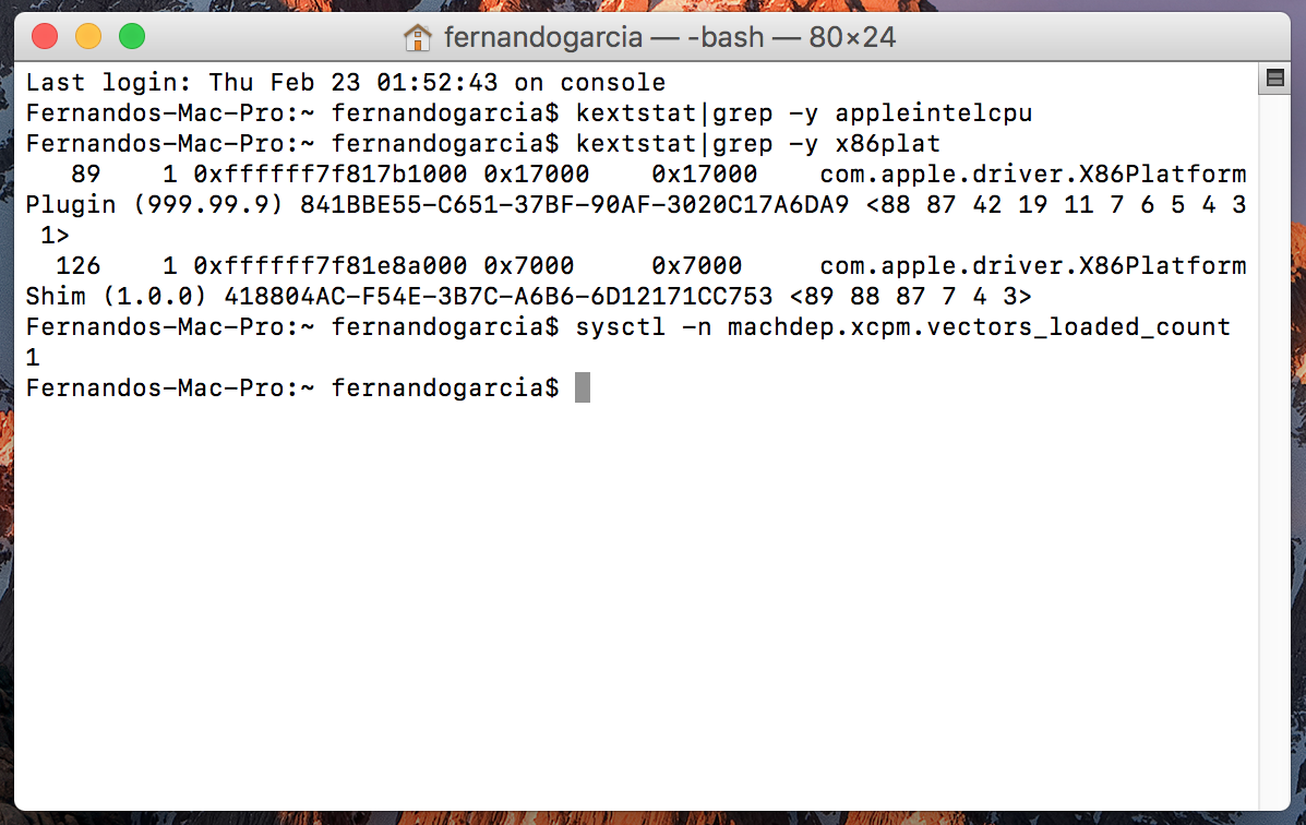

It worked!! After chamging the patches as Fabiosun told me, and choosing the 14,2 vectors as mfc88 suggested, it worked!
Thanks

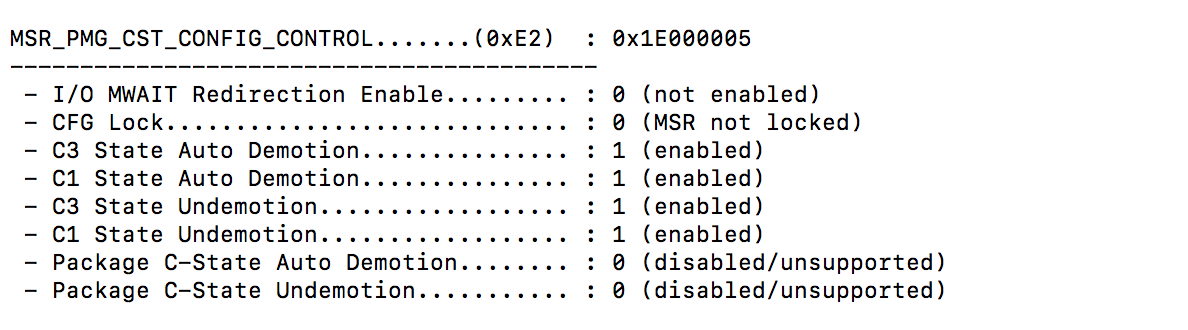

AppleIntelInfo.kext v2.5 Copyright © 2012-2017 Pike R. Alpha. All rights reserved.
Settings:
logMSRs..................................: 1
logIGPU..................................: 0
logCStates...............................: 1
logIPGStyle..............................: 1
Warning: Clover hw.busfrequency error detected : 17d78400
InitialTSC...............................: 0x4733328e8b3 (163 MHz)
MWAIT C-States...........................: 8480
Processor Brandstring....................: Intel(R) Core(TM) i7-5960X CPU @ 3.00GHz
Processor Signature..................... : 0x306F2
 - Family............................... : 6
 - Stepping............................. : 2
 - Model................................ : 0x3F (63)
Model Specific Registers (MSRs)
MSR_CORE_THREAD_COUNT............(0x35)  : 0x0
 - Core Count........................... : 8
 - Thread Count......................... : 16
MSR_PLATFORM_INFO................(0xCE)  : 0x80C3BF3811E00
 - Maximum Non-Turbo Ratio.............. : 0x1E (3000 MHz)
 - Ratio Limit for Turbo Mode........... : 1 (programmable)
 - TDP Limit for Turbo Mode............. : 1 (programmable)
 - Low Power Mode Support............... : 1 (LPM supported)
 - Number of ConfigTDP Levels........... : 1 (additional TDP level(s) available)
 - Maximum Efficiency Ratio............. : 12
 - Minimum Operating Ratio.............. : 8
MSR_PMG_CST_CONFIG_CONTROL.......(0xE2)  : 0x3
 - I/O MWAIT Redirection Enable......... : 0 (not enabled)
 - CFG Lock............................. : 0 (MSR not locked)
 - C3 State Auto Demotion............... : 0 (disabled/unsupported)
 - C1 State Auto Demotion............... : 0 (disabled/unsupported)
 - C3 State Undemotion.................. : 0 (disabled/unsupported)
 - C1 State Undemotion.................. : 0 (disabled/unsupported)
 - Package C-State Auto Demotion........ : 0 (disabled/unsupported)
 - Package C-State Undemotion........... : 0 (disabled/unsupported)
MSR_PMG_IO_CAPTURE_BASE..........(0xE4)  : 0x0
 - C-state Range........................ : 0 (C-States not included, I/O MWAIT redirection not enabled)
IA32_MPERF.......................(0xE7)  : 0x856CB12C5
IA32_APERF.......................(0xE8)  : 0x74B5D4876
MSR_FLEX_RATIO...................(0x194) : 0xE0000
MSR_IA32_PERF_STATUS.............(0x198) : 0x188700000C00
 - Current Performance State Value...... : 0xC00 (1200 MHz)
MSR_IA32_PERF_CONTROL............(0x199) : 0xC00
 - Target performance State Value....... : 0xC00 (1200 MHz)
 - Intel Dynamic Acceleration........... : 0 (IDA engaged)
IA32_CLOCK_MODULATION............(0x19A) : 0x0
IA32_THERM_INTERRUPT.............(0x19B) : 0x0
IA32_THERM_STATUS................(0x19C) : 0x883F0000
 - Thermal Status....................... : 0
 - Thermal Log.......................... : 0
 - PROCHOT # or FORCEPR# event.......... : 0
 - PROCHOT # or FORCEPR# log............ : 0
 - Critical Temperature Status.......... : 0
 - Critical Temperature log............. : 0
 - Thermal Threshold #1 Status.......... : 0
 - Thermal Threshold #1 log............. : 0
 - Thermal Threshold #2 Status.......... : 0
 - Thermal Threshold #2 log............. : 0
 - Power Limitation Status.............. : 0
 - Power Limitation log................. : 0
 - Current Limit Status................. : 0
 - Current Limit log.................... : 0
 - Cross Domain Limit Status............ : 0
 - Cross Domain Limit log............... : 0
 - Digital Readout...................... : 63
 - Resolution in Degrees Celsius........ : 1
 - Reading Valid........................ : 1 (valid)
MSR_THERM2_CTL...................(0x19D) : 0x0
IA32_MISC_ENABLES................(0x1A0) : 0x850081
 - Fast-Strings......................... : 1 (enabled)
 - FOPCODE compatibility mode Enable.... : 0
 - Automatic Thermal Control Circuit.... : 0 (disabled)
 - Split-lock Disable................... : 0
 - Performance Monitoring............... : 1 (available)
 - Bus Lock On Cache Line Splits Disable : 0
 - Hardware prefetch Disable............ : 0
 - Processor Event Based Sampling....... : 0 (PEBS supported)
 - GV1/2 legacy Enable.................. : 0
 - Enhanced Intel SpeedStep Technology.. : 1 (enabled)
 - MONITOR FSM.......................... : 1 (MONITOR/MWAIT supported)
 - Adjacent sector prefetch Disable..... : 0
 - xTPR Message Disable................. : 1 (disabled)
MSR_TEMPERATURE_TARGET...........(0x1A2) : 0x591200
 - Turbo Attenuation Units.............. : 0
 - Temperature Target................... : 89
 - TCC Activation Offset................ : 0
MSR_MISC_PWR_MGMT................(0x1AA) : 0x0
MSR_TURBO_RATIO_LIMIT............(0x1AD) : 0x2121212121212323
 - Maximum Ratio Limit for C01.......... : 23 (3500 MHz)
 - Maximum Ratio Limit for C02.......... : 23 (3500 MHz)
 - Maximum Ratio Limit for C03.......... : 21 (3300 MHz)
 - Maximum Ratio Limit for C04.......... : 21 (3300 MHz)
 - Maximum Ratio Limit for C05.......... : 21 (3300 MHz)
 - Maximum Ratio Limit for C06.......... : 21 (3300 MHz)
 - Maximum Ratio Limit for C07.......... : 21 (3300 MHz)
 - Maximum Ratio Limit for C08.......... : 21 (3300 MHz)
IA32_ENERGY_PERF_BIAS............(0x1B0) : 0x1
 - Power Policy Preference...............: 1 (highest performance)
MSR_POWER_CTL....................(0x1FC) : 0x21040059
 - Bi-Directional Processor Hot..........: 1 (enabled)
 - C1E Enable............................: 0 (disabled)
MSR_RAPL_POWER_UNIT..............(0x606) : 0xA0E03
 - Power Units.......................... : 3 (1/8 Watt)
 - Energy Status Units.................. : 14 (61 micro-Joules)
 - Time Units .......................... : 10 (976.6 micro-Seconds)
MSR_PKG_POWER_LIMIT..............(0x610) : 0x43857800148460
 - Package Power Limit #1............... : 140 Watt
 - Enable Power Limit #1................ : 1 (enabled)
 - Package Clamping Limitation #1....... : 0 (disabled)
 - Time Window for Power Limit #1....... : 10 (2560 milli-Seconds)
 - Package Power Limit #2............... : 175 Watt
 - Enable Power Limit #2................ : 1 (enabled)
 - Package Clamping Limitation #2....... : 1 (allow going below OS-requested P/T state setting Time Window for Power Limit #2)
 - Time Window for Power Limit #2....... : 33 (10 milli-Seconds)
 - Lock................................. : 0 (MSR not locked)
MSR_PKG_ENERGY_STATUS............(0x611) : 0x4E031B1
 - Total Energy Consumed................ : 4992 Joules (Watt = Joules / seconds)
MSR_CONFIG_TDP_NOMINAL...........(0x648) : 0x1E
MSR_CONFIG_TDP_LEVEL1............(0x649) : 0x940000001B0460
MSR_CONFIG_TDP_LEVEL2............(0x64a) : 0x94000000000000
MSR_CONFIG_TDP_CONTROL...........(0x64b) : 0x0
MSR_TURBO_ACTIVATION_RATIO.......(0x64c) : 0x0
MSR_PKGC3_IRTL...................(0x60a) : 0x0
MSR_PKGC6_IRTL...................(0x60b) : 0x0
MSR_PKG_C2_RESIDENCY.............(0x60d) : 0x131D7AABF4
MSR_PKG_C3_RESIDENCY.............(0x3f8) : 0x0
MSR_PKG_C6_RESIDENCY.............(0x3f9) : 0x8173090DF4
IA32_TSC_DEADLINE................(0x6E0) : 0x47336FF8B92
CPU Ratio Info:
Base Clock Frequency (BLCK)............. : 100 MHz
Maximum Efficiency Ratio/Frequency.......: 12 (1200 MHz)
Maximum non-Turbo Ratio/Frequency........: 30 (3000 MHz)
Maximum Turbo Ratio/Frequency............: 35 (3500 MHz)
P-State ratio * 100 = Frequency in MHz
CPU P-States [ (12) 27 33 ]
CPU C6-Cores [ 0 3 4 6 8 10 12 15 ]
CPU P-States [ 12 21 27 (30) 33 ]
CPU C6-Cores [ 0 1 2 3 4 5 6 8 9 10 11 12 15 ]
CPU P-States [ (12) 21 22 27 30 33 ]
CPU C6-Cores [ 0 1 2 3 4 5 6 7 8 9 10 11 12 15 ]
CPU C6-Cores [ 0 1 2 3 4 5 6 7 8 9 10 11 12 13 14 15 ]
CPU P-States [ (12) 19 21 22 27 30 33 ]
CPU P-States [ (12) 19 21 22 27 28 30 33 ]
CPU P-States [ 12 19 21 22 27 28 30 31 (33) ]
CPU P-States [ (12) 16 19 21 22 27 28 30 31 33 ]
CPU P-States [ (12) 16 19 21 22 25 27 28 30 31 33 ]
CPU P-States [ (12) 14 16 19 21 22 25 27 28 30 31 33 ]
CPU P-States [ (12) 14 16 19 21 22 25 26 27 28 30 31 33 ]
CPU P-States [ 12 14 16 18 19 21 22 25 26 27 28 (30) 31 33 ]
CPU P-States [ (12) 14 16 18 19 20 21 22 25 26 27 28 30 31 33 ]
CPU P-States [ (12) 14 16 17 18 19 20 21 22 25 26 27 28 30 31 33 ]
CPU P-States [ (12) 14 16 17 18 19 20 21 22 23 25 26 27 28 30 31 33 ]
CPU P-States [ (12) 14 16 17 18 19 20 21 22 23 24 25 26 27 28 30 31 33 ]
CPU P-States [ (12) 14 15 16 17 18 19 20 21 22 23 24 25 26 27 28 30 31 33 ]
CPU P-States [ (12) 13 14 15 16 17 18 19 20 21 22 23 24 25 26 27 28 30 31 33 ]
CPU P-States [ 12 13 14 15 16 17 18 19 20 21 22 23 24 25 26 27 28 30 31 33 (35) ]
CPU P-States [ (12) 13 14 15 16 17 18 19 20 21 22 23 24 25 26 27 28 29 30 31 33 35 ]
Done populating the CPU states!
Fedemaxts-Mac-Pro:~ seppia$
working
xcpm
graphics
sleep
Usb2.0/3.0
OC stable @4.3ghz
not working yet:
realtek 1150
hdmi audio (there must be some conflicts because it was working fine)
I will start diggin the forum for some overclocking clues, if you have suggestions they´ll be more than welcome! Thanks again
@mfc88 I've learned a lot by you and other user like @nmano @PMHeart, etc... and making a Hackintosh workstation stable and rocksolid for my work has been a challenge for me and for people like us that loves computing and OS X without buy official hardware that, for pro' users, it's like a joke!
I appreciate your help... Now I've a system with full XCPM working but I'd like to complete the opera compiling SSDT's for my system, dropping PCI table, etc...
If I'll post my EFI configuration, IOREG's profile could someone help me for it? If it's answering too much, I'll appreciate a guide too!
Thanks a lot to everyone!!
Inviato dal mio iPad utilizzando Tapatalk
Thanks

Hi,
I saw you have this and you can correct:
In my opinion you should enter the Bios of your board and select the function "Sync All Cores" to the cores reach all the same maximum frequency.
In Asus it's in the Ai Tweaker zone, but I do not know what board you have. You should also create a signature with your hardware, to facilitate the help.

And you can also try to fix this by trying to use only the 3 XCPM patchs in my EFI config.plist. So you get to have C-3, C-6 and P-States in the result of your AppleInteinfo without losing performance. If in your case does not work for you, reverse!
Are you sure that's what you say? In Clover, the option you suggested for PM does not appear... ^_^
Mount your current SSD via Clover Configurator, then generate boot.log (you can find it on the left hand side under "Tools" and underneath "Mount EFI" will be "Boot.log," click "Generate log"). Then paste here.
Ok, is this what you're looking for? So this is where I have to base and apply PmMgt. Ok ok... :yes:
If you go further down the boot.log, it should show this...
6:104  0:000  === [ ACPIDropTables ] ====================================
6:104  0:000  Drop tables from Xsdt, SIGN=SSDT TableID=PmMgt Length=86589
6:104  0:000   Xsdt has tables count=15
6:104  0:000   Table: SSDT  PmMgt  86589 dropped
Hello all,
even though it is all recognised in SysProfiler, I´m still stuck without Audio, i´ve tried all this solutions in vain:
-Patchs and  Kext for ALC1150
-toleda alc 1150 (audio_cloverALC-120_v1.0d 2.command)
-AppleALC + CodecCommander kexts
Still no go.
Have you any clues? Thanks for your help

Hi,
I cleaned and altered your EFI, had some junk...
The suggestion I gave you for sound, only works if AppleHDA is original (vanilla). If you applied toleda alc 1150 (audio_cloverALC-120_v1.0d 2.command)
-AppleALC + CodecCommander kexts your AppleHDA.kext is no longer original.
Read this, here you have an original AppleHDA.kext. Replace this one with the one you have in SLE and try. It can not copy/paste, you have to install it with the Kext Wizard and then rebuild the permissions.
Your config.plist already has the HDA patches, you just have to install the AppleHDA_ALC1150.kext and the original AplleHDA.kext and rebuild the permissions. Kext Wizard installs and does this. After that, try with the attached EFI.
EFI.rar

I noticed that in the results of your Intel Info it appears like this!
MSR_PMG_CST_CONFIG_CONTROL.......(0xE2)  : 0x8400
 - I/O MWAIT Redirection Enable......... : 1 (enabled, IO read of MSR(0xE4) mapped to MWAIT)
 - CFG Lock............................. : 1 (MSR locked until next reset)
I've been running Intel Info and in mine it appears like this with just tree XCPM patches. I tried only with two patches, but it seemed to me more stable with three. But with more time I still have to explore better with only two. Anyway, as it stands it seems perfect!

MSR_PMG_CST_CONFIG_CONTROL.......(0xE2)  : 0x1E000005
 - C3 State Auto Demotion............... : 1 (enabled)
 - C1 State Auto Demotion............... : 1 (enabled)
 - C3 State Undemotion.................. : 1 (enabled)
 - C1 State Undemotion.................. : 1 (enabled)
My question is: Which one of us is right and which one is wrong?
And as no one has spoken, for me, the answer is: I am the one who is well and I'm going to have a gin to make the party  :thumbsup_anim:
Hello
Sorry to respond late, work, work !!!
So if I disable the patch as in your photo, my hack does not boot
