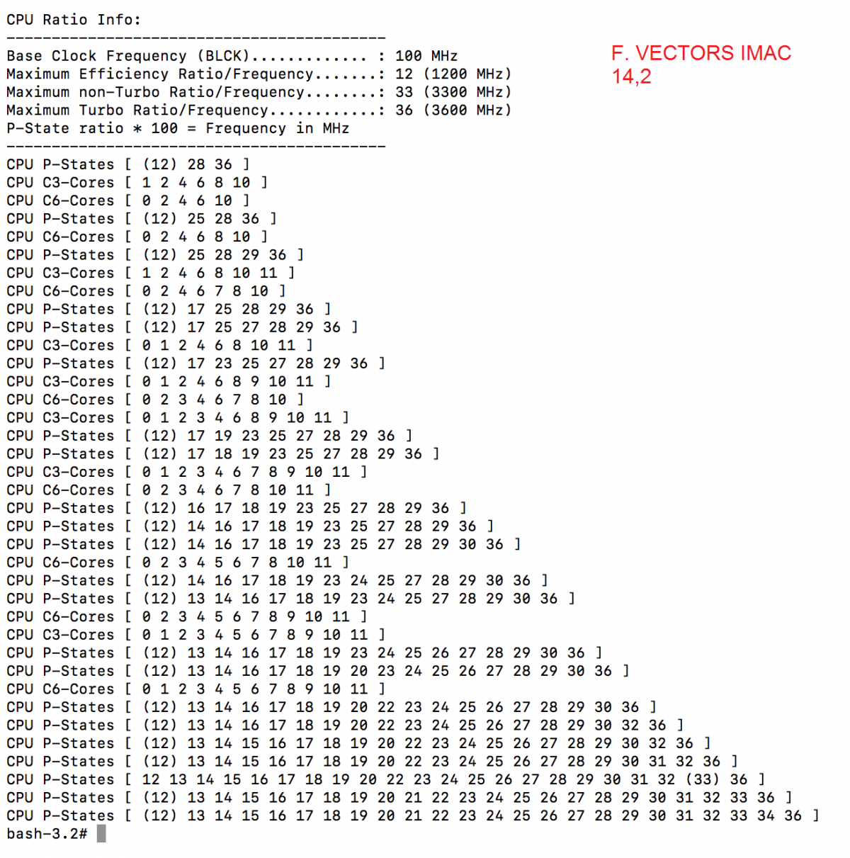

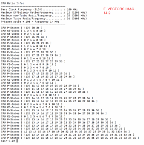

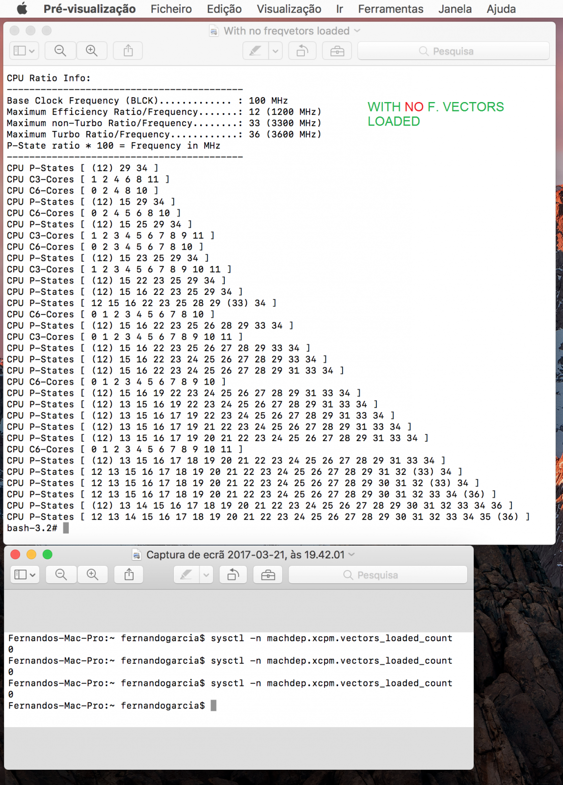

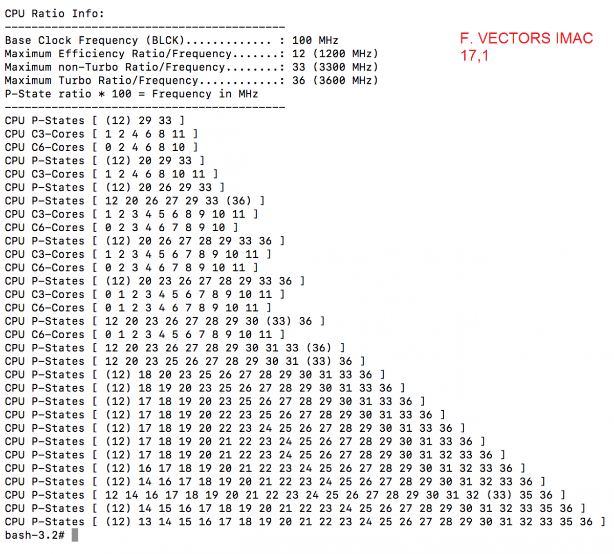

As always our intention is to optimize and improve the systems and I was doing tests with two freqvectors.kexts (thakns PMHeart) with different freqvectors (14,2), (17,1) and without freqvectors loaded in my macpro6,1 and strangely also works well too without any kext loaded :yes:
I no longer use freqVectorsEdit.sh from Pike.
The result is in the prints below.
I did not test performance, so I do not know if it changes anything.
What is your opinion and which of the results do you think is better? ^_^
Hi Fergarth, thank you for your constant testing! :-)
This two pictures in my opinion are pretty similar, for me, the best result should be where you have in this conditions best performance and less wattage usage (so low temperatures)
Always I think it is useful to post your two patches so people can compare with your results
In my case to achieve C3 visible states in output I have to program msr 0xE2 as user sammlerG taught us in a old post
Hi Fabio,
Yes it´s true, the difference between both vectors is minimal and consumption has remained the same. To have C3 in the output, I just need to use two patches and are these:
