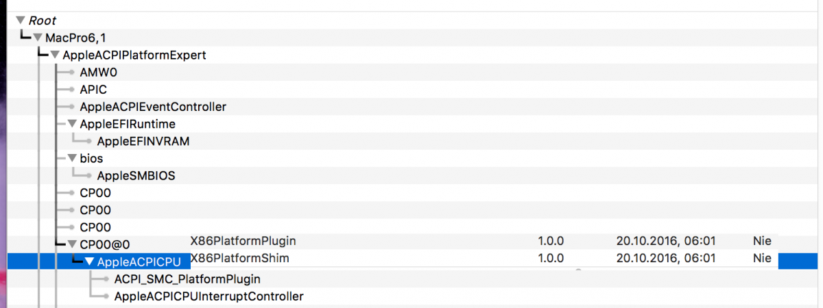

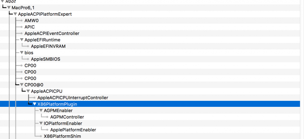

I don't suppose that X86* are loaded properly. Please try to type in
kextstat | grep X86
If you get no output, then X86* are not loaded, in this case, you should check your "plugin-type" property in your EFI Device Properties/ACPI _DSM Method. (Should be set to 0x1.)
kextstat | grep X86
Thanks...i solved....i deleted the kext and now i've output to kextstat grep command and vector loaded.

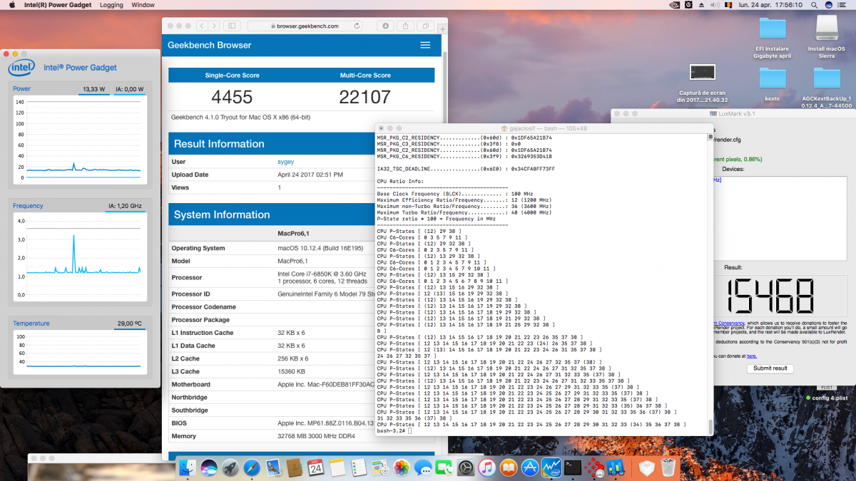

Hello friends
I need your help, I have successfully installed MacOS Sierra 10.12.4.
Hardware:
* X99 Mootherboard
* CPU 5930K
* GTX 1070
* Ram 16GB DDR4
* SSD 850 PRO

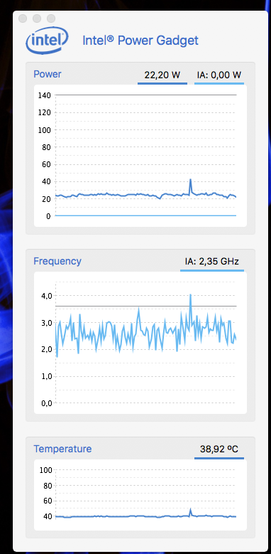

My question is how can I get better energy management, I've seen IPG catches with very low consumptions and more states.
This is my AppleIntelInfo and IPG
(Does not allow me to upload an image of my capture of Intel Power Gadget, sorry)

 How can I create a correct ssdtPRGen.sh for my 5930K (I have no overclocking).

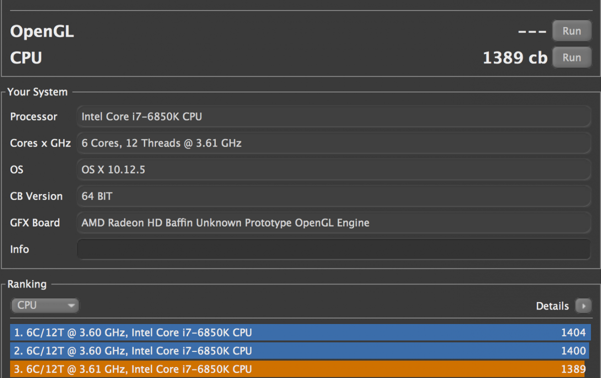

Most of us use iMac 17.1 definitions so i think they should be good for you too. And if you read older posts you will find correct suggestions how to use your cpu.
Did any of you try this solution for Broadwell-E? Im using this combination for a week and computer have more P states and cpu in idle mode working more quieter and and in lower temp. (Im using 6850k OC to 4.4)

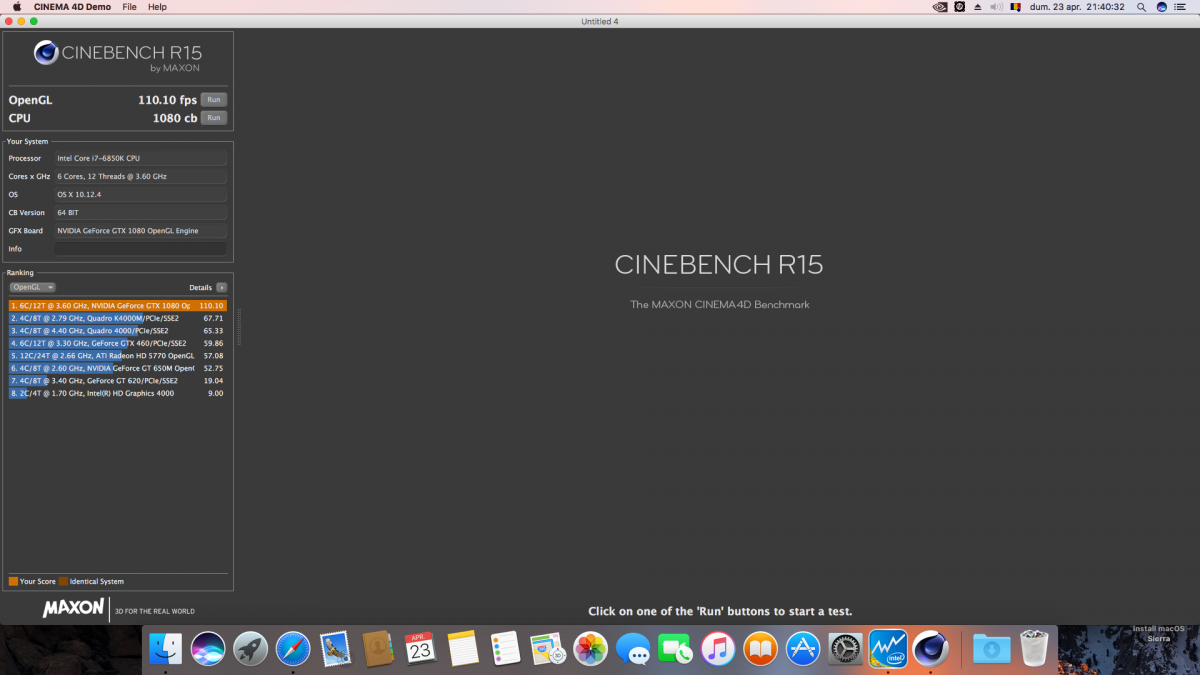

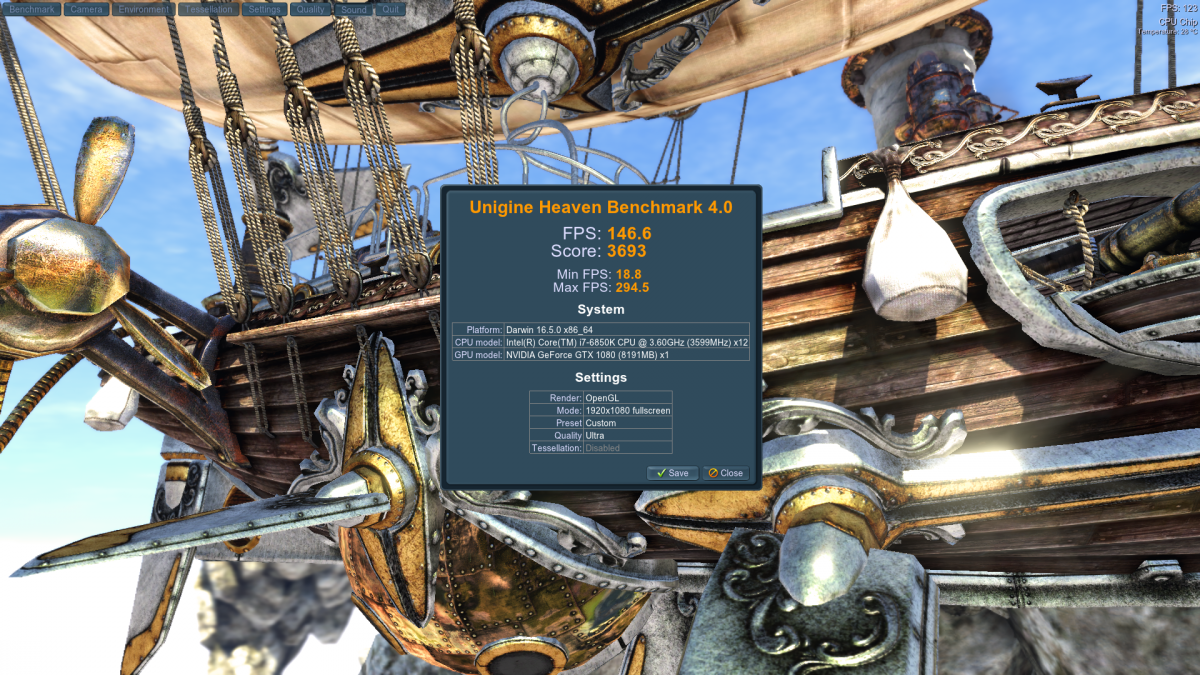

Some time ago I have tried it , but it was not so stable for me .
Also performance was worst in CPU and graphic
I working on this solution for a week in FCPX and performance is identical in my case. Plus now I have lower cpu temp.
83c0e9 > 83c0e1 - Broadwell-E CPUID
554889e5 41574156 41554154 53504189d64189f7 4889fb45 85ff0f84 > c39089e5 41574156 41554154 535041890d64189f 74889fb4 585ff0f8 - Rebot Fix
83c3c483 fb22 > 83c3bc83 fb22 -  xcpm bootstrap
and attachicon.gifPMDrvr.kext.zip
attachicon.gifZrzut ekranu 2017-04-24 o 13.00.40.png attachicon.gifZrzut ekranu 2017-04-24 o 13.01.18.png
attachicon.gifZrzut ekranu 2017-04-24 o 13.05.58.png attachicon.gifZrzut ekranu 2017-04-24 o 13.05.48.png
attachicon.gifZrzut ekranu 2017-04-24 o 13.03.45.png attachicon.gifZrzut ekranu 2017-04-24 o 13.17.12.png

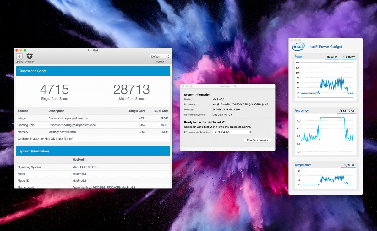

Hi Matthew82! for me it worked! I have a louwerr consumption watt and idle fregvency, with same benchmarks 22000 multicore
i have always this problem in every situation ..testyng ..always ...  or fervency to high and watt ok , or watt to high and fregvency low
For  working xcpm,  macOS must be installed when I already overclocked to profile 1 from bios?   or it recognise later to, if I install macOS Sierra on stock 3,6 profile?

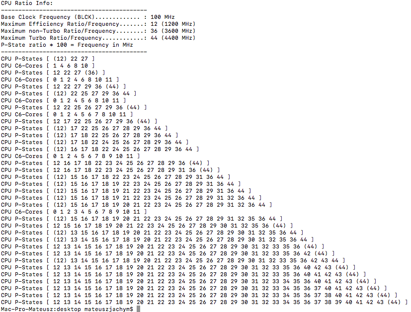

​I,m not sure how is this working.
Here are my results...
Without PMDriver and with SSDT:
While idling (ignore Watts, it's incorrect due to manual overclock):
MSR_PKG_ENERGY_STATUS............(0x611) : 0x6F2DE
 - Total Energy Consumed................ : 27 Joules (Watt = Joules / seconds)
MSR_PKGC3_IRTL...................(0x60a) : 0x0
MSR_PKGC6_IRTL...................(0x60b) : 0x0
MSR_PKG_C2_RESIDENCY.............(0x60d) : 0x0
MSR_PKG_C3_RESIDENCY.............(0x3f8) : 0x0
MSR_PKG_C6_RESIDENCY.............(0x3f9) : 0x0
IA32_TSC_DEADLINE................(0x6E0) : 0x2C15FC8B267D
CPU Ratio Info:
Base Clock Frequency (BLCK)............. : 100 MHz
Maximum Efficiency Ratio/Frequency.......: 12 (1200 MHz)
Maximum non-Turbo Ratio/Frequency........: 30 (3000 MHz)
Maximum Turbo Ratio/Frequency............: 40 (4000 MHz)
P-State ratio * 100 = Frequency in MHz
CPU P-States [ 27 (40) ]
CPU C6-Cores [ 0 2 4 10 12 19 ]
CPU P-States [ (12) 27 34 40 ]
CPU C6-Cores [ 0 2 4 7 8 10 12 14 19 ]
CPU P-States [ 12 27 29 34 (40) ]
CPU C6-Cores [ 0 1 2 4 6 7 8 10 12 14 15 16 18 19 ]
CPU P-States [ 12 27 29 34 38 (40) ]
CPU C6-Cores [ 0 1 2 3 4 6 7 8 10 11 12 13 14 15 16 18 19 ]
CPU P-States [ 12 27 29 34 35 38 (40) ]
CPU P-States [ 12 27 29 34 35 37 38 (40) ]
CPU C6-Cores [ 0 1 2 3 4 5 6 7 8 10 11 12 13 14 15 16 18 19 ]
CPU P-States [ (12) 27 29 34 35 37 38 39 40 ]
CPU P-States [ 12 27 29 33 34 35 37 38 39 (40) ]
CPU C6-Cores [ 0 1 2 3 4 5 6 7 8 10 11 12 13 14 15 16 17 18 19 ]
CPU C6-Cores [ 0 1 2 3 4 5 6 7 8 9 10 11 12 13 14 15 16 17 18 19 ]
CPU P-States [ 12 27 29 32 33 34 35 37 38 39 (40) ]
CPU P-States [ (12) 27 29 32 33 34 35 36 37 38 39 40 ]
CPU P-States [ (12) 27 29 30 32 33 34 35 36 37 38 39 40 ]
CPU P-States [ (12) 27 29 30 31 32 33 34 35 36 37 38 39 40 ]
CPU P-States [ 12 26 27 29 30 31 32 33 34 35 36 37 38 39 (40) ]
CPU P-States [ (12) 26 27 28 29 30 31 32 33 34 35 36 37 38 39 40 ]
CPU P-States [ (12) 23 26 27 28 29 30 31 32 33 34 35 36 37 38 39 40 ]
CPU P-States [ 12 22 23 26 27 28 29 30 31 32 33 34 35 36 37 38 39 (40) ]
CPU P-States [ 12 22 23 25 26 27 28 29 30 31 32 33 34 35 36 37 38 39 (40) ]
CPU P-States [ 12 21 22 23 25 26 27 28 29 30 31 32 33 34 35 36 37 38 39 (40) ]
CPU P-States [ 12 21 22 23 24 25 26 27 28 29 30 31 32 33 34 35 36 37 38 39 (40) ]

With PMDriver and with SSDT:
MSR_PKG_ENERGY_STATUS............(0x611) : 0x349136
 - Total Energy Consumed................ : 210 Joules (Watt = Joules / seconds)
IA32_TSC_DEADLINE................(0x6E0) : 0x2B2386C486EC
CPU Ratio Info:
CPU P-States [ (12) 25 ]
CPU C6-Cores [ 0 2 8 10 12 16 19 ]
CPU P-States [ (12) 14 25 ]
CPU C6-Cores [ 0 2 4 6 8 10 12 14 16 18 19 ]
CPU P-States [ (12) 14 16 25 ]
CPU P-States [ (12) 14 16 25 27 ]
CPU P-States [ (12) 14 15 16 25 27 ]
CPU C6-Cores [ 0 2 3 4 6 8 10 12 14 16 18 19 ]
CPU P-States [ (12) 14 15 16 17 25 27 ]
CPU C6-Cores [ 0 1 2 3 4 6 8 10 12 14 16 18 19 ]
CPU P-States [ (12) 13 14 15 16 17 25 27 ]
CPU C6-Cores [ 0 1 2 3 4 5 6 8 10 12 14 16 18 19 ]
CPU C6-Cores [ 0 1 2 3 4 5 6 8 10 12 14 16 17 18 19 ]
CPU P-States [ (12) 13 14 15 16 17 18 25 27 ]
CPU P-States [ (12) 13 14 15 16 17 18 19 25 27 ]
CPU P-States [ (12) 13 14 15 16 17 18 19 23 25 27 ]
CPU C6-Cores [ 0 1 2 3 4 5 6 8 10 12 13 14 16 17 18 19 ]
CPU P-States [ 12 13 14 15 16 17 18 19 23 25 27 (40) ]
CPU C6-Cores [ 0 1 2 3 4 5 6 8 9 10 12 13 14 16 17 18 19 ]
CPU P-States [ 12 13 14 15 16 17 18 19 20 23 25 27 (30) 40 ]
CPU C6-Cores [ 0 1 2 3 4 5 6 8 9 10 12 13 14 15 16 17 18 19 ]
CPU P-States [ 12 13 14 15 16 17 18 19 20 23 (24) 25 26 27 30 40 ]
CPU P-States [ (12) 13 14 15 16 17 18 19 20 23 24 25 26 27 30 32 40 ]
CPU P-States [ (12) 13 14 15 16 17 18 19 20 23 24 25 26 27 29 30 32 40 ]
CPU P-States [ (12) 13 14 15 16 17 18 19 20 21 23 24 25 26 27 29 30 32 40 ]
CPU P-States [ 12 13 14 15 16 17 18 19 20 21 23 24 25 26 27 29 30 32 36 (40) ]
CPU P-States [ (12) 13 14 15 16 17 18 19 20 21 22 23 24 25 26 27 29 30 32 36 40 ]
CPU C6-Cores [ 0 1 2 3 4 5 6 8 9 10 11 12 13 14 15 16 17 18 19 ]
CPU P-States [ 12 13 14 15 16 17 18 19 20 21 22 23 24 25 26 27 28 29 30 32 36 (40) ]
With PMDriver and without SSDT:
MSR_PKG_ENERGY_STATUS............(0x611) : 0x4AEA4E
 - Total Energy Consumed................ : 299 Joules (Watt = Joules / seconds)
IA32_TSC_DEADLINE................(0x6E0) : 0x28DF5B1D5365
CPU Ratio Info:
CPU P-States [ (12) 28 40 ]
CPU C6-Cores [ 0 2 4 6 8 10 12 14 16 18 ]
CPU C6-Cores [ 0 1 2 3 4 6 8 10 11 12 14 16 18 19 ]
CPU C6-Cores [ 0 1 2 3 4 6 8 9 10 11 12 14 15 16 18 19 ]
CPU P-States [ (12) 28 34 40 ]
CPU C6-Cores [ 0 1 2 3 4 5 6 8 9 10 11 12 14 15 16 18 19 ]
CPU P-States [ (12) 14 28 34 40 ]
CPU P-States [ (12) 14 16 28 34 40 ]
CPU P-States [ (12) 13 14 16 28 34 40 ]
CPU P-States [ (12) 13 14 16 28 34 37 40 ]
CPU C6-Cores [ 0 1 2 3 4 5 6 7 8 9 10 11 12 14 15 16 18 19 ]
CPU C6-Cores [ 0 1 2 3 4 5 6 7 8 9 10 11 12 14 15 16 17 18 19 ]
CPU P-States [ (12) 13 14 16 28 33 34 37 40 ]
CPU P-States [ (12) 13 14 16 22 28 33 34 37 40 ]
CPU P-States [ (12) 13 14 16 19 22 28 33 34 37 40 ]
CPU P-States [ 12 13 14 16 19 22 28 33 34 37 (38) 40 ]
CPU P-States [ (12) 13 14 15 16 19 22 28 33 34 37 38 40 ]
CPU P-States [ (12) 13 14 15 16 19 22 24 28 33 34 37 38 40 ]
CPU P-States [ 12 13 14 15 16 19 22 24 28 32 33 34 37 38 (40) ]
CPU P-States [ (12) 13 14 15 16 19 21 22 24 28 32 33 34 37 38 40 ]
CPU P-States [ 12 13 14 15 16 19 21 22 23 24 28 32 33 34 37 38 (40) ]
CPU P-States [ 12 13 14 15 16 19 20 21 22 23 24 28 32 33 34 37 38 (40) ]
CPU P-States [ (12) 13 14 15 16 18 19 20 21 22 23 24 28 32 33 34 37 38 40 ]
CPU P-States [ (12) 13 14 15 16 18 19 20 21 22 23 24 27 28 32 33 34 37 38 40 ]
CPU P-States [ (12) 13 14 15 16 18 19 20 21 22 23 24 26 27 28 32 33 34 37 38 40 ]
CPU P-States [ (12) 13 14 15 16 18 19 20 21 22 23 24 25 26 27 28 32 33 34 37 38 40 ]
CPU P-States [ (12) 13 14 15 16 18 19 20 21 22 23 24 25 26 27 28 29 32 33 34 37 38 40 ]
CPU P-States [ (12) 13 14 15 16 17 18 19 20 21 22 23 24 25 26 27 28 29 32 33 34 37 38 40 ]
Well slap my @$$ and call me "Sally," it works pretty well. But! It needs more testing before I can call it stable.
Note: Without SSDT, while showing better results, seemed like it took a bit more time to boot in to the OS.
Update: Random kernel panic without SSDT. Not stable.
Switching to PMDriver w/SSDT.
Hi mfc88!      Is this CPU-S v 3.7 some  ssdt maker tool ..or some tester..?
Wath are your overclock numbers. 4,5 Ghz ?
i just do as u told and got a good dsl, but when i save it as aml, errors still occour. so confused
No errors on my end. Make sure you're using the correct MaciASL/IASL version.
