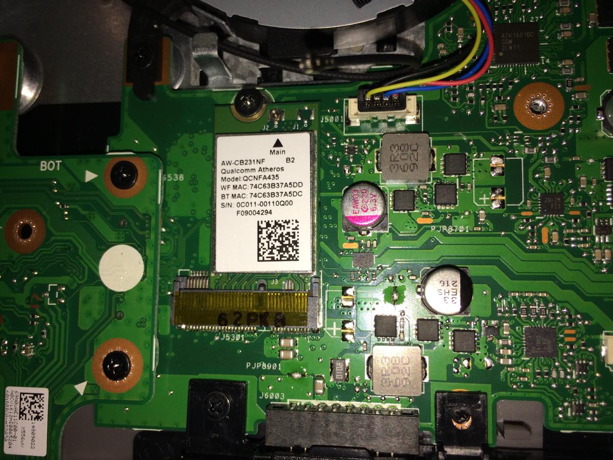

Centinho Posted May 30, 2016 Author Share Posted May 30, 2016 Ho controllato il tipo di scheda WiFi. Si tratta di una mini Pcie express. Quale devo acquistare quindi? Link to comment https://www.insanelymac.com/forum/topic/312335-installare-el-capitan-su-asus-x556u/page/7/#findComment-2241289 Share on other sites More sharing options...
gengik84 Posted May 30, 2016 Share Posted May 30, 2016 Post 133 La prima... Link to comment https://www.insanelymac.com/forum/topic/312335-installare-el-capitan-su-asus-x556u/page/7/#findComment-2241290 Share on other sites More sharing options...
Centinho Posted May 30, 2016 Author Share Posted May 30, 2016 La scheda è questa Ha tre "ingressi" però..non riesco a capire bene di che tipo si tratta Link to comment https://www.insanelymac.com/forum/topic/312335-installare-el-capitan-su-asus-x556u/page/7/#findComment-2241292 Share on other sites More sharing options...
gengik84 Posted May 30, 2016 Share Posted May 30, 2016 Non è pci-e... Link to comment https://www.insanelymac.com/forum/topic/312335-installare-el-capitan-su-asus-x556u/page/7/#findComment-2241294 Share on other sites More sharing options...
Centinho Posted May 30, 2016 Author Share Posted May 30, 2016 Eh allora di cosa si tratta? Link to comment https://www.insanelymac.com/forum/topic/312335-installare-el-capitan-su-asus-x556u/page/7/#findComment-2241295 Share on other sites More sharing options...
gengik84 Posted May 30, 2016 Share Posted May 30, 2016 Mettici anche un po' del tuo...nel senso... Per esempio Google...ricerca....modello https://wikidevi.com/wiki/Qualcomm_Atheros_QCNFA435... Link to comment https://www.insanelymac.com/forum/topic/312335-installare-el-capitan-su-asus-x556u/page/7/#findComment-2241296 Share on other sites More sharing options...
Centinho Posted May 30, 2016 Author Share Posted May 30, 2016 Allora a quanto ho capito, da alcune ricerche che ho fatto, si tratta di una NGFF? Link to comment https://www.insanelymac.com/forum/topic/312335-installare-el-capitan-su-asus-x556u/page/7/#findComment-2241298 Share on other sites More sharing options...
gengik84 Posted May 30, 2016 Share Posted May 30, 2016 Beh direi di si... Link to comment https://www.insanelymac.com/forum/topic/312335-installare-el-capitan-su-asus-x556u/page/7/#findComment-2241299 Share on other sites More sharing options...
Centinho Posted May 30, 2016 Author Share Posted May 30, 2016 Perfetto. Quindi posso acquistare quella che stai aspettando tu? Link to comment https://www.insanelymac.com/forum/topic/312335-installare-el-capitan-su-asus-x556u/page/7/#findComment-2241300 Share on other sites More sharing options...

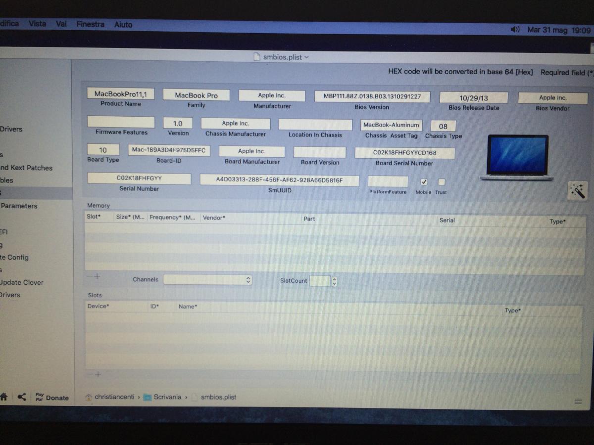

Centinho Posted May 31, 2016 Author Share Posted May 31, 2016 Come ti sembra questo SmBios? Cosa devo aggiungere negli spazi vuoti e nelle caselle "Memory" e "Slots"? Link to comment https://www.insanelymac.com/forum/topic/312335-installare-el-capitan-su-asus-x556u/page/7/#findComment-2241459 Share on other sites More sharing options...
gengik84 Posted May 31, 2016 Share Posted May 31, 2016 Scusami... ma ti ho detto che MacBookPro 11. è Haswell...e non va bene perché tu hai skylake... Ad oggi unici portatili dotati di tale processore sono i MacBook 9.1... è questo il SMbios che devi creare. Non basta che tu cambi solo la parte "product name"...tutto il resto è di conseguenza per ogni modello... Non troverai un SMbios già pronto... è troppo presto...per quello devi crearlo te. Quindi prendila col la giusta calma, fai ricerche ed allo stesso tempo devi essere minuzioso nei relativi "dettagli"... Ripeto: il seriale non deve essere originale e quindi non deve essere riconosciuto da Apple. Puoi controllare qui, inserendolo ed ovviamente la risposta ricevuta deve essere negativa Buon lavoro.... Link to comment https://www.insanelymac.com/forum/topic/312335-installare-el-capitan-su-asus-x556u/page/7/#findComment-2241463 Share on other sites More sharing options...
