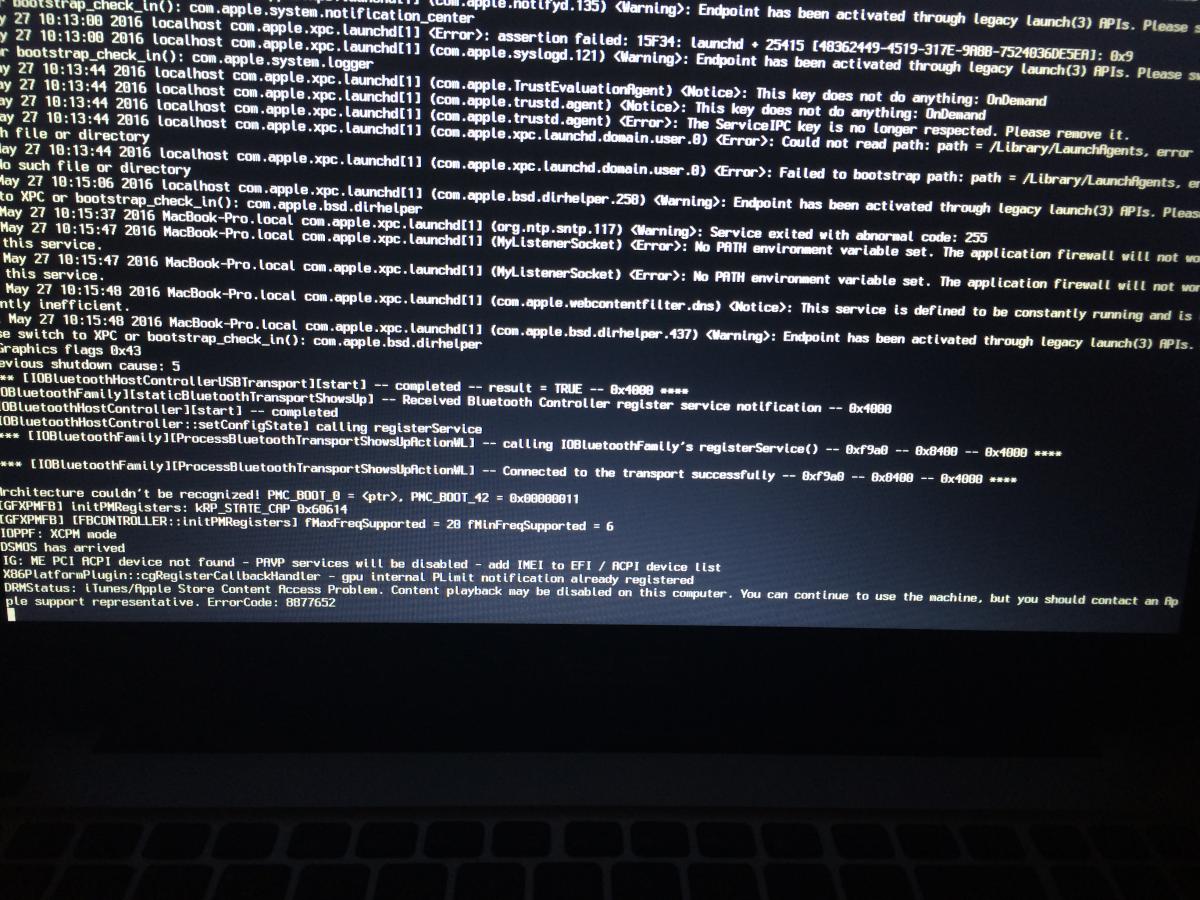

Centinho Posted May 27, 2016 Author Share Posted May 27, 2016 Ho rimosso le kext ed ho riprovato, sembrava caricare tutto, solo che quando ha finito con le scritte nere è rimasto solo lo schermo acceso senza nulla. Link to comment https://www.insanelymac.com/forum/topic/312335-installare-el-capitan-su-asus-x556u/page/2/#findComment-2240617 Share on other sites More sharing options...

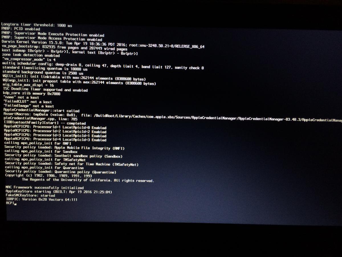

gengik84 Posted May 27, 2016 Share Posted May 27, 2016 posta la foto del verbose Link to comment https://www.insanelymac.com/forum/topic/312335-installare-el-capitan-su-asus-x556u/page/2/#findComment-2240618 Share on other sites More sharing options...
Centinho Posted May 27, 2016 Author Share Posted May 27, 2016 Lo sto facendo ripartire, ti interessa la parte finale, giusto? Link to comment https://www.insanelymac.com/forum/topic/312335-installare-el-capitan-su-asus-x556u/page/2/#findComment-2240619 Share on other sites More sharing options...
gengik84 Posted May 27, 2016 Share Posted May 27, 2016 si esatto Link to comment https://www.insanelymac.com/forum/topic/312335-installare-el-capitan-su-asus-x556u/page/2/#findComment-2240620 Share on other sites More sharing options...

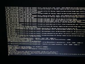

Centinho Posted May 27, 2016 Author Share Posted May 27, 2016 Ecco la parte prima della schermata nera. Link to comment https://www.insanelymac.com/forum/topic/312335-installare-el-capitan-su-asus-x556u/page/2/#findComment-2240622 Share on other sites More sharing options...
gengik84 Posted May 27, 2016 Share Posted May 27, 2016 nella sezione graphics metti inject intel e su ig-platform-id metti ==> 0x191b0000 Salva la modifica al config e riprova Link to comment https://www.insanelymac.com/forum/topic/312335-installare-el-capitan-su-asus-x556u/page/2/#findComment-2240623 Share on other sites More sharing options...

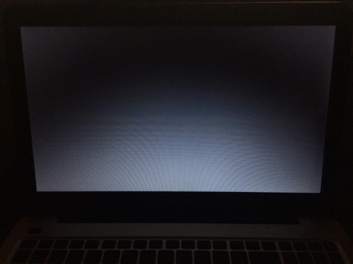

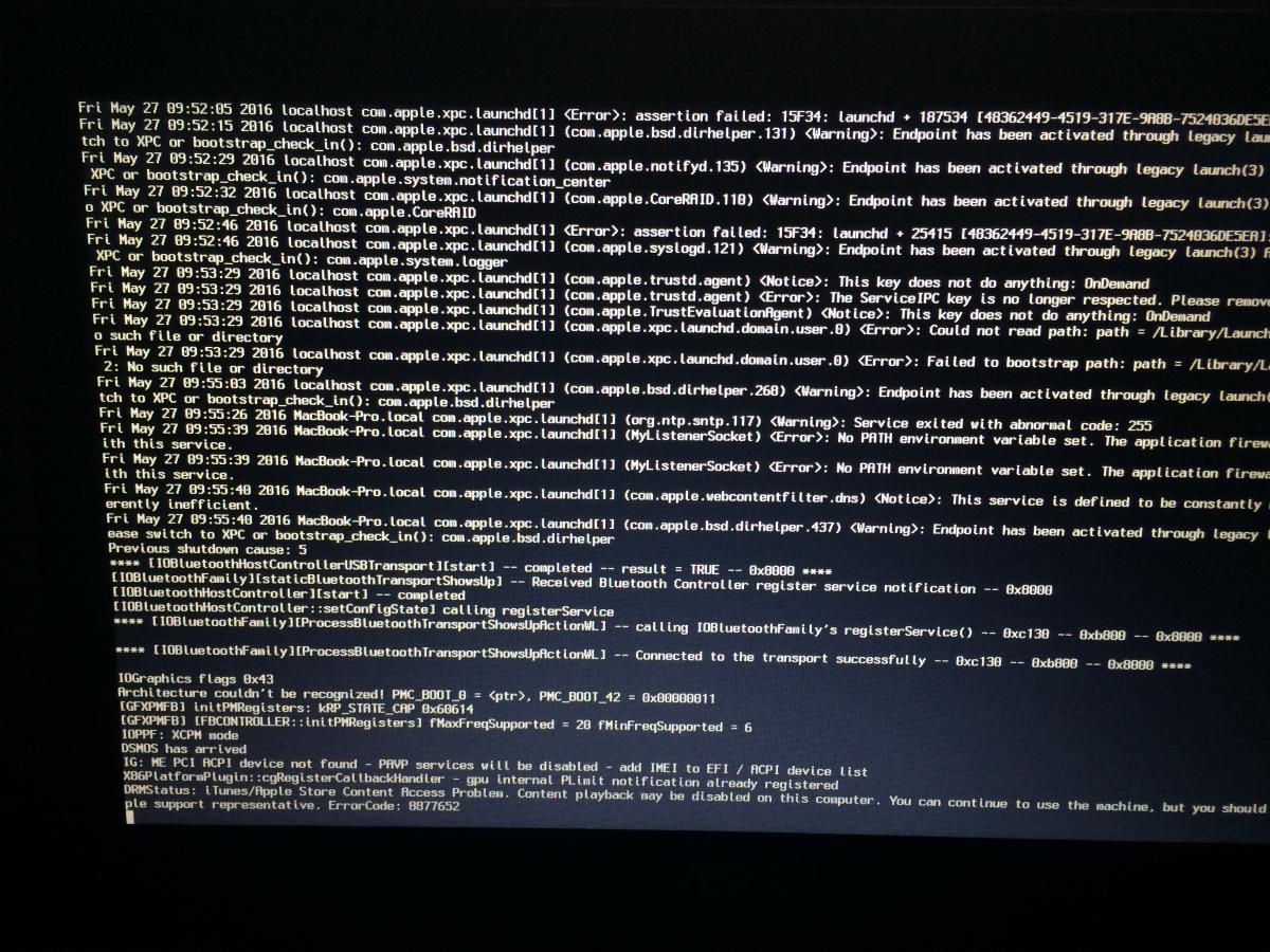

Centinho Posted May 27, 2016 Author Share Posted May 27, 2016 Ecco quello che compare adesso. Sembra esser partito qualcosa, ma non mi funziona il touchpad. trim.1DDFA83B-BFDD-480C-A348-66852BB68F42.MOV Link to comment https://www.insanelymac.com/forum/topic/312335-installare-el-capitan-su-asus-x556u/page/2/#findComment-2240625 Share on other sites More sharing options...
gengik84 Posted May 27, 2016 Share Posted May 27, 2016 Cosa vuol dire sembra essere partito qualcosa?? arrivi all'installer? Link to comment https://www.insanelymac.com/forum/topic/312335-installare-el-capitan-su-asus-x556u/page/2/#findComment-2240626 Share on other sites More sharing options...
Centinho Posted May 27, 2016 Author Share Posted May 27, 2016 Ti ho caricato il video, quello è ciò che compare, ma la freccietta non si muove. Link to comment https://www.insanelymac.com/forum/topic/312335-installare-el-capitan-su-asus-x556u/page/2/#findComment-2240627 Share on other sites More sharing options...
gengik84 Posted May 27, 2016 Share Posted May 27, 2016 ho visto adesso il video.... sorry Premi la barra spaziatrice...dovresti oltrepassare quel problema...che di fatto poi non lo è... Se poi non funzionasse tastiera ecc metti il kext allegato in EFI/Clover/kext/10.11 Ci aggiorniamo più tardi.... VoodooPS2Controller.kext.zip Link to comment https://www.insanelymac.com/forum/topic/312335-installare-el-capitan-su-asus-x556u/page/2/#findComment-2240628 Share on other sites More sharing options...

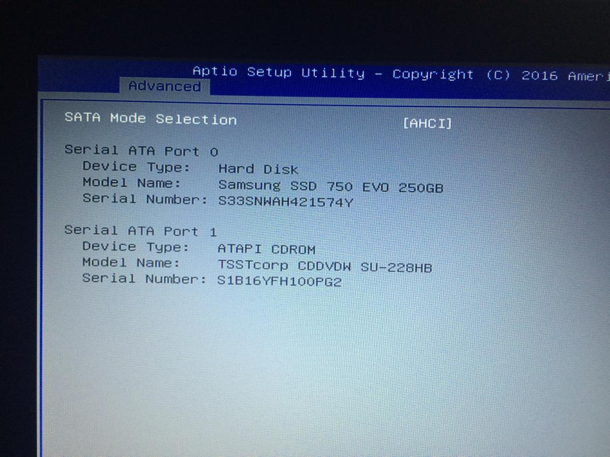

gengik84 Posted May 27, 2016 Share Posted May 27, 2016 con il kext allegato quindi il touchpad non funziona? Per i dischi, controlla sul bios di aver impostato in modalità ahci Link to comment https://www.insanelymac.com/forum/topic/312335-installare-el-capitan-su-asus-x556u/page/2/#findComment-2240646 Share on other sites More sharing options...
Centinho Posted May 27, 2016 Author Share Posted May 27, 2016 Il touchpad non funziona, il BIOS è settato così, non va bene? Nel verbose per l'hard disk dà questo problema: IOAHCIBlockStorageDriver: could not recover SATA HDD after 5 attemps, terminating Link to comment https://www.insanelymac.com/forum/topic/312335-installare-el-capitan-su-asus-x556u/page/2/#findComment-2240651 Share on other sites More sharing options...
