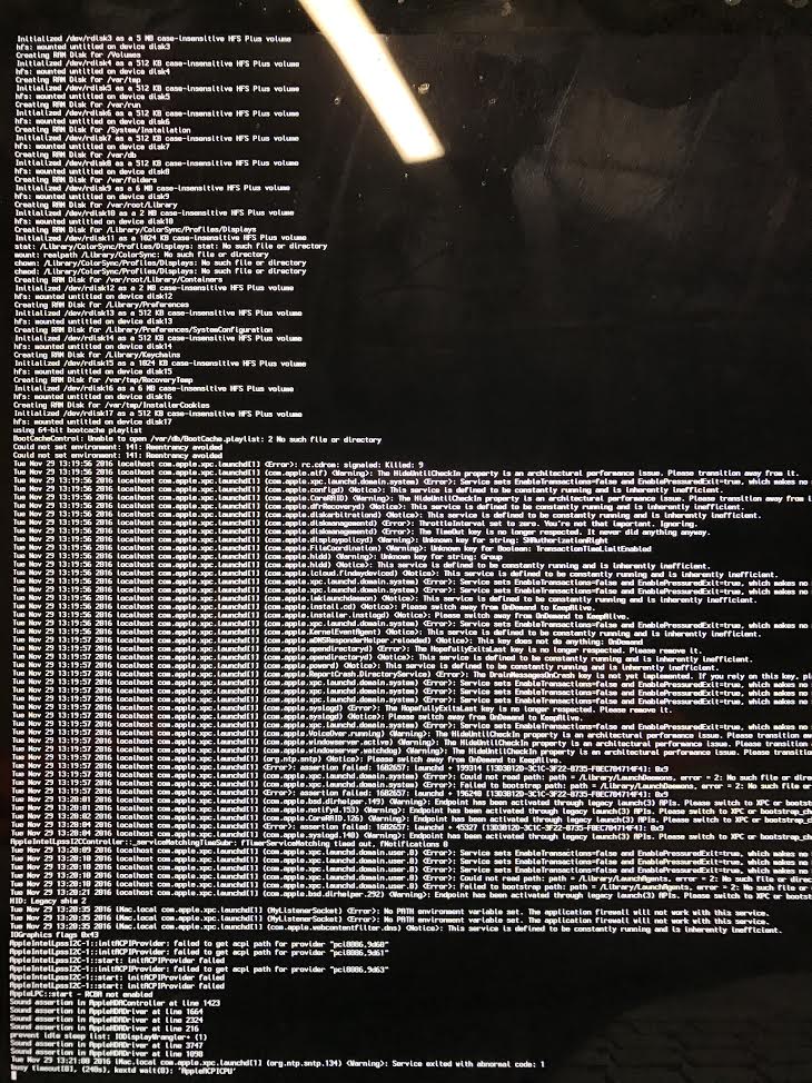

cydia2020 Posted November 30, 2016 Author Share Posted November 30, 2016 Hey smart people, I am trying to follow this guide which would definitely solve some big issues for me (mainly the annoyance of carrying around 2 laptops). I thought I followed the guide pretty well but obviously I missed something important because I keep getting stuck at what seems to be a fairly early step. I am using 10.12 install and it seems like everything is smooth until I try to boot off of the USB. It got stuck so I ran it in verbose and no panic and got the following: Error.JPG Can anyone tell me if I'm doing something silly wrong? If you need more info from me to help please let me know! Thank you, MChernetsky Hi mchernetsky Please change the ig-platform-id to 12345678 in clover settings (Graphics Injection)for this issue, and change it back after you installed the framebuffer kext. BTW, why not using bootcamp on your Mac? Thanks. 1 Link to comment Share on other sites More sharing options...
mchernetsky Posted November 30, 2016 Share Posted November 30, 2016 Hi mchernetsky Please change the ig-platform-id to 12345678 in clover settings (Graphics Injection)for this issue, and change it back after you installed the framebuffer kext. BTW, why not using bootcamp on your Mac? Thanks. Thank you! I'm going to test that out asap. Well, I don't know why I didn't do boot camp but I am using Parallels Desktop for my Windows VM. I like the hardware for Surface Book better and would rather sell my over priced MacBook Pro Retina. I guess I'm looking to this solution because my last 2 MacBooks cost me $2800 each. Best Regards, MChernetsky Link to comment Share on other sites More sharing options...
cydia2020 Posted November 30, 2016 Author Share Posted November 30, 2016 Thank you! I'm going to test that out asap. Well, I don't know why I didn't do boot camp but I am using Parallels Desktop for my Windows VM. I like the hardware for Surface Book better and would rather sell my over priced MacBook Pro Retina. I guess I'm looking to this solution because my last 2 MacBooks cost me $2800 each. Best Regards, MChernetsky In fact, I never used MacBook before, but I heard that parallel windows thing. Please try that inject id, it should works Sorry I missed that in the post, I already edited it. Thanks Link to comment Share on other sites More sharing options...
mchernetsky Posted November 30, 2016 Share Posted November 30, 2016 In fact, I never used MacBook before, but I heard that parallel windows thing. Please try that inject id, it should works Sorry I missed that in the post, I already edited it. Thanks Well, I think I got passed the previous error but now I'm running into something new. Nevermind, started from scratch on the walkthough and it worked this time. Thanks again for all your help! Any ideas? Best Regards, MChernetsky Link to comment Share on other sites More sharing options...

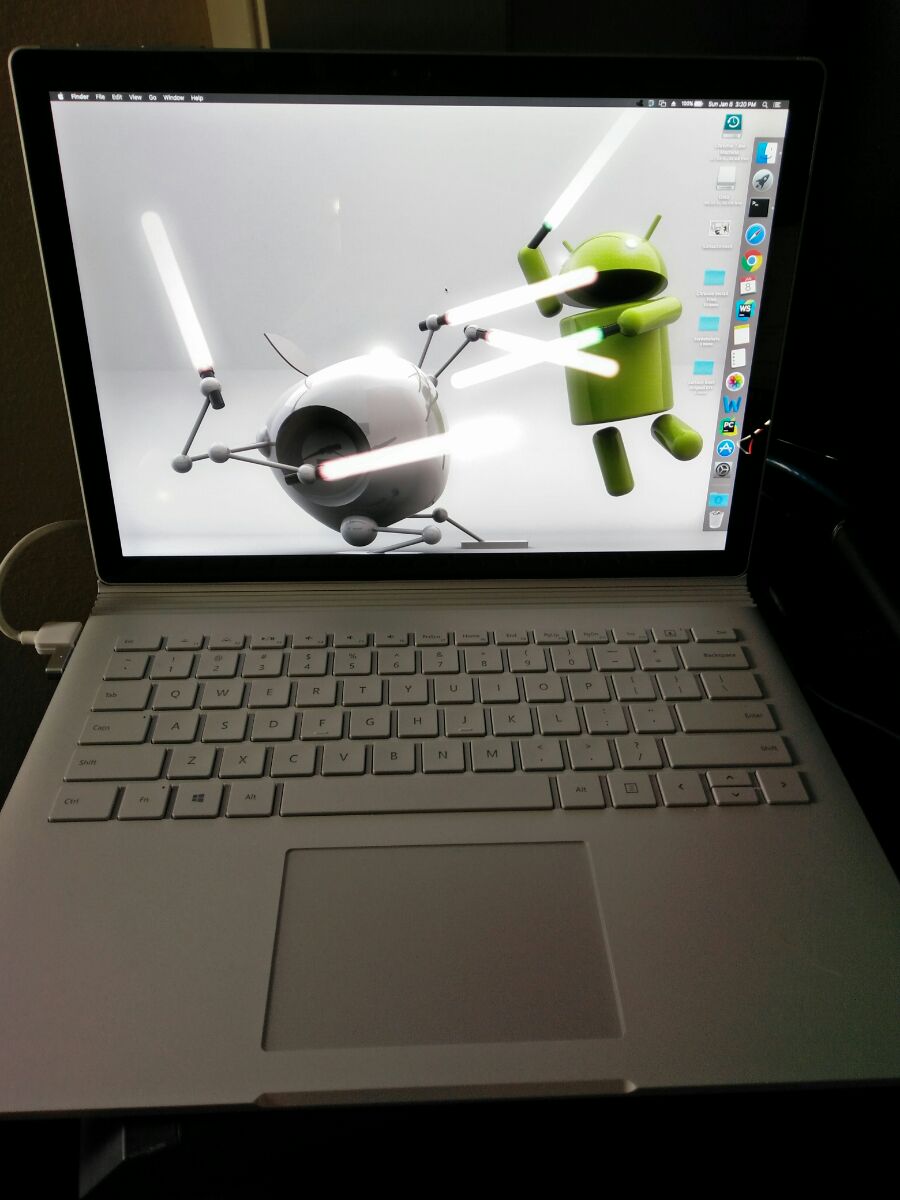

virgosun Posted December 2, 2016 Share Posted December 2, 2016 Hi Cydia2020 Thanks very much, i used your guide to get osx up and running on my surface book and i wanted to say massive thanks, i will be following this and your other pages with keen interest. i was wondering if you had any joy getting the touch and stylus up and running? i know a lot of people are working on touch at the moment and that there are a group of people working on 2ic touch devices and this doesn't include the surface book but i wasn't a 100% clear from your posts if you had the stylus working or not? i know there was some talk about inking working but it wasn't obvious to me where i should start looking to get the stylus working. again thanks very much, huge fan of your work! I come across your discuss about touch. Very interesting area in os x. I experience this with my Lenovo Yoga 15 convertible. Inking and multitouch gesture work surprisingly great. How ever as you point out, os x buttons and icons are too small and I don't have a stylus to test. So pls share any progress in supporting touch. Would we be able to request a dedicate forum for touch, like discrete graphics And pls share you success video with Surface Book. These are some image of inking and touch gesture on my Yoga 500 15 Inking: https://youtu.be/QS8gVdBITZc Touching: https://youtu.be/JEVYvdY95l0 This commend made by touch 100% Link to comment Share on other sites More sharing options...

flameshadow Posted January 10, 2017 Share Posted January 10, 2017 Hi cydia2020, Thanks to your guide, I was able to get El Capitan installed on my Surface Book working [nearly] flawlessly. In your video, you mentioned the Surface Dock ethernet not working. I have the brick version of the dock and I can confirm that the ethernet isn't detected; whereas, on my Surface Pro 3 Hackintosh it works fine. Do you have any recommendations on getting trackpad gestures and/or scrolling working? Link to comment Share on other sites More sharing options...
