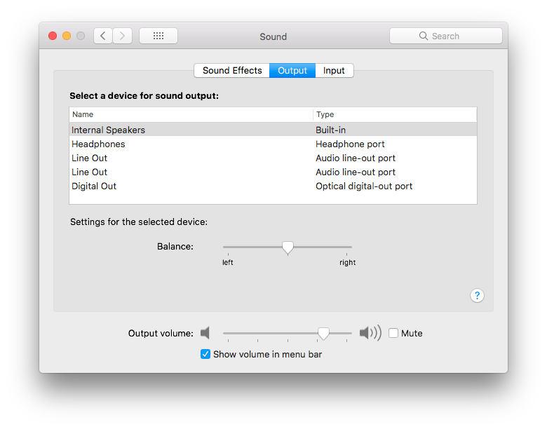

wern apfel Posted November 19, 2017 Share Posted November 19, 2017 Sorry for pinging again just want to see if there's anyone who's managed to achieve manual speaker/headphone selection for ALC1220. Layout 11 with AppleALC works brilliantly but would like to remove the auto sense. You can try this little applet, it should work with the most realtek codecs. ALCAudioSwitcher.zip If you prefer to use the Apple menu, I can make an new layout for you. Link to comment https://www.insanelymac.com/forum/topic/311293-applealc-%E2%80%94-dynamic-applehda-patching/page/75/#findComment-2536984 Share on other sites More sharing options...
toleda Posted November 19, 2017 Share Posted November 19, 2017 want to see if there's anyone who's managed to achieve manual speaker/headphone selection for ALC1220. Following procedure applies to 1220/PlatformsT.xml.zlib/PathMapID: 900 (layout 1): 3. Manual Internal Speaker and Headphone Selection - Displays both Internal Speaker and Headphones audio output devices. Note: An existing audio output device must be deleted to add Headphones as an audio output device. Edit Platforms.xml/zml Open Item/PathMapID Verify PathMapID Copy the current speaker/headphone (Item 2) Paste the current speaker/headphone so there are two of the same (Item 0 and 3) Drag Item 2 up to PathMap - 2 times (moves new item to correct position) In Item 2, open next level and there are Item 0 and Item 1; delete Item 1 (headphones). In Item 3, open next level and there are Item 0 and Item 1; delete Item 0 (speakers). Edit this path map as follows: Current Item 0/NodeID/Number/27 Item 1/NodeID/Number/12 Item 2/NodeID/Number/2 New: Item 0/NodeID/Number/27 Item 1/NodeID/Number/38 Item 2/NodeID/Number/37 Save, install and restart. Technique removes Headphone detect and switching. Can be adapted to other PathMaps. 5 Link to comment https://www.insanelymac.com/forum/topic/311293-applealc-%E2%80%94-dynamic-applehda-patching/page/75/#findComment-2536988 Share on other sites More sharing options...
magnificentflamingo Posted November 19, 2017 Share Posted November 19, 2017 Following procedure applies to 1220/PlatformsT.xml.zlib/PathMapID: 900 (layout 1): 3. Manual Internal Speaker and Headphone Selection - Displays both Internal Speaker and Headphones audio output devices. Note: An existing audio output device must be deleted to add Headphones as an audio output device. Edit Platforms.xml/zml Open Item/PathMapID Verify PathMapID Copy the current speaker/headphone (Item 2) Paste the current speaker/headphone so there are two of the same (Item 0 and 3) Drag Item 2 up to PathMap - 2 times (moves new item to correct position) In Item 2, open next level and there are Item 0 and Item 1; delete Item 1 (headphones). In Item 3, open next level and there are Item 0 and Item 1; delete Item 0 (speakers). Edit this path map as follows: Current Item 0/NodeID/Number/27 Item 1/NodeID/Number/12 Item 2/NodeID/Number/2 New: Item 0/NodeID/Number/27 Item 1/NodeID/Number/38 Item 2/NodeID/Number/37 Save, install and restart. Technique removes Headphone detect and switching. Can be adapted to other PathMaps. so after a lot of scratching my head trying to understand what you were trying to say in that documentation based on what's in PlatformsT.xml.zlib, I finallyyyyyy managed to get the manual selection working :D thanks so much everyone for helping me <3 you all have incredible patience 1 Link to comment https://www.insanelymac.com/forum/topic/311293-applealc-%E2%80%94-dynamic-applehda-patching/page/75/#findComment-2537090 Share on other sites More sharing options...
ammoune78 Posted November 19, 2017 Share Posted November 19, 2017 so after a lot of scratching my head trying to understand what you were trying to say in that documentation based on what's in PlatformsT.xml.zlib, I finallyyyyyy managed to get the manual selection working :D thanks so much everyone for helping me <3 you all have incredible patience You're welcome my MAN, i'm a simple user, but here there are masters that can help people, you was with Mr Toleda 2 Link to comment https://www.insanelymac.com/forum/topic/311293-applealc-%E2%80%94-dynamic-applehda-patching/page/75/#findComment-2537099 Share on other sites More sharing options...
