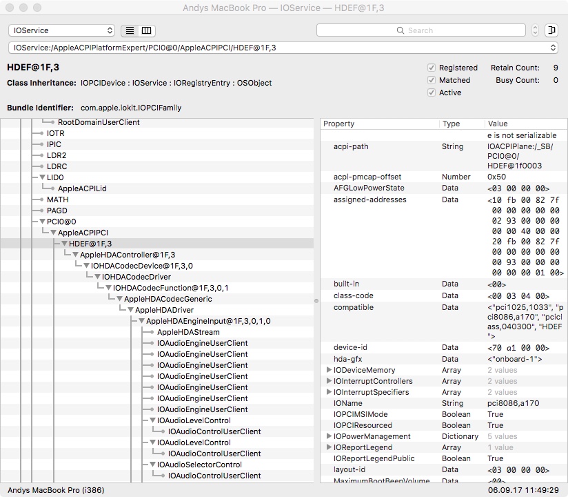

Hi,
I have a little problem with my Hackintosh: Audio is working perfect but if I change the audio output to internal and I reboot it changes back to headphones, why is that ?
Thanks !
I have no HDMI Audio please Help me :-/
only Hotpatched DSDT over Clover (See config.plist) everything is working great  except HDMI-Audio

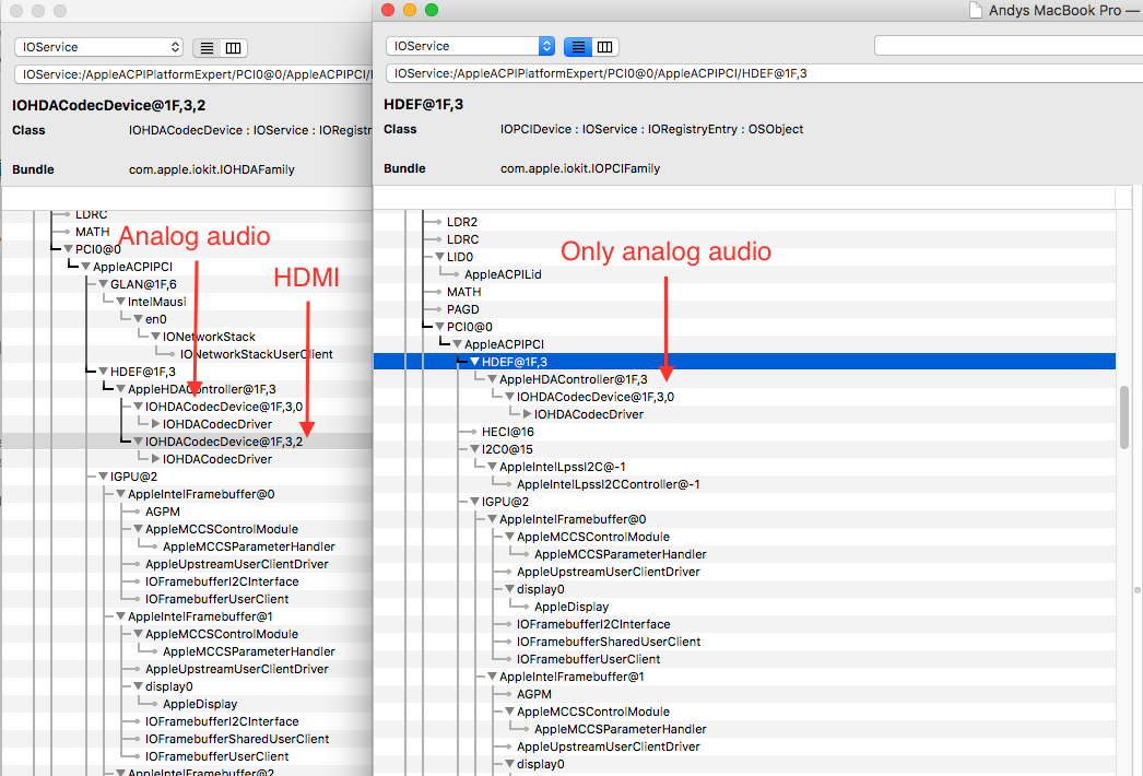

You don't even have HDMI device. Left - mine devices, right - yours...
Probably your HDMI audio connected to discrette graphics card. In that case you can't make it work...

Probable your HDMI audio connected to discrette graphics card. In that case you can't make it work...

Sorry but i don't know. I have same issue on Acer Swift 3 with single Intel HD620 and without discrette graphics at all.
Because either your DSDT or the config.plist is missing the necessary Inject to provide the HDMI-Info to OSX.
Even without necessary inject it should be in ioreg as secondary device in HDEF!!! But in this case it is absent. There is no dedicated HDAU device on Skylake/Kaby Lake.
i added addHDMI80000 in Clover now my IOreg shows this
Useless fix for IGPU HDMI audio. As i told earlier there is no dedicated HDAU device on Skylake/Kaby Lake boards. Intel HDMI audio works through HDEF. Analog audio adress - 1F,3 and HDMI audio adress - 1F,3,2. Both on HDEF. You don't have 1F,3,2 though your HDMI audio didn't work.

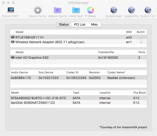

Plz help! I've spent weeks on this but I still can't get applealc working
what I have done:
1. Inject layout-id and hda-gfx into ssdt. can be verified by checking "system information" -> "Audio" and IOReg tool (see attached), or system extracted ACPI Table
2. it's a clean install so there's no residue from previous modification left (and i checked applehda signing made sure it was untouched)
3. both lilu and applealc are the latest debug release, and located within Clover/Kext/Other folder
4. made sure in my dsdt file, the audio device is named HDEF.
5. I didn't rename HDMI audio to HDAU in my dsdt, thought it would be easier to deal with one first.
6. I extracted my audio card codec and added support for it my self, and compiled against the latest code, same result.
kextstat |egrep '(ALC|Lilu|HDA)'
   25    6 0xffffff7f8273a000 0x61000    0x61000    as.vit9696.Lilu (1.1.7) EEDE488C-8AF6-3654-AD54-9B718FB61DAA <7 5 4 3 2 1>
   28    0 0xffffff7f827a4000 0xae000    0xae000    as.vit9696.AppleALC (1.1.4) 9FAACF48-233A-3128-A075-95527FAB70B5 <25 7 5 4 3 2 1>
  108    1 0xffffff7f825e0000 0xc000     0xc000     com.apple.iokit.IOHDAFamily (279.48) E332A19C-33F1-3F25-B9FC-982F769BF17A <5 4 3 1>
  109    0 0xffffff7f825ef000 0x1d000    0x1d000    com.apple.driver.AppleHDAController (279.48) ED51F180-19C8-3DE1-AF81-0E389D98ADDE <108 107 45 12 7 6 5 4 3 1>
the problem: no codec is recognized, and AppleHDA is not loading. (DPCIManager codec id is blank)
what's attached:
1. my logs
2. ioreg
3. clover config
4. codec dump
5. my own  config/pathmap
Archive.zip
