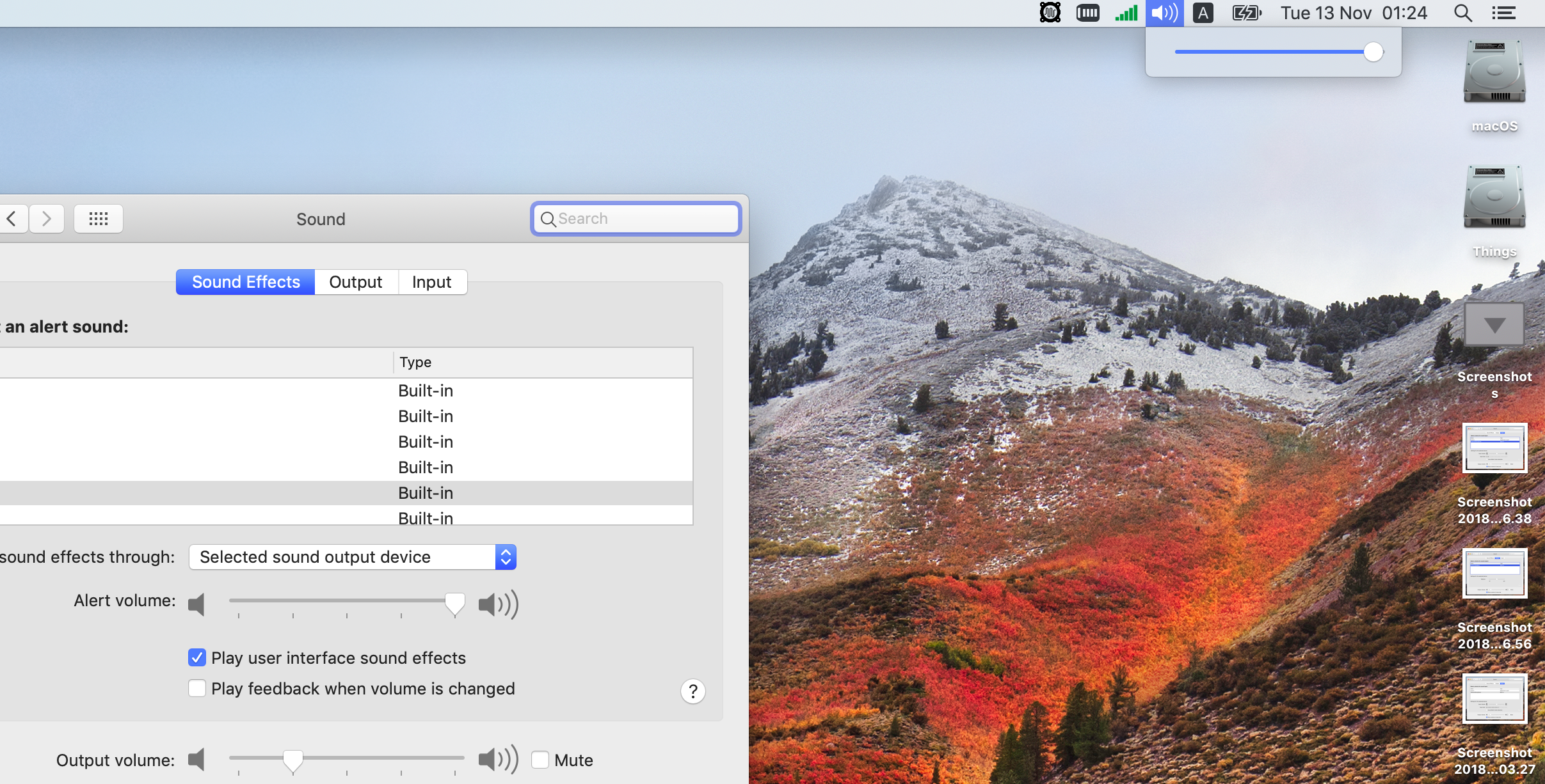

Justin Spier Posted November 12, 2018 Share Posted November 12, 2018 @Andres ZeroCross First of all, Thank you so much for your hard work And now the result: 1. The first one: I have sound on both Int Speaker and Headphone, And automatic switch from int to ext works correctly. But there is a small problem in int speaker: The volume slider doesn't work properly, hard to explain; Just see the screenshot: 2. The second one: I have sound only on Headphone. --- IOReg output of both attached. --- And now a question: What about HDMI audio? Should it be enable by this kext? or need more workaround? troubleshooting.zip Link to comment https://www.insanelymac.com/forum/topic/311293-applealc-%E2%80%94-dynamic-applehda-patching/page/120/#findComment-2647285 Share on other sites More sharing options...

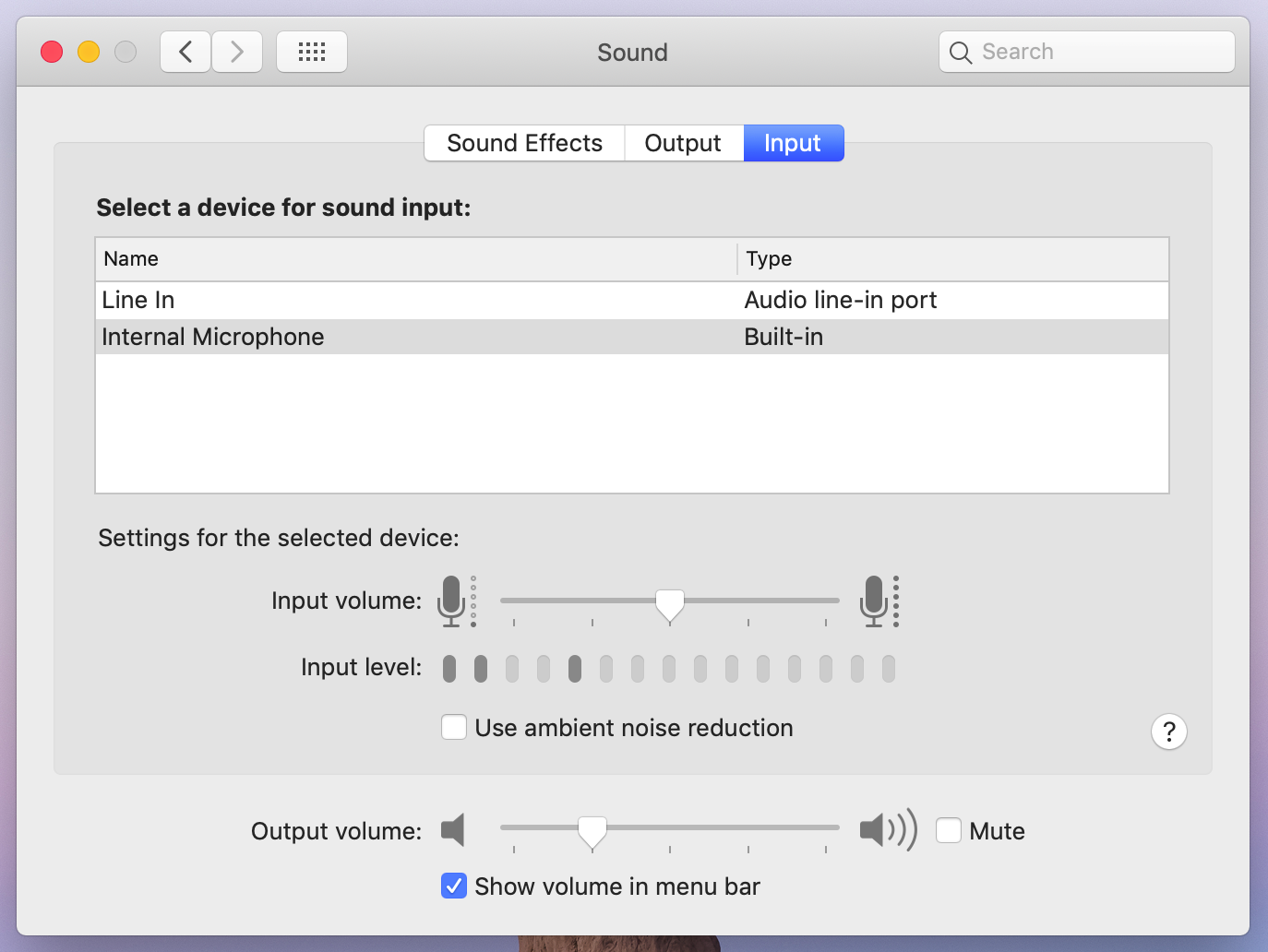

Justin Spier Posted November 13, 2018 Share Posted November 13, 2018 16 hours ago, Andres ZeroCross said: Now use this kexts,,, slider problem should be fixed. Let me know for the result AppleALC.kext.zip You are a Hero Now the volume slider works properly too. And about Mic; It records a little noisy I think, Not sure, Or maybe influenced by fan noise?!! Cause there is no noise on my words that I say in mic; Just a little noise in background. And one thing else; should it be like this? No difference whether the headphone connected or not, It's like the screenshot in both state. Link to comment https://www.insanelymac.com/forum/topic/311293-applealc-%E2%80%94-dynamic-applehda-patching/page/120/#findComment-2647397 Share on other sites More sharing options...
Andres ZeroCross Posted November 13, 2018 Share Posted November 13, 2018 7 minutes ago, Justin Spier said: You are a Hero Now the volume slider works properly too. And about Mic; It records a little noisy I think, Not sure, Or maybe influenced by fan noise?!! Cause there is no noise on my words that I say in mic; Just a little noise in background. And one thing else; should it be like this? No difference whether the headphone connected or not, It's like the screenshot in both state. Yes,, for Internal Mic and External mic i set no for jack sense. It's independent to choice internal or external mic. Try to tick "use ambient noise reductions". And how about wake from sleep?? Is audio still working?? If all is good then i will ask @vandroiy2012 to add my resource files for CX8150 to Github Link to comment https://www.insanelymac.com/forum/topic/311293-applealc-%E2%80%94-dynamic-applehda-patching/page/120/#findComment-2647401 Share on other sites More sharing options...
Justin Spier Posted November 13, 2018 Share Posted November 13, 2018 1 hour ago, Andres ZeroCross said: Yes,, for Internal Mic and External mic i set no for jack sense. It's independent to choice internal or external mic. Try to tick "use ambient noise reductions". And how about wake from sleep?? Is audio still working?? If all is good then i will ask @vandroiy2012 to add my resource files for CX8150 to Github I activated "use ambient noise reductions" and now ... there isn't any noise And yes, I have audio after wake, and without installing CodecCommander, I thought it's always necessary, isn't?!! Link to comment https://www.insanelymac.com/forum/topic/311293-applealc-%E2%80%94-dynamic-applehda-patching/page/120/#findComment-2647426 Share on other sites More sharing options...

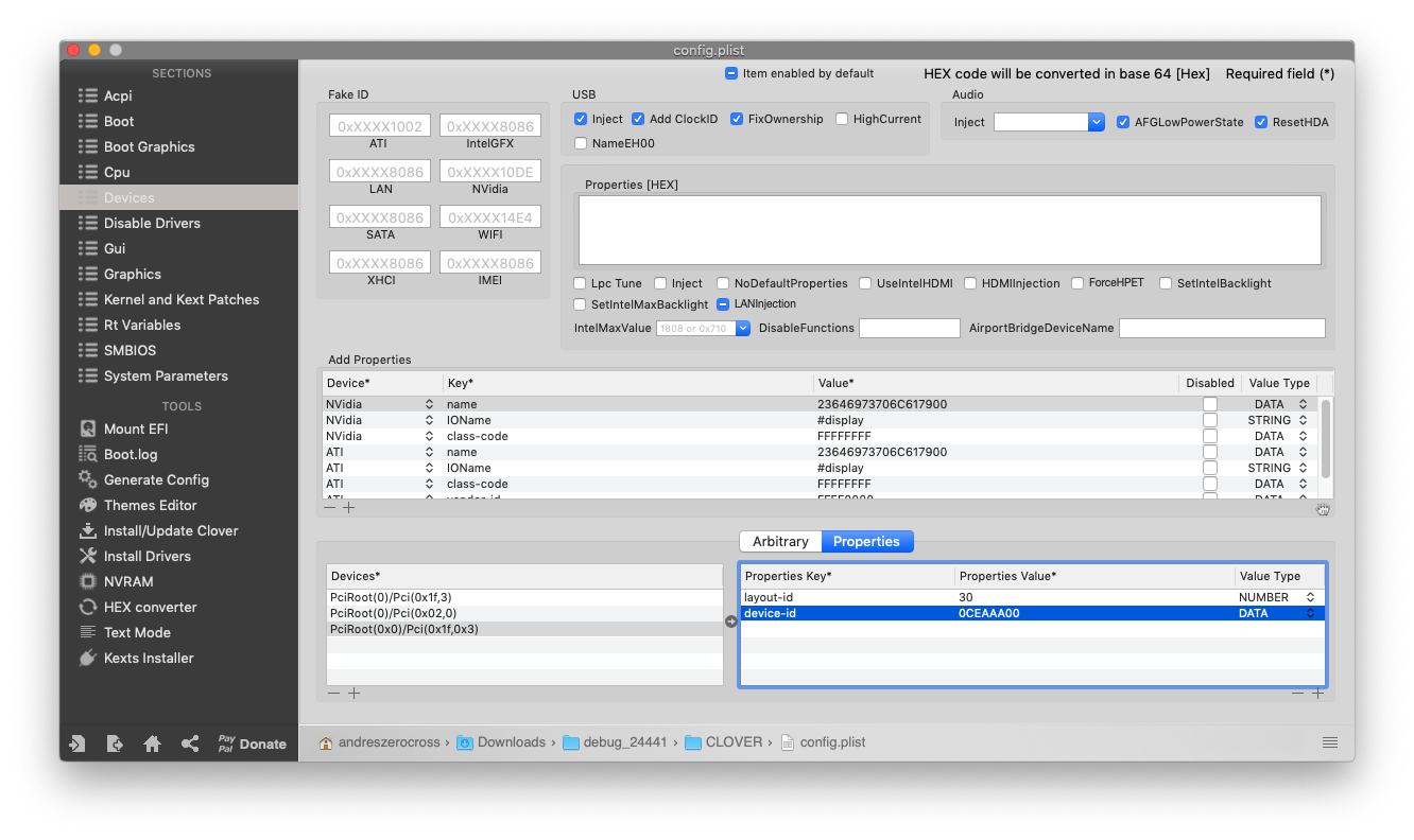

Andres ZeroCross Posted November 17, 2018 Share Posted November 17, 2018 (edited) 12 minutes ago, lunaoso said: I have my specs in my signature. Am I missing anything that I should add? 1. You should put your additional kext to EFI/CLOVER/Kexts other, except for Bluetooth kexts (just to make easy when another problem is happened) 2. You must set your Device-id of your HDEF to SkyLake's HDEF. You can add this properties to _DSM of HDEF in your DSDT or SSDT. THis is device id of SkyLake's HDEF "device-id", Buffer (0x04) { 0x70, 0xA1, 0x00, 0x00 }, or you can set it too to Devices/Properties/PciRoot(0x0)/Pci(0x1f, 0x3)/ Try this Config.plist,, replace the old ones. Post the result.. Sorry for bad english config.plist Edited November 17, 2018 by Andres ZeroCross Link to comment https://www.insanelymac.com/forum/topic/311293-applealc-%E2%80%94-dynamic-applehda-patching/page/120/#findComment-2648204 Share on other sites More sharing options...
lunaoso Posted November 17, 2018 Share Posted November 17, 2018 1 hour ago, Andres ZeroCross said: 1. You should put your additional kext to EFI/CLOVER/Kexts other, except for Bluetooth kexts (just to make easy when another problem is happened) 2. You must set your Device-id of your HDEF to SkyLake's HDEF. You can add this properties to _DSM of HDEF in your DSDT or SSDT. THis is device id of SkyLake's HDEF "device-id", Buffer (0x04) { 0x70, 0xA1, 0x00, 0x00 }, or you can set it too to Devices/Properties/PciRoot(0x0)/Pci(0x1f, 0x3)/ Try this Config.plist,, replace the old ones. Post the result.. Sorry for bad english config.plist Thanks for the help! So setting the device-id of my HDEF to Skylake's got me audio at least. The devices are recognized by the OS, but everything is distorted. I've tried some different layout-ids but they seem to all be distorted. Any idea on how to fix that? And just out of curiosity, why did you recommend Skylake's HDEF when my CPU is Coffee Lake? Just trying to somewhat learn what is going on/how to better debug for myself in the future. Link to comment https://www.insanelymac.com/forum/topic/311293-applealc-%E2%80%94-dynamic-applehda-patching/page/120/#findComment-2648208 Share on other sites More sharing options...
Andres ZeroCross Posted November 17, 2018 Share Posted November 17, 2018 1 minute ago, lunaoso said: Thanks for the help! So setting the device-id of my HDEF to Skylake's got me audio at least. The devices are recognized by the OS, but everything is distorted. I've tried some different layout-ids but they seem to all be distorted. Any idea on how to fix that? And just out of curiosity, why did you recommend Skylake's HDEF when my CPU is Coffee Lake? Just trying to somewhat learn what is going on/how to better debug for myself in the future. Maybe for the first step you can try to tick this options at Device Sections (Open your config.plist with Clover Configurator) Link to comment https://www.insanelymac.com/forum/topic/311293-applealc-%E2%80%94-dynamic-applehda-patching/page/120/#findComment-2648209 Share on other sites More sharing options...
lunaoso Posted November 17, 2018 Share Posted November 17, 2018 (edited) 6 minutes ago, Andres ZeroCross said: Maybe for the first step you can try to tick this options at Device Sections (Open your config.plist with Clover Configurator) Didn't seem like that changed anything. If it helps, it sounds like vocals are very quiet. And then the music is distorted. EDIT: Also if you want me to post any logs or anything like that, let me know. Edited November 17, 2018 by lunaoso Link to comment https://www.insanelymac.com/forum/topic/311293-applealc-%E2%80%94-dynamic-applehda-patching/page/120/#findComment-2648211 Share on other sites More sharing options...

Andres ZeroCross Posted November 17, 2018 Share Posted November 17, 2018 7 minutes ago, lunaoso said: I still have my kexts in /L/E because I haven't had to mess with those yet anyway, but I included them in the debug zip so you can take a look at what's there. Also, doing a cold boot unfortunately did not make a difference. debug_24441.zip Why did you put this value??? My solution before is to use "70A10000" Link to comment https://www.insanelymac.com/forum/topic/311293-applealc-%E2%80%94-dynamic-applehda-patching/page/120/#findComment-2648217 Share on other sites More sharing options...
lunaoso Posted November 17, 2018 Share Posted November 17, 2018 6 minutes ago, Andres ZeroCross said: Why did you put this value??? My solution before is to use "70A10000" I grabbed the base64 encoded version from the config.plist and messed up copying it over, my bad. I've edited it back to be the correct value. Didn't seem to fix anything though unfortunately. Same problems as before. config.plist Link to comment https://www.insanelymac.com/forum/topic/311293-applealc-%E2%80%94-dynamic-applehda-patching/page/120/#findComment-2648220 Share on other sites More sharing options...
