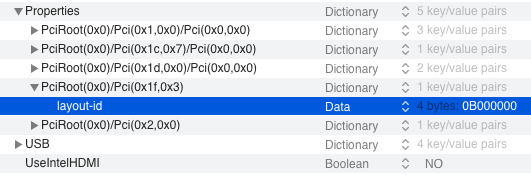

ctich Posted November 21, 2018 Share Posted November 21, 2018 @insanelyDeepak hello, need to do like this: 1 Link to comment https://www.insanelymac.com/forum/topic/311293-applealc-%E2%80%94-dynamic-applehda-patching/page/122/#findComment-2648869 Share on other sites More sharing options...
insanelyDeepak Posted November 21, 2018 Share Posted November 21, 2018 2 hours ago, ctich said: @insanelyDeepak hello, need to do like this: i'm not trying to inject layout-id , doing no-controller-inject and injected properties seems fine , but result isn't expected Link to comment https://www.insanelymac.com/forum/topic/311293-applealc-%E2%80%94-dynamic-applehda-patching/page/122/#findComment-2648912 Share on other sites More sharing options...

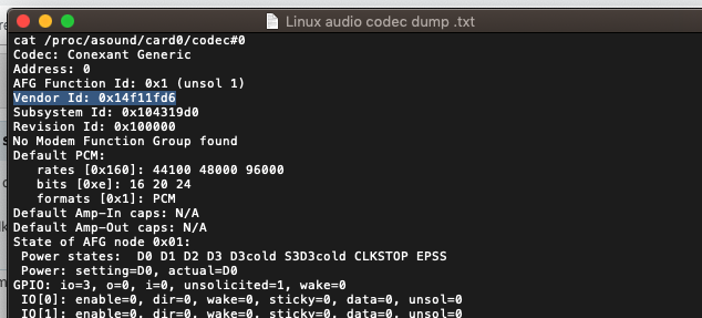

devillived666 Posted November 21, 2018 Share Posted November 21, 2018 Hey guys, I've got an Asus s405ua(site lists as x405ua for driver downloads. I tried windows hardware id and then Linux codec dump to get the codec but cannot find. Driver shows as conexant generic . Looked at similar models that have been hacked and see that they mainly use conexant 8050. I'm trying to use this but am probably not doing config. plist correctly. I'd like to verify if indeed I should be treating my audio device as conexant 8050 so I can try all available IDs.I have attached codec dump text from Linux. I'm hoping somebody can better interpret it better than I did. Txt is here because Tapatalk won't let me upload it https://docs.google.com/document/d/1Cjnsxp87ogelb6RGmT5748pawOs-QWVnuIsioVIa2Dg/edit?usp=drivesdkSent from my Pixel using Tapatalk Link to comment https://www.insanelymac.com/forum/topic/311293-applealc-%E2%80%94-dynamic-applehda-patching/page/122/#findComment-2648934 Share on other sites More sharing options...
Andres ZeroCross Posted November 21, 2018 Share Posted November 21, 2018 Hey guys, I've got an Asus s405ua(site lists as x405ua for driver downloads. I tried windows hardware id and then Linux codec dump to get the codec but cannot find. Driver shows as conexant generic . Looked at similar models that have been hacked and see that they mainly use conexant 8050. I'm trying to use this but am probably not doing config. plist correctly. I'd like to verify if indeed I should be treating my audio device as conexant 8050 so I can try all available IDs.I have attached codec dump text from Linux. I'm hoping somebody can better interpret it better than I did. Txt is here because Tapatalk won't let me upload it https://docs.google.com/document/d/1Cjnsxp87ogelb6RGmT5748pawOs-QWVnuIsioVIa2Dg/edit?usp=drivesdkSent from my Pixel using TapatalkWhy did you upload the txt to google drive and make someone to ask permission first to download the txt file??Sent from my Mi Note 2 using Tapatalk Link to comment https://www.insanelymac.com/forum/topic/311293-applealc-%E2%80%94-dynamic-applehda-patching/page/122/#findComment-2648938 Share on other sites More sharing options...
devillived666 Posted November 21, 2018 Share Posted November 21, 2018 48 minutes ago, Andres ZeroCross said: Why did you upload the txt to google drive and make someone to ask permission first to download the txt file?? Sent from my Mi Note 2 using Tapatalk Hey sir, I did it from my phone and the mobile version didn't give me much option in regards to sharing. I'm on my laptop now so Ill put it below: Linux audio codec dump .txt Link to comment https://www.insanelymac.com/forum/topic/311293-applealc-%E2%80%94-dynamic-applehda-patching/page/122/#findComment-2648954 Share on other sites More sharing options...
Andres ZeroCross Posted November 21, 2018 Share Posted November 21, 2018 This is CX8150,,, i already make new resource for this ones https://github.com/acidanthera/AppleALC/tree/master/Resources/CX8150 Use layoutid = 21 Link to comment https://www.insanelymac.com/forum/topic/311293-applealc-%E2%80%94-dynamic-applehda-patching/page/122/#findComment-2648958 Share on other sites More sharing options...
ctich Posted November 21, 2018 Share Posted November 21, 2018 1 hour ago, insanelyDeepak said: i'm not trying to inject layout-id , doing no-controller-inject and injected properties seems fine , but result isn't expected Attach ioreg. If you want to add a property for a video card, then you need to inject it on HDAU video cards and not on HDEF. Link to comment https://www.insanelymac.com/forum/topic/311293-applealc-%E2%80%94-dynamic-applehda-patching/page/122/#findComment-2648960 Share on other sites More sharing options...
Andres ZeroCross Posted November 21, 2018 Share Posted November 21, 2018 26 minutes ago, devillived666 said: Hey sir, I did it from my phone and the mobile version didn't give me much option in regards to sharing. I'm on my laptop now so Ill put it below: Linux audio codec dump .txt This prebuilt ones,, There is no release version yet for CX8150. Link to comment https://www.insanelymac.com/forum/topic/311293-applealc-%E2%80%94-dynamic-applehda-patching/page/122/#findComment-2648964 Share on other sites More sharing options...
devillived666 Posted November 21, 2018 Share Posted November 21, 2018 36 minutes ago, Andres ZeroCross said: This prebuilt ones,, There is no release version yet for CX8150. Thanks. So my codec is 8150? Which ID should I inject? Link to comment https://www.insanelymac.com/forum/topic/311293-applealc-%E2%80%94-dynamic-applehda-patching/page/122/#findComment-2648978 Share on other sites More sharing options...

insanelyDeepak Posted November 22, 2018 Share Posted November 22, 2018 9 hours ago, ctich said: Attach ioreg. If you want to add a property for a video card, then you need to inject it on HDAU video cards and not on HDEF. now that's the point Deepak’s iMac.ioreg Link to comment https://www.insanelymac.com/forum/topic/311293-applealc-%E2%80%94-dynamic-applehda-patching/page/122/#findComment-2649054 Share on other sites More sharing options...
Andres ZeroCross Posted November 22, 2018 Share Posted November 22, 2018 2 hours ago, insanelyDeepak said: now that's the point Deepak’s iMac.ioreg Can you share your issue to me. Honestly, i don't know detail of your issue Link to comment https://www.insanelymac.com/forum/topic/311293-applealc-%E2%80%94-dynamic-applehda-patching/page/122/#findComment-2649061 Share on other sites More sharing options...
