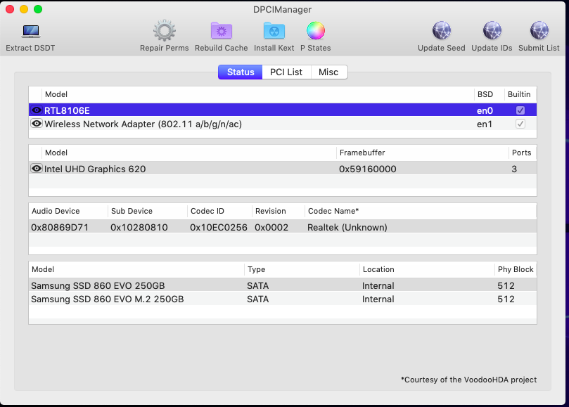

matgeo Posted November 10, 2018 Share Posted November 10, 2018 (edited) Hi! I'm facing an audio problem both on High Sierra and Mojave , with my Kabylake-r Dell 5570. Audio codec is alc256 , using applealc and codeccommander.kext. First problem is that if I inject layout-id 13 or 56 then after wake from sleep cpu stays at 100%. If I use layout 11 then it is ok. Second problem is that with all the layouts I don't have audio from headphones. Can you help me ? Y.G. Can you take a look at my i2c trackpad (saw that you an make improvments) or anything else needs optimising ? 5570.ioreg Terminal Saved Output.txt CLOVER.zip Edited November 10, 2018 by matgeo Link to comment https://www.insanelymac.com/forum/topic/311293-applealc-%E2%80%94-dynamic-applehda-patching/page/118/#findComment-2646803 Share on other sites More sharing options...

Andres ZeroCross Posted November 10, 2018 Share Posted November 10, 2018 18 minutes ago, matgeo said: Hi! I'm facing an audio problem both on High Sierra and Mojave , with my Kabylake-r Dell 5570. Audio codec is alc256 , using applealc and codeccommander.kext. First problem is that if I inject layout-id 13 or 56 then after wake from sleep cpu stays at 100%. If I use layout 11 then it is ok. Second problem is that with all the layouts I don't have audio from headphones. Can you help me ? Y.G. Can you take a look at my i2c trackpad (saw that you an make improvments) or anything else needs optimising ? 5570.ioreg Terminal Saved Output.txt CLOVER.zip 1. Then just use layoutid = 11 2. There is patch with DSDT/SSDT + CodecCommander for ALC256. I post it above, just scroll above and try to use it About trackpad,,, there is no problem then there is no fix. And this discussion is about AppleALC.kext Link to comment https://www.insanelymac.com/forum/topic/311293-applealc-%E2%80%94-dynamic-applehda-patching/page/118/#findComment-2646807 Share on other sites More sharing options...
matgeo Posted November 10, 2018 Share Posted November 10, 2018 In the patch you are reffering there are 3 files : dsdt.aml , ssdt0.aml and ssdt1.aml. Which one should I use ? Will this work , using dsdt/ssdt from another computer ? Link to comment https://www.insanelymac.com/forum/topic/311293-applealc-%E2%80%94-dynamic-applehda-patching/page/118/#findComment-2646811 Share on other sites More sharing options...

matgeo Posted November 10, 2018 Share Posted November 10, 2018 Sorry , I misunderstood. Where can I find the patch ? Link to comment https://www.insanelymac.com/forum/topic/311293-applealc-%E2%80%94-dynamic-applehda-patching/page/118/#findComment-2646814 Share on other sites More sharing options...
Andres ZeroCross Posted November 10, 2018 Share Posted November 10, 2018 Sorry , I misunderstood. Where can I find the patch ? Patch for what??? I write the answer for your problem. Just try itSent from my Mi Note 2 using Tapatalk Link to comment https://www.insanelymac.com/forum/topic/311293-applealc-%E2%80%94-dynamic-applehda-patching/page/118/#findComment-2646815 Share on other sites More sharing options...
matgeo Posted November 10, 2018 Share Posted November 10, 2018 You wrote " 2. There is patch with DSDT/SSDT + CodecCommander for ALC256. I post it above, just scroll above and try to use it". I can't find where you posted it. Link to comment https://www.insanelymac.com/forum/topic/311293-applealc-%E2%80%94-dynamic-applehda-patching/page/118/#findComment-2646817 Share on other sites More sharing options...
Andres ZeroCross Posted November 10, 2018 Share Posted November 10, 2018 2 hours ago, Andres ZeroCross said: It's another problem,, it will need "codec_dump.txt" from your audio codec since resource at GITHUB for ALC256 is for Dell and asus device. Just change value of alc-layout-id of SSDT-1.aml "alc-layout-id", Buffer (0x04) { 0x0D, 0x00, 0x00, 0x00 // .... }, change,, 0x0D to HEX of layoutid at Github resource. 0x0D = 13 (decimal). Check ALC256 Available layoutID at this resource https://github.com/acidanthera/AppleALC/tree/master/Resources/ALC256 And change the value. For distorted audio you need to try ALC256 patch with CodecCommander (install CodecCommander at Library/Extensions first) And put this code (credit to @insanelyDeepak ) inside HDEF device at SSDT-1.aml Name(RMCF, Package() { "CodecCommander", Package() { "Custom Commands", Package() { Package(){}, // signifies Array instead of Dictionary Package() { // 0x19 SET_PIN_WIDGET_CONTROL 0x24 "Command", Buffer() { 0x01, 0x97, 0x07, 0x24 }, "On Init", ">y", "On Sleep", ">n", "On Wake", ">y", }, Package() { // 0x1A SET_PIN_WIDGET_CONTROL 0x20 "Command", Buffer() { 0x01, 0xA7, 0x07, 0x20 }, "On Init", ">y", "On Sleep", ">n", "On Wake", ">y", }, Package() { // 0x21 SET_UNSOLICITED_ENABLE 0x83 "Command", Buffer() { 0x02, 0x17, 0x08, 0x83 }, "On Init", ">y", "On Sleep", ">n", "On Wake", ">y", } }, "Perform Reset", ">n", "Perform Reset on External Wake", ">n", "Send Delay", 10, "Sleep Nodes", ">n", }, }) or this ones, credit to @vbourachot Name(RMCF, Package() { "CodecCommander", Package() { "Custom Commands", Package() { Package(){}, // signifies Array instead of Dictionary Package() { // 0x19 SET_PIN_WIDGET_CONTROL 0x25 "Command", Buffer() { 0x01, 0x97, 0x07, 0x25 }, "On Init", ">y", "On Sleep", ">n", "On Wake", ">y", }, Package() { // 0x21 SET_UNSOLICITED_ENABLE 0x83 "Command", Buffer() { 0x02, 0x17, 0x08, 0x83 }, "On Init", ">y", "On Sleep", ">n", "On Wake", ">y", }, Package() { // 0x20 SET_COEF_INDEX 0x36 "Command", Buffer() { 0x02, 0x05, 0x00, 0x36 }, "On Init", ">y", "On Sleep", ">n", "On Wake", ">y", }, Package() { // 0x20 SET_PROC_COEF 0x1737 "Command", Buffer() { 0x02, 0x04, 0x17, 0x37 }, "On Init", ">y", "On Sleep", ">n", "On Wake", ">y", }, }, "Perform Reset", ">n", "Perform Reset on External Wake", ">n", // enable if using AppleALC "Send Delay", 10, "Sleep Nodes", ">n", }, }) For Touchpad,, your touchpad is not use I2C Interface,, but touchscreen is yes. You didn't answer my questions yet. Did your TOUCHSCREEN work????? your old VoodooPS2Controller.kext (for keyboard and touchpad) use VoodooPS2Controller.kext version 1.8.92, maybe you can try to put this version, and replace my VoodooP2Controller.kext at your EFI/CLOVER/Kexts/Other to enable basic function of your touchpad. This... Link to comment https://www.insanelymac.com/forum/topic/311293-applealc-%E2%80%94-dynamic-applehda-patching/page/118/#findComment-2646818 Share on other sites More sharing options...
matgeo Posted November 10, 2018 Share Posted November 10, 2018 I don't have ssdt1.aml on my system. Nevermind , looks that you are too busy to answer to all of our noob questions. Thanks for your time. Link to comment https://www.insanelymac.com/forum/topic/311293-applealc-%E2%80%94-dynamic-applehda-patching/page/118/#findComment-2646819 Share on other sites More sharing options...
Andres ZeroCross Posted November 10, 2018 Share Posted November 10, 2018 4 minutes ago, matgeo said: I don't have ssdt1.aml on my system. Nevermind , looks that you are too busy to answer to all of our noob questions. Thanks for your time. You mustn't put the patch to ssdt-1.aml. It's depend about your configurations,, you can create new one or put it in DSDT.aml. The important thing is ,, put the patch inside HDEF device. Link to comment https://www.insanelymac.com/forum/topic/311293-applealc-%E2%80%94-dynamic-applehda-patching/page/118/#findComment-2646820 Share on other sites More sharing options...
matgeo Posted November 10, 2018 Share Posted November 10, 2018 I don't think that I have the knowledge to do that. But I will give it a try , because audio from headphones is very important to me. Will try the HDEF patch. As for the other , I don't have a dsdt either. Link to comment https://www.insanelymac.com/forum/topic/311293-applealc-%E2%80%94-dynamic-applehda-patching/page/118/#findComment-2646822 Share on other sites More sharing options...
Andres ZeroCross Posted November 10, 2018 Share Posted November 10, 2018 7 minutes ago, matgeo said: I don't think that I have the knowledge to do that. But I will give it a try , because audio from headphones is very important to me. Will try the HDEF patch. As for the other , I don't have a dsdt either. Try to put this file to EFI/CLOVER/ACPI/Patched,, and reboot SSDT-ALC256.aml Link to comment https://www.insanelymac.com/forum/topic/311293-applealc-%E2%80%94-dynamic-applehda-patching/page/118/#findComment-2646825 Share on other sites More sharing options...
matgeo Posted November 10, 2018 Share Posted November 10, 2018 Wow!!! Audio working great. Thank you my friend. Can I ask something else ? Saw that you prefer installing codeccommander.kext at l/e. If I'm not wrong , latest version working from clover/oher , too? Is there any benefit for l/e ? Link to comment https://www.insanelymac.com/forum/topic/311293-applealc-%E2%80%94-dynamic-applehda-patching/page/118/#findComment-2646833 Share on other sites More sharing options...
Andres ZeroCross Posted November 10, 2018 Share Posted November 10, 2018 Wow!!! Audio working great. Thank you my friend. Can I ask something else ? Saw that you prefer installing codeccommander.kext at l/e. If I'm not wrong , latest version working from clover/oher , too? Is there any benefit for l/e ?Never tried it, for codeccommander i always installed in Library/ExtensionsSent from my Mi Note 2 using Tapatalk Link to comment https://www.insanelymac.com/forum/topic/311293-applealc-%E2%80%94-dynamic-applehda-patching/page/118/#findComment-2646834 Share on other sites More sharing options...

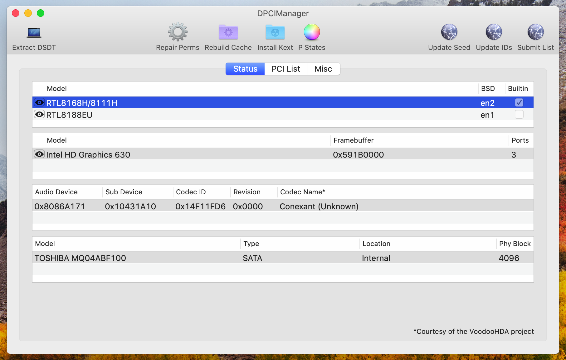

Justin Spier Posted November 11, 2018 Share Posted November 11, 2018 On 11/7/2018 at 9:09 AM, Andres ZeroCross said: 1. I need IOREG Output,, use IOREG Explorer version 2.1 not the new ones. Then upload the the output files 2. Open DPCIManager.app and take a screen shot of status menu.. and upload here Sorry for late reply. I did everything from scratch, dumped codec from arch linux, calculated pin configs, added codec and rebuilt. Here the result; Resources + IOReg: applealc_cx8150_troubleshooting.zip Screenshot: Link to comment https://www.insanelymac.com/forum/topic/311293-applealc-%E2%80%94-dynamic-applehda-patching/page/118/#findComment-2647066 Share on other sites More sharing options...
