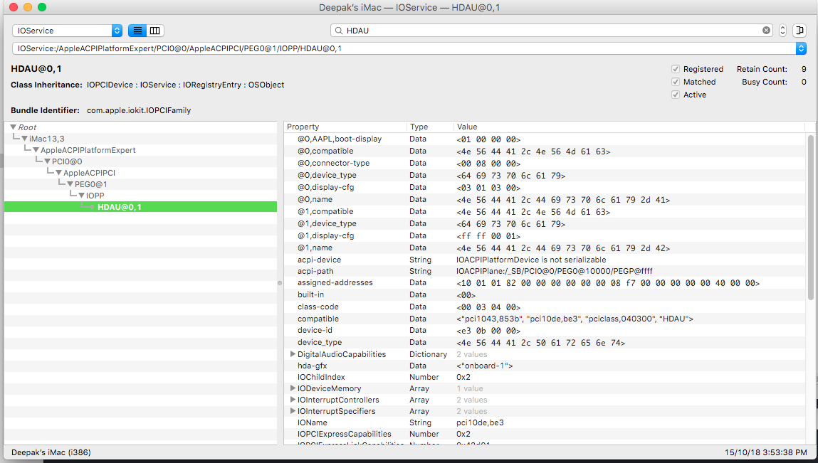

vit9696 Posted October 14, 2018 Author Share Posted October 14, 2018 18 hours ago, insanelyDeepak said: can you tell me how to disable HDAU ? my dsdt don't have HDAU device I suppose it may be differently in your DSDT. You are looking for a second device in your GPU PCI bridge. Actually, if you use a patched DSDT it is the likely cause of freezes. Another way could be running gfxutil -f HDAU from the system. It should give you the path usable with DeviceProperties. Link to comment https://www.insanelymac.com/forum/topic/311293-applealc-%E2%80%94-dynamic-applehda-patching/page/114/#findComment-2640728 Share on other sites More sharing options...

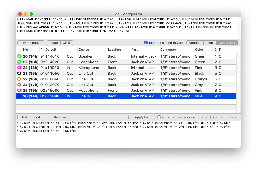

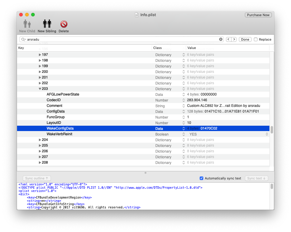

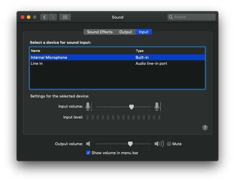

MacPeet Posted October 14, 2018 Share Posted October 14, 2018 @arsradu try this with LayoutID 15 trial_alc892_layoutID15_for_MSi_Z97S_SLI_Krait_Edition.zip with EAPD: 01471c10 01471d40 01471e11 01471f91 01470c02 01b71c20 01b71d40 01b71e21 01b71f02 01b70c02 01871c30 01871d90 01871ea1 01871f91 01571c50 01571d10 01571e01 01571f01 01671c60 01671d60 01671e01 01671f01 01771c70 01771d20 01771e01 01771f01 01971c80 01971d90 01971ea1 01971f02 01a71c90 01a71d30 01a71e81 01a71f01 Archiv.zip 1 Link to comment https://www.insanelymac.com/forum/topic/311293-applealc-%E2%80%94-dynamic-applehda-patching/page/114/#findComment-2640732 Share on other sites More sharing options...
arsradu Posted October 14, 2018 Share Posted October 14, 2018 (edited) 1 hour ago, MacPeet said: @arsradu try this with LayoutID 15 trial_alc892_layoutID15_for_MSi_Z97S_SLI_Krait_Edition.zip with EAPD: 01471c10 01471d40 01471e11 01471f91 01470c02 01b71c20 01b71d40 01b71e21 01b71f02 01b70c02 01871c30 01871d90 01871ea1 01871f91 01571c50 01571d10 01571e01 01571f01 01671c60 01671d60 01671e01 01671f01 01771c70 01771d20 01771e01 01771f01 01971c80 01971d90 01971ea1 01971f02 01a71c90 01a71d30 01a71e81 01a71f01 Archiv.zip Hii!! Thank you so much for your feedback!!! Tried Layout ID 15 and the attached files with the following results: Layout-wise, this is PERFECT! Internal Microphone in Switch Mode (Back and Front). And a Line-in. Perfect! Now, there seems to be an issue with the actual sound. Meaning I only have a functional microphone with the Back Microphone port (Pink, node 24). The Line-in (Blue, node 26) and the Front Microphone (Pink, node 25) are non functional, although, as you can see, they do show up in System Preferences. IF I'm correct and the Platforms.xml is responsible for tracing the routes from the port to the node, then my guess is that probably there is something wrong on the Platforms side. I'm just not sure what. We can use 8 or 9 for Input, right? And, so far, we've got 9-34-24, 9-34-25 and 8-35-26. Kinda weird that the path to node 24 seems to be working but the one for nodes 25 and 26 are not, even though at least for 24 and 25, they're both using the same Audio Mixer. Outputs are all working perfectly. Edited October 14, 2018 by arsradu Link to comment https://www.insanelymac.com/forum/topic/311293-applealc-%E2%80%94-dynamic-applehda-patching/page/114/#findComment-2640743 Share on other sites More sharing options...
MacPeet Posted October 14, 2018 Share Posted October 14, 2018 oh, sorry, my mistake Front Mic now as LineIn 01471c10 01471d40 01471e11 01471f91 01b71c20 01470c02 01b71d40 01b71e21 01b71f02 01b70c02 01871c30 01871d90 01871ea1 01871f91 01571c50 01571d10 01571e01 01571f01 01671c60 01671d60 01671e01 01671f01 01771c70 01771d20 01771e01 01771f01 01971c80 01971d90 01971e81 01971f02 01a71c90 01a71d30 01a71e81 01a71f01 change again this AppleALC trial_AppleALC.kext.zip LineOut back green (as internal speaker) in SwitchMode with HP front green Mic back pink (as internal Mic) in SwitchMode with Mic front pink (as LineIn) LineIn back blue is a pure LineIn (requires pre-amplified mic's or CD players) 1 Link to comment https://www.insanelymac.com/forum/topic/311293-applealc-%E2%80%94-dynamic-applehda-patching/page/114/#findComment-2640758 Share on other sites More sharing options...

insanelyDeepak Posted October 15, 2018 Share Posted October 15, 2018 (edited) On 10/14/2018 at 2:47 PM, vit9696 said: I suppose it may be differently in your DSDT. You are looking for a second device in your GPU PCI bridge. Actually, if you use a patched DSDT it is the likely cause of freezes. Another way could be running gfxutil -f HDAU from the system. It should give you the path usable with DeviceProperties. Thanks results below Last login: Mon Oct 15 08:44:14 on console Deepaks-iMac:~ deepak$ /Users/deepak/Downloads/gfxutil-1.76b/gfxutil -f HDAU DevicePath = PciRoot(0x0)/Pci(0x1,0x0)/Pci(0x0,0x1) yes using custom DSDT , myDisplay has hdmi port but no inbuilt speakers but i'm not using HDMI port also issue wasn't in AppleALC just with new Edited October 15, 2018 by insanelyDeepak Link to comment https://www.insanelymac.com/forum/topic/311293-applealc-%E2%80%94-dynamic-applehda-patching/page/114/#findComment-2640953 Share on other sites More sharing options...
arsradu Posted October 15, 2018 Share Posted October 15, 2018 On 10/14/2018 at 3:00 PM, MacPeet said: oh, sorry, my mistake Front Mic now as LineIn 01471c10 01471d40 01471e11 01471f91 01b71c20 01470c02 01b71d40 01b71e21 01b71f02 01b70c02 01871c30 01871d90 01871ea1 01871f91 01571c50 01571d10 01571e01 01571f01 01671c60 01671d60 01671e01 01671f01 01771c70 01771d20 01771e01 01771f01 01971c80 01971d90 01971e81 01971f02 01a71c90 01a71d30 01a71e81 01a71f01 change again this AppleALC trial_AppleALC.kext.zip LineOut back green (as internal speaker) in SwitchMode with HP front green Mic back pink (as internal Mic) in SwitchMode with Mic front pink (as LineIn) LineIn back blue is a pure LineIn (requires pre-amplified mic's or CD players) This is genius! :)) Works exactly as you said. So it needs to be Line-In in order to work? How do you know if it has to be Line-In or Microphone or Headphone or whatever...? We've got one Microphone (Node 24). Can Node 25 be also marked as another Microphone and still work in Switch Mode? Just curious. I'll experiment with that a little more on my own. Thank you so much for your help! Do you think we can integrate these resources into AppleALC so they can be included with future updates? That would be awesome!!! Link to comment https://www.insanelymac.com/forum/topic/311293-applealc-%E2%80%94-dynamic-applehda-patching/page/114/#findComment-2641051 Share on other sites More sharing options...

MacPeet Posted October 16, 2018 Share Posted October 16, 2018 @arsradu pure experience Only 2 nodes chains (9 34 x and 8 35 x) for 3 input devices. Two with the same nodes, but two mic's are causing problems with OSX. Good evening @vandroiy2012 I have a new codec, everything works perfectly says @arsradu ALC892 - LayoutID 15 (0F) for MSi Z97S SLI Krait Edition new_Resources_alc892.zip can you please added the new codec? many thanks 2 Link to comment https://www.insanelymac.com/forum/topic/311293-applealc-%E2%80%94-dynamic-applehda-patching/page/114/#findComment-2641218 Share on other sites More sharing options...
arsradu Posted October 16, 2018 Share Posted October 16, 2018 23 minutes ago, MacPeet said: @arsradu pure experience Only 2 nodes chains (9 34 x and 8 35 x) for 3 input devices. Two with the same nodes, but two mic's are causing problems with OSX. Good evening @vandroiy2012 I have a new codec, everything works perfectly says @arsradu ALC892 - LayoutID 15 (0F) for MSi Z97S SLI Krait Edition new_Resources_alc892.zip can you please added the new codec? many thanks Many, many thanks! Link to comment https://www.insanelymac.com/forum/topic/311293-applealc-%E2%80%94-dynamic-applehda-patching/page/114/#findComment-2641225 Share on other sites More sharing options...

vit9696 Posted October 16, 2018 Author Share Posted October 16, 2018 @insanelyDeepak, from the screen it is obvious that your DSDT (?) is absolutely insane, as you inject a mad amount of unneeded properties to your HDMI audio device instead of your GPU device. So it is literally genuine garbage, and borked bootup is expected. Please fix your GPU setup accordingly to properly written manuals (e.g. the ones on applelife). Link to comment https://www.insanelymac.com/forum/topic/311293-applealc-%E2%80%94-dynamic-applehda-patching/page/114/#findComment-2641277 Share on other sites More sharing options...

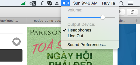

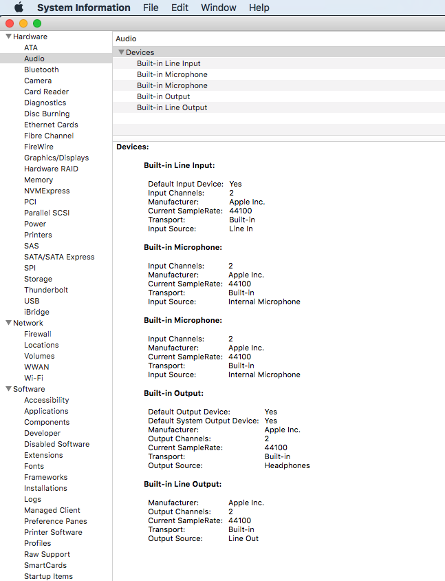

huytbt Posted October 21, 2018 Share Posted October 21, 2018 (edited) Hi everyone, I'm using hackintosh on HP Workstation Z600. This use Realtek ALC262. I have added AppleALC to patch HDA. And use clover to inject layout 28. I see it success to patch. But I cannot hear sound when inject headphone although input detected. (Please see Input detected image file I'm attached) I also attach my codec_dump file. Please support me resolve this issue. Many thanks codec_dump.txt Edited October 21, 2018 by huytbt Link to comment https://www.insanelymac.com/forum/topic/311293-applealc-%E2%80%94-dynamic-applehda-patching/page/114/#findComment-2642067 Share on other sites More sharing options...
