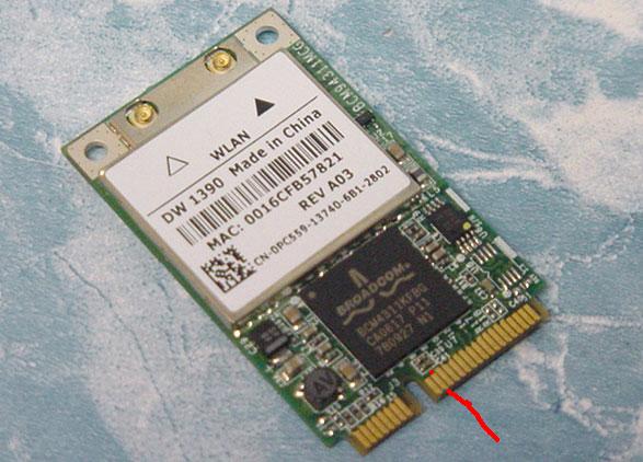

Slice Posted January 22, 2016 Share Posted January 22, 2016 It won't work, replace with BCM43225 or BCM4352 4315/4312 was working with kext from 10.6 by replacing DeviceID and put a scotch on Pin20 (I am not sure, google about it). I am sure about 4315, it is my working WiFi in Dell Inspiron. 1 Link to comment https://www.insanelymac.com/forum/topic/310779-about-bcm943142-in-osx/#findComment-2209313 Share on other sites More sharing options...

arsradu Posted February 2, 2016 Author Share Posted February 2, 2016 4315/4312 was working with kext from 10.6 by replacing DeviceID and put a scotch on Pin20 (I am not sure, google about it). I am sure about 4315, it is my working WiFi in Dell Inspiron. Hey Slice I'm going to try this, but before that, I want to ask you this: if you do this, will you still be able to use your WiFi in Windows? Any idea? Link to comment https://www.insanelymac.com/forum/topic/310779-about-bcm943142-in-osx/#findComment-2212709 Share on other sites More sharing options...
Andres ZeroCross Posted February 2, 2016 Share Posted February 2, 2016 Hey Slice I'm going to try this, but before that, I want to ask you this: if you do this, will you still be able to use your WiFi in Windows? Any idea? 2 weeks ago, i have a friend with AR9285 as Wifi Card, he got the wifi card from HP Mini Notebook. He needs to put a scotch at pin 20. It will work at Windows and OS X. 2 Link to comment https://www.insanelymac.com/forum/topic/310779-about-bcm943142-in-osx/#findComment-2212715 Share on other sites More sharing options...
Slice Posted February 2, 2016 Share Posted February 2, 2016 Those computer had no WIndows to check if the WiFi works in it. 1 Link to comment https://www.insanelymac.com/forum/topic/310779-about-bcm943142-in-osx/#findComment-2212736 Share on other sites More sharing options...
arsradu Posted February 2, 2016 Author Share Posted February 2, 2016 Those computer had no WIndows to check if the WiFi works in it. Understood. Thank you! 2 weeks ago, i have a friend with AR9285 as Wifi Card, he got the wifi card from HP Mini Notebook. He needs to put a scotch at pin 20. It will work at Windows and OS X. Cool! I'm gonna try it tomorrow. Thank you both very much for your fast reply! Link to comment https://www.insanelymac.com/forum/topic/310779-about-bcm943142-in-osx/#findComment-2212739 Share on other sites More sharing options...
arsradu Posted February 3, 2016 Author Share Posted February 3, 2016 2 weeks ago, i have a friend with AR9285 as Wifi Card, he got the wifi card from HP Mini Notebook. He needs to put a scotch at pin 20. It will work at Windows and OS X. Hey guys, I'm a bit confused. Which one is Pin 20 on this card? Where do you start counting? Or you're not supposed to count them...? Link to comment https://www.insanelymac.com/forum/topic/310779-about-bcm943142-in-osx/#findComment-2213038 Share on other sites More sharing options...
artur_pt Posted February 3, 2016 Share Posted February 3, 2016 hello pin 20 good hack 2 Link to comment https://www.insanelymac.com/forum/topic/310779-about-bcm943142-in-osx/#findComment-2213041 Share on other sites More sharing options...

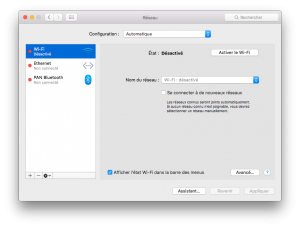

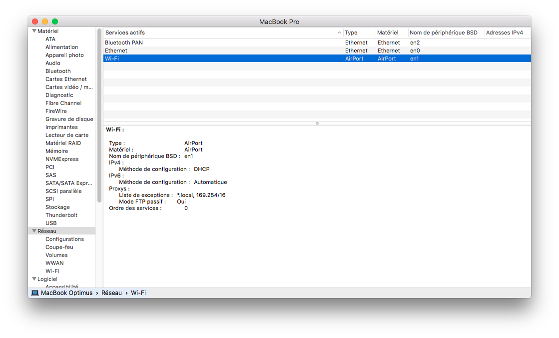

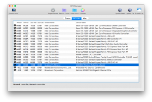

polyzargone Posted February 4, 2016 Share Posted February 4, 2016 hello this tip is only for cards show in system .. loading the kext .. but can't connect but u can try no harm .. only a few work to test good hack Didn't worked for me . The kext seems loaded : MacBook-Optimus:~ polyzargone$ kextstat | grep Atheros 52 0 0xffffff7f81959000 0x14d000 0x14d000 com.apple.driver.AirPort.Atheros40 (700.74.5) ABBC5EFD-7F18-30BE-A526-273DE99C1614 <51 50 12 7 5 4 3 1> But as you can see in screenshots, no WIFI hardware detected by OS X (though it is by DPCIManager) but shows up in Sys Info. However, I'm pretty sure it's because of the DSDT Atheros patch. Device (PXSX) { Name (_ADR, Zero) // _ADR: Address Method (_PRW, 0, NotSerialized) // _PRW: Power Resources for Wake { Return (GPRW (0x09, 0x04)) } Method (_DSM, 4, NotSerialized) // _DSM: Device-Specific Method { If (LEqual (Arg2, Zero)) { Return (Buffer (One) { 0x03 }) } Return (Package (0x0E) { "device-id", Unicode ("0"), "name", "pci168c,30", "AAPL,slot-name", Buffer (0x08) { "AirPort" }, "device_type", Buffer (0x08) { "AirPort" }, "model", Buffer (0x33) { "Atheros 9285 802.11 b/g/n Wireless Network Adapter" }, "subsystem-id", Buffer (0x04) { 0x8F, 0x00, 0x00, 0x00 }, "subsystem-vendor-id", Buffer (0x04) { 0x6B, 0x10, 0x00, 0x00 } }) } } Anyway, thanks ! Link to comment https://www.insanelymac.com/forum/topic/310779-about-bcm943142-in-osx/#findComment-2213120 Share on other sites More sharing options...

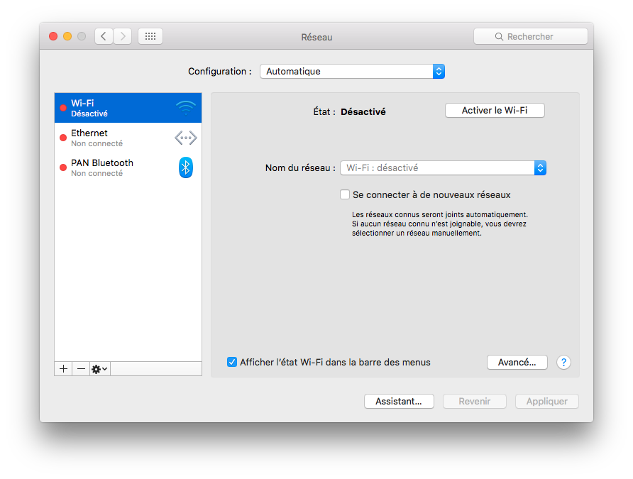

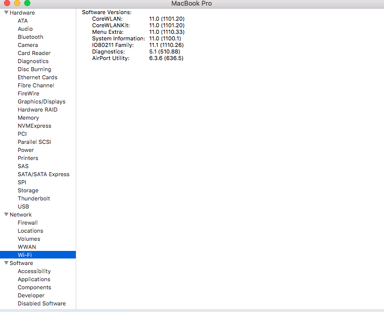

arsradu Posted February 4, 2016 Author Share Posted February 4, 2016 ..inject metioned ids (a lot of broadcom and Atheros) Hey, Micky I "patched" the card with tape, it is visible and working properly on Windows, there is something in System Report in OS X...but I'm not sure that information is ok or if it means that the card is somehow detected... The kext is loaded though... Any idea? Link to comment https://www.insanelymac.com/forum/topic/310779-about-bcm943142-in-osx/#findComment-2213203 Share on other sites More sharing options...
