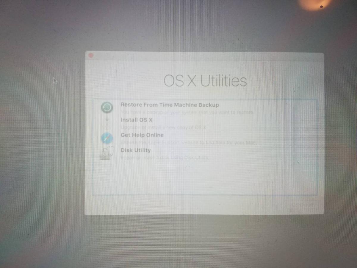

I have decided to try your guide and I can get a functioning installer made and get into the setup.. but it would appear to be in Italian.. any idea how I can change it to english as its throwing an error I can't read after I try to install after partitioning the HD on the surface

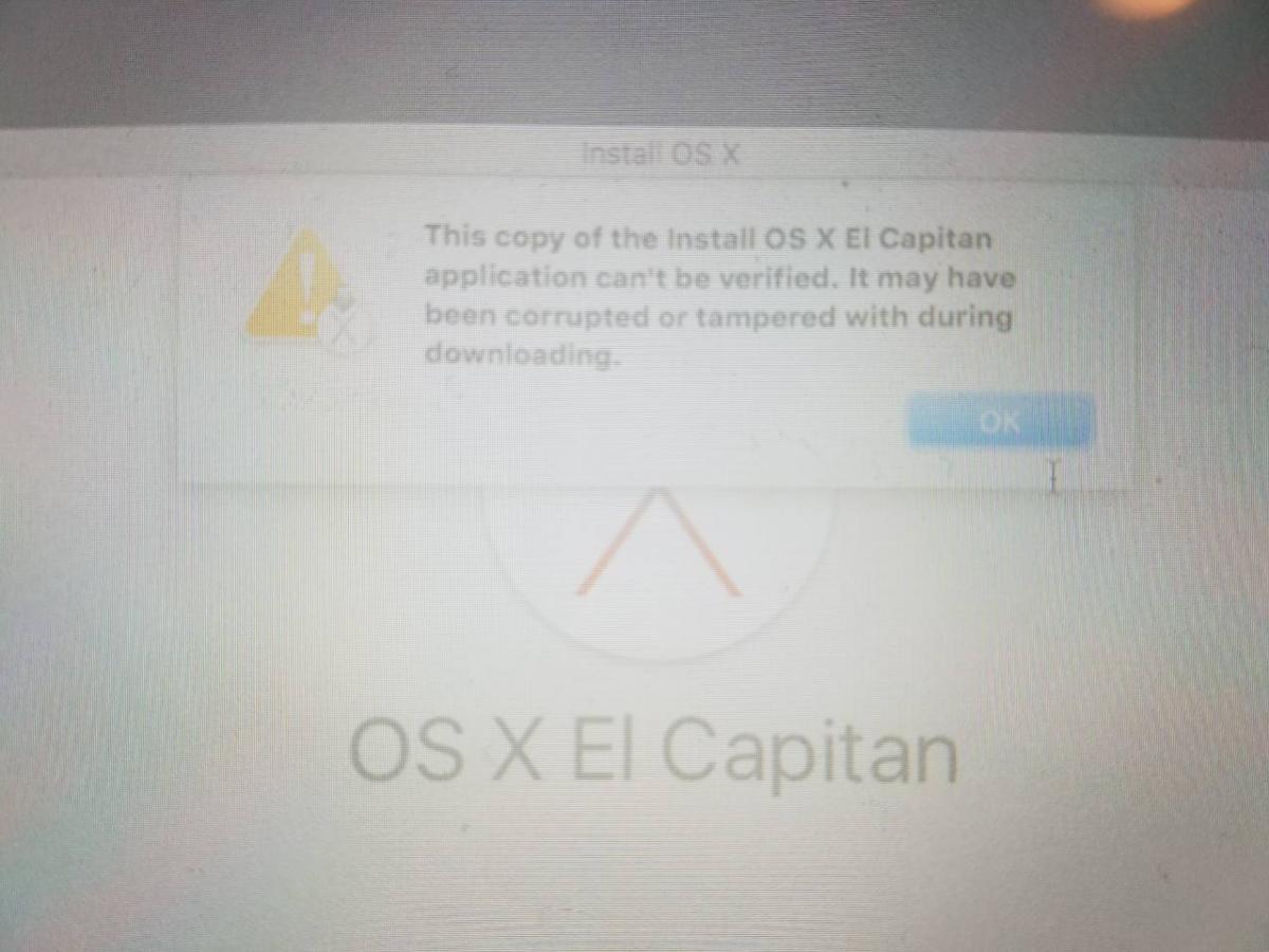

1) Screen is very white...
2) Says it cannot validate my El Cap installer and it may have been modified during download.. I do not believe its the newest copy of the installer but without internet on the Surface I'm not sure how its comparing that or why it thinks that..
@Timelord83
1) If I remember correctly, this was caused by original/unpatched DSDT and AppleIntelFramebufferCapri.kext. Try to live with it during the installation – I'm not sure whether this has been fixed. If the white screen still appears after booting the installed OS X, check that you are using the correct DSDT and AppleIntelFramebufferCapri.kext.
2) This may be caused by an expired certificate. Apple signs Installer packages for verification before installation. If the signature is no longer valid (certificates expire after some time), it can trigger this error. Check that your date/time is set correctly (e.g. in Windows, if you still have those installed, or in the installer: Utilites > Terminal, then type date). If it is correct, try changing your date to ~1 week after the release of the version of OS X you are trying to install. See here for more information:
http://apple.stackexchange.com/questions/216730/this-copy-of-the-install-os-x-el-capitan-application-cant-be-verified-it-may-h

thank you very much your assumption on the expired cert was correct after setting my machine date back to 16 it is installing.. thank you very much
