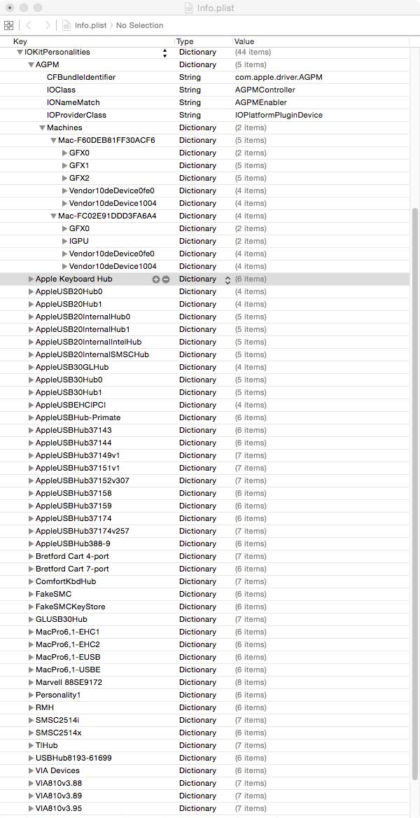

stinga11 Posted June 18, 2015 Share Posted June 18, 2015 Well, After a long frustrating week of search a solution, I finally found it. I will not going into details of how I fixed it, if you want to know what I did, review the two dummy Kext. 1. Install and boot Mac OS X El capital using a iMac13,2 definition. 2. Download the two dummy kexts and put into the /System/Library/Extensions or /Library/Extensions 10.11 MacPro6,1 USB FIX.zip 3. Download InsanelyRepairPermission and repair and touch with sudo InsanelyRepairPermission -rt / 4. Change the iMac13,2 definition to MacPro6,1 definition. Now all USB 2.0 should be working properly. 5. When you switch to MacPro6,1 definition you may not be able to boot your Hackintosh, because the monitor turns off after the boot process. How to solve this problem? Easy, boot with this boot-args: nv_disable=1, then go to System/Library/Extensions/AppleGraphicsControl.kext/Contents/PlugIns/AppleGraphicsDevicePolicy.kext/ copy the info.plist to Desktop and change: <key>ConfigMap</key> <dict> <key>Mac-F60DEB81FF30ACF6</key> <string>Config1</string> </dict> To <key>ConfigMap</key> <dict> <key>Mac-F60DEB81FF30ACF6</key> <string>none</string> </dict> Then replace the original info.plist with the modified version. Now you need run again the InsanelyRepairPermission. This part of work would not have been possible without the Pikeralpha OR Change your graphics information on the DSDT to GFX1 Device (GFX1) { Name (_ADR, Zero) Name (_SUN, One) Method (_DSM, 4, NotSerialized) { Store (Package (0x0A) { "@0,connector-type", Buffer (0x04) { 0x00, 0x08, 0x00, 0x00 }, "@1,connector-type", Buffer (0x04) { 0x00, 0x08, 0x00, 0x00 }, "@2,connector-type", Buffer (0x04) { 0x00, 0x08, 0x00, 0x00 }, "@3,connector-type", Buffer (0x04) { 0x00, 0x08, 0x00, 0x00 }, "hda-gfx", Buffer (0x0A) { "onboard-1" } }, Local0) DTGP (Arg0, Arg1, Arg2, Arg3, RefOf (Local0)) Return (Local0) } } Device (HDAU) { Name (_ADR, One) Method (_DSM, 4, NotSerialized) { Store (Package (0x02) { "hda-gfx", Buffer (0x0A) { "onboard-1" } }, Local0) DTGP (Arg0, Arg1, Arg2, Arg3, RefOf (Local0)) Return (Local0) } } } If you dont want to use a DSDT you can create a SSDT with your graphics information. ALL credits for this part goes to shilohhh If your motherboard has a FL1009 USB 3.0 I made a dummy kext for this chipset. EDIT: October 7,2015 I edited the kext to fix the problem that when you connect an external drive doesn't show the orange color. Thanks to polyzargone 3 Link to comment https://www.insanelymac.com/forum/topic/306732-macpro61-usb-fix-el-capitan-final-app-store-realease-updated-7-oct-2015/ Share on other sites More sharing options...
vusun123 Posted June 19, 2015 Share Posted June 19, 2015 Well, After a long frustrating week of search a solution, I finally found it. I will not going into details of how I fixed it, if you want to know what I did, review the two dummy Kext. 1. Install and boot Mac OS X El capital using a iMac13,2 definition and the following boot-args: kext-dev-mode=1 and rootless=0. 2. Download the two dummy kexts and put into the /System/Library/Extensions El Capitan DP1 MacPro6 USB Fix.zip 3. Download and run it. 4. Change the iMac13,2 definition to MacPro6,1 definition. Now all USB 2.0 should be working properly. EDIT: It is possible that when you switch to MacPro6,1 definition you may not be able to boot your Hackintosh, because the monitor turns off after the boot process. How to solve this problem? Easy, boot with this boot-args: nv_disable=1, then you need to download this file 10.11Info.plist.zip and replace it with the original here System/Library/Extensions/AppleGraphicsControl.kext/Contents/PlugIns/AppleGraphicsDevicePolicy.kext/ Now you need run again the caches_rebuild.command About the AGDP patch, there's a file in the Download section that automatically patches it to avoid black screen, FYI Link to comment https://www.insanelymac.com/forum/topic/306732-macpro61-usb-fix-el-capitan-final-app-store-realease-updated-7-oct-2015/#findComment-2146339 Share on other sites More sharing options...

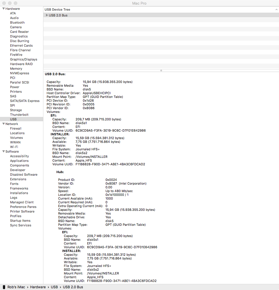

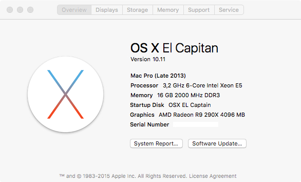

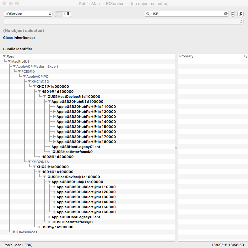

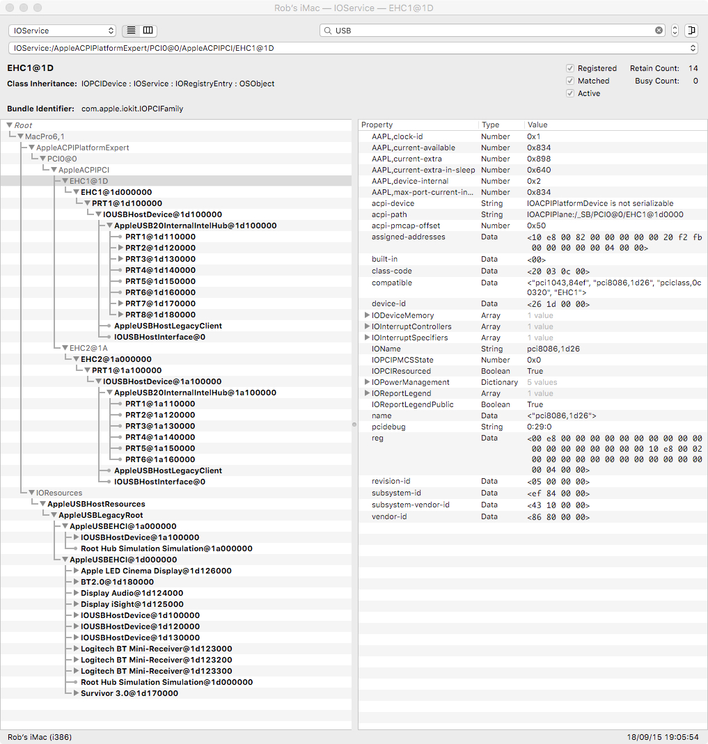

RobLans Posted September 17, 2015 Share Posted September 17, 2015 Hi stinga11, I have Rampage Extreme IV motherboard with AMD R9-290x GPU. I have tried your DP1 Fix on OSX El Captain General Master, after reboot form IMac13,2 >> MacPro 6,1 unfortunately ther's no connection with the USB2.0 ports like mouse and keyb. (remotely connected) I cant's see nothing in sys info about USB 2.0 bus. (USB Device tree empty). Reading the reply from [david_osx] somethings telling me there is a update of your fix, where is it. If there is not, sorry for bothering you Link to comment https://www.insanelymac.com/forum/topic/306732-macpro61-usb-fix-el-capitan-final-app-store-realease-updated-7-oct-2015/#findComment-2168666 Share on other sites More sharing options...
Pike R. Alpha Posted September 17, 2015 Share Posted September 17, 2015 . Link to comment https://www.insanelymac.com/forum/topic/306732-macpro61-usb-fix-el-capitan-final-app-store-realease-updated-7-oct-2015/#findComment-2168672 Share on other sites More sharing options...
stinga11 Posted September 17, 2015 Author Share Posted September 17, 2015 Hi stinga11, I have Rampage Extreme IV motherboard with AMD R9-290x GPU. I have tried your DP1 Fix on OSX El Captain General Master, after reboot form IMac13,2 >> MacPro 6,1 unfortunately ther's no connection with the USB2.0 ports like mouse and keyb. (remotely connected) I cant's see nothing in sys info about USB 2.0 bus. (USB Device tree empty). Reading the reply from [david_osx] somethings telling me there is a update of your fix, where is it. If there is not, sorry for bothering you Hey try with this version. I update the three dummy kext for El capitan GM when captitan release I update the OP. http://www.mediafire.com/download/9tqppbps1pjmk9m/Archive.zip Link to comment https://www.insanelymac.com/forum/topic/306732-macpro61-usb-fix-el-capitan-final-app-store-realease-updated-7-oct-2015/#findComment-2168676 Share on other sites More sharing options...
tChibo Posted September 18, 2015 Share Posted September 18, 2015 Hi stinga11, I have Rampage Extreme IV motherboard with AMD R9-290x GPU. I have tried your DP1 Fix on OSX El Captain General Master, after reboot form IMac13,2 >> MacPro 6,1 unfortunately ther's no connection with the USB2.0 ports like mouse and keyb. (remotely connected) I cant's see nothing in sys info about USB 2.0 bus. (USB Device tree empty). Reading the reply from [david_osx] somethings telling me there is a update of your fix, where is it. If there is not, sorry for bothering you If you want properly inject AMD R9-290x with inject=Ati=yes in clover you must use v3265 https://applelife.ru/threads/clover.42089/page-339#post-543317 Link to comment https://www.insanelymac.com/forum/topic/306732-macpro61-usb-fix-el-capitan-final-app-store-realease-updated-7-oct-2015/#findComment-2168678 Share on other sites More sharing options...
RobLans Posted September 18, 2015 Share Posted September 18, 2015 If you want properly inject AMD R9-290x with inject=Ati=yes in clover you must use v3265 https://applelife.ru/threads/clover.42089/page-339#post-543317 Hi tChibo, My R9-290x MSI Gaming edition working fine with Baladi FB and custom ATI Connector Patch (Clover) poked by myself, using LED Cinema Display trough mini Display Port), no special Clover v3265 needed. I'm on 3259 now System information actually reports "AMD Readon R9 290X 4096 MB" instead of "AMD Readon HD8xxx 4096 MB" But anyway thanks for your information, I will have a look trough but Russia native language is abracadabra for me Hey try with this version. I update the three dummy kext for El capitan GM when captitan release I update the OP. http://www.mediafire.com/download/9tqppbps1pjmk9m/Archive.zip Thank you very much stinga11, I will give this version a try, let you all know, at he moment default install (SMBios MacPro 6,1) I have only USB 2.0 PCI 8086, 1d26 working, PCI 8086, 1d2d not working. Update: Working now with latest FIX and IMac 13,2 >> MacPro 6,2 procedure (not exactly clear why first install under SMBios IMac13,2, must be something related to hardware profile i Gues?) Link to comment https://www.insanelymac.com/forum/topic/306732-macpro61-usb-fix-el-capitan-final-app-store-realease-updated-7-oct-2015/#findComment-2168729 Share on other sites More sharing options...

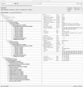

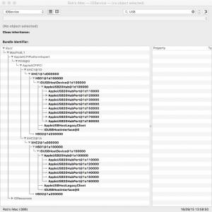

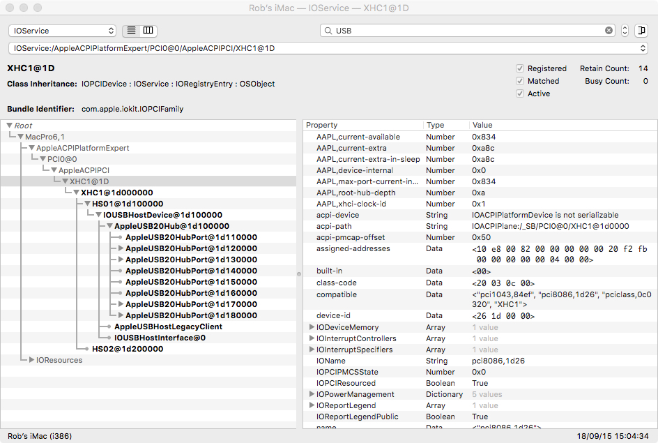

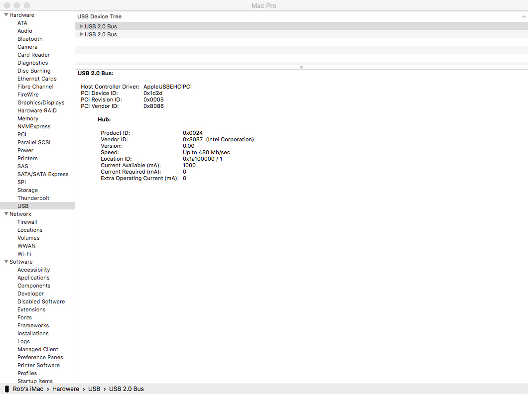

RobLans Posted September 18, 2015 Share Posted September 18, 2015 x79 DMG has updated SSDT's for Asus and Gigabyte. I need a IOREG from the other manufactures to add the patch for them as well. @stinga11 Email me if you have questions of how/what I did. Hi Andrew, Just let you know by experience (Beta testing) the ssdt from latest X79 from date august 9 (checked if ssdt is loaded) strangely seems to support only pci8086,1d26 with (latest) fix from stinga11, NOT pci8086,1d2d unfortunately. Situation occurs If I do a clean fresh install SMBios MacPro 6,1 OR follow the procedure (Stinga Fix) SMBios IMac13,2 >> SMBios MacPro6,1. Implement the ssdt XHCI, XHC2 (replacing EUSB, EUSE) in DSDT working for me. Greetings, Rob System: Rampage IV Extreme, AMD MSI R9-290x, OSX El Captain Golden Master, Clover 3259 Link to comment https://www.insanelymac.com/forum/topic/306732-macpro61-usb-fix-el-capitan-final-app-store-realease-updated-7-oct-2015/#findComment-2168779 Share on other sites More sharing options...
stinga11 Posted September 18, 2015 Author Share Posted September 18, 2015 Hi Andrew, Just let you know by experience (Beta testing) the ssdt from latest X79 from date august 9 (checked if ssdt is loaded) strangely seems to support only pci8086,1d26 with (latest) fix from stinga11, NOT pci8086,1d2d unfortunately. Situation occurs If I do a clean fresh install SMBios MacPro 6,1 OR follow the procedure (Stinga Fix) SMBios IMac13,2 >> SMBios MacPro6,1. Implement the ssdt XHCI, XHC2 (replacing EUSB, EUSE) in DSDT working for me. Greetings, Rob System: Rampage IV Extreme, AMD MSI R9-290x, OSX El Captain Golden Master, Clover 3259 USB2 1d26.jpg IOREG 1d26.jpg Hey, Yoy can not combine the SSDT fix by Rampagedev with my Kext fix if you want use the SSDT by Rampagedev and my fix together you need edit the SSDT and delete the USB fix and then you can use both at the same time. What motherboard do you have??? Send me the ssdt for check it and edit for you Link to comment https://www.insanelymac.com/forum/topic/306732-macpro61-usb-fix-el-capitan-final-app-store-realease-updated-7-oct-2015/#findComment-2168788 Share on other sites More sharing options...
RobLans Posted September 18, 2015 Share Posted September 18, 2015 Hey, Yoy can not combine the SSDT fix by Rampagedev with my Kext fix if you want use the SSDT by Rampagedev and my fix together you need edit the SSDT and delete the USB fix and then you can use both at the same time. What motherboard do you have??? Send me the ssdt for check it and edit for you Hi Stinga11, I have Rampage IV extreme, same as you i guess >> My config > System: Rampage IV Extreme, AMD MSI R9-290x, OSX El Captain Golden Master, Clover 3259 Im using ssdt from Andrew (Rampagedev) latest X79 Package in folder [R4E V2.2/AMD] june 22 >> here (official link from Rampagedev) Thanks for your help, which is great. PS> Without your fix, and only ssdt from Andrew (Rampagev) USB2.0 there is only working one USB Bus 1d26. Link to comment https://www.insanelymac.com/forum/topic/306732-macpro61-usb-fix-el-capitan-final-app-store-realease-updated-7-oct-2015/#findComment-2168807 Share on other sites More sharing options...
stinga11 Posted September 18, 2015 Author Share Posted September 18, 2015 Hi Stinga11, I have Rampage IV extreme, same as you i guess >> My config > System: Rampage IV Extreme, AMD MSI R9-290x, OSX El Captain Golden Master, Clover 3259 Im using ssdt from Andrew (Rampagedev) latest X79 Package in folder [R4E V2.2/AMD] june 22 >> here (official link from Rampagedev) Thanks for your help, which is great. PS> Without your fix, and only ssdt from Andrew (Rampagev) USB2.0 there is only working one USB Bus 1d26. Hey, I leave here my DSDT, delete the rampagedev ssdt and add only the ssdt for speedtep and my DSDTRampage IV DSDT.zip Link to comment https://www.insanelymac.com/forum/topic/306732-macpro61-usb-fix-el-capitan-final-app-store-realease-updated-7-oct-2015/#findComment-2168824 Share on other sites More sharing options...
RobLans Posted September 18, 2015 Share Posted September 18, 2015 Hey, I leave here my DSDT, delete the rampagedev ssdt and add only the ssdt for speedtep and my DSDTRampage IV DSDT.zip Hi stinga11, unfortunately i can't boot from your dsdt due to different hardware config, although i get the picture by understanding your dsdt what's need for properly working USB2.0. I'm digging trough to understand your FIX, for so far so good, thank you for you help, really appreciated. Update: Well this looks pretty cool to me 1 Link to comment https://www.insanelymac.com/forum/topic/306732-macpro61-usb-fix-el-capitan-final-app-store-realease-updated-7-oct-2015/#findComment-2168843 Share on other sites More sharing options...
