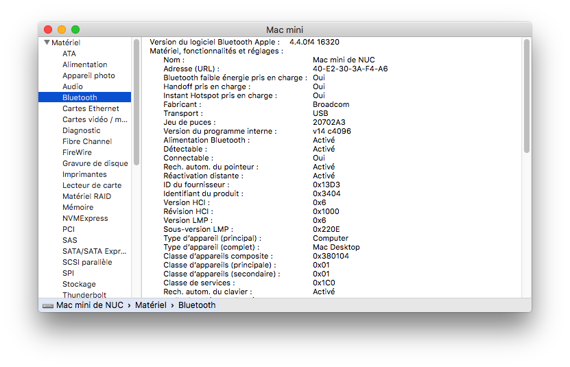

In 10.11, my bluetooth shows up (both in USB and in settings, system information), it can search for devices, but when I try to connect, it always failed. In Yosemite, I have to have the firmware uploaded using BrcmPatchRAM.

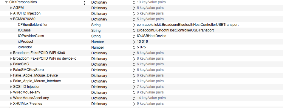

As far as I know his is same as mine AzureWave AW-CE123H Device ID: 13316, Vendor: 5075, mine is doing that as well when you can search for devices but can't coonect.
I think that is one of the vendor/device ids that are not supported by the firmware provided in 10.11.
Your firmware is still showing the default v4096. Strange that it still works for you.
Note c4096, not v4096.

attachicon.gifFakeSMC_1394.kext.zip
good hack
Thanks, so you use FakeSMC.kext/Contents/Info.plist to inject your hardware with the same way as common injectors do  :thumbsup_anim:
I never imagined to do so !
Your injection seems to be same as RehabMan for our card, so everything is consistent.

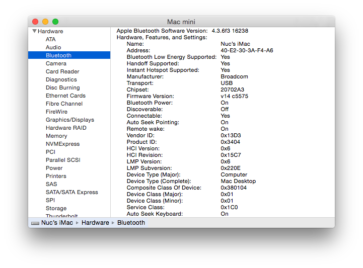

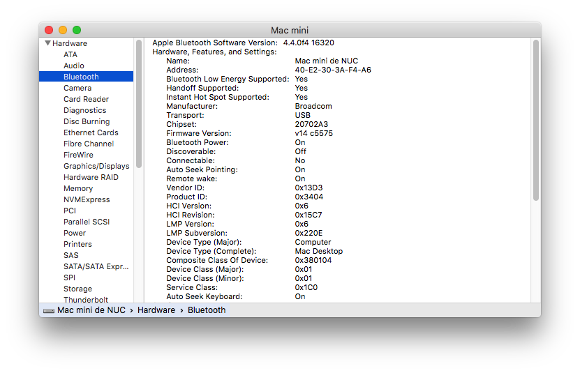

 On 10.10.5 I have v14 c5575 and on 10.11.DP8 I get randomly v14 c4096 and v14 c5575.
With c5575 : everything is OK
with c4096 : Sys Pref OK but no connection !

Has anyone gotten Handoff/Hotspot working in el capitan with ProductID 0x3404, VendorID 0x13d3? For me, it shows up, it connects devices, yet I can't get handoff/hotspot to work on it.
I have a different card (Asus BCM4352/Azurewave CE-123H, vendor: 0x0b05, product: 0x17cf) but same problem.
Using BrcmBluetoothInjector and 10.11 handoff patch in clover (3259) everything looks exactly like it did in 10.10.X
10.10.5 screenshot: http://i.imgur.com/J3CEs0a.png
10.11 GM screenshot: http://i.imgur.com/8y42t4Y.png
Bluetooth mouse (including waking from sleep) works, but handoff and instant hotspot don't work anymore.
