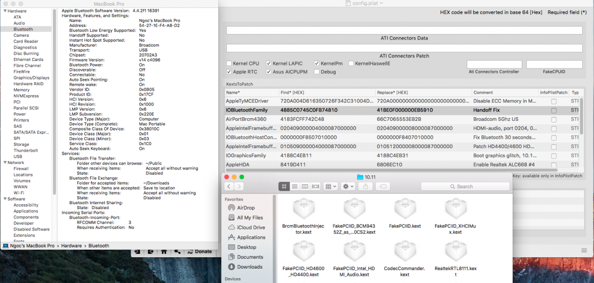

Hello
my asus BCM 94352 fw 20702A3 does't work with BrcmPatchRAM2
it works with BrcmBluetoothInjector but handoff doesnt work
can you add my device to BrcmPatchRAM2 ?
0b05:17cf is already in the kext. Make sure you install it correctly (read the README).
Your image shows BrcmBluetoothInjector.kext installed, not BrcmPatchRAM2+BrcmFirmwareData (as would be required in Clover/kexts).
Thanks it works when i remove BrcmBluetoothInjector.kext installed, and put BrcmPatchRAM2+BrcmFirmwareData together in clover/kext
But why handoff doesn't work?
i added in config.plist
			<dict>
				<key>Comment</key>
				<string>10.11.dp1+ BT4LE-Handoff-Hotspot, credit RehabMan based on Dokterdok original</string>
				<key>Find</key>
				<data>
				SIX/dEdIiwc=
				</data>
				<key>Name</key>
				<string>IOBluetoothFamily</string>
				<key>Replace</key>
				<data>
				Qb4PAAAA60Q=
				</data>
			</dict>
Apple Bluetooth Software Version:	4.4.2f1 16391

This is my problem with my wifi/Bt asus 94352hmb, bluetooth working but not found anything, thx for a fix
cat /var/log/system.log | grep -i brcm[fp]
Oct 30 09:30:26 localhost kernel[0]: BrcmPatchRAM2: Version 2.2.1 starting on OS X Darwin 15.0.

yes i fix the problem with rebuild the caches on El Capitan 10.11
1- sudo kextcache -system-prelinked-kernel
2- sudo kextcache -system-caches
3- repair permissions
4- reboot
after this i pairs all
