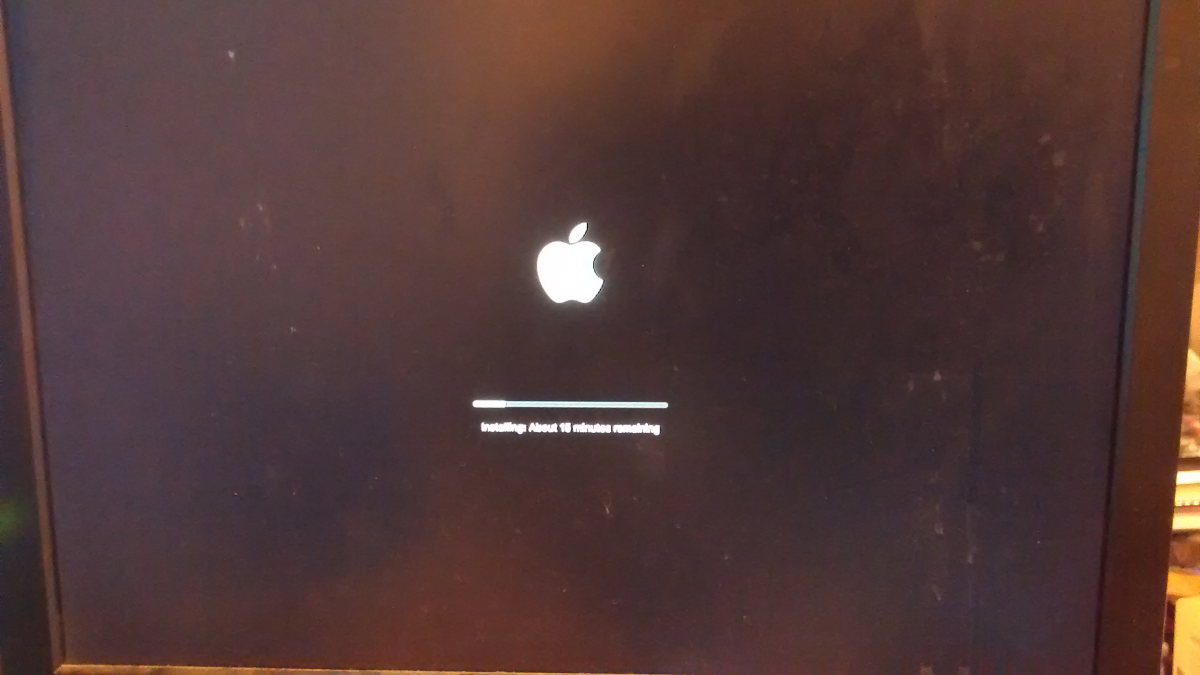

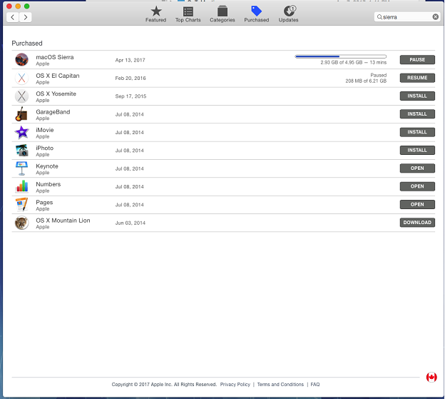

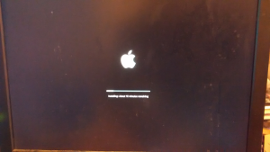

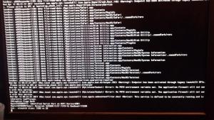

dregnox Posted April 12, 2017 Share Posted April 12, 2017 I'm at a loss. Struggling to get the USB stick to load the OSX installer for Yosemite 10.10.10. I havent built a Hackintosh in awhile but I had enough spare PC parts from work to mash this thing together. This is my 3rd Hackintosh and the first time I've been unable to get to the installer. Specs: Yosemite 10.10.10 MSI H81M-E34 board Haswell i5-4440 Single Stick 4GB DDR3 RAM 160GB HDD Followed the guide yet during the Verbose setup I hit a "hmm.. mismatch sizes 3100 vs 20" The system hangs for a bit then goes to the black screen with white Apple logo with loading bar. I can see and move my cursor and then a beach ball of death happens and the system hangs there not doing anything. The only deviation I have is that the Clover 2.3K Special Edition Installer is no longer on the site. I ended up using Clover 2.3k r3270 I had from setting up a different Hackintosh. When that failed I used the latest Clover 2.4k r4049. Both give the same issue of hanging at an Apple logo with a loading bar unfilled and beach ball of death. I've also tried getting the installer to launch with both HDD and DVD drives unplugged to no avail. Followed the guide right up to the install point, right after where the guide notes the deprecated information. I attempt to carry out the install and that's where I'm stuck now. -16gb USB 2.0 stick formatted HFS+ with GUID partition -Make bootable Yosemite 10.10.10 media on USB -Install Clover; UEFI and ESP selected only -Run Clover Configurator, mount EFI, set ACPI, set Boot, set GUI, set Graphics, set Kernel and Kexts, set RT Variables, set SMBIOS, set System Params, set Drivers according to guide -Save config.plist to EFI -Eject USB safely -Put USB stick into USB 2.0 port -Set mobo to IGD -Hit F11 and boot UEFI: USB STICK -kext-dev-mode=1 rootless=0 nv_disable=1 -v (I also tried with -f, dart=0, ncpi=0x2000) -System hangs at "hmm.. mismatch sizes 3100 vs 20" Any clues as to where I might have gone wrong? Link to comment https://www.insanelymac.com/forum/topic/306429-guide-msi-h81m-motherboards-basics-of-a-computer-build-budget-hackintosh-builds-uefi-dualboot-os-x-el-capitan-wip/page/6/#findComment-2402960 Share on other sites More sharing options...
GhostRaider Posted April 12, 2017 Author Share Posted April 12, 2017 I'm at a loss. Struggling to get the USB stick to load the OSX installer for Yosemite 10.10.10. I havent built a Hackintosh in awhile but I had enough spare PC parts from work to mash this thing together. This is my 3rd Hackintosh and the first time I've been unable to get to the installer. Specs: Yosemite 10.10.10 MSI H81M-E34 board Haswell i5-4440 Single Stick 4GB DDR3 RAM 160GB HDD Followed the guide yet during the Verbose setup I hit a "hmm.. mismatch sizes 3100 vs 20" The system hangs for a bit then goes to the black screen with white Apple logo with loading bar. I can see and move my cursor and then a beach ball of death happens and the system hangs there not doing anything. The only deviation I have is that the Clover 2.3K Special Edition Installer is no longer on the site. I ended up using Clover 2.3k r3270 I had from setting up a different Hackintosh. When that failed I used the latest Clover 2.4k r4049. Both give the same issue of hanging at an Apple logo with a loading bar unfilled and beach ball of death. I've also tried getting the installer to launch with both HDD and DVD drives unplugged to no avail. Followed the guide right up to the install point, right after where the guide notes the deprecated information. I attempt to carry out the install and that's where I'm stuck now. -16gb USB 2.0 stick formatted HFS+ with GUID partition -Make bootable Yosemite 10.10.10 media on USB -Install Clover; UEFI and ESP selected only -Run Clover Configurator, mount EFI, set ACPI, set Boot, set GUI, set Graphics, set Kernel and Kexts, set RT Variables, set SMBIOS, set System Params, set Drivers according to guide -Save config.plist to EFI -Eject USB safely -Put USB stick into USB 2.0 port -Set mobo to IGD -Hit F11 and boot UEFI: USB STICK -kext-dev-mode=1 rootless=0 nv_disable=1 -v (I also tried with -f, dart=0, ncpi=0x2000) -System hangs at "hmm.. mismatch sizes 3100 vs 20" Any clues as to where I might have gone wrong? That's a pretty funny verbose message lol. Well if you are in fact using the same motherboard as mine then it should be very easy. Though I'm not sure why you want Yosemite if you can use Sierra just fine. For this motherboard you need iMac 14,2 SMBIOS, OsxAptioFix2Drv, KernelPM enabled, AppleRTC enabled, igPlatformID 0x0D220003 if using Intel HD 4600. Now I use a custom SSDT so you will need to enable GeneratePStates and GenerateCStates. For USB, Ethernet, kexts are placed in Clover kext folder. Other than that, this motherboard runs almost vanilla macOS. Not sure why you're having problems. Link to comment https://www.insanelymac.com/forum/topic/306429-guide-msi-h81m-motherboards-basics-of-a-computer-build-budget-hackintosh-builds-uefi-dualboot-os-x-el-capitan-wip/page/6/#findComment-2403270 Share on other sites More sharing options...
dregnox Posted April 13, 2017 Share Posted April 13, 2017 Well after some tom foolery I managed to get into the installer on some trial and error unstable configuration. I did however learn that dart=x would get me into the installer with my custom config. Originally I had tried to use dart=1 while trying to trouble shoot on day 1 but it failed. This time I did dart=0 and followed the guide and it loaded the installer normally without issues. Frustratingly my Yosemite USB refused to install because of corruption issues, apparently. So I said eff it and went with Sierra like you suggested. Still had to do dart=0 for Sierra otherwise it would just boot loop. I bought this MSI H81M-E34 about a week ago from NCIX so it might be that a newer BIOS/EFI revision caused a need to use dart=0. I'll edit in any other oddities if I run into them once it's up and running By the way what were the contents of the MSI H81M MotherBoard Pack? The files are gone from the insanelymac site. . Link to comment https://www.insanelymac.com/forum/topic/306429-guide-msi-h81m-motherboards-basics-of-a-computer-build-budget-hackintosh-builds-uefi-dualboot-os-x-el-capitan-wip/page/6/#findComment-2403572 Share on other sites More sharing options...
