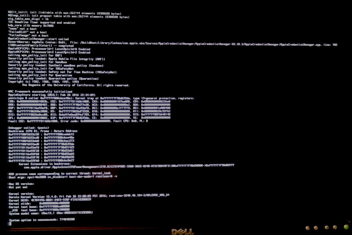

However, still cannot boot.  I have the MSI H81M-E34 with Pentium G3258, 8gb ram and wish to use the integrated graphics (I also have access to GTX 950).
I have modified Clover with the following:
Gfx section: Inject Intel, ig-platform-id (0x0166000A)
Kernel+Kext patches: AppleRTC, KernelPM, FakeCPUID (0x0306A0)
SMBIOS: iMac 13,1
I have not copied FakePCIID amd FakePCIID_HD4600_HD4400
I attach a screenshot of my failure!  Does it make sense to anyone?
