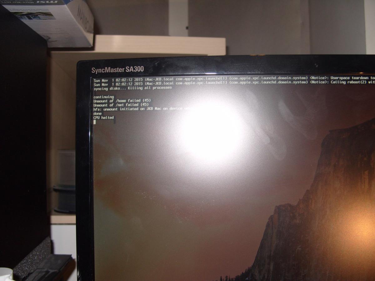

JKB MACPL Posted October 31, 2015 Share Posted October 31, 2015 That's right. O sx closes, but there's no power down. It only happens occasionally, usually after I close Pro Tools. I'll monitor it and get back to you. Link to comment https://www.insanelymac.com/forum/topic/306429-guide-msi-h81m-motherboards-basics-of-a-computer-build-budget-hackintosh-builds-uefi-dualboot-os-x-el-capitan-wip/page/3/#findComment-2184000 Share on other sites More sharing options...
JKB MACPL Posted November 1, 2015 Share Posted November 1, 2015 That's what I get when in verbose mode. sometimes it powers down sometimes it doesnt. I also used the power managemet patch, but it dondn't change anything Link to comment https://www.insanelymac.com/forum/topic/306429-guide-msi-h81m-motherboards-basics-of-a-computer-build-budget-hackintosh-builds-uefi-dualboot-os-x-el-capitan-wip/page/3/#findComment-2184546 Share on other sites More sharing options...
JKB MACPL Posted November 3, 2015 Share Posted November 3, 2015 I Think I found the solution. I activated the Fix Shutdown DSDT patch in Clover. The computer powers down after a longer moment. Link to comment https://www.insanelymac.com/forum/topic/306429-guide-msi-h81m-motherboards-basics-of-a-computer-build-budget-hackintosh-builds-uefi-dualboot-os-x-el-capitan-wip/page/3/#findComment-2185103 Share on other sites More sharing options...
GhostRaider Posted November 3, 2015 Author Share Posted November 3, 2015 I Think I found the solution. I activated the Fix Shutdown DSDT patch in Clover. The computer powers down after a longer moment. I was thinking that it was a kext that was causing the problem, but if the dsdt patch works then your problem is solved. 1 Link to comment https://www.insanelymac.com/forum/topic/306429-guide-msi-h81m-motherboards-basics-of-a-computer-build-budget-hackintosh-builds-uefi-dualboot-os-x-el-capitan-wip/page/3/#findComment-2185145 Share on other sites More sharing options...
JKB MACPL Posted November 4, 2015 Share Posted November 4, 2015 I also deactivated wait for lan in the energy saver preferences. Now it boots down kind of smoother. 1 Link to comment https://www.insanelymac.com/forum/topic/306429-guide-msi-h81m-motherboards-basics-of-a-computer-build-budget-hackintosh-builds-uefi-dualboot-os-x-el-capitan-wip/page/3/#findComment-2185434 Share on other sites More sharing options...
