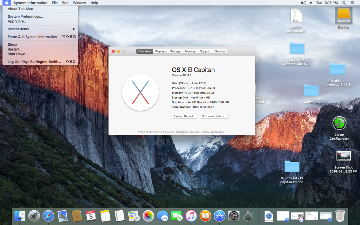

HD4400 with qe/ci and HDMI audio:
i have an H81I mini-itx mobo installed in an old Shuttle enclosure.  i'm using an i3-4170 cpu, which has HD4400 graphics.
i used RehabMan's FakePCIID kexts to enable full operation of HD4400 and to get HDMI audio working.  i had not been successful with the toleda approach to HDMI audio.
refer to RehabMan's github page for links to the FakePCIID kexts and info on how to use them.
this approach requires an ssdt which contains the GFX0 device and the B0D3 device.  refer to Rehabman's excellent guide on patching laptop DSDT's (google for it).  don't be put off by "laptop".  the procedure for desktops is the same.
for my setup, the ssdt that needs to be patched is ssdt-6.
i changed the name of device GFX0 to IGPU, and the name of device B0D3 to HDAU.
i added a method _DSM device HDAU so i could inject "hda-gfx" = "onboard-1" and "layout-id" = 1.  i added a method _DSM to device IGPU so i could inject "hda-gfx" = "onboard-1".
then i used kext wizard to install the following RehabMan kexts into system/library/extensions:
FakePCIID.kext
FakePCIID_Intel_HD_Graphics.kext (if you already have your HD4x00 gfx working properly i would not install this kext)
FakePCIID_Intel_HDMI_Audio.kext
in config.plist/ACPI/SSDT add key DropOem and set to true/
place your patched ssdt in efi/clover/ACPI/patched
reboot, and hopefully your HDMI sound device will show up in system preferences/sound.
again, i have not tried to get AppleHDA sound working.  if you have, this approach might not work.
i'm attaching my patched ssdt, which may or may not work in your configuration, but you can see what changes i made and you can apply them to your own extracted ssdt.
credit to Rehabman for the kexts and his help to me to get HDMI audio working.
ken

*This is clearly a real Mac and not a Hackintosh. Can't you see the Apple logo?  :whistle:
Anyways, can we beat Apple's most cheapest Mac, the Mac Mini? Of course! The question is, how?

So let's see what we have done so far:
  • Clover Bootloader is already installed to the Hard Drive / SSD.
  • The Intel HD Graphics 4400/4600 works with QE/CI.
  • Ethernet and USB 3.0 ports work.

14) All Builds: That's it! You should now see the desktop and your NVIDIA Graphics card should now be working!
