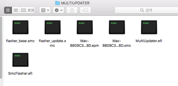

i found one about imac17,1 smc rev when install fresh hs dp9.
installer makes
/Volumes/EFI/EFI/APPLE/UPDATERS/MULTIUPDATER/Mac-B809C3757DA9BB8D.epm
/Volumes/EFI/EFI/APPLE/UPDATERS/MULTIUPDATER/Mac-B809C3757DA9BB8D.smc
to update
REV          : 02 34 0f 00 00 02
clover used 2.33f10.
as result, mac installer always makes files for smc update to match board-id and latest smc rev key.
Mac-B809C3757DA9BB8D.smc.zip
installer makes
to update
Only one file here for Imac13,2 SMBIOS: Mac-F60DEB81FF30ACF6.epm?
Seems most of system has epm file. There is epm file on my all system. I dont know role of epm file.
But there is no smc file except imac17,1 on my system. I tested.
Also when install HS with imac17,1
1. Boot usb installer, installer copy files.
2. 2nd boot, shown that remains 12 minutes, then suddenly reboot, 3nd boot, install HS.
Maybe 2nd boot, seems update smc.
나의 LG-F800S 의 Tapatalk에서 보냄
Same process here for Imac13,2 et macpro6,1 SMBIOS. On french mac4ever site: "Each migration / installation will be machine specific and will install appropriate firmware."  https://www.mac4ever.com/actu/124903_macos-high-sierra-une-installation-specifique-a-votre-mac-ce-qui-pose-quelques-soucis-maj
Can you upload smc file?
/Volumes/EFI/EFI/APPLE/UPDATERS/MULTIUPDATER/Mac-your imac13,2 board-id.smc
As I say before post # 2470: "Only one file here for Imac13,2 SMBIOS: Mac-F60DEB81FF30ACF6.epm." And only one file for macpro6,1 SMBIOS: Mac-F60DEB81FF30ACF6.epm. Curiously it's same epm file. But no SMC files?
I've two HDD for my system: one with Imac13,2 and other with macpro6,1
Update: for Imac13,2 SMBIOS it would be i  Mac13,2: 'Mac-FC02E91DDD3FA6A4'
Sorry for my english.
Like you said, some smbios uses 3nd boot for installation of HS.
If there is no smc file, smc was matched from latest smc rev. Also Installer pkg is not include smc file of all models. Seems atleast need to update smc rev key for models of missing smc rev when installation of HS.
Thank you for clear report.
EDIT1.
I tested 2nd reboot with remains 12 minutes
1. macpro61
2. Imac171
2nd no reboot
1. imac18.x
