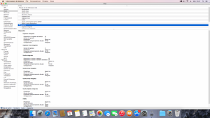

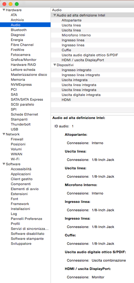

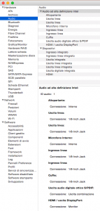

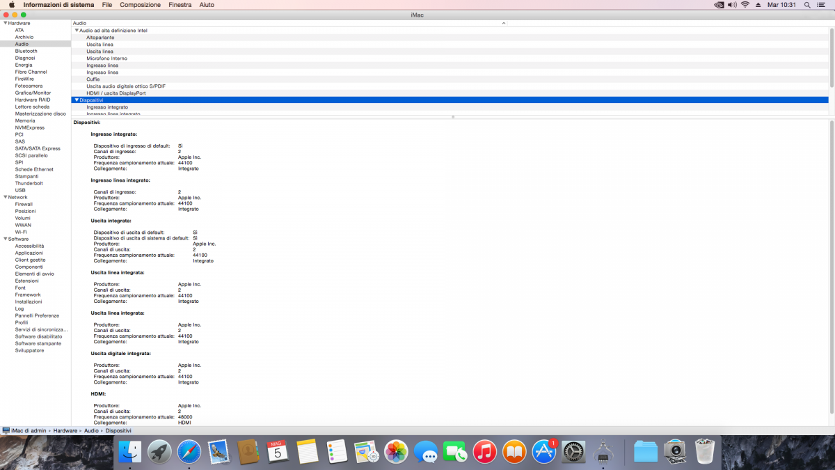

Fabio1971 Posted May 5, 2015 Share Posted May 5, 2015 Fai una foto e postala : info di sistema-suono Fabio Link to comment https://www.insanelymac.com/forum/topic/305856-asus-z97-pro-wifi-ac/page/8/#findComment-2133252 Share on other sites More sharing options...
iLoveOSX Posted May 5, 2015 Author Share Posted May 5, 2015 ok, 2 minuti ecco Link to comment https://www.insanelymac.com/forum/topic/305856-asus-z97-pro-wifi-ac/page/8/#findComment-2133256 Share on other sites More sharing options...
Fabio1971 Posted May 5, 2015 Share Posted May 5, 2015 Ok, piú tardi controllo IoReg Fabio Link to comment https://www.insanelymac.com/forum/topic/305856-asus-z97-pro-wifi-ac/page/8/#findComment-2133257 Share on other sites More sharing options...
iLoveOSX Posted May 5, 2015 Author Share Posted May 5, 2015 Grazie Fabio! Link to comment https://www.insanelymac.com/forum/topic/305856-asus-z97-pro-wifi-ac/page/8/#findComment-2133258 Share on other sites More sharing options...
Fabio1971 Posted May 5, 2015 Share Posted May 5, 2015 Controllato IoReg è ok Fabio Link to comment https://www.insanelymac.com/forum/topic/305856-asus-z97-pro-wifi-ac/page/8/#findComment-2133329 Share on other sites More sharing options...
