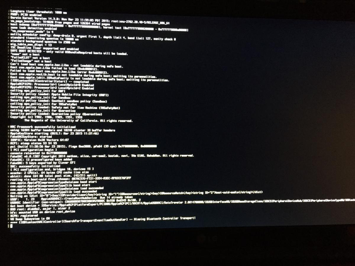

iLoveOSX Posted April 25, 2015 Author Share Posted April 25, 2015 Creazione usb terminata seguendo la guida di Fabio. Questo il primo KO al boot Link to comment https://www.insanelymac.com/forum/topic/305856-asus-z97-pro-wifi-ac/#findComment-2130868 Share on other sites More sharing options...

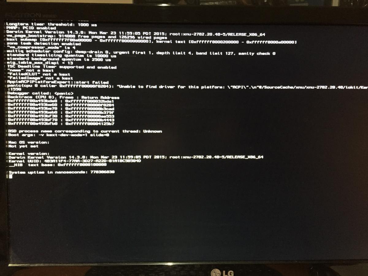

iLoveOSX Posted April 25, 2015 Author Share Posted April 25, 2015 Con il file config di gengi (messo in EFI/clover) invece si ferma qui: Link to comment https://www.insanelymac.com/forum/topic/305856-asus-z97-pro-wifi-ac/#findComment-2130879 Share on other sites More sharing options...
gengik84 Posted April 25, 2015 Share Posted April 25, 2015 il problema riguarda la grafica. Da quanto è la penna che utilizzi? Come collegamento pc monitor quale cavo usi? altra cosa: come hai formattato la usb? Deve essere formatta in mac esteso journaled, tabella partizione guid. Link to comment https://www.insanelymac.com/forum/topic/305856-asus-z97-pro-wifi-ac/#findComment-2130893 Share on other sites More sharing options...
iLoveOSX Posted April 25, 2015 Author Share Posted April 25, 2015 Penna usb 8gb utilizzata in passato per altri hack senza problemi. Formattata ovviamente guid. Uso hdmi. Link to comment https://www.insanelymac.com/forum/topic/305856-asus-z97-pro-wifi-ac/#findComment-2130894 Share on other sites More sharing options...
gengik84 Posted April 25, 2015 Share Posted April 25, 2015 la cpu ha grafica integrata? Ora scusami ma io stavo pensando a I7 4790, ma per ora stavi utilizzando i3... Link to comment https://www.insanelymac.com/forum/topic/305856-asus-z97-pro-wifi-ac/#findComment-2130896 Share on other sites More sharing options...
Fabio1971 Posted April 25, 2015 Share Posted April 25, 2015 Al momento ho inserito 1 solo banco di ram (4gb) per l'installazione, inserirò i restanti al termine. Perchè? ma in attesa ho un installato un intel i3 Quale modello di integrata monta Fabio 1 Link to comment https://www.insanelymac.com/forum/topic/305856-asus-z97-pro-wifi-ac/#findComment-2130903 Share on other sites More sharing options...
iLoveOSX Posted April 26, 2015 Author Share Posted April 26, 2015 Buongiorno amici, credo di aver capito il problema. Il processore da me usato per la prova (in attesa che arrivi i7-4790k) in realtà è un "misero" g3250 che avevo conservato tempo fa all'interno di una confezione per i3. Mi sono lasciato ingannare dalla confezione e non ho fatto caso neppure nel bios. Comunque attendo l'arrivo del bestione e poi vi aggiorno. Buona domenica a tutti. Link to comment https://www.insanelymac.com/forum/topic/305856-asus-z97-pro-wifi-ac/#findComment-2131010 Share on other sites More sharing options...
gengik84 Posted April 26, 2015 Share Posted April 26, 2015 ecco dove era il problema..... Puoi passarmi la EFI della usb Link to comment https://www.insanelymac.com/forum/topic/305856-asus-z97-pro-wifi-ac/#findComment-2131013 Share on other sites More sharing options...
