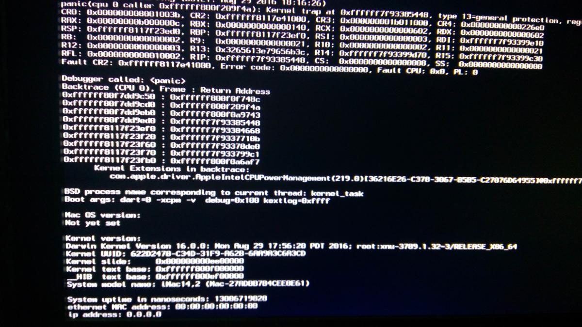

Gigamaxx Posted September 5, 2017 Share Posted September 5, 2017 is there anyone who installed HS DP? in my case, can't install HS. very strange issue. The closest I've come is using cpuid 0x0106E0, 306A0 gets kernel panic. It ends in white screen and gIOScrenlockstate. I had to cheat and use a cloned disk but with clone I can use 0x0306A0. Link to comment https://www.insanelymac.com/forum/topic/303755-how-to-intel-pentium-g3xxx-and-celeron-g1xxx-haswell-works-with-speedstep-yosemite-1010-and-mavericks-109/page/9/#findComment-2490056 Share on other sites More sharing options...
Sherlocks Posted September 5, 2017 Share Posted September 5, 2017 The closest I've come is using cpuid 0x0106E0, 306A0 gets kernel panic. It ends in white screen and gIOScrenlockstate. I had to cheat and use a cloned disk but with clone I can use 0x0306A0.I dont have a problem for using sierra to install or boot. But if i try to install HS from usb, i cant pass first log with -v. I hard to see log. Because log pass fast with -v. I just saw AppleIntelCpu kext kernel panic with mach_reboot message. Very strange. I first guessed ACPI issue, so i disabled some ACPI tables. But still no luck. Continuely shown same message. I'm considering to buy i3 cpu.. But i dont want. Cuz waste money... Anyway can you use or install HS with no problem? What is your cpu? My cpu is g4500 skylake pentium. 나의 LG-F800S 의 Tapatalk에서 보냄 Link to comment https://www.insanelymac.com/forum/topic/303755-how-to-intel-pentium-g3xxx-and-celeron-g1xxx-haswell-works-with-speedstep-yosemite-1010-and-mavericks-109/page/9/#findComment-2490070 Share on other sites More sharing options...
Gigamaxx Posted September 5, 2017 Share Posted September 5, 2017 I dont have a problem for using sierra to install or boot. But if i try to install HS from usb, i cant pass first log with -v. I hard to see log. Because log pass fast with -v. I just saw AppleIntelCpu kext kernel panic with mach_reboot message. Very strange. I first guessed ACPI issue, so i disabled some ACPI tables. But still no luck. Continuely shown same message. I'm considering to buy i3 cpu.. But i dont want. Cuz waste money... Anyway can you use or install HS with no problem? What is your cpu? My cpu is g4500 skylake pentium. 나의 LG-F800S 의 Tapatalk에서 보냄 I have g3258 and it works fine in HS but I can't update or instal, I have to put disk in real MacBook or i5 6500 to get past updates. Once it's updated it works fine with 0x0306A0. Hit space bar at clover screen and select -v don't reboot on panic and keep symbols to see final stopping point. 1 Link to comment https://www.insanelymac.com/forum/topic/303755-how-to-intel-pentium-g3xxx-and-celeron-g1xxx-haswell-works-with-speedstep-yosemite-1010-and-mavericks-109/page/9/#findComment-2490136 Share on other sites More sharing options...
Sherlocks Posted September 6, 2017 Share Posted September 6, 2017 I have g3258 and it works fine in HS but I can't update or instal, I have to put disk in real MacBook or i5 6500 to get past updates. Once it's updated it works fine with 0x0306A0. Hit space bar at clover screen and select -v don't reboot on panic and keep symbols to see final stopping point. Thank you for info.I buy i3 6100 skylake(used) to clear issue today. It can surely check problem. After check, i will sell pentium. 나의 LG-F800S 의 Tapatalk에서 보냄 Link to comment https://www.insanelymac.com/forum/topic/303755-how-to-intel-pentium-g3xxx-and-celeron-g1xxx-haswell-works-with-speedstep-yosemite-1010-and-mavericks-109/page/9/#findComment-2490241 Share on other sites More sharing options...
Sherlocks Posted September 8, 2017 Share Posted September 8, 2017 I have g3258 and it works fine in HS but I can't update or instal, I have to put disk in real MacBook or i5 6500 to get past updates. Once it's updated it works fine with 0x0306A0. Hit space bar at clover screen and select -v don't reboot on panic and keep symbols to see final stopping point. i changed cpu from g4500 to i3 6100. no more suffered symbol issue. i can use usb installer and recovery and install HS. seems that maybe need more patch to avoid Symbol issue. EDIT. Cant catch correct issue now. Anyway i moved i3 processor. Link to comment https://www.insanelymac.com/forum/topic/303755-how-to-intel-pentium-g3xxx-and-celeron-g1xxx-haswell-works-with-speedstep-yosemite-1010-and-mavericks-109/page/9/#findComment-2491501 Share on other sites More sharing options...
