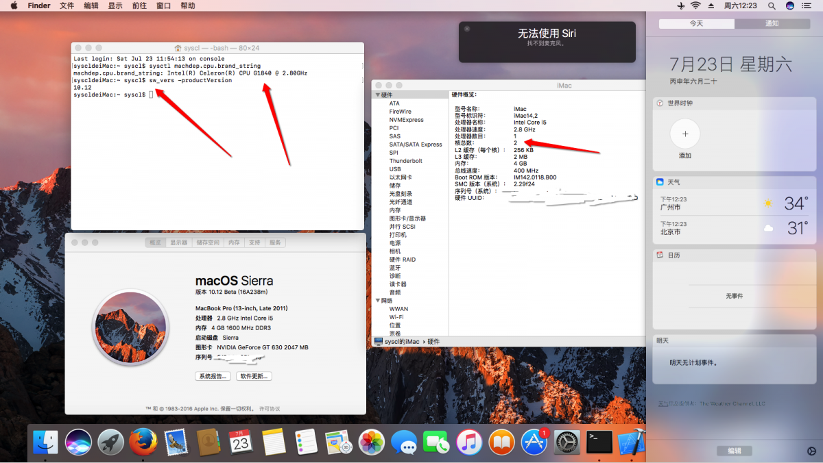

Hi, @vandroiy2012, sorry for my late reply since I was busy doing my startup these days.
Now I'm back to my laptop, and dig into it. Let's do it;)
Please try this one. I use a new method/way to fix that issue.
kernel.zip
Wait for your feedback!
syscl

Hi @vandroiy2012 and @all, finally back to home and sit down to have a look at G1840 on Sierra. I wanna say, Haswell Celeron and Pentium on Sierra is OK :)
Here's my solution:
1. Use Clover r3650
2. FakeCPUID = 0x0306A0
3. Vanilla Sierra installation disk(public beta 16A238m) [Maybe unrelated, I haven't tested other Sierra version]
4. Important: Place NullCPUPowerManagement.kext under Clover/kexts/Other, or place it directly into /S*/L*/E* to prevent kernel panic
5. Vanilla/untouched mach_kernel.
I've tested it successfully on my G1840, here's my specification and configuration files:
Motherboard: MSI H87M-G43
CPU: Celeron G1840
Graphics: Dell GT630 with UEFI vBios
CLOVER.zip
P.S. Next step, I will find out the binary patch for AppleIntelCPUPowerManagement on Sierra, which is the main reason that causes the kernel panic on Haswell Pentium and Celeron. If this can be completed, we can no more use NullCPUPowerManagement.
Wishes you can enjoy Sierra on Celeron and Pentium soon!
syscl
