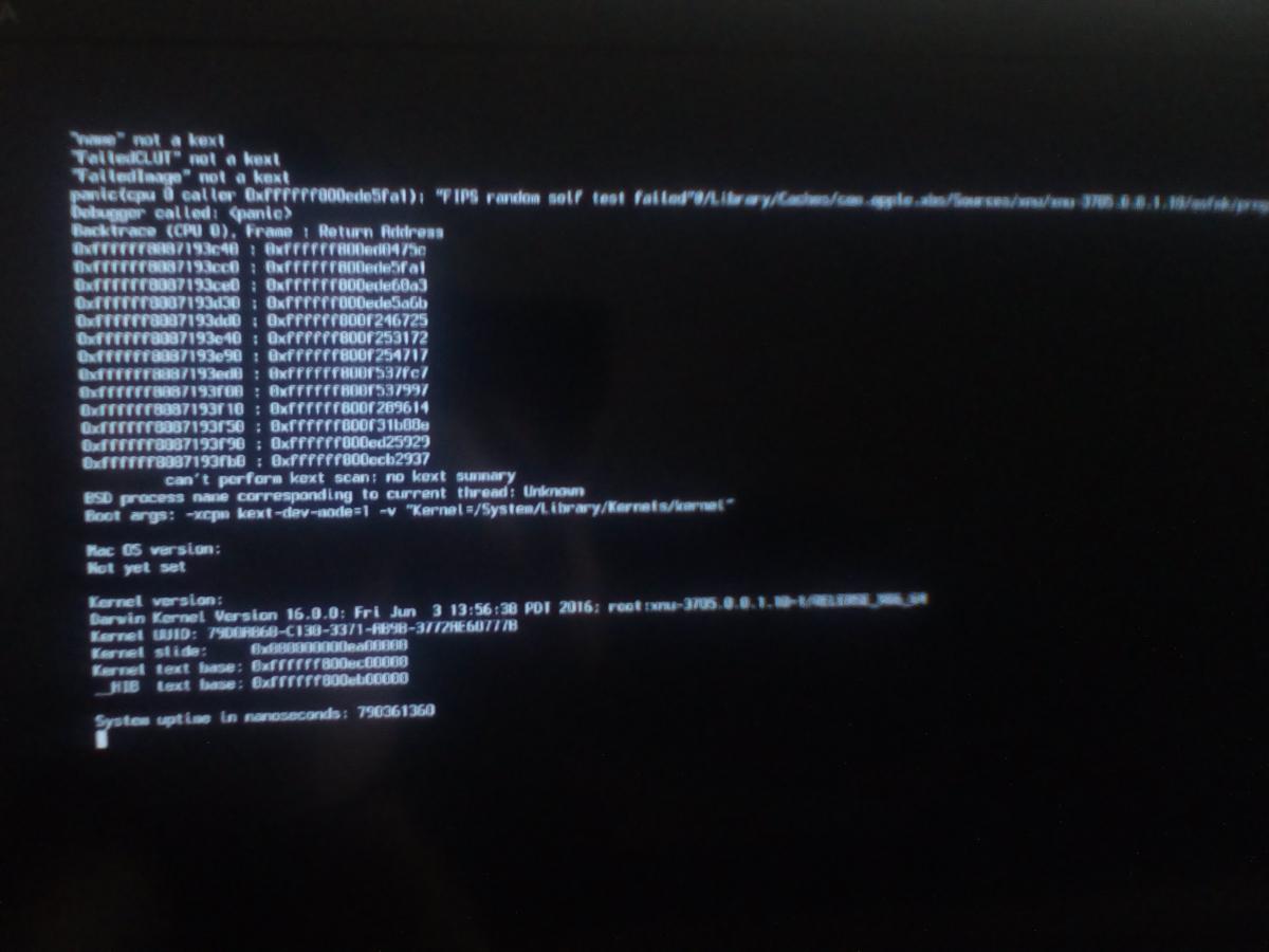

Hello. Replaced kernel in System/Library/Kernels and got KP. Here is KP photo. Should i do anything else except replacing kernel?
Oops, try to remove
<key>KernelAndKextPatches</key>
	<dict>
		<key>FakeCPUID</key>
		<string>0x0306A0</string>
	</dict>
And update Clover to the latest version(there's more improvements on macOS).
syscl
Oops, try to remove
	<dict>
	</dict>
syscl
I'll try to remove FakeCPUID. Should i delete -xcpm key from bootargs? Clover is already updated to r3561

Thread 0 crashed
RAX: 0x000000010ccaf358, RBX: 0x000000010ccaf310, RCX: 0x000000010ccaf348, RDX: 0x000000000000007c
RSP: 0x00007fff53389970, RBP: 0x00007fff53389970, RSI: 0x0000000000000000, RDI: 0x000000010ccaf358
R8:  0x0000000040000000, R9:  0x0000000000000008, R10: 0x0000000000000030, R11: 0x000000010d269ec0
R12: 0x0000000000000000, R13: 0x00007fff53389e80, R14: 0x0000000000000000, R15: 0x0000000000000000
RFL: 0x0000000000010283, RIP: 0x000000010d25bd90, CS:  0x000000000000002b, SS:  0x0000000000000023
Thread 0: 0xffffff802d638b60
	0x000000010d26a27a
	0x000000010d26a19a
	0x000000010d269ef0
	0x000000010c8d85be
	0x000000010c8d8514
	0x0000000118039d4c
	0x0000000118039f25
	0x000000010cf25584
	0x000000010c8d8074
	0x000000010ceabc64
	0x000000010ceabc13
	0x000000010c8caa02
	0x000000011804a063
	0x000000011804a266
	0x0000000118045bf0
	0x0000000118045b87
	0x0000000118044c60
	0x0000000118044cf5
	0x00000001180372f6
	0x000000011803b459
	0x0000000118036249
	0x0000000118036036
	0x0000000000000001
Mac OS version: Not yet set
Kernel version: Darwin Kernel Version 16.0.0: Fri Jun  3 13:56:38 PDT 2016; root:xnu-3705.0.0.1.10~1/RELEASE_X86_64
Kernel UUID: 79D0A860-C130-3371-AB9B-3772AE60777B
System model name: iMac13,1 (Mac-00BE6ED71E35EB86)
Model: iMac13,1, BootROM IM131.010A.B09, 2 processors, Intel Core i5, 2,69 GHz, 4 GB, SMC 2.11f14
Graphics: NVIDIA GeForce GT 240, NVIDIA GeForce GT 240, PCIe, 512 MB
Memory Module: BANK0/DIMM0, 4 GB, DDR3, 1600 MHz, Micron Technology, 16KTF51264AZ-1G6M1M1
Network Service: Ethernet, Ethernet, en0
PCI Card: NVIDIA GeForce GT 240, Display Controller, PCI Slot 0
PCI Card: Realtek RTL8168G/8111G PCI Express Gigabit Ethernet, Ethernet, Ethernet
Serial ATA Device: OCZ-VERTEX3, 120,03 GB
Serial ATA Device: ST500DM002-1BD142, 500,11 GB
USB Device: USB 2.0 Bus
USB Device: Hub
USB Device: Hub
USB Device: USB 3.0 Bus
USB Device: Composite Device
USB Device: USB OPTICAL MOUSE
Thunderbolt Bus:
Netkas told something today about same panic on processors without SSE4 instructions
Bad news for everyone who still uses 65-nm intel cpu based on conroe arch (for example MP1,1/2,1).
SSE4 is being used now in system application and these cpus a missing it.
For example, trying to run macOS 10.12 on MP1,1/MP2,1 will give a panic because launchd process (init process, if it dies – kernel in panic) dies with signal 4 (illegal instruction).
Your only hope is when 10.12 released and sources code for kernel becomes available, if somebody will implement sse4,1 emulator (similar to sse3 emulation in the past)
http://netkas.org/?p=1448
But i don't understand. According to Intel http://ark.intel.com/ru/products/78955/Intel-Celeron-Processor-G1820-2M-Cache-2_70-GHz Celeron G1820 have SSE4.1/4.2 instructions...
