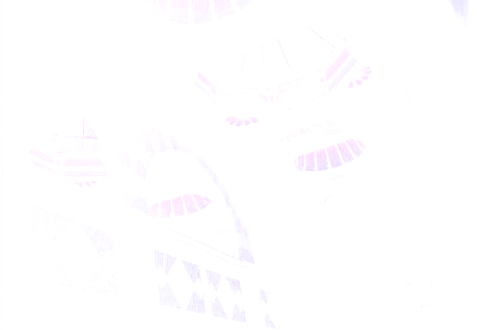

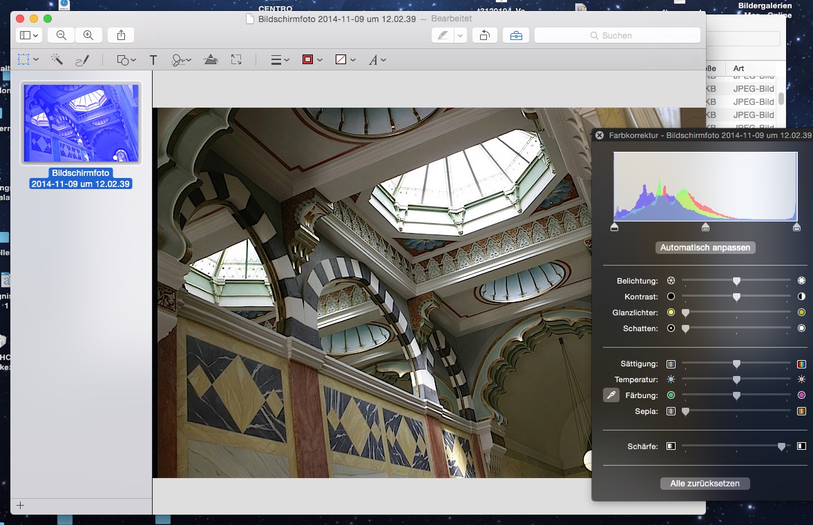

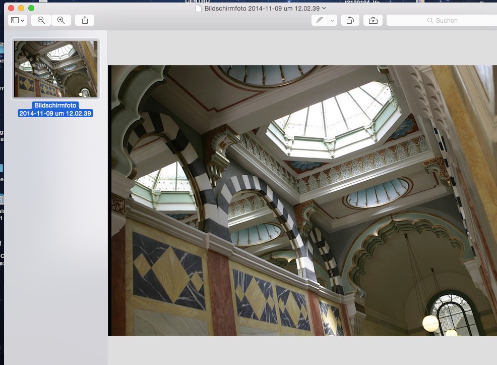

mitch_de Posted November 14, 2014 Share Posted November 14, 2014 Probs:Since the beginning of Yosemite i have an major prob with my GPU Nvidia GT 440. If i use Preview and change something on an pic - doesnt matter if i cut out, use some effects. First the mini preview (left side) pic shoes wrong colours ( hue complete wrong) and after closing the app (pic is saved) the pic reopened ist mostly white?! Opened pic, all OK. Some pic effects = mini preview(left side) ?? colours closing app (pic is saved) and reopening that pic: near complete white?! Link to comment https://www.insanelymac.com/forum/topic/301416-nvidia-web-driver-updates-for-yosemite-update-07212017/page/3/#findComment-2085125 Share on other sites More sharing options...

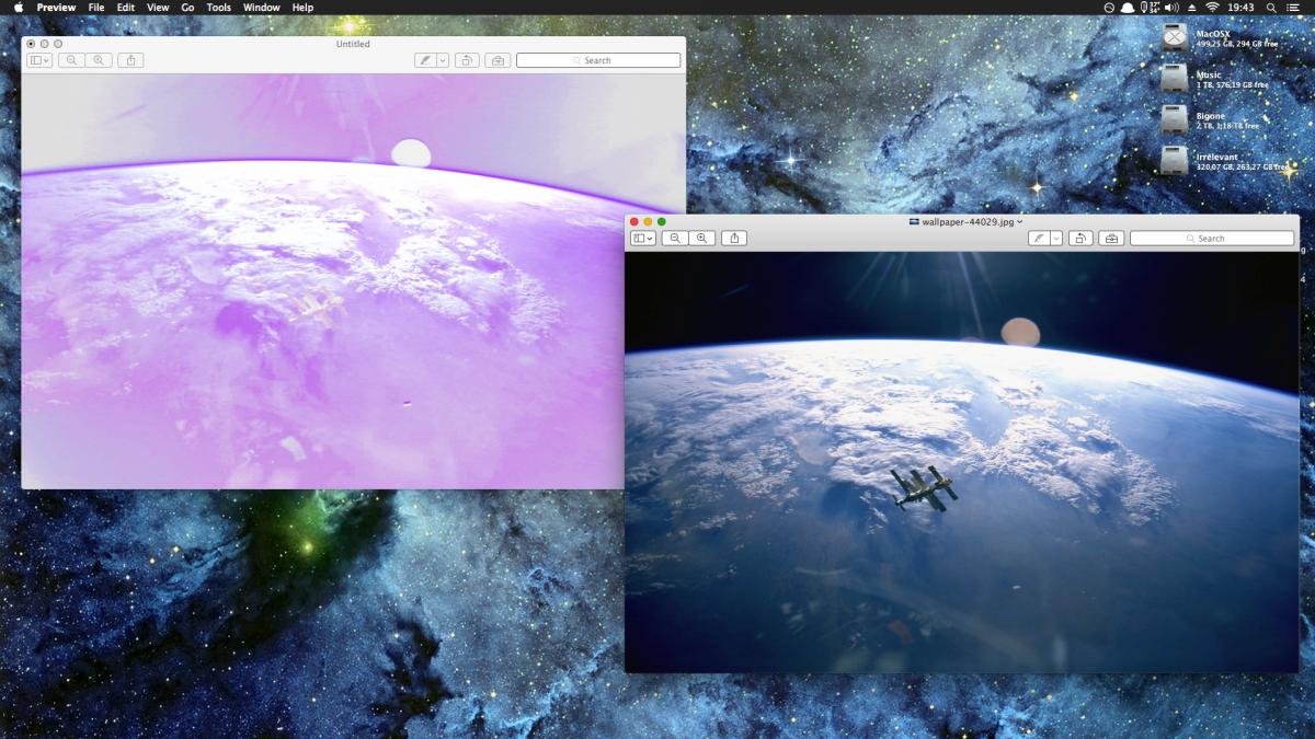

maximus Posted November 14, 2014 Share Posted November 14, 2014 I also have a weird problem. This happens when I copy - paste an image in preview.Very strange. Dont know if its related to drivers. Probs:Since the beginning of Yosemite i have an major prob with my GPU Nvidia GT 440. If i use Preview and change something on an pic - doesnt matter if i cut out, use some effects. First the mini preview (left side) pic shoes wrong colours ( hue complete wrong) and after closing the app (pic is saved) the pic reopened ist mostly white?! Opened pic, all OK. Bildschirmfoto 2014-11-14 um 13.10.30.jpg Some pic effects = mini preview(left side) ?? colours Bildschirmfoto 2014-11-14 um 13.11.27.jpg closing app (pic is saved) and reopening that pic: near complete white?! Bildschirmfoto 2014-11-09 um 12.02.39.jpg I can also reproduce this.Same problem here. Link to comment https://www.insanelymac.com/forum/topic/301416-nvidia-web-driver-updates-for-yosemite-update-07212017/page/3/#findComment-2085282 Share on other sites More sharing options...
crusher Posted November 15, 2014 Share Posted November 15, 2014 i figered out what preview uses running (which libs, frameworks are loaded running preview). Uses OpenCL. I tested to use the Framework OpenCL (in system/frameworks) from 10.9.5. And that happens when i change some effects on an pic: Bildschirmfoto 2014-11-15 um 11.08.05.jpg Nothing bad anymore: pic (left side) stays normal and more good : the saved pic didnt get corrupted anymore. So OpenCL probs can happen not only by the gpu drivers - switching OS X <> Nvidia Web divers didnt fix the prob!! - also the OpenCL framework, can be bugged (or at least not compatible with a wide range of non apple gpu types). Do you fix that problem?If you solve,how? 1 Link to comment https://www.insanelymac.com/forum/topic/301416-nvidia-web-driver-updates-for-yosemite-update-07212017/page/3/#findComment-2085495 Share on other sites More sharing options...
bluenote56 Posted November 15, 2014 Share Posted November 15, 2014 Do you fix that problem?If you solve,how? I had the very same issue, so I tried what mitch_de said and used the Framework OpenCL (in system/frameworks) from 10.9.5. It worked for me and now I have no more issues editing pics. Thanks mitch_ de while I'm waiting for some real fix of this bug it's a good temp fix. Link to comment https://www.insanelymac.com/forum/topic/301416-nvidia-web-driver-updates-for-yosemite-update-07212017/page/3/#findComment-2085564 Share on other sites More sharing options...
mitch_de Posted November 15, 2014 Share Posted November 15, 2014 Sorry, i deleted that post. Using OpenCL Framework from 10.9.5 fixed that preview issue - but by disabling OpenCL complete So other (most benches) OpenCL apps like Luxmark, OpenCL Oceanwaves Bench cant run anymore. But thats not an major prob, if you use that disabling OpenCL method - ist not really needed because CPU is used for that tasks, normally acellerated by OpernCL gpu. I restored the Framework - but i think there is less hope to fix that prob without disabling OpenCL complete (with some gpu types) Would be interesting which similar lowend Nvidia gpus (like my GT 440), 740/750? perhaps didnt have that prob. 1 Link to comment https://www.insanelymac.com/forum/topic/301416-nvidia-web-driver-updates-for-yosemite-update-07212017/page/3/#findComment-2085588 Share on other sites More sharing options...
bluenote56 Posted November 15, 2014 Share Posted November 15, 2014 Sorry, i deleted that post. Using OpenCL Framework from 10.9.5 fixed that preview issue - but by disabling OpenCL complete So other (most benches) OpenCL apps like Luxmark, OpenCL Oceanwaves Bench cant run anymore. But thats not an major prob, if you use that disabling OpenCL method - ist not really needed because CPU is used for that tasks, normally acellerated by OpernCL gpu. I restored the Framework - but i think there is less hope to fix that prob without disabling OpenCL complete (with some gpu types) Would be interesting which similar lowend Nvidia gpus (like my GT 440), 740/750? perhaps didnt have that prob. Thanks for posting but I want you to know that in my case I tested with Cinebench and Heaven and it seems to work. Btw I can use Preview with quick edits while before your suggest I could not. We'll see what comes next for this problem. Link to comment https://www.insanelymac.com/forum/topic/301416-nvidia-web-driver-updates-for-yosemite-update-07212017/page/3/#findComment-2085718 Share on other sites More sharing options...
mitch_de Posted November 16, 2014 Share Posted November 16, 2014 Yep, disabling OpenCL should not have any bad side effekts on most apps (or OpenGL). EDIT: Other (better) workaround (than disabling OpenCL by using older openCL Framework): I tried to use preview.app from 10.9.5 with Yosemite : WORKS so far tested ! No pic corruption as with preview version for 10.10! 10.10 Version seems to use more of the OpenCL API (images) that older Preview version = running in probs with some gpus. That shows that not only drivers / frameworks may make probs - also apps which more and more use OpenCL maybe problematic. Link to comment https://www.insanelymac.com/forum/topic/301416-nvidia-web-driver-updates-for-yosemite-update-07212017/page/3/#findComment-2085826 Share on other sites More sharing options...
