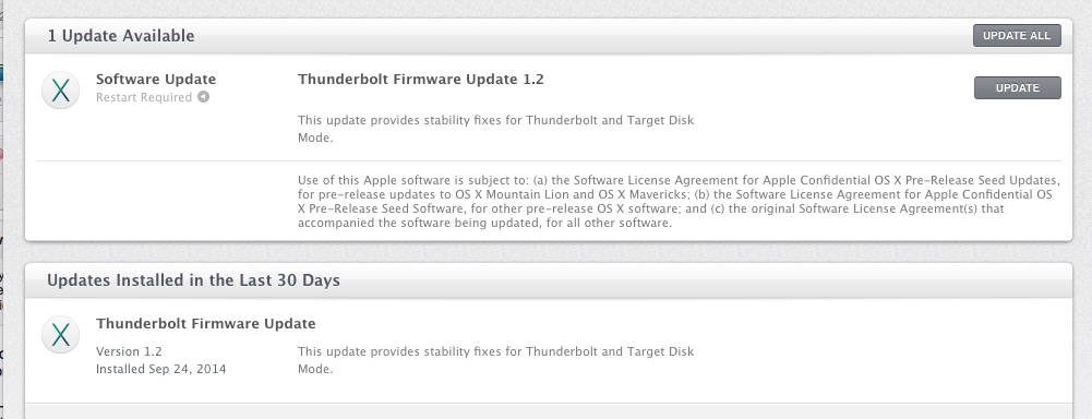

Aide Posted September 18, 2014 Share Posted September 18, 2014 I've checked updates on the App Store on Yosemite Beta 3 and I'm constantly getting the following update shown:- Thunderbolt Firmware Update 1.2 I've tried to the install the update and it seems to install but when my machine reboots and I go back into App Store updates, it re-appears! If I look in the Updates installed in the Last 30 Days section, it shows that it's been installed. I've tried to install it 3 times now and the same issue persists. Is there away that I can hide the update? Thanks in advance Link to comment https://www.insanelymac.com/forum/topic/300943-thunderbolt-firmware-update-12-doesnt-seem-to-install-from-app-store/ Share on other sites More sharing options...

mhaeuser Posted September 22, 2014 Share Posted September 22, 2014 The update is not applicable to our machines as all it does is that it copies a firmware ROM to the ESP. On Macs, Apple EFI reads that file when present and flashes it. As our UEFI implementations of course don't have that behavior, the update is completely useless. Imagine if OS X tried to flash the image by itself: Oops, PC bricked. Furthermore this update would be useless even if it could be flashed. Did you notice that v1.2 was already offered with Mavericks? It's true. It's the very same update. It's always shown when there is a firmware version set in SMBIOS that is lower than OS X expects it to be (OS X updates include firmware updates from time to time, you know). Find out the new version number and use it in SMBIOS, or wait for a Clover update having the new versions. Personally I don't know the new version numbers (yet), sorry. 2 Link to comment https://www.insanelymac.com/forum/topic/300943-thunderbolt-firmware-update-12-doesnt-seem-to-install-from-app-store/#findComment-2063118 Share on other sites More sharing options...

Popular Post FrDakota Posted October 19, 2014 Popular Post Share Posted October 19, 2014 I successfully hid the Thunderbolt update 1.2 under Yosemite. To do that use the softwareupdate command (no need to do a sudo). softwareupdate --ignore ThunderboltFirmwareUpdate1.2 Because putting the latest firmware revision in SMBIOS worked for Mavericks but not for Yosemite. 33 Link to comment https://www.insanelymac.com/forum/topic/300943-thunderbolt-firmware-update-12-doesnt-seem-to-install-from-app-store/#findComment-2071784 Share on other sites More sharing options...
