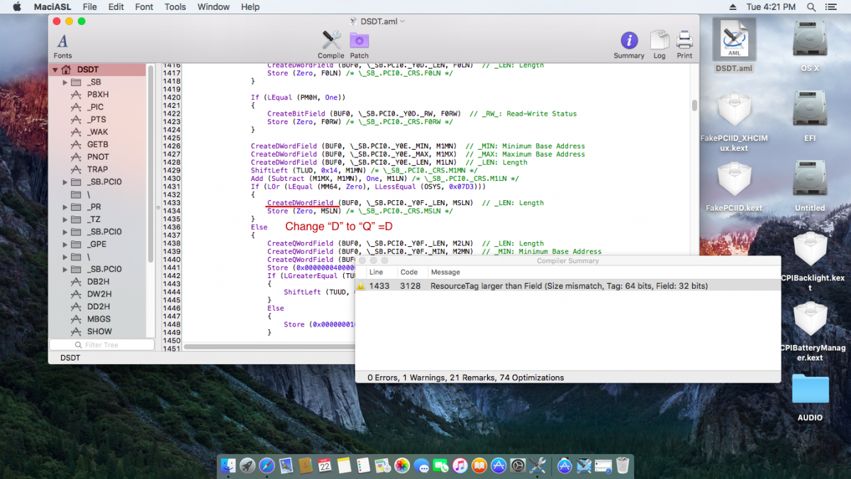

ersan19 Posted March 22, 2016 Share Posted March 22, 2016 got this error while compiling my dsdt Link to comment https://www.insanelymac.com/forum/topic/300906-guide-install-mavericksyosemite-on-sony-vaio-s-2012-and-other-uefi-capable-vaios/page/19/#findComment-2225667 Share on other sites More sharing options...
midi-sama Posted March 22, 2016 Author Share Posted March 22, 2016 got this error while compiling my dsdt Well check again, it's written "0 Errors" LOL And pls, follow the new guide instead of this one Link to comment https://www.insanelymac.com/forum/topic/300906-guide-install-mavericksyosemite-on-sony-vaio-s-2012-and-other-uefi-capable-vaios/page/19/#findComment-2225681 Share on other sites More sharing options...
Allan Posted March 22, 2016 Share Posted March 22, 2016 got this error while compiling my dsdt Is not an error, is a "Warning". To fix this, look: Link to comment https://www.insanelymac.com/forum/topic/300906-guide-install-mavericksyosemite-on-sony-vaio-s-2012-and-other-uefi-capable-vaios/page/19/#findComment-2225771 Share on other sites More sharing options...
