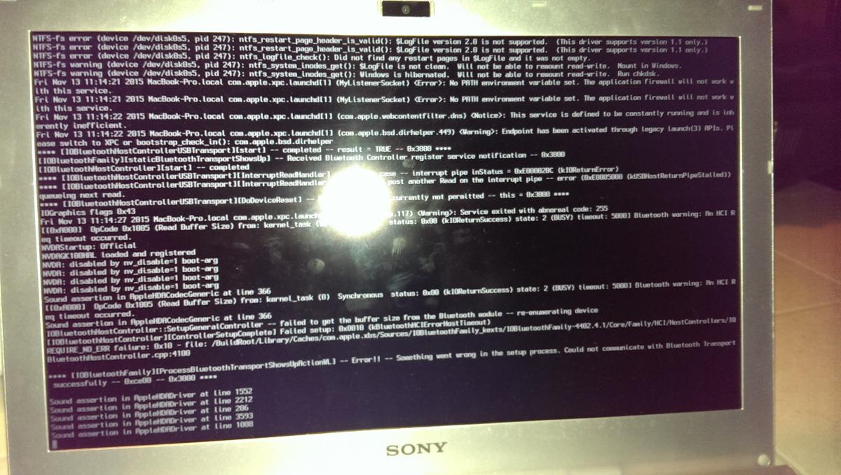

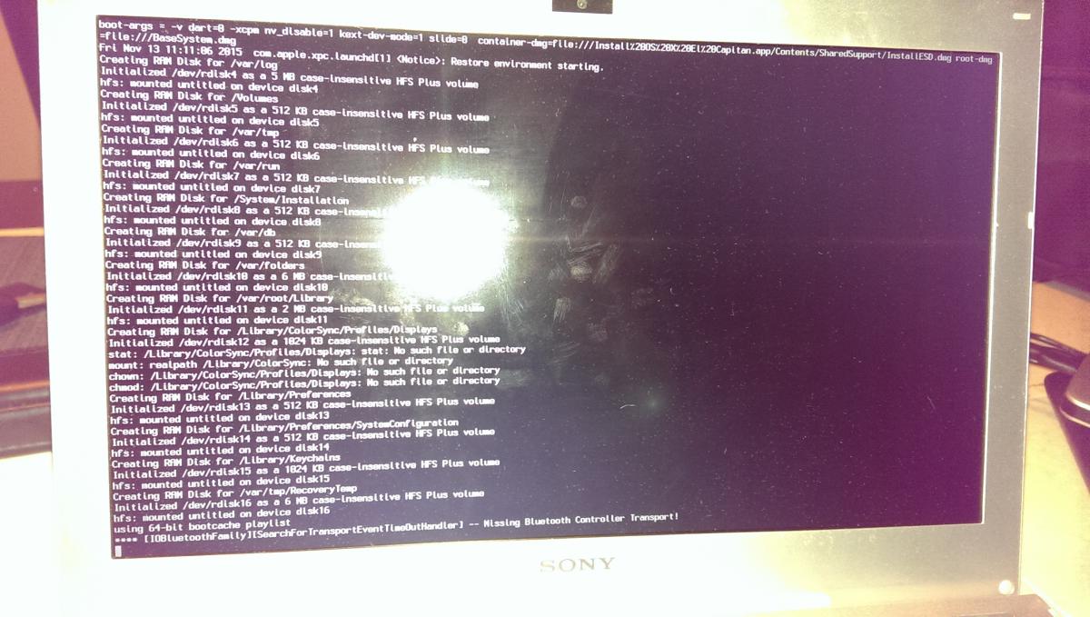

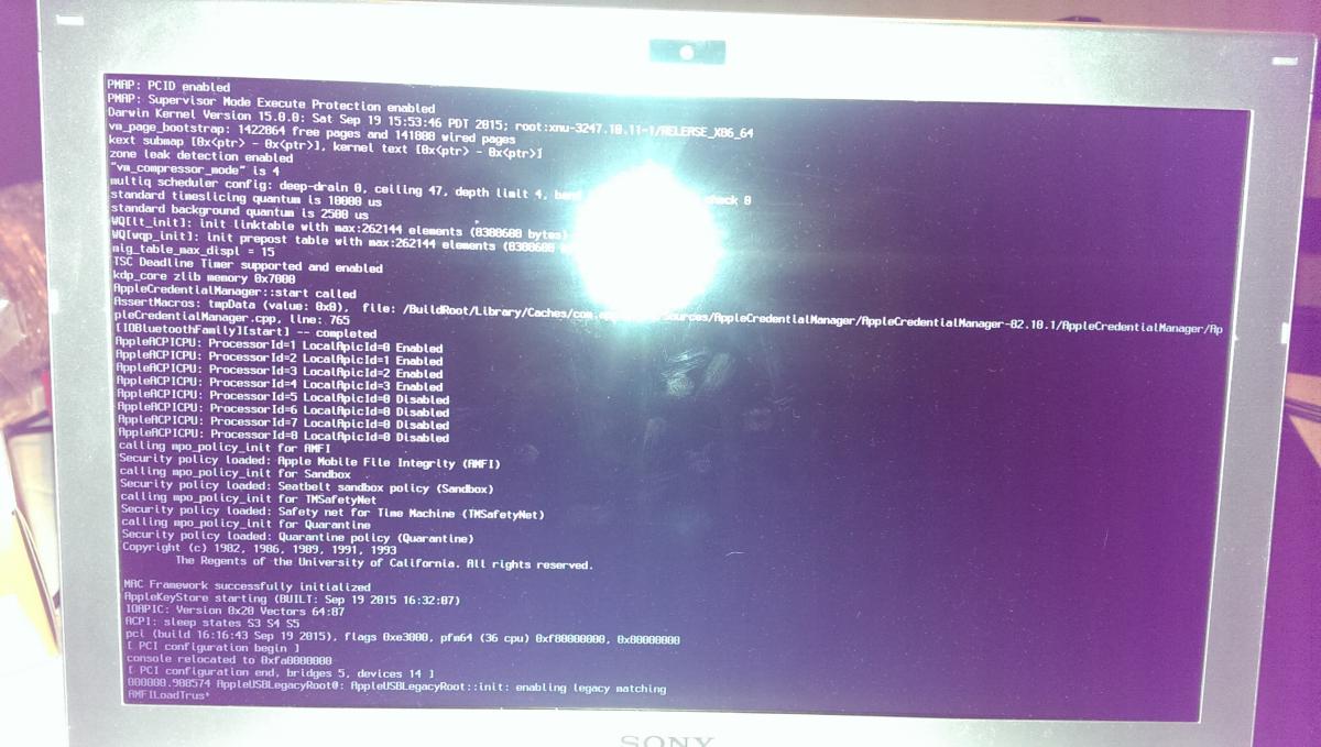

smccagg627 Posted November 13, 2015 Share Posted November 13, 2015 Thanks for those zips!.... Unfortunately, I still get the same error messages... however I played around with the clover options, and after letting it sit for 10 mins + I got a new screen... The Bluetooth thing transported correctly... However, it broke when it 'loaded' the next screen... It looked like a grey shade (like the mac os installer) however it broke with a bunch of vertical lines on the screen. Any tips? Link to comment https://www.insanelymac.com/forum/topic/300906-guide-install-mavericksyosemite-on-sony-vaio-s-2012-and-other-uefi-capable-vaios/page/17/#findComment-2188104 Share on other sites More sharing options...

midi-sama Posted November 13, 2015 Author Share Posted November 13, 2015 Guys, did you input the right ig-platform-id? If not it will certenly not work! Igp4 = 0x01660004 for 1600x900 and higher Igp3 = 0x01660003 for 1366x756 (or near) And make sure Fakesmc is in 10.11 AND "other" folder (may be the cause on some installs, so copy the "other" kexts too in other folder) Hope it works Link to comment https://www.insanelymac.com/forum/topic/300906-guide-install-mavericksyosemite-on-sony-vaio-s-2012-and-other-uefi-capable-vaios/page/17/#findComment-2188114 Share on other sites More sharing options...
smccagg627 Posted November 13, 2015 Share Posted November 13, 2015 Guys, did you input the right ig-platform-id? If not it will certenly not work! Igp4 = 0x01660004 for 1600x900 and higher Igp3 = 0x01660003 for 1366x756 (or near) And make sure Fakesmc is in 10.11 AND "other" folder (may be the cause on some installs, so copy the "other" kexts too in other folder) Hope it works Just tried it, and didn't work. I had high hopes. Link to comment https://www.insanelymac.com/forum/topic/300906-guide-install-mavericksyosemite-on-sony-vaio-s-2012-and-other-uefi-capable-vaios/page/17/#findComment-2188120 Share on other sites More sharing options...

peppershaker Posted November 13, 2015 Share Posted November 13, 2015 take a picture of the error screen and use USB3 port, if you have another USB stick (preferably 2.0) try that in the 3.0 port. Link to comment https://www.insanelymac.com/forum/topic/300906-guide-install-mavericksyosemite-on-sony-vaio-s-2012-and-other-uefi-capable-vaios/page/17/#findComment-2188122 Share on other sites More sharing options...

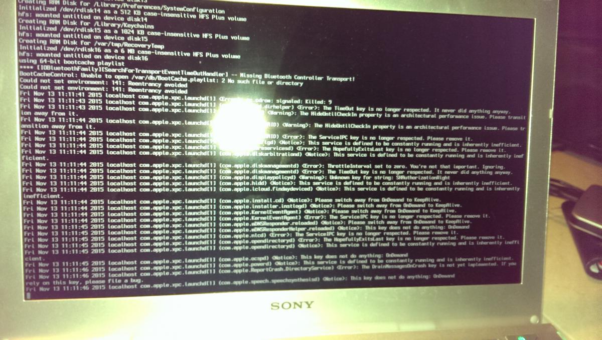

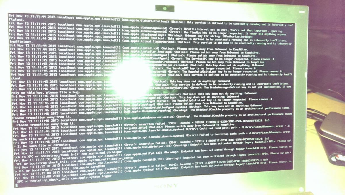

smccagg627 Posted November 13, 2015 Share Posted November 13, 2015 It's The same missing Bluetooth controller transport. I was just fussing around with the clover options before... And I forgot which arguments I had set and such... Now it keeps crashing with the error screen Cloud is running into Link to comment https://www.insanelymac.com/forum/topic/300906-guide-install-mavericksyosemite-on-sony-vaio-s-2012-and-other-uefi-capable-vaios/page/17/#findComment-2188123 Share on other sites More sharing options...
peppershaker Posted November 13, 2015 Share Posted November 13, 2015 try disabling cpu virtualization and discrete graphics in bios and try again It's The same missing Bluetooth controller transport.I was just fussing around with the clover options before... And I forgot which arguments I had set and such...Now it keeps crashing with the error screen Cloud is running into how long did you wait? try waiting around 15 mins Link to comment https://www.insanelymac.com/forum/topic/300906-guide-install-mavericksyosemite-on-sony-vaio-s-2012-and-other-uefi-capable-vaios/page/17/#findComment-2188124 Share on other sites More sharing options...
midi-sama Posted November 13, 2015 Author Share Posted November 13, 2015 Ok try making os x installer on a usn and clovee on another, when you get past "Mac.. .framwork ..." and get stuck just few lines after, then remove both usb, and plug the installer on any other one until it starts reading it again, it's a common 10.11 problem, imo I make a new partition on my hdd and make the installer in it (as if ot waa usb, then start it using clover I have on my hdd, it never fails me. Link to comment https://www.insanelymac.com/forum/topic/300906-guide-install-mavericksyosemite-on-sony-vaio-s-2012-and-other-uefi-capable-vaios/page/17/#findComment-2188125 Share on other sites More sharing options...

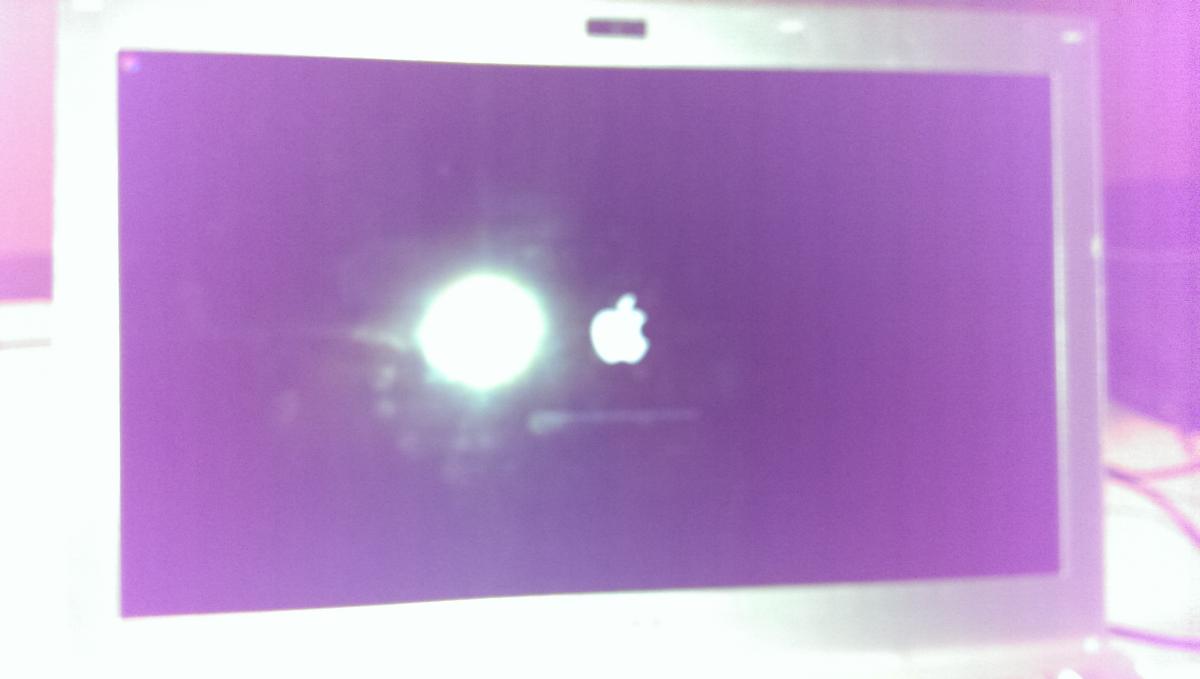

cloud1250000 Posted November 14, 2015 Share Posted November 14, 2015 Okay guys, got way farther now!! It doesn't move or do anything now tho.... Got the loading screen but nothing is happening... The USB key light do nothing... Only the loading icon in the top left corner that is still doing something ahah.. Anyway, used kext and drivers from peppershaker disabled virtualization technology in bios.. Can't disable discrete card... Running the last public bios.. And used the first usb3 port . Edit: Okay so I put the USB key back in the first USB port (the black one) and it crashed as before after looking for Bluetooth something... But!!!! I unplugged the USB key and put it back in another USB port (the middle one) and the boot ignored the crash and just go on :0 Link to comment https://www.insanelymac.com/forum/topic/300906-guide-install-mavericksyosemite-on-sony-vaio-s-2012-and-other-uefi-capable-vaios/page/17/#findComment-2188155 Share on other sites More sharing options...

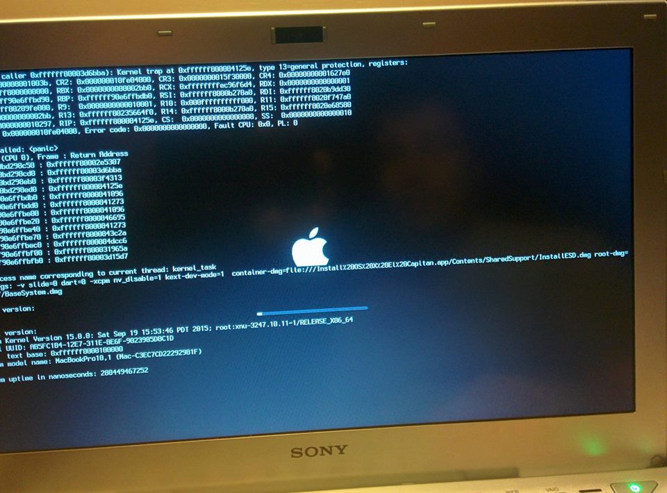

cloud1250000 Posted November 14, 2015 Share Posted November 14, 2015 Okay! I got farther again using the following configuration but it crashed after the first loading step Also, I did inject kext in clover boot menu (space bar on el capitan installer then kext inject option) (without kext inject, it just do the same as before, see loading but crashed before anything... and nothing to work with apart from Service exited with abnormal code: 255 before the loading show up) clover.zip Link to comment https://www.insanelymac.com/forum/topic/300906-guide-install-mavericksyosemite-on-sony-vaio-s-2012-and-other-uefi-capable-vaios/page/17/#findComment-2188183 Share on other sites More sharing options...
peppershaker Posted November 14, 2015 Share Posted November 14, 2015 you are missing generate p state and generate c state in clover config (under ACPI) also your SMBIOS is wrong, should be Macbook pro 9.2 try this config.plist.zip Link to comment https://www.insanelymac.com/forum/topic/300906-guide-install-mavericksyosemite-on-sony-vaio-s-2012-and-other-uefi-capable-vaios/page/17/#findComment-2188192 Share on other sites More sharing options...
cloud1250000 Posted November 14, 2015 Share Posted November 14, 2015 Result with my previous clover config and your config. Plist edit : nv_disable wasn't activated... trying that right now Edit2 : I enabled cstate and pstate and changed my smbios to 9.2 and it does exactly the same thing :'(. Should I disable virutalisation in my bios again? (I run a vm of el capitan in order to edit everything so I kinda like virtualization technology) Edit 3: not working without virtualization Link to comment https://www.insanelymac.com/forum/topic/300906-guide-install-mavericksyosemite-on-sony-vaio-s-2012-and-other-uefi-capable-vaios/page/17/#findComment-2188194 Share on other sites More sharing options...
