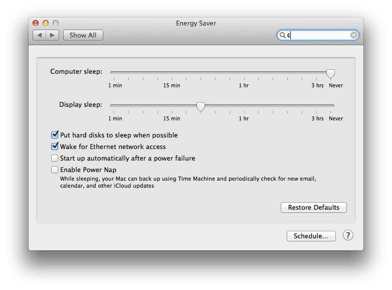

aoijsnlkd Posted July 1, 2014 Share Posted July 1, 2014 Is it possible for hackintosh to enable Power Nap for certain motherboards that have Intel Smart Connect Technology? Since both of this two technologies have a lot of similarities it makes me to think that this is possible. Is is possible by any ways to enable this from software patches to even BIOS mods? I believe that a lot had thought about this but I could not find much helpful threads and articles. Thanks in advanced for those who can help me. BTW I am using Z77 chipset (GA-Z77M-D3H) Link to comment Share on other sites More sharing options...
charliebounce Posted July 1, 2014 Share Posted July 1, 2014 The answer is YES! In my case, it was down to the SMBIOS settings I used. With iMac 13,2 and MacPro 5,1 and 6,1 i was able to get it working. As long as the power management/sleep is working properly Power Nap should work. 1 Link to comment Share on other sites More sharing options...

Stefan Milev Posted July 4, 2014 Share Posted July 4, 2014 This feature is something I'm really interested in. Unfortunately in my case the option is not there. Except for that the system works without any problem. Is this feature related to the processor I have (Sandy Bridge)? I tried the MacPro 5,1 and iMac 13,2 definitions in my Yosemite 10.10 DP2 partition, but no dice. Should I try something else? Link to comment Share on other sites More sharing options...
Hackmodford Posted July 4, 2014 Share Posted July 4, 2014 In addition to using the correct smbios you also need to have power management working. Also I do not believe power nap works with sandy bridge (don't quote me) Link to comment Share on other sites More sharing options...
charliebounce Posted July 4, 2014 Share Posted July 4, 2014 Ideally your CPU should be able to reach all the P-states that it is designed to have a perfectly working power management setup and subsequently power nap. Additionally the correct darkwake boot argument should be added that correspond the SMBIOS that are implemented. Common options are darkwake=0, darkwake=1, darkwake=8 and darkwake=10. Link to comment Share on other sites More sharing options...
aoijsnlkd Posted July 6, 2014 Author Share Posted July 6, 2014 Sorry for the late reply, Ideally your CPU should be able to reach all the P-states that it is designed to have a perfectly working power management setup and subsequently power nap. Additionally the correct darkwake boot argument should be added that correspond the SMBIOS that are implemented. Common options are darkwake=0, darkwake=1, darkwake=8 and darkwake=10. Do you know what's the difference between darkwake=0, darkwake=1, darkwake=8 and darkwake=10? Link to comment Share on other sites More sharing options...
charliebounce Posted July 6, 2014 Share Posted July 6, 2014 As far as I know and as far as my system is concerned: darkwake=0 -> Power Nap Disabled darkwake=1 -> Power Nap Fully Enabled (System fully wakes. Fans on, monitors on, Hourly) darkwake=2 darkwake=3 darkwake=4 darkwake=5 darkwake=6 darkwake=7 darkwake=8 -> Power Nap Enabled (System Fully wakes, sometimes monitor come on, sometimes not [don't know why]) darkwake=9 darkwake=10 -> Power Nap Enabled (Fans & monitors do not come on, system.log show the times that the computer woke from sleep. Time Machine Backup are performed hourly in sleep mode) darkwake=11 Hopefully the others can elaborate on the other dark wake states. 6 Link to comment Share on other sites More sharing options...

3square Posted October 24, 2014 Share Posted October 24, 2014 As far as I know and as far as my system is concerned: darkwake=0 -> Power Nap Disabled darkwake=1 -> Power Nap Fully Enabled (System fully wakes. Fans on, monitors on, Hourly) darkwake=2 darkwake=3 darkwake=4 darkwake=5 darkwake=6 darkwake=7 darkwake=8 -> Power Nap Enabled (System Fully wakes, sometimes monitor come on, sometimes not [don't know why]) darkwake=9 darkwake=10 -> Power Nap Enabled (Fans & monitors do not come on, system.log show the times that the computer woke from sleep. Time Machine Backup are performed hourly in sleep mode) darkwake=11 Hopefully the others can elaborate on the other dark wake states. when i set darkwake=8 or 10. computer sleeps but fans and lights are on. and i'm unable to wake it up. reset and it boot into yosemite as if it has woken up. power management problem? SMBIOS set to iMac13,2 and i'm able to turn on power nap from system preference. Does Intel Smart Connect needs to be on in BIOS? thanks. Link to comment Share on other sites More sharing options...
