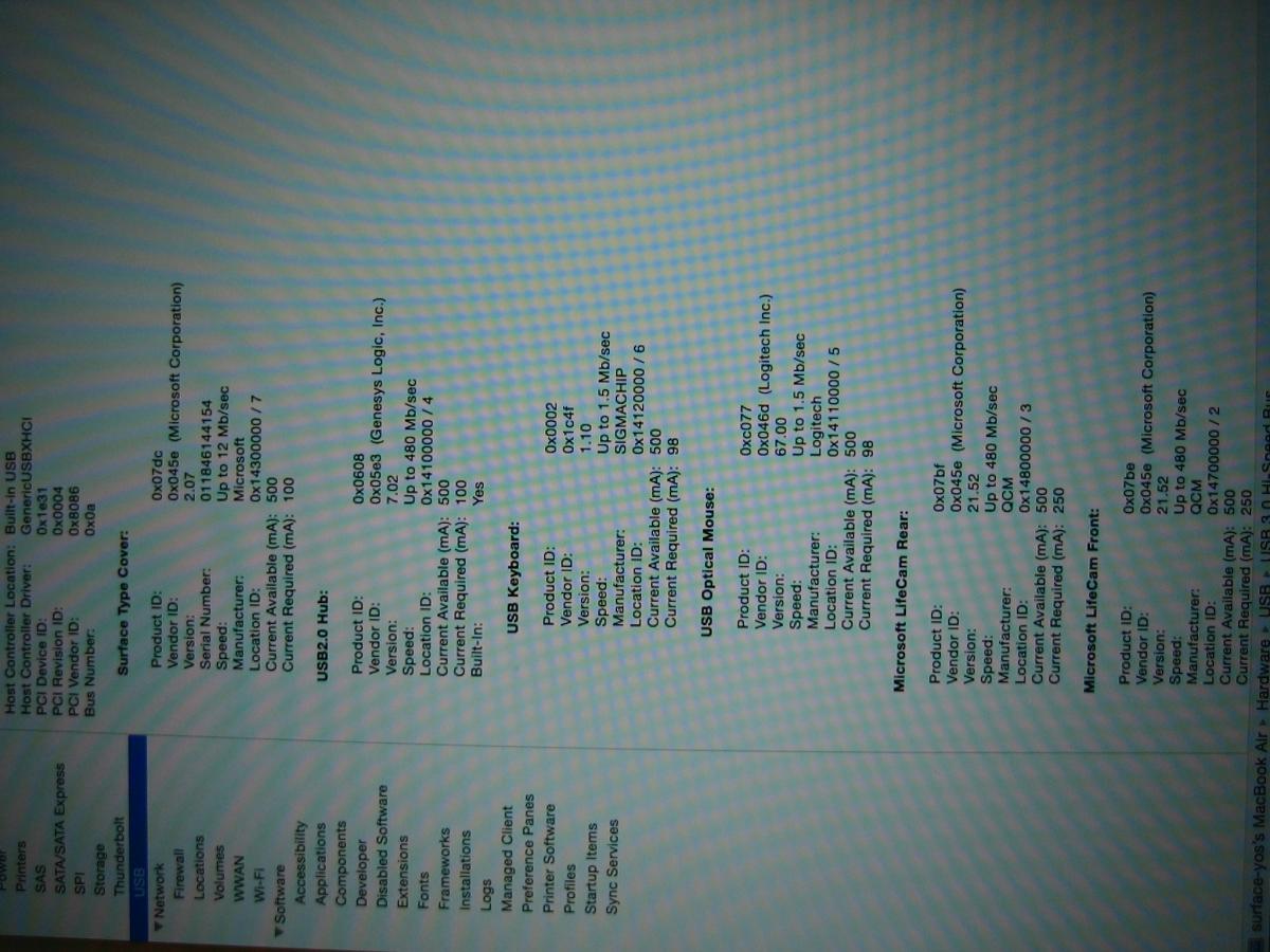

I find extremely unusual that the surface pro cover is detected by Yosemite system report but not functioning . Could be just that since we are loading the system with injected kexts the appropriate existent extension will not load?
In which case what could be the existent extension responsible for enabling the type cover ?
The type cover is not fully detected. If it was detected, the HID Manager would load HIDPointing and HIDKeyboard devices against the physical trackpad and keyboard. In contrast, the Dell Venue's tablet extension is detected and HID devices are attached but the trackpad still doesn't work - that would be an example of a device that is detected but not working.
I have a feeling that there is a USB 3.0 issue on the Surface causing the port to be switched off. Has anyone tried with the USB 3.0 controller switched off in the BIOS?

forgot to mention; with the type cover off surface, the system report does not generate any info. Sooner it is connected , it will appear in the system report.

For the type cover, I'm convinced that it's a USB 3.0 issue considering the Pro 3's type cover works on the Surface Pro 2.

as you can see in the IO Registry - the TypeCover is attached to the USB 2.0 Simulation hub:
Root <class IORegistryEntry>
128: XHCI Root Hub SS Simulation@14 <class IOUSBRootHubDevice>
3: USB3.0 Card Reader@15400000 <class IOUSBDevice>
129: XHCI Root Hub USB 2.0 Simulation@14 <class IOUSBRootHubDevice>
1: Microsoft LifeCam Front@14700000 <class IOUSBDevice>
2: Microsoft LifeCam Rear@14800000 <class IOUSBDevice>
4: Keyboard Hub@14100000 <class IOUSBHubDevice> -> my Apple USB keyboard integrated USB 2.0 Hub
6: Apple Keyboard@14120000 <class IOUSBDevice> -> my Apple USB keyboard itself
11: Mad Catz R.A.T.7 Mouse@14130000 <class IOUSBDevice> -> my USB mouse
18: Surface Type Cover@14300000 <class IOUSBDevice>
