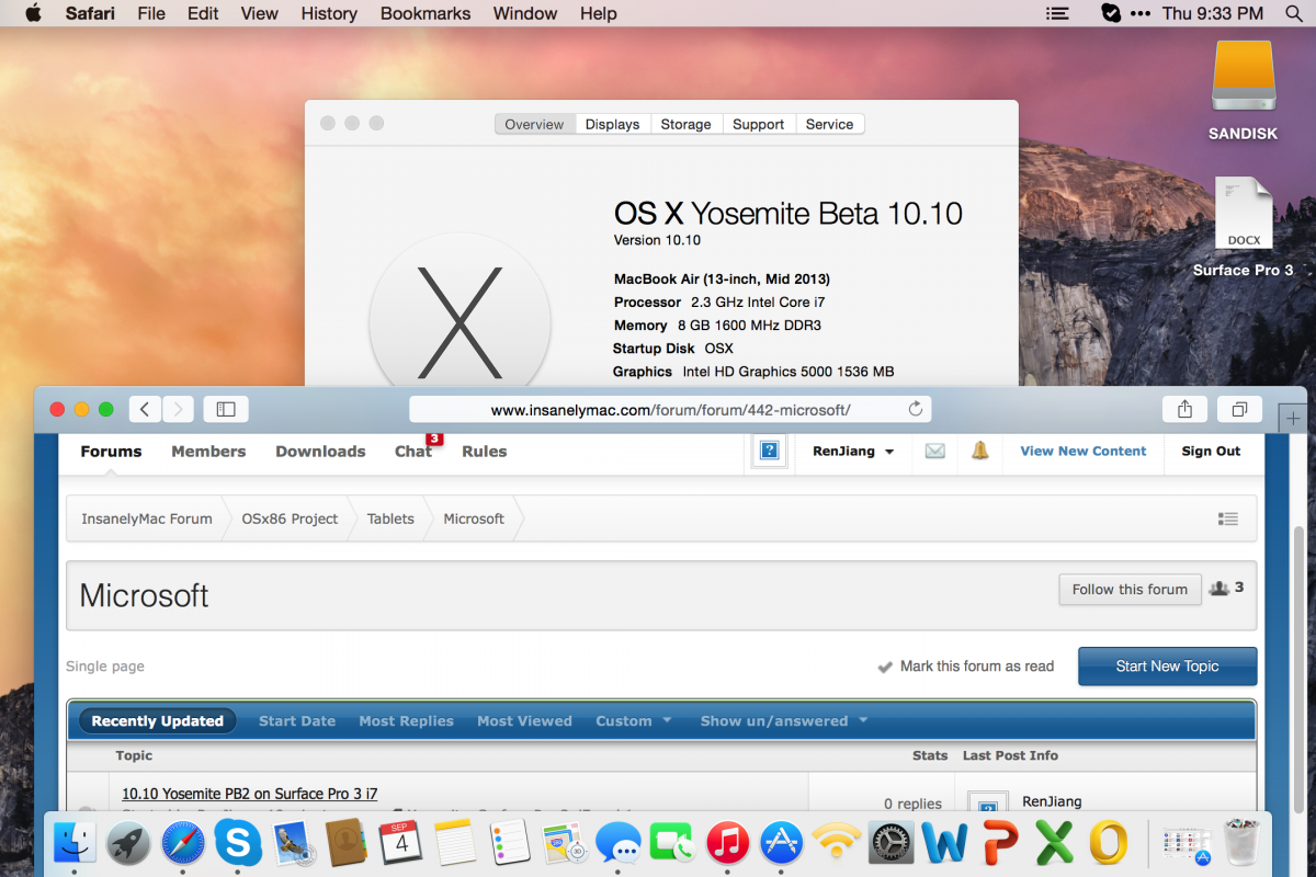

RenJiang Posted September 5, 2014 Share Posted September 5, 2014 Wanted to share my experience with installing Yosemite on a Surface Pro 3. What doesn't work: Touch Controls Wifi Bluetooth Type cover Graphic Artifacts after initial startup (resolves itself logging out and then in again) Things tried: Audio works with the Voodoo kext. Installed a bluetooth adapter (Asus) for bluetooth. Used NullEthernet to fix imessage/itunes/facetime etc. Installed an external wifi usb adapter which worked but uninstalled because the adapter's performance was disappointing (any suggestions for a good wifi usb adapter?). Also, the usb ethernet adapter works. Enabled hidpi using Quartz debug (installed Xcode beta) and the clarity is amazing. Airplay tested and works as well. Tried with both an airport express and an apple tv. ---------- This was my first hackintosh and I've learned a lot from this experience and this forums. A thank you to the community. To me, this surface pro 3 hackintosh feels like 80% complete and usable. Mainly, it's missing n-trig kexts and getting the type cover to work . Link to comment https://www.insanelymac.com/forum/topic/299021-macosx-on-the-surface-pro-3/page/2/#findComment-2057942 Share on other sites More sharing options...
Mirone Posted September 5, 2014 Share Posted September 5, 2014 look here: http://www.insanelymac.com/forum/files/file/294-surfacepro-1°gen-files-package/ Your audio codec is Alc280? Link to comment https://www.insanelymac.com/forum/topic/299021-macosx-on-the-surface-pro-3/page/2/#findComment-2057944 Share on other sites More sharing options...
RenJiang Posted September 5, 2014 Share Posted September 5, 2014 According to ifixit, it's Realtek ALC3264 Audio Codec. Should of mentioned, that I already tried the Yosemite compatible AppleHDA kexts and it didn't work for me. Link to comment https://www.insanelymac.com/forum/topic/299021-macosx-on-the-surface-pro-3/page/2/#findComment-2057947 Share on other sites More sharing options...
Mirone Posted September 5, 2014 Share Posted September 5, 2014 send me your codec_dump. http://www.insanelymac.com/forum/topic/295001-guide-to-patch-applehda-for-your-codec/ Link to comment https://www.insanelymac.com/forum/topic/299021-macosx-on-the-surface-pro-3/page/2/#findComment-2057949 Share on other sites More sharing options...
RenJiang Posted September 5, 2014 Share Posted September 5, 2014 Codec dump attached codec_dump.txt Link to comment https://www.insanelymac.com/forum/topic/299021-macosx-on-the-surface-pro-3/page/2/#findComment-2057965 Share on other sites More sharing options...
Mirone Posted September 5, 2014 Share Posted September 5, 2014 this is the codec dump your HDMI send me the two files generated. Link to comment https://www.insanelymac.com/forum/topic/299021-macosx-on-the-surface-pro-3/page/2/#findComment-2058017 Share on other sites More sharing options...
RenJiang Posted September 5, 2014 Share Posted September 5, 2014 Codec: Realtek ALC288 Codec dump attached now. card0-codec#0.txt card1-codec#0.txt Link to comment https://www.insanelymac.com/forum/topic/299021-macosx-on-the-surface-pro-3/page/2/#findComment-2058028 Share on other sites More sharing options...
Mirone Posted September 5, 2014 Share Posted September 5, 2014 later send you a kext. 1 Link to comment https://www.insanelymac.com/forum/topic/299021-macosx-on-the-surface-pro-3/page/2/#findComment-2058034 Share on other sites More sharing options...
RenJiang Posted September 5, 2014 Share Posted September 5, 2014 Thanks Mirone. I'd be glad to try it. Looking forward to it. Link to comment https://www.insanelymac.com/forum/topic/299021-macosx-on-the-surface-pro-3/page/2/#findComment-2058040 Share on other sites More sharing options...
RenJiang Posted September 6, 2014 Share Posted September 6, 2014 Attached verbs output files (attempted to follow the guide, but this is as far as i could get with my limited knowledge). verbitdebug.txt verbs.txt ioreg.txt config.plist.txt dsdt.aml.txt 1 Link to comment https://www.insanelymac.com/forum/topic/299021-macosx-on-the-surface-pro-3/page/2/#findComment-2058213 Share on other sites More sharing options...
