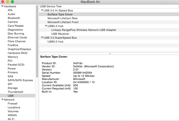

If you're referring to the typecover, it doesn't work at all.
If you mean that you have an external USB mouse and keyboard and it still doesn't work, try the kext from here: https://github.com/RehabMan/OS-X-Generic-USB3
Edit: sorry, didn't read that you don't have an external mouse. You'll need to get a hub, mouse and external keyboard because the typecover doesn't work yet.
There are USB 3 issues galore with the new tablets. The keyboard extensions don't work on either the Dell or the Surface.

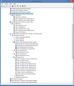

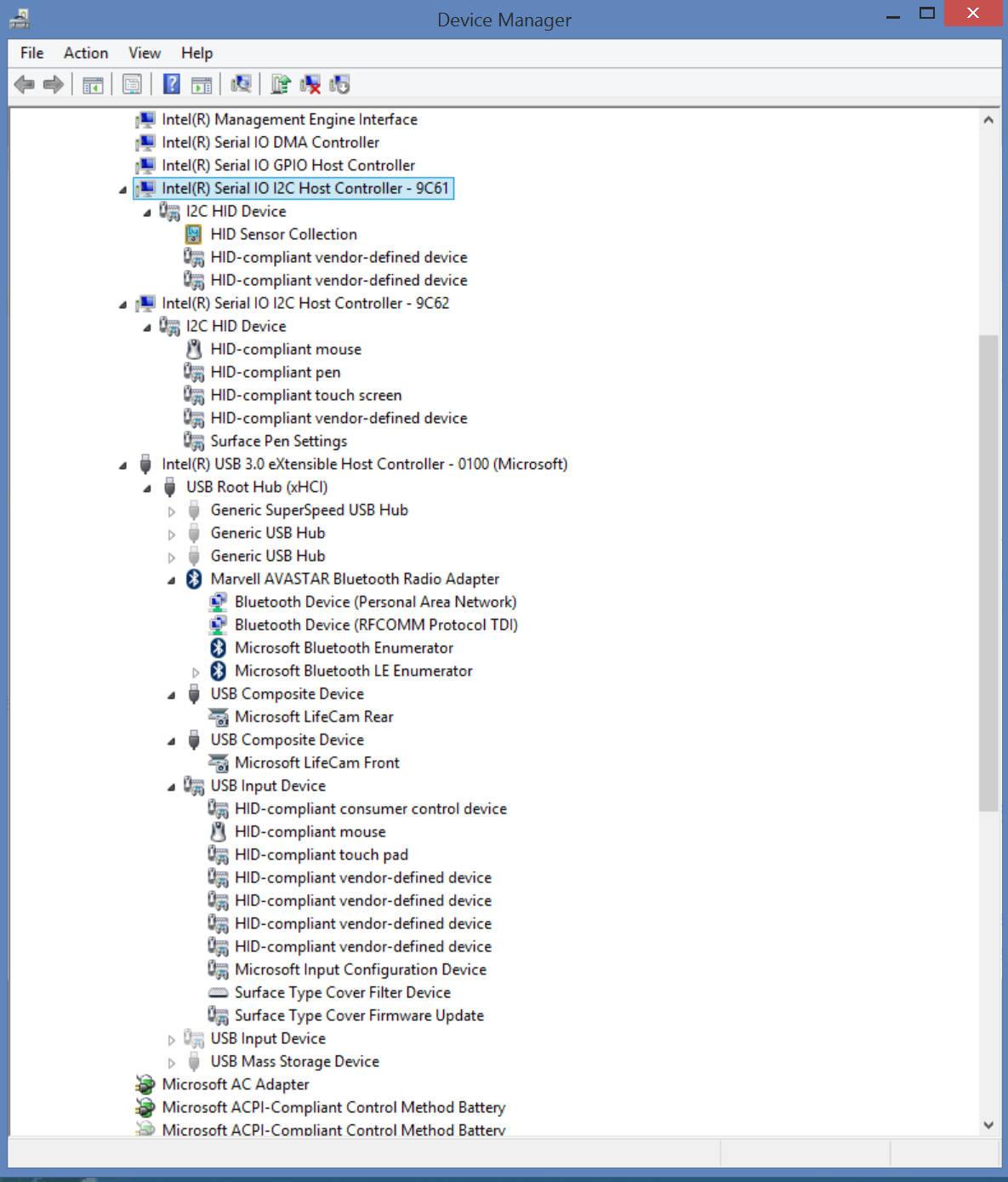

First I want to see if the BTKL device (Bluetooth RF Kill) is used on the Surface. Can you please boot Windows and go into the device manager and check for a certain "
Intel Bluetooth USB HW RFKilldevice. I am not sure where it will be in the Device Manager but if I have to wager a guess, it will be in the "System devices" section. If not, just check all sections to see if the device is there. If you can't find it, can you provide the device IDs of the Wifi and BT cards please.
Hi Alex,
here are my device IDs:
Marvell AVASTAR Bluetooth Radio Adapter
Port_#0006.Hub_#0001
USB\VID_1286&PID_204B&REV_3201
Marvell AVASTAR Wireless-AC Network Controller
PCI-Slot 2 (PCI-Bus 1, Device 0, Function 0)
PCI\VEN_11AB&DEV_2B38&SUBSYS_045E0001&REV_00

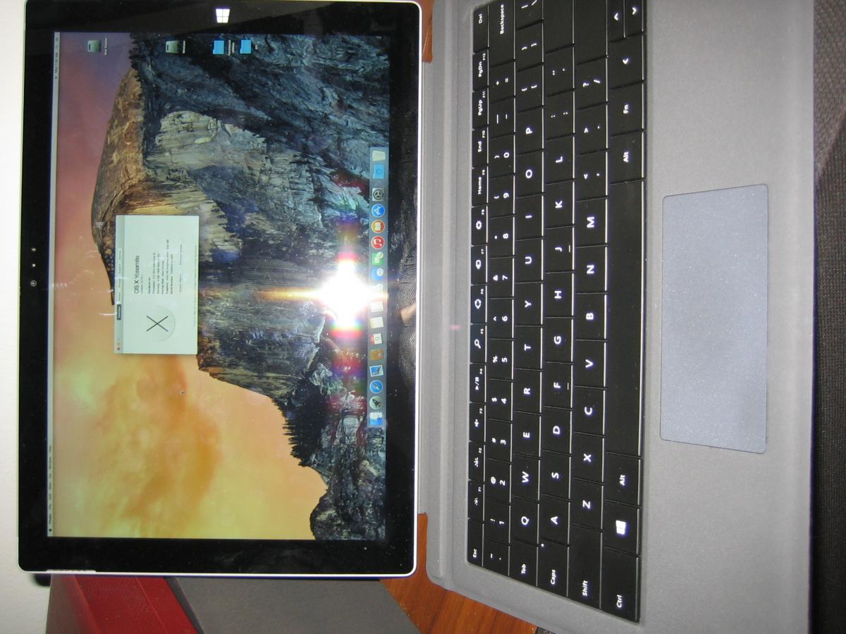

Alright so lets recap. Although I read all tutorials online as best I could, i had hard times installing Yosemite on my surface pro 3 .  But I am up and running now with Yosemite boot from SSD.
So what I have done thus far;
  1. Have installed Yosemite on a 8gb memory stick using the tutorial existent here;  http://www.insanelymac.com/forum/topic/301884-guide-surface-pro-1st-gen-yosemite-clean-installation including clover + drivers provided  SurfacePro V0.5.1 files Pack up to the Part 3 from tutorial
  2. Replace the clover Plist with the file supplied here;    Surface Pro 3 Clover Config.zip  (first page in this thread)
  3. Using an USB hub i plunged in an USB mouse + USB keyboard + the original USB stick with Yosemite and clover installation done at chapter 1.
  4. Started the surface pro with USB boot enable and safe boot disabled in Bios

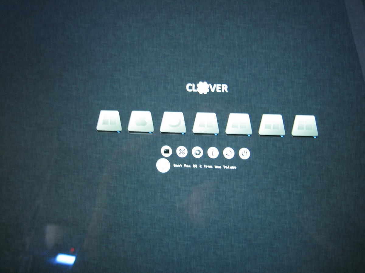

  5. At the clover boot, i selected the stick drive where the Yosemite installer is, press space key choosing from the menu Boot Mac OS injection with Kext  NOT ( the option without caches and with injected Kext)
  6. After initiation of the hardware , Mac Installer starts , proceed further with Disk Utility, format partition using Mac Extended.
  7. After first restart the tablet will restart in windows. Restart again with boot from USB doing the steps indicated at number 4 and 5.
  8. Mac installer will continue to install the system until the end, chose country, language, login name and password, DONE.
The trick part is to actually get to boot your surface from either windows or Yosemite without a USB help.
  1. Install latest EFI clover boot onto the newest Mac OS drive where Yosemite has been installed (same as you have installed initially clover on to the USB stick)
  2. Reboot into windows.
  3. You must enable the EFI partition in windows to be accessible and writeable using File Manager. Use this tutorial http://defaultreasoning.com/2009/05/29/unhide-the-recovery-partition-on-a-basic-disk-with-diskpart/
  4. Then after EFI drive becomes visible and accessible, you must simple replace the entire EFI folder installed at step 1 with the EFI from your installing memory stick.
  5. Restart again your computer booting one more time from the same memory stick used to install Mac Os Yosemite.
  6. At the clover boot menu go to both "clover boot options" existent then press space for each enabling "add clover boot options for all entries
That is it, the next restart clover will be enabled automatically and you can safe boot from either windows or Yosemite. Remember to always boot using boot with injected Kext)
My surface pro 3 has been identified as MacBook Air
sound + wifi + type cover + others not working. Here is where I need help finding the appropriate drivers for all these. Hopefully others will chime in adding Kext that are required or explaining how to enable these...
