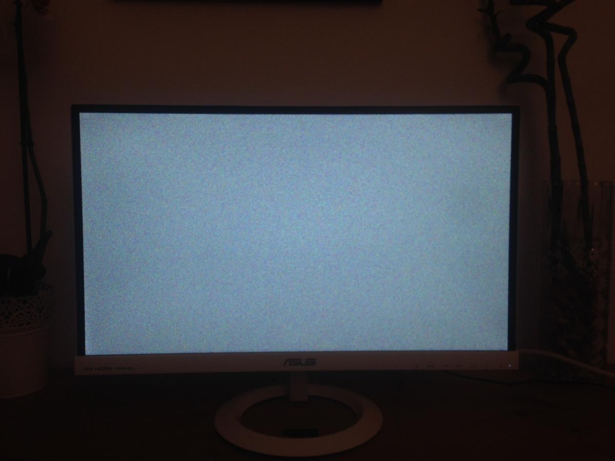

rimkashox Posted May 31, 2015 Share Posted May 31, 2015 Hello guys, first of all I want to say a big THANKS to all of you devs and hackers who are making our lives so much better every day ! Too many names come to mind Netkas, RehabMan, Toleda... And anyone actively searching for solutions to get mac running on pc ... You guys are INSANELY GREAT I have a new build running almost perfectly: i7 4790k on GA-z97x-UD3H with latest bios F8 Using integrated HD 4600 Connected to HDMI to Asus VX239W SMBios is iMac 15,1 Framebuffer looks like Azul native and QE/CI appear to be working fine, no flickering, chess game ok etc.. all good, just a very annoying of 10 sec of FUZZY analog signal before login screen... It has not changed from the very beginning of my install, same with Clover, Chameleon, DSDT-free or even patched DSDT. Now I'm not using any injectors just a more or less clean DSDT, and am injecting directly this: Device (GFX0) { Name (_ADR, 0x00020000) // _ADR: Address Method (_DSM, 4, NotSerialized) { If (LEqual (Arg2, Zero)) { Return (Buffer() { 0x03 } ) } Return (Package() { "AAPL,ig-platform-id", Buffer() { 0x03, 0x00, 0x22, 0x0D }, "hda-gfx", Buffer() { "onboard-1" }, "device-id", Buffer() { 0x12, 0x04, 0x00, 0x00 }, }) } } On the boot log, I can see something interesting, it's trying to match the display or something... Please take a look: 31/05/15 12:01:34,205 WindowServer[135]: Found 21 modes for display 0x00000000 [21, 0] 31/05/15 12:01:34,207 WindowServer[135]: Found 1 modes for display 0x00000000 [1, 0] 31/05/15 12:01:34,209 WindowServer[135]: Found 1 modes for display 0x00000000 [1, 0] 31/05/15 12:01:34,209 WindowServer[135]: mux_initialize: Couldn't find any matches 31/05/15 12:01:34,212 WindowServer[135]: Found 21 modes for display 0x00000000 [21, 0] 31/05/15 12:01:34,219 WindowServer[135]: Found 1 modes for display 0x00000000 [1, 0] 31/05/15 12:01:34,220 WindowServer[135]: Found 1 modes for display 0x00000000 [1, 0] 31/05/15 12:01:34,283 WindowServer[135]: WSMachineUsesNewStyleMirroring: true 31/05/15 12:01:34,316 WindowServer[135]: Display 0x1a48a060: GL mask 0x1; bounds (0, 0)[1920 x 1080], 21 modes available Main, Active, on-line, enabled, boot, Vendor 469, Model 23e1, S/N 5821, Unit 0, Rotation 0 UUID 0xed66da45394f2facad90d3e148bb16b9 31/05/15 12:01:34,316 WindowServer[135]: Display 0x003f003f: GL mask 0x8; bounds (0, 0)[4096 x 2160], 2 modes available off-line, enabled, Vendor ffffffff, Model ffffffff, S/N ffffffff, Unit 3, Rotation 0 UUID 0xffffffffffffffffffffffffffffffff 31/05/15 12:01:34,316 WindowServer[135]: Display 0x003f003e: GL mask 0x4; bounds (0, 0)[0 x 0], 1 modes available off-line, enabled, Vendor ffffffff, Model ffffffff, S/N ffffffff, Unit 2, Rotation 0 UUID 0xffffffffffffffffffffffffffffffff 31/05/15 12:01:34,316 WindowServer[135]: Display 0x003f003d: GL mask 0x2; bounds (0, 0)[0 x 0], 1 modes available off-line, enabled, Vendor ffffffff, Model ffffffff, S/N ffffffff, Unit 1, Rotation 0 UUID 0xffffffffffffffffffffffffffffffff 31/05/15 12:01:34,322 WindowServer[135]: Set a breakpoint at CGSLogError to catch errors as they are logged. 31/05/15 12:01:34,322 WindowServer[135]: WSSetWindowTransform: Singular matrix 31/05/15 12:01:34,322 WindowServer[135]: WSSetWindowTransform: Singular matrix 31/05/15 12:01:34,324 WindowServer[135]: Display 0x1a48a060: GL mask 0x1; bounds (0, 0)[1920 x 1080], 21 modes available Main, Active, on-line, enabled, boot, Vendor 469, Model 23e1, S/N 5821, Unit 0, Rotation 0 UUID 0xed66da45394f2facad90d3e148bb16b9 31/05/15 12:01:34,324 WindowServer[135]: Display 0x003f003f: GL mask 0x8; bounds (2944, 0)[1 x 1], 2 modes available off-line, enabled, Vendor ffffffff, Model ffffffff, S/N ffffffff, Unit 3, Rotation 0 UUID 0xffffffffffffffffffffffffffffffff 31/05/15 12:01:34,324 WindowServer[135]: Display 0x003f003e: GL mask 0x4; bounds (2945, 0)[1 x 1], 1 modes available off-line, enabled, Vendor ffffffff, Model ffffffff, S/N ffffffff, Unit 2, Rotation 0 UUID 0xffffffffffffffffffffffffffffffff 31/05/15 12:01:34,324 WindowServer[135]: Display 0x003f003d: GL mask 0x2; bounds (2946, 0)[1 x 1], 1 modes available off-line, enabled, Vendor ffffffff, Model ffffffff, S/N ffffffff, Unit 1, Rotation 0 UUID 0xffffffffffffffffffffffffffffffff 31/05/15 12:01:34,324 WindowServer[135]: CGXPerformInitialDisplayConfiguration 31/05/15 12:01:34,324 WindowServer[135]: Display 0x1a48a060: Unit 0; Vendor 0x469 Model 0x23e1 S/N 22561 Dimensions 20.04 x 11.26; online enabled, Bounds (0,0)[1920 x 1080], Rotation 0, Resolution 1 31/05/15 12:01:34,324 WindowServer[135]: Display 0x003f003f: Unit 3; Vendor 0xffffffff Model 0xffffffff S/N -1 Dimensions 0.00 x 0.00; offline enabled, Bounds (2944,0)[1 x 1], Rotation 0, Resolution 1 31/05/15 12:01:34,324 WindowServer[135]: Display 0x003f003e: Unit 2; Vendor 0xffffffff Model 0xffffffff S/N -1 Dimensions 0.00 x 0.00; offline enabled, Bounds (2945,0)[1 x 1], Rotation 0, Resolution 1 31/05/15 12:01:34,324 WindowServer[135]: Display 0x003f003d: Unit 1; Vendor 0xffffffff Model 0xffffffff S/N -1 Dimensions 0.00 x 0.00; offline enabled, Bounds (2946,0)[1 x 1], Rotation 0, Resolution 1 Could suggest a fix for this ? Attached is my patched DSDT.dsl, original DSDT.aml, and IO Registry output from IOJones... If you need anything else, don't hesitate !!! Files.zip Link to comment https://www.insanelymac.com/forum/topic/298591-intel-hd-4600-qeci-yosemite/page/19/#findComment-2140321 Share on other sites More sharing options...
toleda Posted May 31, 2015 Share Posted May 31, 2015 Could suggest a fix for this ? Framebuffer has 3 DP ports. Motherboard HDMI connector is using a framebuffer DP connector. Consider an edit to the framebuffer. See graphics_Intel_framebuffers, try azul-a patch. 1 Link to comment https://www.insanelymac.com/forum/topic/298591-intel-hd-4600-qeci-yosemite/page/19/#findComment-2140355 Share on other sites More sharing options...
