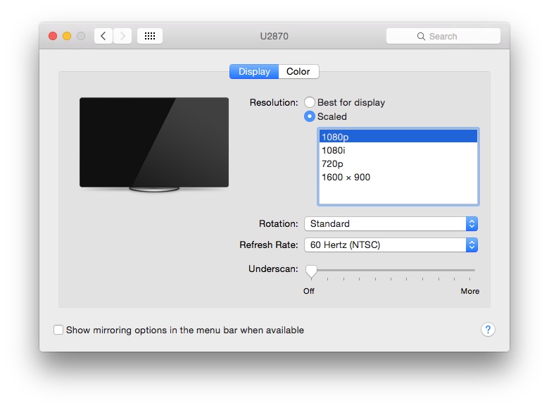

fisherwei Posted November 2, 2014 Share Posted November 2, 2014 I updated guide and kext after getting a bunch of messages hopefully this helps Hello Iron, I have a reference design R9 290 with*OUT* X, can I use HDMI outputing 3840x2160@30Hz to monitor(in windows it is OK). Now, it is only 1080p option can be selected. Link to comment https://www.insanelymac.com/forum/topic/298443-r9-290-non-x-yosemited-help/page/2/#findComment-2079887 Share on other sites More sharing options...

kvonlinee Posted November 11, 2014 Share Posted November 11, 2014 Hello Iron, I have a reference design R9 290 with*OUT* X, can I use HDMI outputing 3840x2160@30Hz to monitor(in windows it is OK). Now, it is only 1080p option can be selected. Screen Shot 2014-11-02 at 2.44.48 PM.jpg How is resolution of your monitor? Singal may passthrougth but actual display will show the resolution. Link to comment https://www.insanelymac.com/forum/topic/298443-r9-290-non-x-yosemited-help/page/2/#findComment-2083893 Share on other sites More sharing options...
