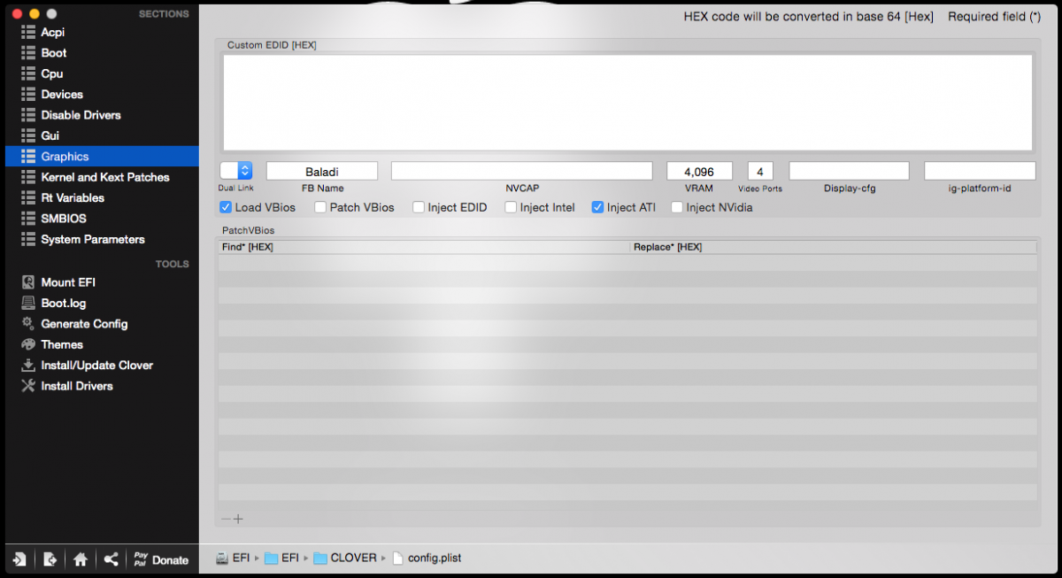

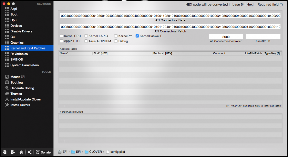

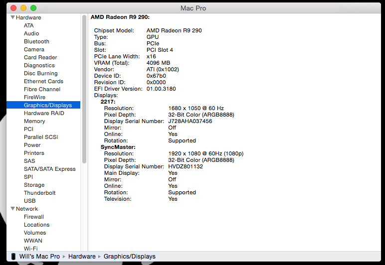

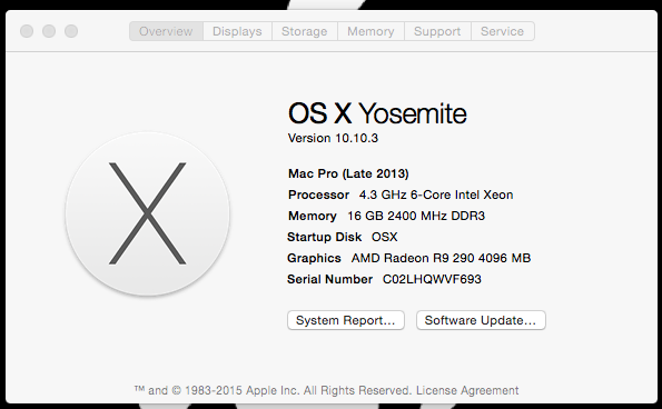

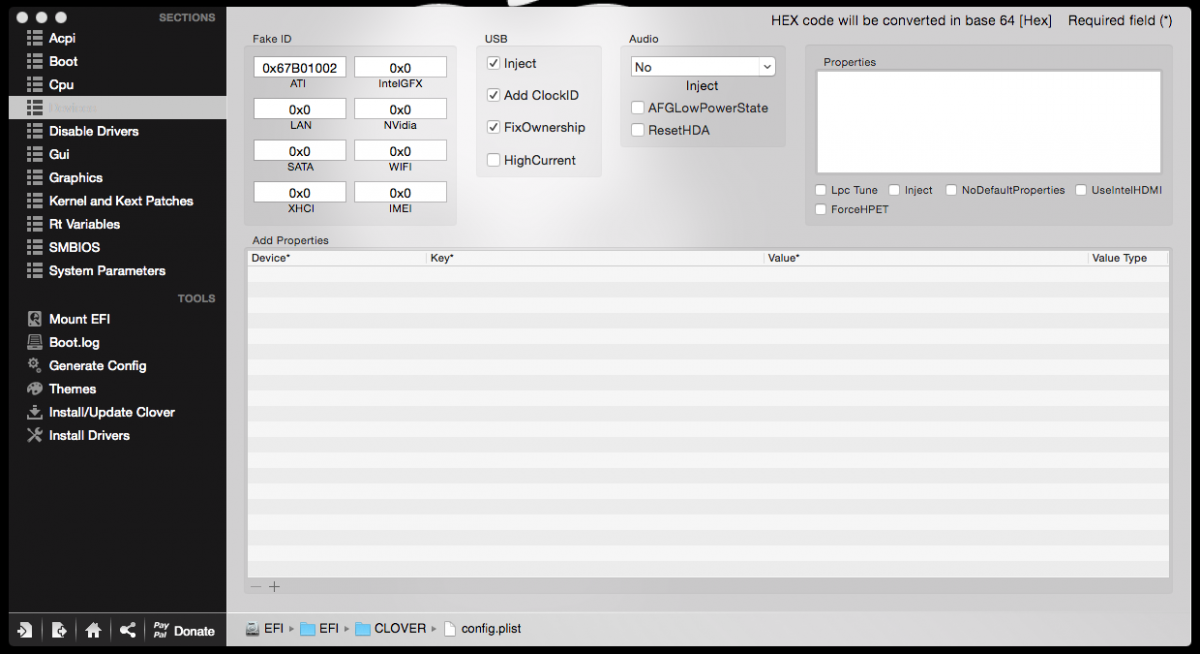

Audiohacks Posted March 11, 2015 Share Posted March 11, 2015 I have getting the R9 290 Tri-x OC 4Gbs Card fully working in 10.10.3 public beta. With all video out puts working and HDMI audio. I did this with clover. here are 3 pics of my clover setting. Link to comment https://www.insanelymac.com/forum/topic/298443-r9-290-non-x-yosemited-help/page/3/#findComment-2118775 Share on other sites More sharing options...

Audiohacks Posted March 13, 2015 Share Posted March 13, 2015 did you ever get more than two screens working? I have it fully working. all ports. here is the clover setup you will need. Also i am using the 8000 and 4000 kext from 10.10.3 beta R9 290 Info List For Clover DEVICES Facke ID ( 0x67B01002 ) GRAPHICS FB Name ( Baladi ) VRAM ( The amount your 290 has. If you have 4GBs then it will be 4,096.) Video ports ( 4 ) KERNEL AND KEXT PATCHES ATI Connectors Data 000400000403000000010300120403030004000004030000000101001102010100040000040300000001020021030202000400000403000000010400220504040004000004030000000105001000050500040000040300000001060020010606 ATI Connectors Patch 000800000402000000010200220502030004000004030000000101011204010100040000040300000001020021030202040000001402000000010300110203040004000004030000000105001000050500020000040200000001040110000406 ATI Connectors Controller ( 8000) 1 Link to comment https://www.insanelymac.com/forum/topic/298443-r9-290-non-x-yosemited-help/page/3/#findComment-2119596 Share on other sites More sharing options...
Audiohacks Posted March 22, 2015 Share Posted March 22, 2015 did you ever get more than two screens working? Yes i did. And after a lot of time spent trying different things. The only way i got this to work is by installing Xcode 6.3 beta 2. After you have set up your clover config with the above setting. Then launch Xcode, let it install everything. Then run Onyx and repair Disk permissions. Then go to the cleaning tab and check the box for Kernel and extensions. Execute and restart and you should be able to plug the second screen in.. Link to comment https://www.insanelymac.com/forum/topic/298443-r9-290-non-x-yosemited-help/page/3/#findComment-2122050 Share on other sites More sharing options...
