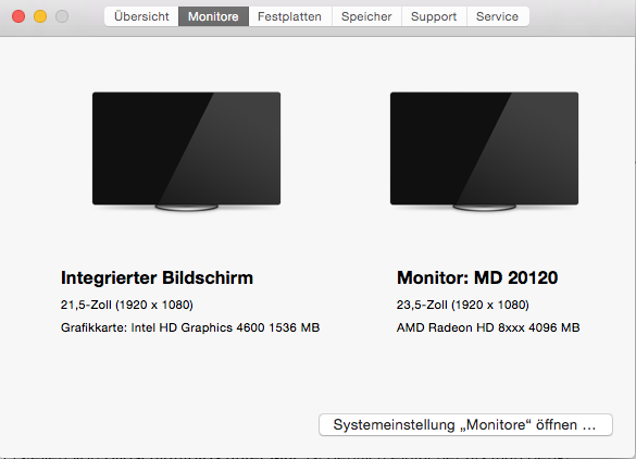

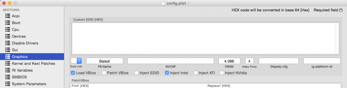

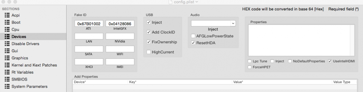

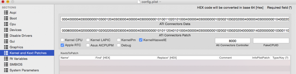

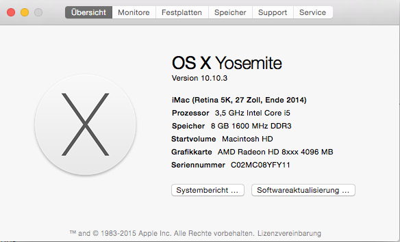

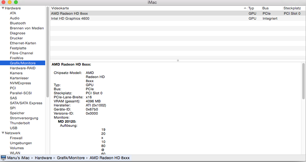

Buddz1990 Posted June 24, 2015 Share Posted June 24, 2015 Sorry for my bad english but i have some information i want to share with you guys ! This is for everyone with a Sapphire Radeon R9 290 Tri-X OC AND a Intel HD Graphics 4600 Desktop who is using Clover as their bootloader - i finally could get both units to work proper with full acceleration on 10.10.3, which means i can usw 2 Displays without any glitches or slowdowns or something =) BIG THANKS to the Member Audiohacks for sending me the oh so needed files for the R9 ! First of all enter your UEFI/BIOS and set the intel gpu as the initial gpu What i did for the R9 to get to work: 1. Install the Kexts R9 290 10.10.3 Files.zip ( i repeat: i did this on 10.10.3 so i dont know about other versions ) 2. open your clover config.plist in Devices -> ATI -> paste 0x67B01002 in Graphics -> FB Name -> paste Baladi VRAM -> paste 4096 Video Ports -> 4 Check LoadVBios in Kernel and Kext Patches -> ATI Connectors Data paste: 000400000403000000010300120403030004000004030000000101001102010100040000040300000001020021030202000400000403000000010400220504040004000004030000000105001000050500040000040300000001060020010606 -> ATI Connectors Patch paste: 000800000402000000010200220502030004000004030000000101011204010100040000040300000001020021030202040000001402000000010300110203040004000004030000000105001000050500020000040200000001040110000406 ATI Connectors Controller -> 8000 Save and reboot and now your R9 290 should work fine with one port in use (ive tested hdmi and dvi) What i did to get the Intel HD Graphics 4600 Desktop to work: 1. open your clover config.plist in Devices -> IntelGFX -> paste 0x04128086 on the right sight check ->UseIntelHDMI in Graphics -> check Inject Intel Save and reboot and now also the Intel GPU should run flawlessly Check out the screenshots below! im so happy to finally get what i wanted all the time..ive been trying around for so long and been searching the net like hell and somehow it all worked now =) i really hope i could help someone with this little guide! bless! Link to comment https://www.insanelymac.com/forum/topic/298443-r9-290-non-x-yosemited-help/page/5/#findComment-2147699 Share on other sites More sharing options...
