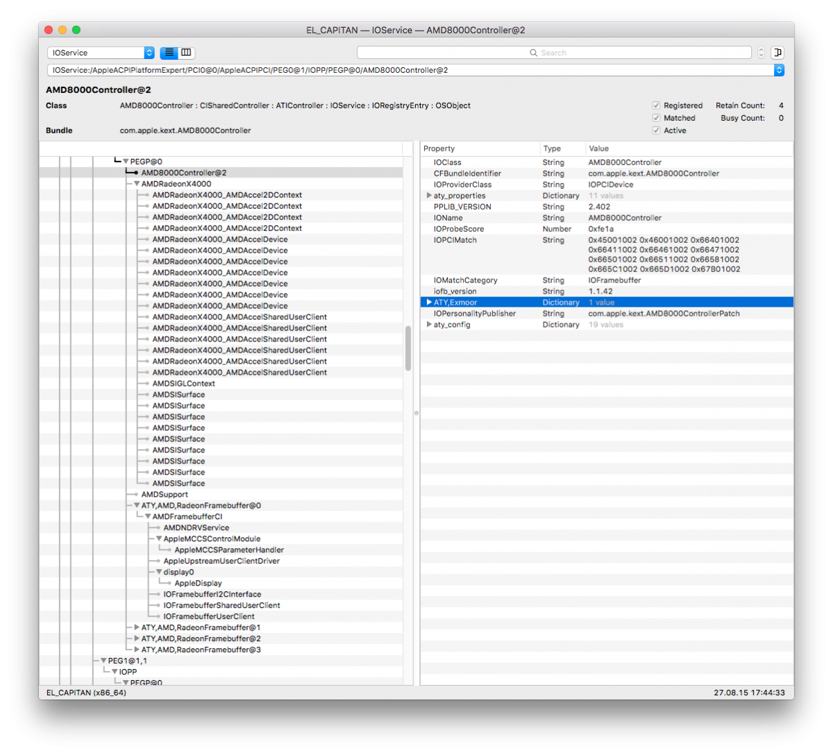

Mork vom Ork Posted August 27, 2015 Share Posted August 27, 2015 I have the following problem: got SAPHIRE R7 260X 2GB with UEFI-Bios here. No matter, how i configure my CLOVER (latest Edition r3561), i'll never get the fake-id for ATI injected (using 0x66401002). The original ID is 0x66581002. If i patch the info.plist of AMD8000Controller.kext and AMDRadeonX4000.kext, the Card will work fully supported, but uses allways "ATY, AMDRadeonframebuffer". Could not determine, which Framebuffer to use to patch the card working with DP and HDMI. My config.plist of CLOVER uses the follwing entries: <key>Graphics</key> <dict> <key>DualLink</key> <integer>1</integer> <key>FBName</key> <string>Exmoor</string> <key>Inject</key> <dict> <key>ATI</key> <true/> <key>Intel</key> <false/> <key>NVidia</key> <false/> </dict> <key>InjectEDID</key> <true/> <key>NvidiaSingle</key> <false/> <key>PatchVBios</key> <true/> <key>VRAM</key> <integer>2048</integer> <key>VideoPorts</key> <integer>4</integer> </dict> <key>KernelAndKextPatches</key> <dict> <key>ATIConnectorsController</key> <string>8000</string> <key>ATIConnectorsData</key> <string>020000000001000000010103220502040200000000010000000102031204010300040000040300000001030711020301000400000001000000010403210305050004000004030000000105071000040200040000000100000001060320010505</string> <key>ATIConnectorsPatch</key> <string>000800000402000000010000220501030004000004030000000100071204020100040000040300000001000021030302040000001402000000010000110204040004000004030000000100001000050500020000140200000001000010000606</string> Attached you can find my CLOVER.plist - CLOVER BootLog - IORegistry Screenshot, DPCIManager Screenshot and Systeminfo Screenshot. Card seems to be fully supportet, no glitches or artifacts, full Quarz/CE - but just standard AMD Framebuffer. As you can see in the Bootlog file, Clover did not use the FakeID for ATI. PS: forget to mention, that i dont use any SSDT or DSDT files. There is one more thing: even if i use unpatched kexts of AMD8000Controller and AMDRadeonX4000 and within CLOVER the option to inject FakeID 0x66401002, it seems, that the FakeID would not be implemented during bootup. Even than got the same entries within CloverBootLog (see attached File). BTW: System is EL CAPITAN DP7 rev 15A263E CLOVER_BOOT_LOG.rtf config._plist.txt Link to comment https://www.insanelymac.com/forum/topic/298413-r9-and-r7-support-in-1010-finally/page/3/#findComment-2163717 Share on other sites More sharing options...
Mork vom Ork Posted August 28, 2015 Share Posted August 28, 2015 Set <key>FBName</key> <string>Futomaki</string> Why use FUTOMAKI for this card as prefered framebuffer? FUTOMAKI ist not a framebuffer within AMD8000Controller.kext - so why not use EXMOOR or BALADI ? Is the use of a proper framebuffer related to the connectors a card has? My card (R7 260x) just have 3 physical connectors, but BALADI and EXMOOR from 8000Controller.kext have 6 entrys that may have to be patched. Please explain, why you mention to use FUTOMAKI here... Link to comment https://www.insanelymac.com/forum/topic/298413-r9-and-r7-support-in-1010-finally/page/3/#findComment-2163945 Share on other sites More sharing options...
Slice Posted August 29, 2015 Share Posted August 29, 2015 Why use FUTOMAKI for this card as prefered framebuffer? FUTOMAKI ist not a framebuffer within AMD8000Controller.kext - so why not use EXMOOR or BALADI ? Is the use of a proper framebuffer related to the connectors a card has? My card (R7 260x) just have 3 physical connectors, but BALADI and EXMOOR from 8000Controller.kext have 6 entrys that may have to be patched. Please explain, why you mention to use FUTOMAKI here... I tested R7-240 and Futomaki was very good with it. Working R7 240 in Mavericks Test other names and report what is better. Link to comment https://www.insanelymac.com/forum/topic/298413-r9-and-r7-support-in-1010-finally/page/3/#findComment-2164178 Share on other sites More sharing options...
AkimoA Posted September 5, 2015 Share Posted September 5, 2015 @ Mork So when u assign Exmoor in the config.plist it loads up the Default RadeonFramebuffer ? ( isnt that what the ATI Injection is suppose to do when all things go south ) And from my Experience when Kexts are patched correctly (meaning dev/ven id in Bonaire Section of the 8000Controller) don´t even need the ATI Injection set to True it will detect the correct Framebuffer by itself. maybe thats what messing with u ? im pretty positive when ATI Injection is set to False it will assign Exmoor alright or whatever u assigned in FBName. ( or am i mixing the two bootloaders options now i hope not ) you could try Baladi as u mentioned since its the other Framebuffer next to Exmoor inside your 8000 Series u could also try injecting the Framebuffer only via DSDT as for your FakeID Experiments: i think u dont need to use a Fake ID since you have a Supported Chipset on your Card ,if im not wrong it should be Bonaire which is present in the Kext . And AFAIK when using FakeID u need to boot twice without cache to get it working proper , maybe another Reason why it failed on your tests. just a few guesses Have a nice Weekend Link to comment https://www.insanelymac.com/forum/topic/298413-r9-and-r7-support-in-1010-finally/page/3/#findComment-2165744 Share on other sites More sharing options...
