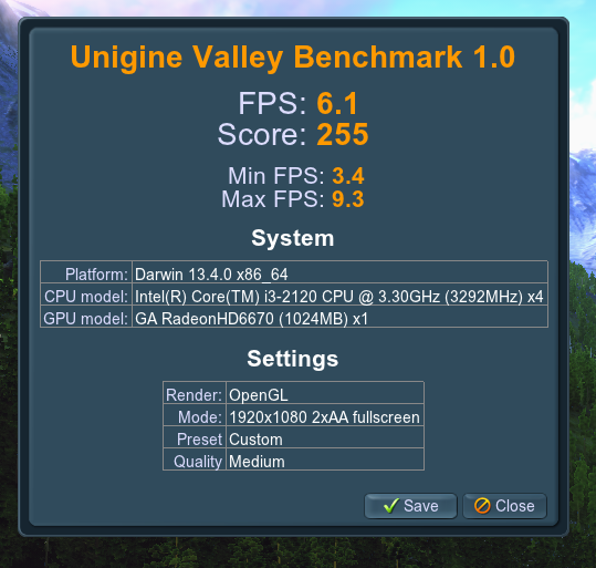

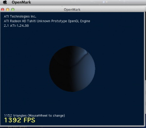

Slice Posted February 11, 2015 Share Posted February 11, 2015 I took a card AMD Radeon R7 240 (ASUS) 1GbDDR3 for one day testing and got it to work. DeviceID=0x6613 This is low cost card (50$) and works worse then my HD6670. Screenshots: This is Oland family that is not supported in Mavericks. May be it will be better in Yosemite. Nonetheless I made by Clover-rev3150 the follow: Devices->FakeID->ATI=0x67981002 (in Yosemite it will be better 6640) Graphics->Inject->ATI=true ->FBName=Futomaki Voila! The card has UEFI BIOS and works in native resolution 1920x1080 even without drivers. No acceleration but good color if no drivers. PS. On screenshot you may see model "GA Radeon6670". It is injected for my previous card. I just forgot to change the name. It is easy with Clover. EDITED. Make sure your DSDT contains GFX device. Else FakeID patch may not work. It can be obtained by Clover DSDT fixes: ACPI->DSDT->Fixes->FixDisplay_0100=true 8 Link to comment https://www.insanelymac.com/forum/topic/304498-working-r7-240-in-mavericks/ Share on other sites More sharing options...

toekimarks Posted February 16, 2015 Share Posted February 16, 2015 I took a card AMD Radeon R7 240 (ASUS) 1GbDDR3 for one day testing and got it to work. DeviceID=0x6613 This is low cost card (50$) and works worse then my HD6670. Screenshots: R7-240-OpenMark.png Screen Shot 2015-02-11 at 21.02.49.png This is Oland family that is not supported in Mavericks. May be it will be better in Yosemite. Nonetheless I made by Clover-rev3150 the follow: Devices->FakeID->ATI=0x67981002 (in Yosemite it will be better 6640) Graphics->Inject->ATI=true ->FBName=Futomaki Voila! The card has UEFI BIOS and works in native resolution 1920x1080 even without drivers. No acceleration but good color. PS. On screenshot you may see model "GA Radeon6670". It is injected for my previous card. I just forgot to change the name. It is easy with Clover. What do you mean with 'no acceleration'? You mean it doesn't have qe/qi? I'm planning on buying this card since it's the cheapest one that will run my lg 34um95 resolution on 50 hz. Thanks in advance Link to comment https://www.insanelymac.com/forum/topic/304498-working-r7-240-in-mavericks/#findComment-2112196 Share on other sites More sharing options...
Slice Posted February 16, 2015 Author Share Posted February 16, 2015 What do you mean with 'no acceleration'? You mean it doesn't have qe/qi? No, I mean that it can work OOB without acceleration. But my way it works WITH ACCELERATION. See screenshots. Link to comment https://www.insanelymac.com/forum/topic/304498-working-r7-240-in-mavericks/#findComment-2112272 Share on other sites More sharing options...
toekimarks Posted February 16, 2015 Share Posted February 16, 2015 No, I mean that it can work OOB without acceleration. But my way it works WITH ACCELERATION. See screenshots. Ok, thanks. I want to buy the exact card you used, but asus says it maximum resolution is 1920x1200, but over hdmi a r7 240 should go to 4k. Do you know if the asus 1gb also supports 4k? Again thanks in advance Link to comment https://www.insanelymac.com/forum/topic/304498-working-r7-240-in-mavericks/#findComment-2112360 Share on other sites More sharing options...
Slice Posted February 17, 2015 Author Share Posted February 17, 2015 Ok, thanks. I want to buy the exact card you used, but asus says it maximum resolution is 1920x1200, but over hdmi a r7 240 should go to 4k. Do you know if the asus 1gb also supports 4k? Again thanks in advance I have no such screen to test. I tested with 1920x1080 Link to comment https://www.insanelymac.com/forum/topic/304498-working-r7-240-in-mavericks/#findComment-2112396 Share on other sites More sharing options...
