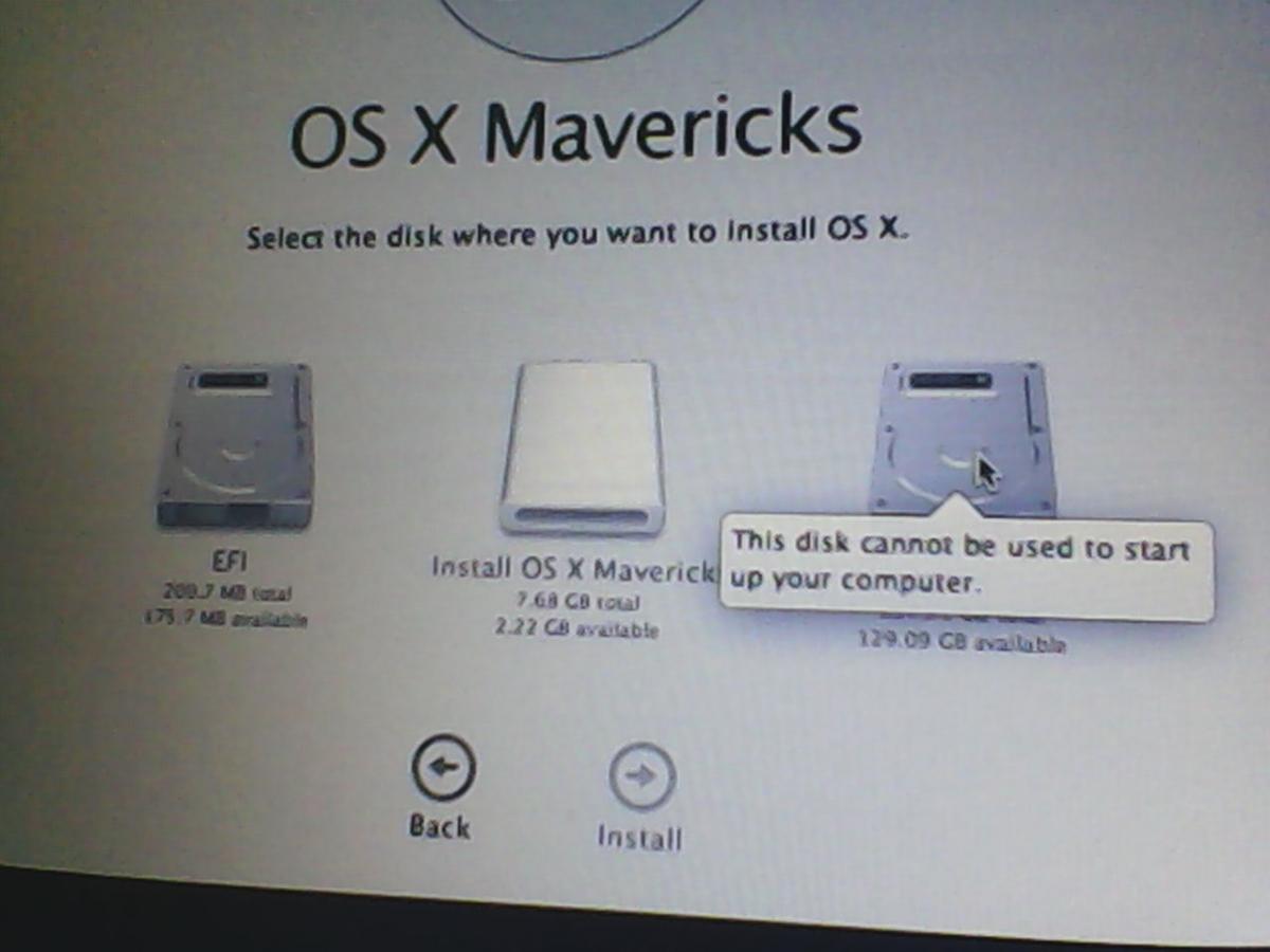

jamaly Posted April 20, 2014 Share Posted April 20, 2014 Greetings my fellow hackers! I've run into a bit of a conundrum. I've recently created a Mavericks installation usb, i'm trying to upgrade from Mountain Lion 10.8.3. I installed Clover as the bootloader on the usb, and spent all of last night until i realised that i missed the USB 3.0 driver, solved that thank God. Now however, it seems like my current hurdle is the message "This disk cannot be used to start up your computer" when i try and select the partition/drive i want to install Mavericks to. I've read around and it seems like the suggestions everyone gives is to shrink the targeted partition slightly (1Gb) with disk utility, and try again. I've tried this, and am still getting the same result. The other suggestion i've read is to format the whole drive clean and then try to install. My goal however is to do an in-place upgrade without losing files and already-installed apps, especially since i don't have access to another hackintosh, legit mac, or computer capable of booting into the installer to fresh install (originally installed ML with this latter method). A clean install is going to be my last resort, and i actually don't think i'd have that many issues this time around. Clover boot manager seems to have prevented the issues i usually have with my limited access HP BIOS settings. I'm looking at you HP engineers and project managers HP Envy 17t-32XX 3D CTO | i7-3820QM | AMD Radeon 7850m | 8Gb Ram @ 1600Mhz | Windows 7 on 750Gb drive (removed during installation attempts)| OSX 10.8.3 Mountain Lion on secondary Link to comment https://www.insanelymac.com/forum/topic/297564-mavericks-install-disk-cannot-be-used/ Share on other sites More sharing options...
fusion71au Posted April 20, 2014 Share Posted April 20, 2014 Type in terminal diskutil list and post the output. I have read of people corrupting their EFI partitions by installing Windows 8 without disconnecting their OSX drive - see Rehabman's recommendation in this forum post. Link to comment https://www.insanelymac.com/forum/topic/297564-mavericks-install-disk-cannot-be-used/#findComment-2013947 Share on other sites More sharing options...
jamaly Posted April 20, 2014 Author Share Posted April 20, 2014 Oh dude, it has nothing to do with my Windows 7. The drive isn't even in my laptop at the moment. I always take it out when I'm making changes or upgrades such as this to OSX. The OSX drive is the only one inside, and is the primary drive when their both installed. On the OSX drive is the 209mb EFI partition with Chimera, and the ML partition. I'll edit later with the diskutil list output later, I'm posting from my tablet. Plan is to install Mavericks, and then put Clover in the EFI partition @fusion71au thanks for the prompt reply. You run into this before? Link to comment https://www.insanelymac.com/forum/topic/297564-mavericks-install-disk-cannot-be-used/#findComment-2013957 Share on other sites More sharing options...
fusion71au Posted April 20, 2014 Share Posted April 20, 2014 Personally haven't had this error but I often use gdisk to solve similar disk partitioning problems. Eg I first list the disks on my system.... diskutil list /dev/disk0 #: TYPE NAME SIZE IDENTIFIER 0: FDisk_partition_scheme *120.0 GB disk0 1: Windows_NTFS System Reserved 104.9 MB disk0s1 2: Windows_NTFS WIN7_X64SSD 119.9 GB disk0s2 /dev/disk1 #: TYPE NAME SIZE IDENTIFIER 0: GUID_partition_scheme *1.0 TB disk1 1: EFI EFI 209.7 MB disk1s1 2: Apple_HFS OSX Mavericks 250.0 GB disk1s2 3: Microsoft Basic Data WIN7_X64HDD 250.1 GB disk1s3 4: Microsoft Basic Data DATA 499.8 GB disk1s4 then run gdisk from terminal... sudo gdisk /dev/disk1 Password: GPT fdisk (gdisk) version 0.8.6 Partition table scan: MBR: protective BSD: not present APM: not present GPT: present Found valid GPT with protective MBR; using GPT. Command (? for help): ? b back up GPT data to a file c change a partition's name d delete a partition i show detailed information on a partition l list known partition types n add a new partition o create a new empty GUID partition table (GPT) p print the partition table q quit without saving changes r recovery and transformation options (experts only) s sort partitions t change a partition's type code v verify disk w write table to disk and exit x extra functionality (experts only) ? print this menu Command (? for help): p Disk /dev/disk1: 1953516911 sectors, 931.5 GiB Logical sector size: 512 bytes Disk identifier (GUID): 5D4BAEB5-8630-489E-897B-89BA29C5655B Partition table holds up to 128 entries First usable sector is 34, last usable sector is 1953516877 Partitions will be aligned on 8-sector boundaries Total free space is 264332 sectors (129.1 MiB) Number Start (sector) End (sector) Size Code Name 1 40 409639 200.0 MiB EF00 EFI System Partition 2 409640 488690887 232.8 GiB AF00 OSX Mavericks 3 488953856 977430527 232.9 GiB 0700 WIN7_X86 4 977430528 1953515519 465.4 GiB 0700 DATA In addition, it will also report any errors you have on your hard disk (if you have them). Edit1 Always a good idea to backup/clone your existing working OSX install in case disaster strikes . I have a bootable OSX Mavericks handy (on an external USB HD) that can be used to rescue my main drive. Gdisk can also back up your GPT partition data to a file - choose option "b" in the main menu--->save to external USB for extra safety. Good Luck! Edit2 Did you install chimera/chameleon into the EFI partition? Doing this can create problems for OSX upgrades as it converts the partition from its normal FAT32 format to HFS+ (you can check with diskutil in terminal as I mentioned previously). Normally, chameleon should be installed to the MBR or hybrid MBR whereas Clover installs nicely into the standard FAT32 EFI partition used by Apple. You can try formatting your EFI partition to FAT32 in terminal (replace X with your disk number, Y is usually 1): sudo newfs_msdos -v EFI -F 32 /dev/rdiskXsY If that doesn't work, you may need to repair or format the EFI as described here, using dd to clone a working EFI eg from your installer USB to the disk to be repaired. NB If you want to install Clover into the EFI (recommended), you must have a FAT32 formatted EFI partition. Link to comment https://www.insanelymac.com/forum/topic/297564-mavericks-install-disk-cannot-be-used/#findComment-2013960 Share on other sites More sharing options...
jamaly Posted April 20, 2014 Author Share Posted April 20, 2014 (edited) Just made a disk image file with disk utility, now I'm leaning towards just formatting the drive and if anything goes wrong, I at least have this image I can restore with. EDIT: I napped on the issue, and am wanting to assume i'm having this issue simply because my bootloader is in the EFI partition. So perhaps it's giving me this message because that's typically where we would have our bootloader in a hackintosh. Edited April 20, 2014 by jamaly Link to comment https://www.insanelymac.com/forum/topic/297564-mavericks-install-disk-cannot-be-used/#findComment-2013973 Share on other sites More sharing options...
mnfesq Posted April 20, 2014 Share Posted April 20, 2014 I would make a Time Machine back up and then do a fresh install of Mavericks and, after that, restore your apps and user files. Personally, I would not restore all of your settings. I would do that in Mavericks to make sure you know exactly what settings you have. 1 Link to comment https://www.insanelymac.com/forum/topic/297564-mavericks-install-disk-cannot-be-used/#findComment-2014047 Share on other sites More sharing options...

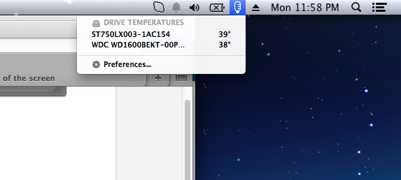

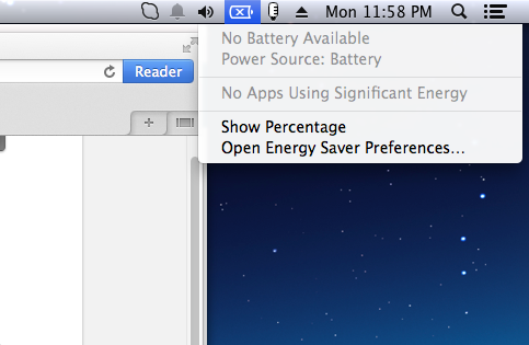

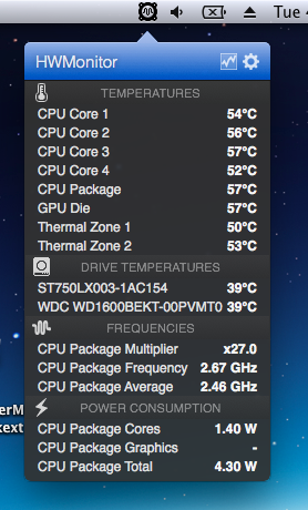

mnfesq Posted April 22, 2014 Share Posted April 22, 2014 For Battery: https://bitbucket.org/RehabMan/os-x-acpi-battery-driver/downloads For HWSensors: http://www.hwsensors.com [be sure to install all of the sensors in FakeSMC.kext-Use Customize during install process] Do you have full CPU function yet? What about speedstepping? Link to comment https://www.insanelymac.com/forum/topic/297564-mavericks-install-disk-cannot-be-used/#findComment-2014447 Share on other sites More sharing options...

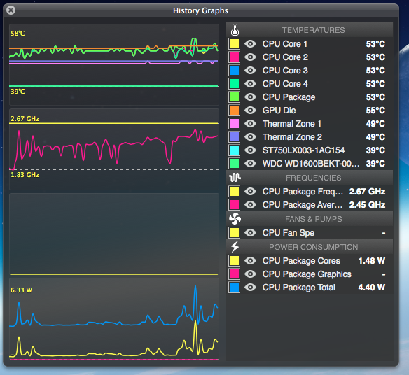

jamaly Posted April 22, 2014 Author Share Posted April 22, 2014 (edited) For Battery: https://bitbucket.org/RehabMan/os-x-acpi-battery-driver/downloads For HWSensors: http://www.hwsensors.com [be sure to install all of the sensors in FakeSMC.kext-Use Customize during install process] Do you have full CPU function yet? What about speedstepping? Full CPU function with speedstepping it seems. I'm going to do the battery fix in a sec EDIT: Battery fix had no effect Edited April 22, 2014 by jamaly Link to comment https://www.insanelymac.com/forum/topic/297564-mavericks-install-disk-cannot-be-used/#findComment-2014535 Share on other sites More sharing options...
mnfesq Posted April 22, 2014 Share Posted April 22, 2014 Ah yes, DSDT patch is required. Get it here: https://github.com/RehabMan/Laptop-DSDT-Patch/blob/e7587379984508bf233061c195133183fdee05ac/battery/battery_HP-Envy-17t.txt Put the patch into MaciASL and apply. BTW, in your Clover configuration, change the Bus Speed KHz to 100000. This will make your speed steps appear as even numbers. Also, are you stuck with only 2 speed steps or do you have more? If your SSDT is correct, you should have about 7 different speed steps. Link to comment https://www.insanelymac.com/forum/topic/297564-mavericks-install-disk-cannot-be-used/#findComment-2014545 Share on other sites More sharing options...
jamaly Posted April 23, 2014 Author Share Posted April 23, 2014 Just discovered that the battery fix broke my sleep and webcam, I'll try it again after the dsdt patch. Second, I'm not so sure about speed stepping because my multiplier stays pegged at 27. Sure the CPU package average changes, but the frequency doesn't change either. Would altering my smbios have any effect on making the created ssdt work? Link to comment https://www.insanelymac.com/forum/topic/297564-mavericks-install-disk-cannot-be-used/#findComment-2014572 Share on other sites More sharing options...
mnfesq Posted April 23, 2014 Share Posted April 23, 2014 Use an smbios that is for an Ivy Bridge Mac. I like the MacBookPro10,2. Make sure to check out this site for the correct method of making your SSDT. http://rampagedev.wordpress.com/guides/make-your-own-ssdt/ And, as Pokenguyen told me, Run the ssdtprgen with -w 3. Link to comment https://www.insanelymac.com/forum/topic/297564-mavericks-install-disk-cannot-be-used/#findComment-2014604 Share on other sites More sharing options...

jamaly Posted April 24, 2014 Author Share Posted April 24, 2014 Sounds like a plan. I reinstalled Clover, and I think I found my problem, gotta look it up. During verbose boot, I've noticed a line: "CPUsensors: CPU base multiplier is 27" To the Google! Link to comment https://www.insanelymac.com/forum/topic/297564-mavericks-install-disk-cannot-be-used/#findComment-2015000 Share on other sites More sharing options...
jamaly Posted April 25, 2014 Author Share Posted April 25, 2014 Holy cannoli batman. IT'S ALIVE! Got it working. 1.19Ghz all the way up to 3.56Ghz (that i've seen using the "yes > /dev/null" terminal command) I did a couple of things, so i'm not exactly sure what exactly did it. I updated my AppleInteCPUPowerManagement.kext to the 216.0.0 version, added the -xcpm argument to boot, set CPU latency to 0x00FA, completely removed my SSDT file, and used the MacBookPro9,1 SMBIOS. The only problem i have left now is this weird sleep behavior... The computer will go to sleep if i close the lid or use the menu option, but then it wakes right back up in less than a second. <--ClockID fixed that. And pressing the power button does nothing. Supposed to bring up the sleep/shut down dialogue right? Battery icon also went missing Link to comment https://www.insanelymac.com/forum/topic/297564-mavericks-install-disk-cannot-be-used/#findComment-2015083 Share on other sites More sharing options...
mnfesq Posted April 25, 2014 Share Posted April 25, 2014 Holy cannoli batman. IT'S ALIVE! Got it working. 1.19Ghz all the way up to 3.56Ghz (that i've seen using the "yes > /dev/null" terminal command) I did a couple of things, so i'm not exactly sure what exactly did it. I updated my AppleInteCPUPowerManagement.kext to the 216.0.0 version, added the -xcpm argument to boot, set CPU latency to 0x00FA, completely removed my SSDT file, and used the MacBookPro9,1 SMBIOS. The only problem i have left now is this weird sleep behavior... The computer will go to sleep if i close the lid or use the menu option, but then it wakes right back up in less than a second. <--ClockID fixed that. And pressing the power button does nothing. Supposed to bring up the sleep/shut down dialogue right? Battery icon also went missing Nice to see you are making progress. I still prefer using a custom SSDT prepared the way it was outlined for me (link is set forth above) and using MacBookPro10,2. You still need to use ACPIBattery.kext and will need to make the DSDT edit required to make it work. It's in my DSDT. As for the power button, this is a new feature in Mavericks. If you press the power button for an instant, it is supposed to put the laptop to sleep. For me, it just puts the video to sleep. But if you hold the power button for 1-2 seconds, it DOES bring up the sleep/shutdown dialogue. Any other issues left to deal with? Link to comment https://www.insanelymac.com/forum/topic/297564-mavericks-install-disk-cannot-be-used/#findComment-2015228 Share on other sites More sharing options...
