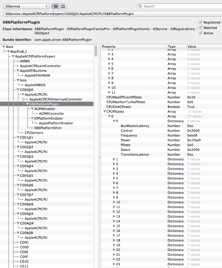

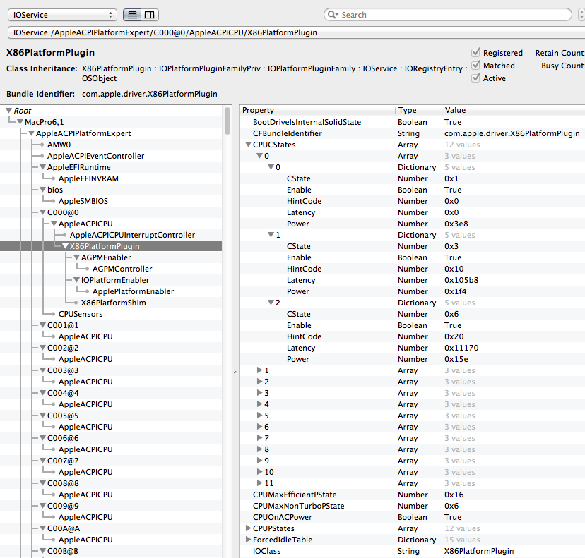

kundica Posted January 21, 2014 Share Posted January 21, 2014 Do you show all c&p states loaded in Ioreg? I get similar results w no ssdt or plugin injection but ioreg shows no states loaded. However AICPUPMi shows 12 32 42 44 reached and I idle at 32 and load at 44 in HWMonitor but technically this is still broken even though it works better than when everything is loaded properly. You can see full results in my post on page 2. @ frankee, I used likes script to generate the frequency vectors and have tried every variation of the ssdt edits outlined on this thread with the same results ( when everything is loaded properly, I'm locked @ 12, 13 or 32) Yep. Here's my info. AICPUPMI: Jan 20 18:38:44 kernel[0]: AICPUPMI: MWAIT C-States.....................: 135456 Jan 20 18:38:44 kernel[0]: AICPUPMI: MSR_CORE_THREAD_COUNT......(0x35) : 0x6000C Jan 20 18:38:44 kernel[0]: AICPUPMI: MSR_PLATFORM_INFO..........(0xCE) : 0xC0070012000 Jan 20 18:38:44 kernel[0]: AICPUPMI: MSR_PMG_CST_CONFIG_CONTROL.(0xE2) : 0x1E000403 Jan 20 18:38:44 kernel[0]: AICPUPMI: MSR_PMG_IO_CAPTURE_BASE....(0xE4) : 0x10414 Jan 20 18:38:44 kernel[0]: AICPUPMI: IA32_MPERF.................(0xE7) : 0x5D244A6 Jan 20 18:38:44 kernel[0]: AICPUPMI: IA32_APERF.................(0xE8) : 0x6E1A997 Jan 20 18:38:44 kernel[0]: AICPUPMI: MSR_FLEX_RATIO.............(0x194) : 0xE0000 Jan 20 18:38:44 kernel[0]: AICPUPMI: MSR_IA32_PERF_STATUS.......(0x198) : 0x2AC100002600 Jan 20 18:38:44 kernel[0]: AICPUPMI: MSR_IA32_PERF_CONTROL......(0x199) : 0x2600 Jan 20 18:38:44 kernel[0]: AICPUPMI: IA32_CLOCK_MODULATION......(0x19A) : 0x0 Jan 20 18:38:44 kernel[0]: AICPUPMI: IA32_THERM_STATUS..........(0x19C) : 0x88350000 Jan 20 18:38:44 kernel[0]: AICPUPMI: IA32_MISC_ENABLES..........(0x1A0) : 0x850089 Jan 20 18:38:44 kernel[0]: AICPUPMI: MSR_MISC_PWR_MGMT..........(0x1AA) : 0x400001 Jan 20 18:38:44 kernel[0]: AICPUPMI: MSR_TURBO_RATIO_LIMIT......(0x1AD) : 0x2323393939393939 Jan 20 18:38:44 kernel[0]: AICPUPMI: IA32_ENERGY_PERF_BIAS......(0x1B0) : 0x0 Jan 20 18:38:44 kernel[0]: AICPUPMI: MSR_POWER_CTL..............(0x1FC) : 0x2504005B Jan 20 18:38:44 kernel[0]: AICPUPMI: MSR_RAPL_POWER_UNIT........(0x606) : 0xA1003 Jan 20 18:38:44 kernel[0]: AICPUPMI: MSR_PKG_POWER_LIMIT........(0x610) : 0x69F40005A9F40 Jan 20 18:38:44 kernel[0]: AICPUPMI: MSR_PKG_ENERGY_STATUS......(0x611) : 0x116F4F98 Jan 20 18:38:44 kernel[0]: AICPUPMI: MSR_PKGC3_IRTL.............(0x60a) : 0x0 Jan 20 18:38:44 kernel[0]: AICPUPMI: MSR_PKGC6_IRTL.............(0x60b) : 0x0 Jan 20 18:38:44 kernel[0]: AICPUPMI: MSR_PKGC7_IRTL.............(0x60c) : 0x0 Jan 20 18:38:44 kernel[0]: AICPUPMI: MSR_PP0_CURRENT_CONFIG.....(0x601) : 0x141494800007F8 Jan 20 18:38:44 kernel[0]: AICPUPMI: MSR_PP0_POWER_LIMIT........(0x638) : 0x0 Jan 20 18:38:44 kernel[0]: AICPUPMI: MSR_PP0_ENERGY_STATUS......(0x639) : 0xDF23AF6 Jan 20 18:38:44 kernel[0]: AICPUPMI: MSR_PP0_POLICY.............(0x63a) : 0x0 Jan 20 18:38:44 kernel[0]: AICPUPMI: MSR_PKG_C2_RESIDENCY.......(0x60d) : 0x10FE764E0 Jan 20 18:38:44 kernel[0]: AICPUPMI: MSR_PKG_C3_RESIDENCY.......(0x3f8) : 0xCC966320 Jan 20 18:38:44 kernel[0]: AICPUPMI: MSR_PKG_C6_RESIDENCY.......(0x3f9) : 0x2946CEE80 Jan 20 18:38:44 kernel[0]: AICPUPMI: MSR_PKG_C7_RESIDENCY.......(0x3fa) : 0x0 Jan 20 18:38:44 kernel[0]: AICPUPMI: Low Frequency Mode.................: 1200 MHz Jan 20 18:38:44 kernel[0]: AICPUPMI: Clock Speed (Max. Non-Turbo Freq.).: 3200 MHz Jan 20 18:38:44 kernel[0]: AICPUPMI: Maximum Turbo Frequency............: 5700 MHz Jan 20 18:38:45 kernel[0]: AICPUPMI: CPU P-States [ (12) 38 ] Jan 20 18:38:45 kernel[0]: AICPUPMI: CPU C3-Cores [ 0 2 3 8 ] Jan 20 18:38:45 kernel[0]: AICPUPMI: CPU C6-Cores [ 0 1 2 3 5 6 7 8 ] Jan 20 18:38:46 kernel[0]: AICPUPMI: CPU C3-Cores [ 0 2 3 6 8 11 ] Jan 20 18:38:46 kernel[0]: AICPUPMI: CPU C6-Cores [ 0 1 2 3 4 5 6 7 8 11 ] Jan 20 18:38:46 kernel[0]: AICPUPMI: CPU C3-Cores [ 0 1 2 3 4 6 8 10 11 ] Jan 20 18:38:46 kernel[0]: AICPUPMI: CPU C6-Cores [ 0 1 2 3 4 5 6 7 8 10 11 ] Jan 20 18:38:47 kernel[0]: AICPUPMI: CPU C3-Cores [ 0 1 2 3 4 6 8 9 10 11 ] Jan 20 18:38:47 kernel[0]: AICPUPMI: CPU C6-Cores [ 0 1 2 3 4 5 6 7 8 9 10 11 ] Jan 20 18:38:49 kernel[0]: AICPUPMI: CPU C3-Cores [ 0 1 2 3 4 5 6 7 8 9 10 11 ] Jan 20 18:38:51 kernel[0]: AICPUPMI: CPU P-States [ 12 (32) 38 ] X86PlatformPlugin/X86PlatformShim debug log: 1/20/14 6:38:01.000 PM kernel[0]: X86PlatformPlugin::init() - kIOPPFBootArgs boot-args set debugLevel 3, debugFlags 3 1/20/14 6:38:01.000 PM kernel[0]: X86PlatformPlugin::start - fPanicErrors 0 1/20/14 6:38:02.000 PM kernel[0]: X86PlatformPlugin::startDelayedPlatformDatabaseRead - Mac-F60DEB81FF30ACF6.plist 1/20/14 6:38:02.000 PM kernel[0]: X86PlatformPlugin::getCPUPStates - P 0: coreFreq 3800, power 130000, latency 10, busLatency 10, control 0x2600, status 0x2600 1/20/14 6:38:02.000 PM kernel[0]: X86PlatformPlugin::getCPUPStates - P 1: coreFreq 3700, power 130000, latency 10, busLatency 10, control 0x2500, status 0x2500 1/20/14 6:38:02.000 PM kernel[0]: X86PlatformPlugin::getCPUPStates - P 2: coreFreq 3600, power 130000, latency 10, busLatency 10, control 0x2400, status 0x2400 1/20/14 6:38:02.000 PM kernel[0]: X86PlatformPlugin::getCPUPStates - P 3: coreFreq 3500, power 130000, latency 10, busLatency 10, control 0x2300, status 0x2300 1/20/14 6:38:02.000 PM kernel[0]: X86PlatformPlugin::getCPUPStates - P 4: coreFreq 3400, power 130000, latency 10, busLatency 10, control 0x2200, status 0x2200 1/20/14 6:38:02.000 PM kernel[0]: X86PlatformPlugin::getCPUPStates - P 5: coreFreq 3300, power 130000, latency 10, busLatency 10, control 0x2100, status 0x2100 1/20/14 6:38:02.000 PM kernel[0]: X86PlatformPlugin::getCPUPStates - P 6: coreFreq 3200, power 130000, latency 10, busLatency 10, control 0x2000, status 0x2000 1/20/14 6:38:02.000 PM kernel[0]: X86PlatformPlugin::getCPUPStates - P 7: coreFreq 3100, power 124510, latency 10, busLatency 10, control 0x1f00, status 0x1f00 1/20/14 6:38:02.000 PM kernel[0]: X86PlatformPlugin::getCPUPStates - P 8: coreFreq 3000, power 119120, latency 10, busLatency 10, control 0x1e00, status 0x1e00 1/20/14 6:38:02.000 PM kernel[0]: X86PlatformPlugin::getCPUPStates - P 9: coreFreq 2900, power 113830, latency 10, busLatency 10, control 0x1d00, status 0x1d00 1/20/14 6:38:02.000 PM kernel[0]: X86PlatformPlugin::getCPUPStates - P10: coreFreq 2800, power 108638, latency 10, busLatency 10, control 0x1c00, status 0x1c00 1/20/14 6:38:02.000 PM kernel[0]: X86PlatformPlugin::getCPUPStates - P11: coreFreq 2700, power 103543, latency 10, busLatency 10, control 0x1b00, status 0x1b00 1/20/14 6:38:02.000 PM kernel[0]: X86PlatformPlugin::getCPUPStates - P12: coreFreq 2600, power 98545, latency 10, busLatency 10, control 0x1a00, status 0x1a00 1/20/14 6:38:02.000 PM kernel[0]: X86PlatformPlugin::getCPUPStates - P13: coreFreq 2500, power 93644, latency 10, busLatency 10, control 0x1900, status 0x1900 1/20/14 6:38:02.000 PM kernel[0]: X86PlatformPlugin::getCPUPStates - P14: coreFreq 2400, power 88837, latency 10, busLatency 10, control 0x1800, status 0x1800 1/20/14 6:38:02.000 PM kernel[0]: X86PlatformPlugin::getCPUPStates - P15: coreFreq 2300, power 84125, latency 10, busLatency 10, control 0x1700, status 0x1700 1/20/14 6:38:02.000 PM kernel[0]: X86PlatformPlugin::getCPUPStates - P16: coreFreq 2200, power 79507, latency 10, busLatency 10, control 0x1600, status 0x1600 1/20/14 6:38:02.000 PM kernel[0]: X86PlatformPlugin::getCPUPStates - P17: coreFreq 2100, power 74981, latency 10, busLatency 10, control 0x1500, status 0x1500 1/20/14 6:38:02.000 PM kernel[0]: X86PlatformPlugin::getCPUPStates - P18: coreFreq 2000, power 70548, latency 10, busLatency 10, control 0x1400, status 0x1400 1/20/14 6:38:02.000 PM kernel[0]: X86PlatformPlugin::getCPUPStates - P19: coreFreq 1900, power 66205, latency 10, busLatency 10, control 0x1300, status 0x1300 1/20/14 6:38:02.000 PM kernel[0]: X86PlatformPlugin::getCPUPStates - P20: coreFreq 1800, power 61953, latency 10, busLatency 10, control 0x1200, status 0x1200 1/20/14 6:38:02.000 PM kernel[0]: X86PlatformPlugin::getCPUPStates - P21: coreFreq 1700, power 57791, latency 10, busLatency 10, control 0x1100, status 0x1100 1/20/14 6:38:02.000 PM kernel[0]: X86PlatformPlugin::getCPUPStates - P22: coreFreq 1600, power 53718, latency 10, busLatency 10, control 0x1000, status 0x1000 1/20/14 6:38:02.000 PM kernel[0]: X86PlatformPlugin::getCPUPStates - P23: coreFreq 1500, power 49733, latency 10, busLatency 10, control 0xf00, status 0xf00 1/20/14 6:38:02.000 PM kernel[0]: X86PlatformPlugin::getCPUPStates - P24: coreFreq 1400, power 45836, latency 10, busLatency 10, control 0xe00, status 0xe00 1/20/14 6:38:02.000 PM kernel[0]: X86PlatformPlugin::getCPUPStates - P25: coreFreq 1300, power 42025, latency 10, busLatency 10, control 0xd00, status 0xd00 1/20/14 6:38:02.000 PM kernel[0]: X86PlatformPlugin::getCPUPStates - P26: coreFreq 1200, power 38299, latency 10, busLatency 10, control 0xc00, status 0xc00 1/20/14 6:38:02.000 PM kernel[0]: X86PlatformPlugin::publishACPIStates - Succeeded in getting max non-turbo PState 6 1/20/14 6:38:02.000 PM kernel[0]: X86PlatformPlugin::publishACPIStates - Succeeded in getting max efficient PState ratio difference 4 1/20/14 6:38:02.000 PM kernel[0]: X86PlatformPlugin::publishACPIStates - Found max efficient PState to be 22 1/20/14 6:38:02.000 PM kernel[0]: X86PlatformPlugin::getCPUPStates - P 0: coreFreq 3800, power 130000, latency 10, busLatency 10, control 0x2600, status 0x2600 1/20/14 6:38:02.000 PM kernel[0]: X86PlatformPlugin::getCPUPStates - P 1: coreFreq 3700, power 130000, latency 10, busLatency 10, control 0x2500, status 0x2500 1/20/14 6:38:02.000 PM kernel[0]: X86PlatformPlugin::getCPUPStates - P 2: coreFreq 3600, power 130000, latency 10, busLatency 10, control 0x2400, status 0x2400 1/20/14 6:38:02.000 PM kernel[0]: X86PlatformPlugin::getCPUPStates - P 3: coreFreq 3500, power 130000, latency 10, busLatency 10, control 0x2300, status 0x2300 1/20/14 6:38:02.000 PM kernel[0]: X86PlatformPlugin::getCPUPStates - P 4: coreFreq 3400, power 130000, latency 10, busLatency 10, control 0x2200, status 0x2200 1/20/14 6:38:02.000 PM kernel[0]: X86PlatformPlugin::getCPUPStates - P 5: coreFreq 3300, power 130000, latency 10, busLatency 10, control 0x2100, status 0x2100 1/20/14 6:38:02.000 PM kernel[0]: X86PlatformPlugin::getCPUPStates - P 6: coreFreq 3200, power 130000, latency 10, busLatency 10, control 0x2000, status 0x2000 1/20/14 6:38:02.000 PM kernel[0]: X86PlatformPlugin::getCPUPStates - P 7: coreFreq 3100, power 124510, latency 10, busLatency 10, control 0x1f00, status 0x1f00 1/20/14 6:38:02.000 PM kernel[0]: X86PlatformPlugin::getCPUPStates - P 8: coreFreq 3000, power 119120, latency 10, busLatency 10, control 0x1e00, status 0x1e00 1/20/14 6:38:02.000 PM kernel[0]: X86PlatformPlugin::getCPUPStates - P 9: coreFreq 2900, power 113830, latency 10, busLatency 10, control 0x1d00, status 0x1d00 1/20/14 6:38:02.000 PM kernel[0]: X86PlatformPlugin::getCPUPStates - P10: coreFreq 2800, power 108638, latency 10, busLatency 10, control 0x1c00, status 0x1c00 1/20/14 6:38:02.000 PM kernel[0]: X86PlatformPlugin::getCPUPStates - P11: coreFreq 2700, power 103543, latency 10, busLatency 10, control 0x1b00, status 0x1b00 1/20/14 6:38:02.000 PM kernel[0]: X86PlatformPlugin::getCPUPStates - P12: coreFreq 2600, power 98545, latency 10, busLatency 10, control 0x1a00, status 0x1a00 1/20/14 6:38:02.000 PM kernel[0]: X86PlatformPlugin::getCPUPStates - P13: coreFreq 2500, power 93644, latency 10, busLatency 10, control 0x1900, status 0x1900 1/20/14 6:38:02.000 PM kernel[0]: X86PlatformPlugin::getCPUPStates - P14: coreFreq 2400, power 88837, latency 10, busLatency 10, control 0x1800, status 0x1800 1/20/14 6:38:02.000 PM kernel[0]: X86PlatformPlugin::getCPUPStates - P15: coreFreq 2300, power 84125, latency 10, busLatency 10, control 0x1700, status 0x1700 1/20/14 6:38:02.000 PM kernel[0]: X86PlatformPlugin::getCPUPStates - P16: coreFreq 2200, power 79507, latency 10, busLatency 10, control 0x1600, status 0x1600 1/20/14 6:38:02.000 PM kernel[0]: X86PlatformPlugin::getCPUPStates - P17: coreFreq 2100, power 74981, latency 10, busLatency 10, control 0x1500, status 0x1500 1/20/14 6:38:02.000 PM kernel[0]: X86PlatformPlugin::getCPUPStates - P18: coreFreq 2000, power 70548, latency 10, busLatency 10, control 0x1400, status 0x1400 1/20/14 6:38:02.000 PM kernel[0]: X86PlatformPlugin::getCPUPStates - P19: coreFreq 1900, power 66205, latency 10, busLatency 10, control 0x1300, status 0x1300 1/20/14 6:38:02.000 PM kernel[0]: X86PlatformPlugin::getCPUPStates - P20: coreFreq 1800, power 61953, latency 10, busLatency 10, control 0x1200, status 0x1200 1/20/14 6:38:02.000 PM kernel[0]: X86PlatformPlugin::getCPUPStates - P21: coreFreq 1700, power 57791, latency 10, busLatency 10, control 0x1100, status 0x1100 1/20/14 6:38:02.000 PM kernel[0]: X86PlatformPlugin::getCPUPStates - P22: coreFreq 1600, power 53718, latency 10, busLatency 10, control 0x1000, status 0x1000 1/20/14 6:38:02.000 PM kernel[0]: X86PlatformPlugin::getCPUPStates - P23: coreFreq 1500, power 49733, latency 10, busLatency 10, control 0xf00, status 0xf00 1/20/14 6:38:02.000 PM kernel[0]: X86PlatformPlugin::getCPUPStates - P24: coreFreq 1400, power 45836, latency 10, busLatency 10, control 0xe00, status 0xe00 1/20/14 6:38:02.000 PM kernel[0]: X86PlatformPlugin::getCPUPStates - P25: coreFreq 1300, power 42025, latency 10, busLatency 10, control 0xd00, status 0xd00 1/20/14 6:38:02.000 PM kernel[0]: X86PlatformPlugin::getCPUPStates - P26: coreFreq 1200, power 38299, latency 10, busLatency 10, control 0xc00, status 0xc00 1/20/14 6:38:02.000 PM kernel[0]: X86PlatformPlugin::getCPUPStates - P 0: coreFreq 3800, power 130000, latency 10, busLatency 10, control 0x2600, status 0x2600 1/20/14 6:38:02.000 PM kernel[0]: X86PlatformPlugin::getCPUPStates - P 1: coreFreq 3700, power 130000, latency 10, busLatency 10, control 0x2500, status 0x2500 1/20/14 6:38:02.000 PM kernel[0]: X86PlatformPlugin::getCPUPStates - P 2: coreFreq 3600, power 130000, latency 10, busLatency 10, control 0x2400, status 0x2400 1/20/14 6:38:02.000 PM kernel[0]: X86PlatformPlugin::getCPUPStates - P 3: coreFreq 3500, power 130000, latency 10, busLatency 10, control 0x2300, status 0x2300 1/20/14 6:38:02.000 PM kernel[0]: X86PlatformPlugin::getCPUPStates - P 4: coreFreq 3400, power 130000, latency 10, busLatency 10, control 0x2200, status 0x2200 1/20/14 6:38:02.000 PM kernel[0]: X86PlatformPlugin::getCPUPStates - P 5: coreFreq 3300, power 130000, latency 10, busLatency 10, control 0x2100, status 0x2100 1/20/14 6:38:02.000 PM kernel[0]: X86PlatformPlugin::getCPUPStates - P 6: coreFreq 3200, power 130000, latency 10, busLatency 10, control 0x2000, status 0x2000 1/20/14 6:38:02.000 PM kernel[0]: X86PlatformPlugin::getCPUPStates - P 7: coreFreq 3100, power 124510, latency 10, busLatency 10, control 0x1f00, status 0x1f00 1/20/14 6:38:02.000 PM kernel[0]: X86PlatformPlugin::getCPUPStates - P 8: coreFreq 3000, power 119120, latency 10, busLatency 10, control 0x1e00, status 0x1e00 1/20/14 6:38:02.000 PM kernel[0]: X86PlatformPlugin::getCPUPStates - P 9: coreFreq 2900, power 113830, latency 10, busLatency 10, control 0x1d00, status 0x1d00 1/20/14 6:38:02.000 PM kernel[0]: X86PlatformPlugin::getCPUPStates - P10: coreFreq 2800, power 108638, latency 10, busLatency 10, control 0x1c00, status 0x1c00 1/20/14 6:38:02.000 PM kernel[0]: X86PlatformPlugin::getCPUPStates - P11: coreFreq 2700, power 103543, latency 10, busLatency 10, control 0x1b00, status 0x1b00 1/20/14 6:38:02.000 PM kernel[0]: X86PlatformPlugin::getCPUPStates - P12: coreFreq 2600, power 98545, latency 10, busLatency 10, control 0x1a00, status 0x1a00 1/20/14 6:38:02.000 PM kernel[0]: X86PlatformPlugin::getCPUPStates - P13: coreFreq 2500, power 93644, latency 10, busLatency 10, control 0x1900, status 0x1900 1/20/14 6:38:02.000 PM kernel[0]: X86PlatformPlugin::getCPUPStates - P14: coreFreq 2400, power 88837, latency 10, busLatency 10, control 0x1800, status 0x1800 1/20/14 6:38:02.000 PM kernel[0]: X86PlatformPlugin::getCPUPStates - P15: coreFreq 2300, power 84125, latency 10, busLatency 10, control 0x1700, status 0x1700 1/20/14 6:38:02.000 PM kernel[0]: X86PlatformPlugin::getCPUPStates - P16: coreFreq 2200, power 79507, latency 10, busLatency 10, control 0x1600, status 0x1600 1/20/14 6:38:02.000 PM kernel[0]: X86PlatformPlugin::getCPUPStates - P17: coreFreq 2100, power 74981, latency 10, busLatency 10, control 0x1500, status 0x1500 1/20/14 6:38:02.000 PM kernel[0]: X86PlatformPlugin::getCPUPStates - P18: coreFreq 2000, power 70548, latency 10, busLatency 10, control 0x1400, status 0x1400 1/20/14 6:38:02.000 PM kernel[0]: X86PlatformPlugin::getCPUPStates - P19: coreFreq 1900, power 66205, latency 10, busLatency 10, control 0x1300, status 0x1300 1/20/14 6:38:02.000 PM kernel[0]: X86PlatformPlugin::getCPUPStates - P20: coreFreq 1800, power 61953, latency 10, busLatency 10, control 0x1200, status 0x1200 1/20/14 6:38:02.000 PM kernel[0]: X86PlatformPlugin::getCPUPStates - P21: coreFreq 1700, power 57791, latency 10, busLatency 10, control 0x1100, status 0x1100 1/20/14 6:38:02.000 PM kernel[0]: X86PlatformPlugin::getCPUPStates - P22: coreFreq 1600, power 53718, latency 10, busLatency 10, control 0x1000, status 0x1000 1/20/14 6:38:02.000 PM kernel[0]: X86PlatformPlugin::getCPUPStates - P23: coreFreq 1500, power 49733, latency 10, busLatency 10, control 0xf00, status 0xf00 1/20/14 6:38:02.000 PM kernel[0]: X86PlatformPlugin::getCPUPStates - P24: coreFreq 1400, power 45836, latency 10, busLatency 10, control 0xe00, status 0xe00 1/20/14 6:38:02.000 PM kernel[0]: X86PlatformPlugin::getCPUPStates - P25: coreFreq 1300, power 42025, latency 10, busLatency 10, control 0xd00, status 0xd00 1/20/14 6:38:02.000 PM kernel[0]: X86PlatformPlugin::getCPUPStates - P26: coreFreq 1200, power 38299, latency 10, busLatency 10, control 0xc00, status 0xc00 1/20/14 6:38:02.000 PM kernel[0]: X86PlatformPlugin::getCPUPStates - P 0: coreFreq 3800, power 130000, latency 10, busLatency 10, control 0x2600, status 0x2600 1/20/14 6:38:02.000 PM kernel[0]: X86PlatformPlugin::getCPUPStates - P 1: coreFreq 3700, power 130000, latency 10, busLatency 10, control 0x2500, status 0x2500 1/20/14 6:38:02.000 PM kernel[0]: X86PlatformPlugin::getCPUPStates - P 2: coreFreq 3600, power 130000, latency 10, busLatency 10, control 0x2400, status 0x2400 1/20/14 6:38:02.000 PM kernel[0]: X86PlatformPlugin::getCPUPStates - P 3: coreFreq 3500, power 130000, latency 10, busLatency 10, control 0x2300, status 0x2300 1/20/14 6:38:02.000 PM kernel[0]: X86PlatformPlugin::getCPUPStates - P 4: coreFreq 3400, power 130000, latency 10, busLatency 10, control 0x2200, status 0x2200 1/20/14 6:38:02.000 PM kernel[0]: X86PlatformPlugin::getCPUPStates - P 5: coreFreq 3300, power 130000, latency 10, busLatency 10, control 0x2100, status 0x2100 1/20/14 6:38:02.000 PM kernel[0]: X86PlatformPlugin::getCPUPStates - P 6: coreFreq 3200, power 130000, latency 10, busLatency 10, control 0x2000, status 0x2000 1/20/14 6:38:02.000 PM kernel[0]: X86PlatformPlugin::getCPUPStates - P 7: coreFreq 3100, power 124510, latency 10, busLatency 10, control 0x1f00, status 0x1f00 1/20/14 6:38:02.000 PM kernel[0]: X86PlatformPlugin::getCPUPStates - P 8: coreFreq 3000, power 119120, latency 10, busLatency 10, control 0x1e00, status 0x1e00 1/20/14 6:38:02.000 PM kernel[0]: X86PlatformPlugin::getCPUPStates - P 9: coreFreq 2900, power 113830, latency 10, busLatency 10, control 0x1d00, status 0x1d00 1/20/14 6:38:02.000 PM kernel[0]: X86PlatformPlugin::getCPUPStates - P10: coreFreq 2800, power 108638, latency 10, busLatency 10, control 0x1c00, status 0x1c00 1/20/14 6:38:02.000 PM kernel[0]: X86PlatformPlugin::getCPUPStates - P11: coreFreq 2700, power 103543, latency 10, busLatency 10, control 0x1b00, status 0x1b00 1/20/14 6:38:02.000 PM kernel[0]: X86PlatformPlugin::getCPUPStates - P12: coreFreq 2600, power 98545, latency 10, busLatency 10, control 0x1a00, status 0x1a00 1/20/14 6:38:02.000 PM kernel[0]: X86PlatformPlugin::getCPUPStates - P13: coreFreq 2500, power 93644, latency 10, busLatency 10, control 0x1900, status 0x1900 1/20/14 6:38:02.000 PM kernel[0]: X86PlatformPlugin::getCPUPStates - P14: coreFreq 2400, power 88837, latency 10, busLatency 10, control 0x1800, status 0x1800 1/20/14 6:38:02.000 PM kernel[0]: X86PlatformPlugin::getCPUPStates - P15: coreFreq 2300, power 84125, latency 10, busLatency 10, control 0x1700, status 0x1700 1/20/14 6:38:02.000 PM kernel[0]: X86PlatformPlugin::getCPUPStates - P16: coreFreq 2200, power 79507, latency 10, busLatency 10, control 0x1600, status 0x1600 1/20/14 6:38:02.000 PM kernel[0]: X86PlatformPlugin::getCPUPStates - P17: coreFreq 2100, power 74981, latency 10, busLatency 10, control 0x1500, status 0x1500 1/20/14 6:38:02.000 PM kernel[0]: X86PlatformPlugin::getCPUPStates - P18: coreFreq 2000, power 70548, latency 10, busLatency 10, control 0x1400, status 0x1400 1/20/14 6:38:02.000 PM kernel[0]: X86PlatformPlugin::getCPUPStates - P19: coreFreq 1900, power 66205, latency 10, busLatency 10, control 0x1300, status 0x1300 1/20/14 6:38:02.000 PM kernel[0]: X86PlatformPlugin::getCPUPStates - P20: coreFreq 1800, power 61953, latency 10, busLatency 10, control 0x1200, status 0x1200 1/20/14 6:38:02.000 PM kernel[0]: X86PlatformPlugin::getCPUPStates - P21: coreFreq 1700, power 57791, latency 10, busLatency 10, control 0x1100, status 0x1100 1/20/14 6:38:02.000 PM kernel[0]: X86PlatformPlugin::getCPUPStates - P22: coreFreq 1600, power 53718, latency 10, busLatency 10, control 0x1000, status 0x1000 1/20/14 6:38:02.000 PM kernel[0]: X86PlatformPlugin::getCPUPStates - P23: coreFreq 1500, power 49733, latency 10, busLatency 10, control 0xf00, status 0xf00 1/20/14 6:38:02.000 PM kernel[0]: X86PlatformPlugin::getCPUPStates - P24: coreFreq 1400, power 45836, latency 10, busLatency 10, control 0xe00, status 0xe00 1/20/14 6:38:02.000 PM kernel[0]: X86PlatformPlugin::getCPUPStates - P25: coreFreq 1300, power 42025, latency 10, busLatency 10, control 0xd00, status 0xd00 1/20/14 6:38:02.000 PM kernel[0]: X86PlatformPlugin::getCPUPStates - P26: coreFreq 1200, power 38299, latency 10, busLatency 10, control 0xc00, status 0xc00 1/20/14 6:38:02.000 PM kernel[0]: X86PlatformPlugin::getCPUPStates - P 0: coreFreq 3800, power 130000, latency 10, busLatency 10, control 0x2600, status 0x2600 1/20/14 6:38:02.000 PM kernel[0]: X86PlatformPlugin::getCPUPStates - P 1: coreFreq 3700, power 130000, latency 10, busLatency 10, control 0x2500, status 0x2500 1/20/14 6:38:02.000 PM kernel[0]: X86PlatformPlugin::getCPUPStates - P 2: coreFreq 3600, power 130000, latency 10, busLatency 10, control 0x2400, status 0x2400 1/20/14 6:38:02.000 PM kernel[0]: X86PlatformPlugin::getCPUPStates - P 3: coreFreq 3500, power 130000, latency 10, busLatency 10, control 0x2300, status 0x2300 1/20/14 6:38:02.000 PM kernel[0]: X86PlatformPlugin::getCPUPStates - P 4: coreFreq 3400, power 130000, latency 10, busLatency 10, control 0x2200, status 0x2200 1/20/14 6:38:02.000 PM kernel[0]: X86PlatformPlugin::getCPUPStates - P 5: coreFreq 3300, power 130000, latency 10, busLatency 10, control 0x2100, status 0x2100 1/20/14 6:38:02.000 PM kernel[0]: X86PlatformPlugin::getCPUPStates - P 6: coreFreq 3200, power 130000, latency 10, busLatency 10, control 0x2000, status 0x2000 1/20/14 6:38:02.000 PM kernel[0]: X86PlatformPlugin::getCPUPStates - P 7: coreFreq 3100, power 124510, latency 10, busLatency 10, control 0x1f00, status 0x1f00 1/20/14 6:38:02.000 PM kernel[0]: X86PlatformPlugin::getCPUPStates - P 8: coreFreq 3000, power 119120, latency 10, busLatency 10, control 0x1e00, status 0x1e00 1/20/14 6:38:02.000 PM kernel[0]: X86PlatformPlugin::getCPUPStates - P 9: coreFreq 2900, power 113830, latency 10, busLatency 10, control 0x1d00, status 0x1d00 1/20/14 6:38:02.000 PM kernel[0]: X86PlatformPlugin::getCPUPStates - P10: coreFreq 2800, power 108638, latency 10, busLatency 10, control 0x1c00, status 0x1c00 1/20/14 6:38:02.000 PM kernel[0]: X86PlatformPlugin::getCPUPStates - P11: coreFreq 2700, power 103543, latency 10, busLatency 10, control 0x1b00, status 0x1b00 1/20/14 6:38:02.000 PM kernel[0]: X86PlatformPlugin::getCPUPStates - P12: coreFreq 2600, power 98545, latency 10, busLatency 10, control 0x1a00, status 0x1a00 1/20/14 6:38:02.000 PM kernel[0]: X86PlatformPlugin::getCPUPStates - P13: coreFreq 2500, power 93644, latency 10, busLatency 10, control 0x1900, status 0x1900 1/20/14 6:38:02.000 PM kernel[0]: X86PlatformPlugin::getCPUPStates - P14: coreFreq 2400, power 88837, latency 10, busLatency 10, control 0x1800, status 0x1800 1/20/14 6:38:02.000 PM kernel[0]: X86PlatformPlugin::getCPUPStates - P15: coreFreq 2300, power 84125, latency 10, busLatency 10, control 0x1700, status 0x1700 1/20/14 6:38:02.000 PM kernel[0]: X86PlatformPlugin::getCPUPStates - P16: coreFreq 2200, power 79507, latency 10, busLatency 10, control 0x1600, status 0x1600 1/20/14 6:38:02.000 PM kernel[0]: X86PlatformPlugin::getCPUPStates - P17: coreFreq 2100, power 74981, latency 10, busLatency 10, control 0x1500, status 0x1500 1/20/14 6:38:02.000 PM kernel[0]: X86PlatformPlugin::getCPUPStates - P18: coreFreq 2000, power 70548, latency 10, busLatency 10, control 0x1400, status 0x1400 1/20/14 6:38:03.000 PM kernel[0]: X86PlatformPlugin::getCPUPStates - P19: coreFreq 1900, power 66205, latency 10, busLatency 10, control 0x1300, status 0x1300 1/20/14 6:38:03.000 PM kernel[0]: X86PlatformPlugin::getCPUPStates - P20: coreFreq 1800, power 61953, latency 10, busLatency 10, control 0x1200, status 0x1200 1/20/14 6:38:03.000 PM kernel[0]: X86PlatformPlugin::getCPUPStates - P21: coreFreq 1700, power 57791, latency 10, busLatency 10, control 0x1100, status 0x1100 1/20/14 6:38:03.000 PM kernel[0]: X86PlatformPlugin::getCPUPStates - P22: coreFreq 1600, power 53718, latency 10, busLatency 10, control 0x1000, status 0x1000 1/20/14 6:38:03.000 PM kernel[0]: X86PlatformPlugin::getCPUPStates - P23: coreFreq 1500, power 49733, latency 10, busLatency 10, control 0xf00, status 0xf00 1/20/14 6:38:03.000 PM kernel[0]: X86PlatformPlugin::getCPUPStates - P24: coreFreq 1400, power 45836, latency 10, busLatency 10, control 0xe00, status 0xe00 1/20/14 6:38:03.000 PM kernel[0]: X86PlatformPlugin::getCPUPStates - P25: coreFreq 1300, power 42025, latency 10, busLatency 10, control 0xd00, status 0xd00 1/20/14 6:38:03.000 PM kernel[0]: X86PlatformPlugin::getCPUPStates - P26: coreFreq 1200, power 38299, latency 10, busLatency 10, control 0xc00, status 0xc00 1/20/14 6:38:03.000 PM kernel[0]: X86PlatformPlugin::getCPUPStates - P 0: coreFreq 3800, power 130000, latency 10, busLatency 10, control 0x2600, status 0x2600 1/20/14 6:38:03.000 PM kernel[0]: X86PlatformPlugin::getCPUPStates - P 1: coreFreq 3700, power 130000, latency 10, busLatency 10, control 0x2500, status 0x2500 1/20/14 6:38:03.000 PM kernel[0]: X86PlatformPlugin::getCPUPStates - P 2: coreFreq 3600, power 130000, latency 10, busLatency 10, control 0x2400, status 0x2400 1/20/14 6:38:03.000 PM kernel[0]: X86PlatformPlugin::getCPUPStates - P 3: coreFreq 3500, power 130000, latency 10, busLatency 10, control 0x2300, status 0x2300 1/20/14 6:38:03.000 PM kernel[0]: X86PlatformPlugin::getCPUPStates - P 4: coreFreq 3400, power 130000, latency 10, busLatency 10, control 0x2200, status 0x2200 1/20/14 6:38:03.000 PM kernel[0]: X86PlatformPlugin::getCPUPStates - P 5: coreFreq 3300, power 130000, latency 10, busLatency 10, control 0x2100, status 0x2100 1/20/14 6:38:03.000 PM kernel[0]: X86PlatformPlugin::getCPUPStates - P 6: coreFreq 3200, power 130000, latency 10, busLatency 10, control 0x2000, status 0x2000 1/20/14 6:38:03.000 PM kernel[0]: X86PlatformPlugin::getCPUPStates - P 7: coreFreq 3100, power 124510, latency 10, busLatency 10, control 0x1f00, status 0x1f00 1/20/14 6:38:03.000 PM kernel[0]: X86PlatformPlugin::getCPUPStates - P 8: coreFreq 3000, power 119120, latency 10, busLatency 10, control 0x1e00, status 0x1e00 1/20/14 6:38:03.000 PM kernel[0]: X86PlatformPlugin::getCPUPStates - P 9: coreFreq 2900, power 113830, latency 10, busLatency 10, control 0x1d00, status 0x1d00 1/20/14 6:38:03.000 PM kernel[0]: X86PlatformPlugin::getCPUPStates - P10: coreFreq 2800, power 108638, latency 10, busLatency 10, control 0x1c00, status 0x1c00 1/20/14 6:38:03.000 PM kernel[0]: X86PlatformPlugin::getCPUPStates - P11: coreFreq 2700, power 103543, latency 10, busLatency 10, control 0x1b00, status 0x1b00 1/20/14 6:38:03.000 PM kernel[0]: X86PlatformPlugin::getCPUPStates - P12: coreFreq 2600, power 98545, latency 10, busLatency 10, control 0x1a00, status 0x1a00 1/20/14 6:38:03.000 PM kernel[0]: X86PlatformPlugin::getCPUPStates - P13: coreFreq 2500, power 93644, latency 10, busLatency 10, control 0x1900, status 0x1900 1/20/14 6:38:03.000 PM kernel[0]: X86PlatformPlugin::getCPUPStates - P14: coreFreq 2400, power 88837, latency 10, busLatency 10, control 0x1800, status 0x1800 1/20/14 6:38:03.000 PM kernel[0]: X86PlatformPlugin::getCPUPStates - P15: coreFreq 2300, power 84125, latency 10, busLatency 10, control 0x1700, status 0x1700 1/20/14 6:38:03.000 PM kernel[0]: X86PlatformPlugin::getCPUPStates - P16: coreFreq 2200, power 79507, latency 10, busLatency 10, control 0x1600, status 0x1600 1/20/14 6:38:03.000 PM kernel[0]: X86PlatformPlugin::getCPUPStates - P17: coreFreq 2100, power 74981, latency 10, busLatency 10, control 0x1500, status 0x1500 1/20/14 6:38:03.000 PM kernel[0]: X86PlatformPlugin::getCPUPStates - P18: coreFreq 2000, power 70548, latency 10, busLatency 10, control 0x1400, status 0x1400 1/20/14 6:38:03.000 PM kernel[0]: X86PlatformPlugin::getCPUPStates - P19: coreFreq 1900, power 66205, latency 10, busLatency 10, control 0x1300, status 0x1300 1/20/14 6:38:03.000 PM kernel[0]: X86PlatformPlugin::getCPUPStates - P20: coreFreq 1800, power 61953, latency 10, busLatency 10, control 0x1200, status 0x1200 1/20/14 6:38:03.000 PM kernel[0]: X86PlatformPlugin::getCPUPStates - P21: coreFreq 1700, power 57791, latency 10, busLatency 10, control 0x1100, status 0x1100 1/20/14 6:38:03.000 PM kernel[0]: X86PlatformPlugin::getCPUPStates - P22: coreFreq 1600, power 53718, latency 10, busLatency 10, control 0x1000, status 0x1000 1/20/14 6:38:03.000 PM kernel[0]: X86PlatformPlugin::getCPUPStates - P23: coreFreq 1500, power 49733, latency 10, busLatency 10, control 0xf00, status 0xf00 1/20/14 6:38:03.000 PM kernel[0]: X86PlatformPlugin::getCPUPStates - P24: coreFreq 1400, power 45836, latency 10, busLatency 10, control 0xe00, status 0xe00 1/20/14 6:38:03.000 PM kernel[0]: X86PlatformPlugin::getCPUPStates - P25: coreFreq 1300, power 42025, latency 10, busLatency 10, control 0xd00, status 0xd00 1/20/14 6:38:03.000 PM kernel[0]: X86PlatformPlugin::getCPUPStates - P26: coreFreq 1200, power 38299, latency 10, busLatency 10, control 0xc00, status 0xc00 1/20/14 6:38:03.000 PM kernel[0]: X86PlatformPlugin::getCPUPStates - P 0: coreFreq 3800, power 130000, latency 10, busLatency 10, control 0x2600, status 0x2600 1/20/14 6:38:03.000 PM kernel[0]: X86PlatformPlugin::getCPUPStates - P 1: coreFreq 3700, power 130000, latency 10, busLatency 10, control 0x2500, status 0x2500 1/20/14 6:38:03.000 PM kernel[0]: X86PlatformPlugin::getCPUPStates - P 2: coreFreq 3600, power 130000, latency 10, busLatency 10, control 0x2400, status 0x2400 1/20/14 6:38:03.000 PM kernel[0]: X86PlatformPlugin::getCPUPStates - P 3: coreFreq 3500, power 130000, latency 10, busLatency 10, control 0x2300, status 0x2300 1/20/14 6:38:03.000 PM kernel[0]: X86PlatformPlugin::getCPUPStates - P 4: coreFreq 3400, power 130000, latency 10, busLatency 10, control 0x2200, status 0x2200 1/20/14 6:38:03.000 PM kernel[0]: X86PlatformPlugin::getCPUPStates - P 5: coreFreq 3300, power 130000, latency 10, busLatency 10, control 0x2100, status 0x2100 1/20/14 6:38:03.000 PM kernel[0]: X86PlatformPlugin::getCPUPStates - P 6: coreFreq 3200, power 130000, latency 10, busLatency 10, control 0x2000, status 0x2000 1/20/14 6:38:03.000 PM kernel[0]: X86PlatformPlugin::getCPUPStates - P 7: coreFreq 3100, power 124510, latency 10, busLatency 10, control 0x1f00, status 0x1f00 1/20/14 6:38:03.000 PM kernel[0]: X86PlatformPlugin::getCPUPStates - P 8: coreFreq 3000, power 119120, latency 10, busLatency 10, control 0x1e00, status 0x1e00 1/20/14 6:38:03.000 PM kernel[0]: X86PlatformPlugin::getCPUPStates - P 9: coreFreq 2900, power 113830, latency 10, busLatency 10, control 0x1d00, status 0x1d00 1/20/14 6:38:03.000 PM kernel[0]: X86PlatformPlugin::getCPUPStates - P10: coreFreq 2800, power 108638, latency 10, busLatency 10, control 0x1c00, status 0x1c00 1/20/14 6:38:03.000 PM kernel[0]: X86PlatformPlugin::getCPUPStates - P11: coreFreq 2700, power 103543, latency 10, busLatency 10, control 0x1b00, status 0x1b00 1/20/14 6:38:03.000 PM kernel[0]: X86PlatformPlugin::getCPUPStates - P12: coreFreq 2600, power 98545, latency 10, busLatency 10, control 0x1a00, status 0x1a00 1/20/14 6:38:03.000 PM kernel[0]: X86PlatformPlugin::getCPUPStates - P13: coreFreq 2500, power 93644, latency 10, busLatency 10, control 0x1900, status 0x1900 1/20/14 6:38:03.000 PM kernel[0]: X86PlatformPlugin::getCPUPStates - P14: coreFreq 2400, power 88837, latency 10, busLatency 10, control 0x1800, status 0x1800 1/20/14 6:38:03.000 PM kernel[0]: X86PlatformPlugin::getCPUPStates - P15: coreFreq 2300, power 84125, latency 10, busLatency 10, control 0x1700, status 0x1700 1/20/14 6:38:03.000 PM kernel[0]: X86PlatformPlugin::getCPUPStates - P16: coreFreq 2200, power 79507, latency 10, busLatency 10, control 0x1600, status 0x1600 1/20/14 6:38:03.000 PM kernel[0]: X86PlatformPlugin::getCPUPStates - P17: coreFreq 2100, power 74981, latency 10, busLatency 10, control 0x1500, status 0x1500 1/20/14 6:38:03.000 PM kernel[0]: X86PlatformPlugin::getCPUPStates - P18: coreFreq 2000, power 70548, latency 10, busLatency 10, control 0x1400, status 0x1400 1/20/14 6:38:03.000 PM kernel[0]: X86PlatformPlugin::getCPUPStates - P19: coreFreq 1900, power 66205, latency 10, busLatency 10, control 0x1300, status 0x1300 1/20/14 6:38:03.000 PM kernel[0]: X86PlatformPlugin::getCPUPStates - P20: coreFreq 1800, power 61953, latency 10, busLatency 10, control 0x1200, status 0x1200 1/20/14 6:38:03.000 PM kernel[0]: X86PlatformPlugin::getCPUPStates - P21: coreFreq 1700, power 57791, latency 10, busLatency 10, control 0x1100, status 0x1100 1/20/14 6:38:03.000 PM kernel[0]: X86PlatformPlugin::getCPUPStates - P22: coreFreq 1600, power 53718, latency 10, busLatency 10, control 0x1000, status 0x1000 1/20/14 6:38:03.000 PM kernel[0]: X86PlatformPlugin::getCPUPStates - P23: coreFreq 1500, power 49733, latency 10, busLatency 10, control 0xf00, status 0xf00 1/20/14 6:38:03.000 PM kernel[0]: X86PlatformPlugin::getCPUPStates - P24: coreFreq 1400, power 45836, latency 10, busLatency 10, control 0xe00, status 0xe00 1/20/14 6:38:03.000 PM kernel[0]: X86PlatformPlugin::getCPUPStates - P25: coreFreq 1300, power 42025, latency 10, busLatency 10, control 0xd00, status 0xd00 1/20/14 6:38:03.000 PM kernel[0]: X86PlatformPlugin::getCPUPStates - P26: coreFreq 1200, power 38299, latency 10, busLatency 10, control 0xc00, status 0xc00 1/20/14 6:38:03.000 PM kernel[0]: X86PlatformPlugin::getCPUPStates - P 0: coreFreq 3800, power 130000, latency 10, busLatency 10, control 0x2600, status 0x2600 1/20/14 6:38:03.000 PM kernel[0]: X86PlatformPlugin::getCPUPStates - P 1: coreFreq 3700, power 130000, latency 10, busLatency 10, control 0x2500, status 0x2500 1/20/14 6:38:03.000 PM kernel[0]: X86PlatformPlugin::getCPUPStates - P 2: coreFreq 3600, power 130000, latency 10, busLatency 10, control 0x2400, status 0x2400 1/20/14 6:38:03.000 PM kernel[0]: X86PlatformPlugin::getCPUPStates - P 3: coreFreq 3500, power 130000, latency 10, busLatency 10, control 0x2300, status 0x2300 1/20/14 6:38:03.000 PM kernel[0]: X86PlatformPlugin::getCPUPStates - P 4: coreFreq 3400, power 130000, latency 10, busLatency 10, control 0x2200, status 0x2200 1/20/14 6:38:03.000 PM kernel[0]: X86PlatformPlugin::getCPUPStates - P 5: coreFreq 3300, power 130000, latency 10, busLatency 10, control 0x2100, status 0x2100 1/20/14 6:38:03.000 PM kernel[0]: X86PlatformPlugin::getCPUPStates - P 6: coreFreq 3200, power 130000, latency 10, busLatency 10, control 0x2000, status 0x2000 1/20/14 6:38:03.000 PM kernel[0]: X86PlatformPlugin::getCPUPStates - P 7: coreFreq 3100, power 124510, latency 10, busLatency 10, control 0x1f00, status 0x1f00 1/20/14 6:38:03.000 PM kernel[0]: X86PlatformPlugin::getCPUPStates - P 8: coreFreq 3000, power 119120, latency 10, busLatency 10, control 0x1e00, status 0x1e00 1/20/14 6:38:03.000 PM kernel[0]: X86PlatformPlugin::getCPUPStates - P 9: coreFreq 2900, power 113830, latency 10, busLatency 10, control 0x1d00, status 0x1d00 1/20/14 6:38:03.000 PM kernel[0]: X86PlatformPlugin::getCPUPStates - P10: coreFreq 2800, power 108638, latency 10, busLatency 10, control 0x1c00, status 0x1c00 1/20/14 6:38:03.000 PM kernel[0]: X86PlatformPlugin::getCPUPStates - P11: coreFreq 2700, power 103543, latency 10, busLatency 10, control 0x1b00, status 0x1b00 1/20/14 6:38:03.000 PM kernel[0]: X86PlatformPlugin::getCPUPStates - P12: coreFreq 2600, power 98545, latency 10, busLatency 10, control 0x1a00, status 0x1a00 1/20/14 6:38:03.000 PM kernel[0]: X86PlatformPlugin::getCPUPStates - P13: coreFreq 2500, power 93644, latency 10, busLatency 10, control 0x1900, status 0x1900 1/20/14 6:38:03.000 PM kernel[0]: X86PlatformPlugin::getCPUPStates - P14: coreFreq 2400, power 88837, latency 10, busLatency 10, control 0x1800, status 0x1800 1/20/14 6:38:03.000 PM kernel[0]: X86PlatformPlugin::getCPUPStates - P15: coreFreq 2300, power 84125, latency 10, busLatency 10, control 0x1700, status 0x1700 1/20/14 6:38:03.000 PM kernel[0]: X86PlatformPlugin::getCPUPStates - P16: coreFreq 2200, power 79507, latency 10, busLatency 10, control 0x1600, status 0x1600 1/20/14 6:38:03.000 PM kernel[0]: X86PlatformPlugin::getCPUPStates - P17: coreFreq 2100, power 74981, latency 10, busLatency 10, control 0x1500, status 0x1500 1/20/14 6:38:03.000 PM kernel[0]: X86PlatformPlugin::getCPUPStates - P18: coreFreq 2000, power 70548, latency 10, busLatency 10, control 0x1400, status 0x1400 1/20/14 6:38:03.000 PM kernel[0]: X86PlatformPlugin::getCPUPStates - P19: coreFreq 1900, power 66205, latency 10, busLatency 10, control 0x1300, status 0x1300 1/20/14 6:38:03.000 PM kernel[0]: X86PlatformPlugin::getCPUPStates - P20: coreFreq 1800, power 61953, latency 10, busLatency 10, control 0x1200, status 0x1200 1/20/14 6:38:03.000 PM kernel[0]: X86PlatformPlugin::getCPUPStates - P21: coreFreq 1700, power 57791, latency 10, busLatency 10, control 0x1100, status 0x1100 1/20/14 6:38:03.000 PM kernel[0]: X86PlatformPlugin::getCPUPStates - P22: coreFreq 1600, power 53718, latency 10, busLatency 10, control 0x1000, status 0x1000 1/20/14 6:38:03.000 PM kernel[0]: X86PlatformPlugin::getCPUPStates - P23: coreFreq 1500, power 49733, latency 10, busLatency 10, control 0xf00, status 0xf00 1/20/14 6:38:03.000 PM kernel[0]: X86PlatformPlugin::getCPUPStates - P24: coreFreq 1400, power 45836, latency 10, busLatency 10, control 0xe00, status 0xe00 1/20/14 6:38:03.000 PM kernel[0]: X86PlatformPlugin::getCPUPStates - P25: coreFreq 1300, power 42025, latency 10, busLatency 10, control 0xd00, status 0xd00 1/20/14 6:38:03.000 PM kernel[0]: X86PlatformPlugin::getCPUPStates - P26: coreFreq 1200, power 38299, latency 10, busLatency 10, control 0xc00, status 0xc00 1/20/14 6:38:03.000 PM kernel[0]: X86PlatformPlugin::getCPUPStates - P 0: coreFreq 3800, power 130000, latency 10, busLatency 10, control 0x2600, status 0x2600 1/20/14 6:38:03.000 PM kernel[0]: X86PlatformPlugin::getCPUPStates - P 1: coreFreq 3700, power 130000, latency 10, busLatency 10, control 0x2500, status 0x2500 1/20/14 6:38:03.000 PM kernel[0]: X86PlatformPlugin::getCPUPStates - P 2: coreFreq 3600, power 130000, latency 10, busLatency 10, control 0x2400, status 0x2400 1/20/14 6:38:03.000 PM kernel[0]: X86PlatformPlugin::getCPUPStates - P 3: coreFreq 3500, power 130000, latency 10, busLatency 10, control 0x2300, status 0x2300 1/20/14 6:38:03.000 PM kernel[0]: X86PlatformPlugin::getCPUPStates - P 4: coreFreq 3400, power 130000, latency 10, busLatency 10, control 0x2200, status 0x2200 1/20/14 6:38:03.000 PM kernel[0]: X86PlatformPlugin::getCPUPStates - P 5: coreFreq 3300, power 130000, latency 10, busLatency 10, control 0x2100, status 0x2100 1/20/14 6:38:03.000 PM kernel[0]: X86PlatformPlugin::getCPUPStates - P 6: coreFreq 3200, power 130000, latency 10, busLatency 10, control 0x2000, status 0x2000 1/20/14 6:38:03.000 PM kernel[0]: X86PlatformPlugin::getCPUPStates - P 7: coreFreq 3100, power 124510, latency 10, busLatency 10, control 0x1f00, status 0x1f00 1/20/14 6:38:03.000 PM kernel[0]: X86PlatformPlugin::getCPUPStates - P 8: coreFreq 3000, power 119120, latency 10, busLatency 10, control 0x1e00, status 0x1e00 1/20/14 6:38:03.000 PM kernel[0]: X86PlatformPlugin::getCPUPStates - P 9: coreFreq 2900, power 113830, latency 10, busLatency 10, control 0x1d00, status 0x1d00 1/20/14 6:38:03.000 PM kernel[0]: X86PlatformPlugin::getCPUPStates - P10: coreFreq 2800, power 108638, latency 10, busLatency 10, control 0x1c00, status 0x1c00 1/20/14 6:38:03.000 PM kernel[0]: X86PlatformPlugin::getCPUPStates - P11: coreFreq 2700, power 103543, latency 10, busLatency 10, control 0x1b00, status 0x1b00 1/20/14 6:38:03.000 PM kernel[0]: X86PlatformPlugin::getCPUPStates - P12: coreFreq 2600, power 98545, latency 10, busLatency 10, control 0x1a00, status 0x1a00 1/20/14 6:38:03.000 PM kernel[0]: X86PlatformPlugin::getCPUPStates - P13: coreFreq 2500, power 93644, latency 10, busLatency 10, control 0x1900, status 0x1900 1/20/14 6:38:03.000 PM kernel[0]: X86PlatformPlugin::getCPUPStates - P14: coreFreq 2400, power 88837, latency 10, busLatency 10, control 0x1800, status 0x1800 1/20/14 6:38:03.000 PM kernel[0]: X86PlatformPlugin::getCPUPStates - P15: coreFreq 2300, power 84125, latency 10, busLatency 10, control 0x1700, status 0x1700 1/20/14 6:38:03.000 PM kernel[0]: X86PlatformPlugin::getCPUPStates - P16: coreFreq 2200, power 79507, latency 10, busLatency 10, control 0x1600, status 0x1600 1/20/14 6:38:03.000 PM kernel[0]: X86PlatformPlugin::getCPUPStates - P17: coreFreq 2100, power 74981, latency 10, busLatency 10, control 0x1500, status 0x1500 1/20/14 6:38:03.000 PM kernel[0]: X86PlatformPlugin::getCPUPStates - P18: coreFreq 2000, power 70548, latency 10, busLatency 10, control 0x1400, status 0x1400 1/20/14 6:38:03.000 PM kernel[0]: X86PlatformPlugin::getCPUPStates - P19: coreFreq 1900, power 66205, latency 10, busLatency 10, control 0x1300, status 0x1300 1/20/14 6:38:03.000 PM kernel[0]: X86PlatformPlugin::getCPUPStates - P20: coreFreq 1800, power 61953, latency 10, busLatency 10, control 0x1200, status 0x1200 1/20/14 6:38:03.000 PM kernel[0]: X86PlatformPlugin::getCPUPStates - P21: coreFreq 1700, power 57791, latency 10, busLatency 10, control 0x1100, status 0x1100 1/20/14 6:38:03.000 PM kernel[0]: X86PlatformPlugin::getCPUPStates - P22: coreFreq 1600, power 53718, latency 10, busLatency 10, control 0x1000, status 0x1000 1/20/14 6:38:03.000 PM kernel[0]: X86PlatformPlugin::getCPUPStates - P23: coreFreq 1500, power 49733, latency 10, busLatency 10, control 0xf00, status 0xf00 1/20/14 6:38:03.000 PM kernel[0]: X86PlatformPlugin::getCPUPStates - P24: coreFreq 1400, power 45836, latency 10, busLatency 10, control 0xe00, status 0xe00 1/20/14 6:38:03.000 PM kernel[0]: X86PlatformPlugin::getCPUPStates - P25: coreFreq 1300, power 42025, latency 10, busLatency 10, control 0xd00, status 0xd00 1/20/14 6:38:03.000 PM kernel[0]: X86PlatformPlugin::getCPUPStates - P26: coreFreq 1200, power 38299, latency 10, busLatency 10, control 0xc00, status 0xc00 1/20/14 6:38:03.000 PM kernel[0]: X86PlatformPlugin::getCPUPStates - P 0: coreFreq 3800, power 130000, latency 10, busLatency 10, control 0x2600, status 0x2600 1/20/14 6:38:03.000 PM kernel[0]: X86PlatformPlugin::getCPUPStates - P 1: coreFreq 3700, power 130000, latency 10, busLatency 10, control 0x2500, status 0x2500 1/20/14 6:38:03.000 PM kernel[0]: X86PlatformPlugin::getCPUPStates - P 2: coreFreq 3600, power 130000, latency 10, busLatency 10, control 0x2400, status 0x2400 1/20/14 6:38:03.000 PM kernel[0]: X86PlatformPlugin::getCPUPStates - P 3: coreFreq 3500, power 130000, latency 10, busLatency 10, control 0x2300, status 0x2300 1/20/14 6:38:03.000 PM kernel[0]: X86PlatformPlugin::getCPUPStates - P 4: coreFreq 3400, power 130000, latency 10, busLatency 10, control 0x2200, status 0x2200 1/20/14 6:38:03.000 PM kernel[0]: X86PlatformPlugin::getCPUPStates - P 5: coreFreq 3300, power 130000, latency 10, busLatency 10, control 0x2100, status 0x2100 1/20/14 6:38:03.000 PM kernel[0]: X86PlatformPlugin::getCPUPStates - P 6: coreFreq 3200, power 130000, latency 10, busLatency 10, control 0x2000, status 0x2000 1/20/14 6:38:03.000 PM kernel[0]: X86PlatformPlugin::getCPUPStates - P 7: coreFreq 3100, power 124510, latency 10, busLatency 10, control 0x1f00, status 0x1f00 1/20/14 6:38:03.000 PM kernel[0]: X86PlatformPlugin::getCPUPStates - P 8: coreFreq 3000, power 119120, latency 10, busLatency 10, control 0x1e00, status 0x1e00 1/20/14 6:38:03.000 PM kernel[0]: X86PlatformPlugin::getCPUPStates - P 9: coreFreq 2900, power 113830, latency 10, busLatency 10, control 0x1d00, status 0x1d00 1/20/14 6:38:03.000 PM kernel[0]: X86PlatformPlugin::getCPUPStates - P10: coreFreq 2800, power 108638, latency 10, busLatency 10, control 0x1c00, status 0x1c00 1/20/14 6:38:03.000 PM kernel[0]: X86PlatformPlugin::getCPUPStates - P11: coreFreq 2700, power 103543, latency 10, busLatency 10, control 0x1b00, status 0x1b00 1/20/14 6:38:03.000 PM kernel[0]: X86PlatformPlugin::getCPUPStates - P12: coreFreq 2600, power 98545, latency 10, busLatency 10, control 0x1a00, status 0x1a00 1/20/14 6:38:03.000 PM kernel[0]: X86PlatformPlugin::getCPUPStates - P13: coreFreq 2500, power 93644, latency 10, busLatency 10, control 0x1900, status 0x1900 1/20/14 6:38:03.000 PM kernel[0]: X86PlatformPlugin::getCPUPStates - P14: coreFreq 2400, power 88837, latency 10, busLatency 10, control 0x1800, status 0x1800 1/20/14 6:38:03.000 PM kernel[0]: X86PlatformPlugin::getCPUPStates - P15: coreFreq 2300, power 84125, latency 10, busLatency 10, control 0x1700, status 0x1700 1/20/14 6:38:03.000 PM kernel[0]: X86PlatformPlugin::getCPUPStates - P16: coreFreq 2200, power 79507, latency 10, busLatency 10, control 0x1600, status 0x1600 1/20/14 6:38:03.000 PM kernel[0]: X86PlatformPlugin::getCPUPStates - P17: coreFreq 2100, power 74981, latency 10, busLatency 10, control 0x1500, status 0x1500 1/20/14 6:38:03.000 PM kernel[0]: X86PlatformPlugin::getCPUPStates - P18: coreFreq 2000, power 70548, latency 10, busLatency 10, control 0x1400, status 0x1400 1/20/14 6:38:03.000 PM kernel[0]: X86PlatformPlugin::getCPUPStates - P19: coreFreq 1900, power 66205, latency 10, busLatency 10, control 0x1300, status 0x1300 1/20/14 6:38:03.000 PM kernel[0]: X86PlatformPlugin::getCPUPStates - P20: coreFreq 1800, power 61953, latency 10, busLatency 10, control 0x1200, status 0x1200 1/20/14 6:38:03.000 PM kernel[0]: X86PlatformPlugin::getCPUPStates - P21: coreFreq 1700, power 57791, latency 10, busLatency 10, control 0x1100, status 0x1100 1/20/14 6:38:03.000 PM kernel[0]: X86PlatformPlugin::getCPUPStates - P22: coreFreq 1600, power 53718, latency 10, busLatency 10, control 0x1000, status 0x1000 1/20/14 6:38:03.000 PM kernel[0]: X86PlatformPlugin::getCPUPStates - P23: coreFreq 1500, power 49733, latency 10, busLatency 10, control 0xf00, status 0xf00 1/20/14 6:38:03.000 PM kernel[0]: X86PlatformPlugin::getCPUPStates - P24: coreFreq 1400, power 45836, latency 10, busLatency 10, control 0xe00, status 0xe00 1/20/14 6:38:03.000 PM kernel[0]: X86PlatformPlugin::getCPUPStates - P25: coreFreq 1300, power 42025, latency 10, busLatency 10, control 0xd00, status 0xd00 1/20/14 6:38:03.000 PM kernel[0]: X86PlatformPlugin::getCPUPStates - P26: coreFreq 1200, power 38299, latency 10, busLatency 10, control 0xc00, status 0xc00 1/20/14 6:38:03.000 PM kernel[0]: X86PlatformPlugin::getCPUPStates - P 0: coreFreq 3800, power 130000, latency 10, busLatency 10, control 0x2600, status 0x2600 1/20/14 6:38:03.000 PM kernel[0]: X86PlatformPlugin::getCPUPStates - P 1: coreFreq 3700, power 130000, latency 10, busLatency 10, control 0x2500, status 0x2500 1/20/14 6:38:03.000 PM kernel[0]: X86PlatformPlugin::getCPUPStates - P 2: coreFreq 3600, power 130000, latency 10, busLatency 10, control 0x2400, status 0x2400 1/20/14 6:38:03.000 PM kernel[0]: X86PlatformPlugin::getCPUPStates - P 3: coreFreq 3500, power 130000, latency 10, busLatency 10, control 0x2300, status 0x2300 1/20/14 6:38:03.000 PM kernel[0]: X86PlatformPlugin::getCPUPStates - P 4: coreFreq 3400, power 130000, latency 10, busLatency 10, control 0x2200, status 0x2200 1/20/14 6:38:03.000 PM kernel[0]: X86PlatformPlugin::getCPUPStates - P 5: coreFreq 3300, power 130000, latency 10, busLatency 10, control 0x2100, status 0x2100 1/20/14 6:38:03.000 PM kernel[0]: X86PlatformPlugin::getCPUPStates - P 6: coreFreq 3200, power 130000, latency 10, busLatency 10, control 0x2000, status 0x2000 1/20/14 6:38:03.000 PM kernel[0]: X86PlatformPlugin::getCPUPStates - P 7: coreFreq 3100, power 124510, latency 10, busLatency 10, control 0x1f00, status 0x1f00 1/20/14 6:38:03.000 PM kernel[0]: X86PlatformPlugin::getCPUPStates - P 8: coreFreq 3000, power 119120, latency 10, busLatency 10, control 0x1e00, status 0x1e00 1/20/14 6:38:03.000 PM kernel[0]: X86PlatformPlugin::getCPUPStates - P 9: coreFreq 2900, power 113830, latency 10, busLatency 10, control 0x1d00, status 0x1d00 1/20/14 6:38:03.000 PM kernel[0]: X86PlatformPlugin::getCPUPStates - P10: coreFreq 2800, power 108638, latency 10, busLatency 10, control 0x1c00, status 0x1c00 1/20/14 6:38:03.000 PM kernel[0]: X86PlatformPlugin::getCPUPStates - P11: coreFreq 2700, power 103543, latency 10, busLatency 10, control 0x1b00, status 0x1b00 1/20/14 6:38:03.000 PM kernel[0]: X86PlatformPlugin::getCPUPStates - P12: coreFreq 2600, power 98545, latency 10, busLatency 10, control 0x1a00, status 0x1a00 1/20/14 6:38:03.000 PM kernel[0]: X86PlatformPlugin::getCPUPStates - P13: coreFreq 2500, power 93644, latency 10, busLatency 10, control 0x1900, status 0x1900 1/20/14 6:38:03.000 PM kernel[0]: X86PlatformPlugin::getCPUPStates - P14: coreFreq 2400, power 88837, latency 10, busLatency 10, control 0x1800, status 0x1800 1/20/14 6:38:03.000 PM kernel[0]: X86PlatformPlugin::getCPUPStates - P15: coreFreq 2300, power 84125, latency 10, busLatency 10, control 0x1700, status 0x1700 1/20/14 6:38:03.000 PM kernel[0]: X86PlatformPlugin::getCPUPStates - P16: coreFreq 2200, power 79507, latency 10, busLatency 10, control 0x1600, status 0x1600 1/20/14 6:38:03.000 PM kernel[0]: X86PlatformPlugin::getCPUPStates - P17: coreFreq 2100, power 74981, latency 10, busLatency 10, control 0x1500, status 0x1500 1/20/14 6:38:03.000 PM kernel[0]: X86PlatformPlugin::getCPUPStates - P18: coreFreq 2000, power 70548, latency 10, busLatency 10, control 0x1400, status 0x1400 1/20/14 6:38:03.000 PM kernel[0]: X86PlatformPlugin::getCPUPStates - P19: coreFreq 1900, power 66205, latency 10, busLatency 10, control 0x1300, status 0x1300 1/20/14 6:38:03.000 PM kernel[0]: X86PlatformPlugin::getCPUPStates - P20: coreFreq 1800, power 61953, latency 10, busLatency 10, control 0x1200, status 0x1200 1/20/14 6:38:03.000 PM kernel[0]: X86PlatformPlugin::getCPUPStates - P21: coreFreq 1700, power 57791, latency 10, busLatency 10, control 0x1100, status 0x1100 1/20/14 6:38:03.000 PM kernel[0]: X86PlatformPlugin::getCPUPStates - P22: coreFreq 1600, power 53718, latency 10, busLatency 10, control 0x1000, status 0x1000 1/20/14 6:38:03.000 PM kernel[0]: X86PlatformPlugin::getCPUPStates - P23: coreFreq 1500, power 49733, latency 10, busLatency 10, control 0xf00, status 0xf00 1/20/14 6:38:03.000 PM kernel[0]: X86PlatformPlugin::getCPUPStates - P24: coreFreq 1400, power 45836, latency 10, busLatency 10, control 0xe00, status 0xe00 1/20/14 6:38:03.000 PM kernel[0]: X86PlatformPlugin::getCPUPStates - P25: coreFreq 1300, power 42025, latency 10, busLatency 10, control 0xd00, status 0xd00 1/20/14 6:38:03.000 PM kernel[0]: X86PlatformPlugin::getCPUPStates - P26: coreFreq 1200, power 38299, latency 10, busLatency 10, control 0xc00, status 0xc00 1/20/14 6:38:03.000 PM kernel[0]: X86PlatformPlugin::getCPUPStates - P 0: coreFreq 3800, power 130000, latency 10, busLatency 10, control 0x2600, status 0x2600 1/20/14 6:38:03.000 PM kernel[0]: X86PlatformPlugin::getCPUPStates - P 1: coreFreq 3700, power 130000, latency 10, busLatency 10, control 0x2500, status 0x2500 1/20/14 6:38:03.000 PM kernel[0]: X86PlatformPlugin::getCPUPStates - P 2: coreFreq 3600, power 130000, latency 10, busLatency 10, control 0x2400, status 0x2400 1/20/14 6:38:03.000 PM kernel[0]: X86PlatformPlugin::getCPUPStates - P 3: coreFreq 3500, power 130000, latency 10, busLatency 10, control 0x2300, status 0x2300 1/20/14 6:38:03.000 PM kernel[0]: X86PlatformPlugin::getCPUPStates - P 4: coreFreq 3400, power 130000, latency 10, busLatency 10, control 0x2200, status 0x2200 1/20/14 6:38:03.000 PM kernel[0]: X86PlatformPlugin::getCPUPStates - P 5: coreFreq 3300, power 130000, latency 10, busLatency 10, control 0x2100, status 0x2100 1/20/14 6:38:03.000 PM kernel[0]: X86PlatformPlugin::getCPUPStates - P 6: coreFreq 3200, power 130000, latency 10, busLatency 10, control 0x2000, status 0x2000 1/20/14 6:38:03.000 PM kernel[0]: X86PlatformPlugin::getCPUPStates - P 7: coreFreq 3100, power 124510, latency 10, busLatency 10, control 0x1f00, status 0x1f00 1/20/14 6:38:03.000 PM kernel[0]: X86PlatformPlugin::getCPUPStates - P 8: coreFreq 3000, power 119120, latency 10, busLatency 10, control 0x1e00, status 0x1e00 1/20/14 6:38:03.000 PM kernel[0]: X86PlatformPlugin::getCPUPStates - P 9: coreFreq 2900, power 113830, latency 10, busLatency 10, control 0x1d00, status 0x1d00 1/20/14 6:38:03.000 PM kernel[0]: X86PlatformPlugin::getCPUPStates - P10: coreFreq 2800, power 108638, latency 10, busLatency 10, control 0x1c00, status 0x1c00 1/20/14 6:38:03.000 PM kernel[0]: X86PlatformPlugin::getCPUPStates - P11: coreFreq 2700, power 103543, latency 10, busLatency 10, control 0x1b00, status 0x1b00 1/20/14 6:38:03.000 PM kernel[0]: X86PlatformPlugin::getCPUPStates - P12: coreFreq 2600, power 98545, latency 10, busLatency 10, control 0x1a00, status 0x1a00 1/20/14 6:38:03.000 PM kernel[0]: X86PlatformPlugin::getCPUPStates - P13: coreFreq 2500, power 93644, latency 10, busLatency 10, control 0x1900, status 0x1900 1/20/14 6:38:03.000 PM kernel[0]: X86PlatformPlugin::getCPUPStates - P14: coreFreq 2400, power 88837, latency 10, busLatency 10, control 0x1800, status 0x1800 1/20/14 6:38:03.000 PM kernel[0]: X86PlatformPlugin::getCPUPStates - P15: coreFreq 2300, power 84125, latency 10, busLatency 10, control 0x1700, status 0x1700 1/20/14 6:38:03.000 PM kernel[0]: X86PlatformPlugin::getCPUPStates - P16: coreFreq 2200, power 79507, latency 10, busLatency 10, control 0x1600, status 0x1600 1/20/14 6:38:03.000 PM kernel[0]: X86PlatformPlugin::getCPUPStates - P17: coreFreq 2100, power 74981, latency 10, busLatency 10, control 0x1500, status 0x1500 1/20/14 6:38:03.000 PM kernel[0]: X86PlatformPlugin::getCPUPStates - P18: coreFreq 2000, power 70548, latency 10, busLatency 10, control 0x1400, status 0x1400 1/20/14 6:38:04.000 PM kernel[0]: X86PlatformPlugin::getCPUPStates - P19: coreFreq 1900, power 66205, latency 10, busLatency 10, control 0x1300, status 0x1300 1/20/14 6:38:04.000 PM kernel[0]: X86PlatformPlugin::getCPUPStates - P20: coreFreq 1800, power 61953, latency 10, busLatency 10, control 0x1200, status 0x1200 1/20/14 6:38:04.000 PM kernel[0]: X86PlatformPlugin::getCPUPStates - P21: coreFreq 1700, power 57791, latency 10, busLatency 10, control 0x1100, status 0x1100 1/20/14 6:38:04.000 PM kernel[0]: X86PlatformPlugin::getCPUPStates - P22: coreFreq 1600, power 53718, latency 10, busLatency 10, control 0x1000, status 0x1000 1/20/14 6:38:04.000 PM kernel[0]: X86PlatformPlugin::getCPUPStates - P23: coreFreq 1500, power 49733, latency 10, busLatency 10, control 0xf00, status 0xf00 1/20/14 6:38:04.000 PM kernel[0]: X86PlatformPlugin::getCPUPStates - P24: coreFreq 1400, power 45836, latency 10, busLatency 10, control 0xe00, status 0xe00 1/20/14 6:38:04.000 PM kernel[0]: X86PlatformPlugin::getCPUPStates - P25: coreFreq 1300, power 42025, latency 10, busLatency 10, control 0xd00, status 0xd00 1/20/14 6:38:04.000 PM kernel[0]: X86PlatformPlugin::getCPUPStates - P26: coreFreq 1200, power 38299, latency 10, busLatency 10, control 0xc00, status 0xc00 1/20/14 6:38:04.000 PM kernel[0]: X86PlatformPlugin::cgPublishCPUStates - Got all the CPU callbacks! 1/20/14 6:38:04.000 PM kernel[0]: X86PlatformPlugin::configResourceHandler - setting Thermal Profile from resource 1/20/14 6:38:04.000 PM kernel[0]: X86PlatformPlugin::cgConfigResourceHandler - waiting for commandWake on num proccessors to be 0: 0 1/20/14 6:38:04.000 PM kernel[0]: X86PlatformPlugin::setPLimitRange - iGPU Limit Range [0, 3] 1/20/14 6:38:04.000 PM kernel[0]: X86PlatformPlugin::cgDispatchCallback - no initial gpu-internal-plimit-notification plimit value sent 1/20/14 6:38:04.000 PM kernel[0]: X86PlatformShim::setPStateEntryInfoAICPM - PState[0]: vid 0x0, voltage 7000, frequency 3800, multiplier 038 1/20/14 6:38:04.000 PM kernel[0]: X86PlatformShim::setPStateEntryInfoAICPM - PState[1]: vid 0x0, voltage 7000, frequency 3700, multiplier 037 1/20/14 6:38:04.000 PM kernel[0]: X86PlatformShim::setPStateEntryInfoAICPM - PState[2]: vid 0x0, voltage 7000, frequency 3600, multiplier 036 1/20/14 6:38:04.000 PM kernel[0]: X86PlatformShim::setPStateEntryInfoAICPM - PState[3]: vid 0x0, voltage 7000, frequency 3500, multiplier 035 1/20/14 6:38:04.000 PM kernel[0]: X86PlatformShim::setPStateEntryInfoAICPM - PState[4]: vid 0x0, voltage 7000, frequency 3400, multiplier 034 1/20/14 6:38:04.000 PM kernel[0]: X86PlatformShim::setPStateEntryInfoAICPM - PState[5]: vid 0x0, voltage 7000, frequency 3300, multiplier 033 1/20/14 6:38:04.000 PM kernel[0]: X86PlatformShim::setPStateEntryInfoAICPM - PState[6]: vid 0x0, voltage 7000, frequency 3200, multiplier 032 1/20/14 6:38:04.000 PM kernel[0]: X86PlatformShim::setPStateEntryInfoAICPM - PState[7]: vid 0x0, voltage 7000, frequency 3100, multiplier 031 1/20/14 6:38:04.000 PM kernel[0]: X86PlatformShim::setPStateEntryInfoAICPM - PState[8]: vid 0x0, voltage 7000, frequency 3000, multiplier 030 1/20/14 6:38:04.000 PM kernel[0]: X86PlatformShim::setPStateEntryInfoAICPM - PState[9]: vid 0x0, voltage 7000, frequency 2900, multiplier 029 1/20/14 6:38:04.000 PM kernel[0]: X86PlatformShim::setPStateEntryInfoAICPM - PState[10]: vid 0x0, voltage 7000, frequency 2800, multiplier 028 1/20/14 6:38:04.000 PM kernel[0]: X86PlatformShim::setPStateEntryInfoAICPM - PState[11]: vid 0x0, voltage 7000, frequency 2700, multiplier 027 1/20/14 6:38:04.000 PM kernel[0]: X86PlatformShim::setPStateEntryInfoAICPM - PState[12]: vid 0x0, voltage 7000, frequency 2600, multiplier 026 1/20/14 6:38:04.000 PM kernel[0]: X86PlatformShim::setPStateEntryInfoAICPM - PState[13]: vid 0x0, voltage 7000, frequency 2500, multiplier 025 1/20/14 6:38:04.000 PM kernel[0]: X86PlatformShim::setPStateEntryInfoAICPM - PState[14]: vid 0x0, voltage 7000, frequency 2400, multiplier 024 1/20/14 6:38:04.000 PM kernel[0]: X86PlatformShim::setPStateEntryInfoAICPM - PState[15]: vid 0x0, voltage 7000, frequency 2300, multiplier 023 1/20/14 6:38:04.000 PM kernel[0]: X86PlatformShim::setPStateEntryInfoAICPM - PState[16]: vid 0x0, voltage 7000, frequency 2200, multiplier 022 1/20/14 6:38:04.000 PM kernel[0]: X86PlatformShim::setPStateEntryInfoAICPM - PState[17]: vid 0x0, voltage 7000, frequency 2100, multiplier 021 1/20/14 6:38:04.000 PM kernel[0]: X86PlatformShim::setPStateEntryInfoAICPM - PState[18]: vid 0x0, voltage 7000, frequency 2000, multiplier 020 1/20/14 6:38:04.000 PM kernel[0]: X86PlatformShim::setPStateEntryInfoAICPM - PState[19]: vid 0x0, voltage 7000, frequency 1900, multiplier 019 1/20/14 6:38:04.000 PM kernel[0]: X86PlatformShim::setPStateEntryInfoAICPM - PState[20]: vid 0x0, voltage 7000, frequency 1800, multiplier 018 1/20/14 6:38:04.000 PM kernel[0]: X86PlatformShim::setPStateEntryInfoAICPM - PState[21]: vid 0x0, voltage 7000, frequency 1700, multiplier 017 1/20/14 6:38:04.000 PM kernel[0]: X86PlatformShim::setPStateEntryInfoAICPM - PState[22]: vid 0x0, voltage 7000, frequency 1600, multiplier 016 1/20/14 6:38:04.000 PM kernel[0]: X86PlatformShim::setPStateEntryInfoAICPM - PState[23]: vid 0x0, voltage 7000, frequency 1500, multiplier 015 1/20/14 6:38:04.000 PM kernel[0]: X86PlatformShim::setPStateEntryInfoAICPM - PState[24]: vid 0x0, voltage 7000, frequency 1400, multiplier 014 1/20/14 6:38:04.000 PM kernel[0]: X86PlatformShim::setPStateEntryInfoAICPM - PState[25]: vid 0x0, voltage 7000, frequency 1300, multiplier 013 1/20/14 6:38:04.000 PM kernel[0]: X86PlatformShim::setPStateEntryInfoAICPM - PState[26]: vid 0x0, voltage 7000, frequency 1200, multiplier 012 1/20/14 6:38:04.000 PM kernel[0]: X86PlatformShim::getMaxEfficientPState - max efficient p-state 22 1/20/14 6:38:04.000 PM kernel[0]: X86PlatformShim::setPStateEntryInfoAICPM - PState[0]: vid 0x0, voltage 7000, frequency 3800, multiplier 038 1/20/14 6:38:04.000 PM kernel[0]: X86PlatformShim::setPStateEntryInfoAICPM - PState[1]: vid 0x0, voltage 7000, frequency 3700, multiplier 037 1/20/14 6:38:04.000 PM kernel[0]: X86PlatformShim::setPStateEntryInfoAICPM - PState[2]: vid 0x0, voltage 7000, frequency 3600, multiplier 036 1/20/14 6:38:04.000 PM kernel[0]: X86PlatformShim::setPStateEntryInfoAICPM - PState[3]: vid 0x0, voltage 7000, frequency 3500, multiplier 035 1/20/14 6:38:04.000 PM kernel[0]: X86PlatformShim::setPStateEntryInfoAICPM - PState[4]: vid 0x0, voltage 7000, frequency 3400, multiplier 034 1/20/14 6:38:04.000 PM kernel[0]: X86PlatformShim::setPStateEntryInfoAICPM - PState[5]: vid 0x0, voltage 7000, frequency 3300, multiplier 033 1/20/14 6:38:04.000 PM kernel[0]: X86PlatformShim::setPStateEntryInfoAICPM - PState[6]: vid 0x0, voltage 7000, frequency 3200, multiplier 032 1/20/14 6:38:04.000 PM kernel[0]: X86PlatformShim::setPStateEntryInfoAICPM - PState[7]: vid 0x0, voltage 7000, frequency 3100, multiplier 031 1/20/14 6:38:04.000 PM kernel[0]: X86PlatformShim::setPStateEntryInfoAICPM - PState[8]: vid 0x0, voltage 7000, frequency 3000, multiplier 030 1/20/14 6:38:04.000 PM kernel[0]: X86PlatformShim::setPStateEntryInfoAICPM - PState[9]: vid 0x0, voltage 7000, frequency 2900, multiplier 029 1/20/14 6:38:04.000 PM kernel[0]: X86PlatformShim::setPStateEntryInfoAICPM - PState[10]: vid 0x0, voltage 7000, frequency 2800, multiplier 028 1/20/14 6:38:04.000 PM kernel[0]: X86PlatformShim::setPStateEntryInfoAICPM - PState[11]: vid 0x0, voltage 7000, frequency 2700, multiplier 027 1/20/14 6:38:04.000 PM kernel[0]: X86PlatformShim::setPStateEntryInfoAICPM - PState[12]: vid 0x0, voltage 7000, frequency 2600, multiplier 026 1/20/14 6:38:04.000 PM kernel[0]: X86PlatformShim::setPStateEntryInfoAICPM - PState[13]: vid 0x0, voltage 7000, frequency 2500, multiplier 025 1/20/14 6:38:04.000 PM kernel[0]: X86PlatformShim::setPStateEntryInfoAICPM - PState[14]: vid 0x0, voltage 7000, frequency 2400, multiplier 024 1/20/14 6:38:04.000 PM kernel[0]: X86PlatformShim::setPStateEntryInfoAICPM - PState[15]: vid 0x0, voltage 7000, frequency 2300, multiplier 023 1/20/14 6:38:04.000 PM kernel[0]: X86PlatformShim::setPStateEntryInfoAICPM - PState[16]: vid 0x0, voltage 7000, frequency 2200, multiplier 022 1/20/14 6:38:04.000 PM kernel[0]: X86PlatformShim::setPStateEntryInfoAICPM - PState[17]: vid 0x0, voltage 7000, frequency 2100, multiplier 021 1/20/14 6:38:04.000 PM kernel[0]: X86PlatformShim::setPStateEntryInfoAICPM - PState[18]: vid 0x0, voltage 7000, frequency 2000, multiplier 020 1/20/14 6:38:04.000 PM kernel[0]: X86PlatformShim::setPStateEntryInfoAICPM - PState[19]: vid 0x0, voltage 7000, frequency 1900, multiplier 019 1/20/14 6:38:04.000 PM kernel[0]: X86PlatformShim::setPStateEntryInfoAICPM - PState[20]: vid 0x0, voltage 7000, frequency 1800, multiplier 018 1/20/14 6:38:04.000 PM kernel[0]: X86PlatformShim::setPStateEntryInfoAICPM - PState[21]: vid 0x0, voltage 7000, frequency 1700, multiplier 017 1/20/14 6:38:04.000 PM kernel[0]: X86PlatformShim::setPStateEntryInfoAICPM - PState[22]: vid 0x0, voltage 7000, frequency 1600, multiplier 016 1/20/14 6:38:04.000 PM kernel[0]: X86PlatformShim::setPStateEntryInfoAICPM - PState[23]: vid 0x0, voltage 7000, frequency 1500, multiplier 015 1/20/14 6:38:04.000 PM kernel[0]: X86PlatformShim::setPStateEntryInfoAICPM - PState[24]: vid 0x0, voltage 7000, frequency 1400, multiplier 014 1/20/14 6:38:04.000 PM kernel[0]: X86PlatformShim::setPStateEntryInfoAICPM - PState[25]: vid 0x0, voltage 7000, frequency 1300, multiplier 013 1/20/14 6:38:04.000 PM kernel[0]: X86PlatformShim::setPStateEntryInfoAICPM - PState[26]: vid 0x0, voltage 7000, frequency 1200, multiplier 012 1/20/14 6:38:04.000 PM kernel[0]: X86PlatformShim::getMaxEfficientPState - max efficient p-state 22 1/20/14 6:38:04.000 PM kernel[0]: X86PlatformShim::setPStateEntryInfoAICPM - PState[0]: vid 0x0, voltage 7000, frequency 3800, multiplier 038 1/20/14 6:38:04.000 PM kernel[0]: X86PlatformShim::setPStateEntryInfoAICPM - PState[1]: vid 0x0, voltage 7000, frequency 3700, multiplier 037 1/20/14 6:38:04.000 PM kernel[0]: X86PlatformShim::setPStateEntryInfoAICPM - PState[2]: vid 0x0, voltage 7000, frequency 3600, multiplier 036 1/20/14 6:38:04.000 PM kernel[0]: X86PlatformShim::setPStateEntryInfoAICPM - PState[3]: vid 0x0, voltage 7000, frequency 3500, multiplier 035 1/20/14 6:38:04.000 PM kernel[0]: X86PlatformShim::setPStateEntryInfoAICPM - PState[4]: vid 0x0, voltage 7000, frequency 3400, multiplier 034 1/20/14 6:38:04.000 PM kernel[0]: X86PlatformShim::setPStateEntryInfoAICPM - PState[5]: vid 0x0, voltage 7000, frequency 3300, multiplier 033 1/20/14 6:38:04.000 PM kernel[0]: X86PlatformShim::setPStateEntryInfoAICPM - PState[6]: vid 0x0, voltage 7000, frequency 3200, multiplier 032 1/20/14 6:38:04.000 PM kernel[0]: X86PlatformShim::setPStateEntryInfoAICPM - PState[7]: vid 0x0, voltage 7000, frequency 3100, multiplier 031 1/20/14 6:38:04.000 PM kernel[0]: X86PlatformShim::setPStateEntryInfoAICPM - PState[8]: vid 0x0, voltage 7000, frequency 3000, multiplier 030 1/20/14 6:38:04.000 PM kernel[0]: X86PlatformShim::setPStateEntryInfoAICPM - PState[9]: vid 0x0, voltage 7000, frequency 2900, multiplier 029 1/20/14 6:38:04.000 PM kernel[0]: X86PlatformShim::setPStateEntryInfoAICPM - PState[10]: vid 0x0, voltage 7000, frequency 2800, multiplier 028 1/20/14 6:38:04.000 PM kernel[0]: X86PlatformShim::setPStateEntryInfoAICPM - PState[11]: vid 0x0, voltage 7000, frequency 2700, multiplier 027 1/20/14 6:38:04.000 PM kernel[0]: X86PlatformShim::setPStateEntryInfoAICPM - PState[12]: vid 0x0, voltage 7000, frequency 2600, multiplier 026 1/20/14 6:38:04.000 PM kernel[0]: X86PlatformShim::setPStateEntryInfoAICPM - PState[13]: vid 0x0, voltage 7000, frequency 2500, multiplier 025 1/20/14 6:38:04.000 PM kernel[0]: X86PlatformShim::setPStateEntryInfoAICPM - PState[14]: vid 0x0, voltage 7000, frequency 2400, multiplier 024 1/20/14 6:38:04.000 PM kernel[0]: X86PlatformShim::setPStateEntryInfoAICPM - PState[15]: vid 0x0, voltage 7000, frequency 2300, multiplier 023 1/20/14 6:38:04.000 PM kernel[0]: X86PlatformShim::setPStateEntryInfoAICPM - PState[16]: vid 0x0, voltage 7000, frequency 2200, multiplier 022 1/20/14 6:38:04.000 PM kernel[0]: X86PlatformShim::setPStateEntryInfoAICPM - PState[17]: vid 0x0, voltage 7000, frequency 2100, multiplier 021 1/20/14 6:38:04.000 PM kernel[0]: X86PlatformShim::setPStateEntryInfoAICPM - PState[18]: vid 0x0, voltage 7000, frequency 2000, multiplier 020 1/20/14 6:38:04.000 PM kernel[0]: X86PlatformShim::setPStateEntryInfoAICPM - PState[19]: vid 0x0, voltage 7000, frequency 1900, multiplier 019 1/20/14 6:38:04.000 PM kernel[0]: X86PlatformShim::setPStateEntryInfoAICPM - PState[20]: vid 0x0, voltage 7000, frequency 1800, multiplier 018 1/20/14 6:38:04.000 PM kernel[0]: X86PlatformShim::setPStateEntryInfoAICPM - PState[21]: vid 0x0, voltage 7000, frequency 1700, multiplier 017 1/20/14 6:38:04.000 PM kernel[0]: X86PlatformShim::setPStateEntryInfoAICPM - PState[22]: vid 0x0, voltage 7000, frequency 1600, multiplier 016 1/20/14 6:38:04.000 PM kernel[0]: X86PlatformShim::setPStateEntryInfoAICPM - PState[23]: vid 0x0, voltage 7000, frequency 1500, multiplier 015 1/20/14 6:38:04.000 PM kernel[0]: X86PlatformShim::setPStateEntryInfoAICPM - PState[24]: vid 0x0, voltage 7000, frequency 1400, multiplier 014 1/20/14 6:38:04.000 PM kernel[0]: X86PlatformShim::setPStateEntryInfoAICPM - PState[25]: vid 0x0, voltage 7000, frequency 1300, multiplier 013 1/20/14 6:38:04.000 PM kernel[0]: X86PlatformShim::setPStateEntryInfoAICPM - PState[26]: vid 0x0, voltage 7000, frequency 1200, multiplier 012 1/20/14 6:38:04.000 PM kernel[0]: X86PlatformShim::getMaxEfficientPState - max efficient p-state 22 1/20/14 6:38:04.000 PM kernel[0]: X86PlatformShim::setPStateEntryInfoAICPM - PState[0]: vid 0x0, voltage 7000, frequency 3800, multiplier 038 1/20/14 6:38:04.000 PM kernel[0]: X86PlatformShim::setPStateEntryInfoAICPM - PState[1]: vid 0x0, voltage 7000, frequency 3700, multiplier 037 1/20/14 6:38:04.000 PM kernel[0]: X86PlatformShim::setPStateEntryInfoAICPM - PState[2]: vid 0x0, voltage 7000, frequency 3600, multiplier 036 1/20/14 6:38:04.000 PM kernel[0]: X86PlatformShim::setPStateEntryInfoAICPM - PState[3]: vid 0x0, voltage 7000, frequency 3500, multiplier 035 1/20/14 6:38:04.000 PM kernel[0]: X86PlatformShim::setPStateEntryInfoAICPM - PState[4]: vid 0x0, voltage 7000, frequency 3400, multiplier 034 1/20/14 6:38:04.000 PM kernel[0]: X86PlatformShim::setPStateEntryInfoAICPM - PState[5]: vid 0x0, voltage 7000, frequency 3300, multiplier 033 1/20/14 6:38:04.000 PM kernel[0]: X86PlatformShim::setPStateEntryInfoAICPM - PState[6]: vid 0x0, voltage 7000, frequency 3200, multiplier 032 1/20/14 6:38:04.000 PM kernel[0]: X86PlatformShim::setPStateEntryInfoAICPM - PState[7]: vid 0x0, voltage 7000, frequency 3100, multiplier 031 1/20/14 6:38:04.000 PM kernel[0]: X86PlatformShim::setPStateEntryInfoAICPM - PState[8]: vid 0x0, voltage 7000, frequency 3000, multiplier 030 1/20/14 6:38:04.000 PM kernel[0]: X86PlatformShim::setPStateEntryInfoAICPM - PState[9]: vid 0x0, voltage 7000, frequency 2900, multiplier 029 1/20/14 6:38:04.000 PM kernel[0]: X86PlatformShim::setPStateEntryInfoAICPM - PState[10]: vid 0x0, voltage 7000, frequency 2800, multiplier 028 1/20/14 6:38:04.000 PM kernel[0]: X86PlatformShim::setPStateEntryInfoAICPM - PState[11]: vid 0x0, voltage 7000, frequency 2700, multiplier 027 1/20/14 6:38:04.000 PM kernel[0]: X86PlatformShim::setPStateEntryInfoAICPM - PState[12]: vid 0x0, voltage 7000, frequency 2600, multiplier 026 1/20/14 6:38:04.000 PM kernel[0]: X86PlatformShim::setPStateEntryInfoAICPM - PState[13]: vid 0x0, voltage 7000, frequency 2500, multiplier 025 1/20/14 6:38:04.000 PM kernel[0]: X86PlatformShim::setPStateEntryInfoAICPM - PState[14]: vid 0x0, voltage 7000, frequency 2400, multiplier 024 1/20/14 6:38:04.000 PM kernel[0]: X86PlatformShim::setPStateEntryInfoAICPM - PState[15]: vid 0x0, voltage 7000, frequency 2300, multiplier 023 1/20/14 6:38:04.000 PM kernel[0]: X86PlatformShim::setPStateEntryInfoAICPM - PState[16]: vid 0x0, voltage 7000, frequency 2200, multiplier 022 1/20/14 6:38:04.000 PM kernel[0]: X86PlatformShim::setPStateEntryInfoAICPM - PState[17]: vid 0x0, voltage 7000, frequency 2100, multiplier 021 1/20/14 6:38:04.000 PM kernel[0]: X86PlatformShim::setPStateEntryInfoAICPM - PState[18]: vid 0x0, voltage 7000, frequency 2000, multiplier 020 1/20/14 6:38:04.000 PM kernel[0]: X86PlatformShim::setPStateEntryInfoAICPM - PState[19]: vid 0x0, voltage 7000, frequency 1900, multiplier 019 1/20/14 6:38:04.000 PM kernel[0]: X86PlatformShim::setPStateEntryInfoAICPM - PState[20]: vid 0x0, voltage 7000, frequency 1800, multiplier 018 1/20/14 6:38:04.000 PM kernel[0]: X86PlatformShim::setPStateEntryInfoAICPM - PState[21]: vid 0x0, voltage 7000, frequency 1700, multiplier 017 1/20/14 6:38:04.000 PM kernel[0]: X86PlatformShim::setPStateEntryInfoAICPM - PState[22]: vid 0x0, voltage 7000, frequency 1600, multiplier 016 1/20/14 6:38:04.000 PM kernel[0]: X86PlatformShim::setPStateEntryInfoAICPM - PState[23]: vid 0x0, voltage 7000, frequency 1500, multiplier 015 1/20/14 6:38:04.000 PM kernel[0]: X86PlatformShim::setPStateEntryInfoAICPM - PState[24]: vid 0x0, voltage 7000, frequency 1400, multiplier 014 1/20/14 6:38:04.000 PM kernel[0]: X86PlatformShim::setPStateEntryInfoAICPM - PState[25]: vid 0x0, voltage 7000, frequency 1300, multiplier 013 1/20/14 6:38:04.000 PM kernel[0]: X86PlatformShim::setPStateEntryInfoAICPM - PState[26]: vid 0x0, voltage 7000, frequency 1200, multiplier 012 1/20/14 6:38:04.000 PM kernel[0]: X86PlatformShim::getMaxEfficientPState - max efficient p-state 22 1/20/14 6:38:04.000 PM kernel[0]: X86PlatformShim::setPStateEntryInfoAICPM - PState[0]: vid 0x0, voltage 7000, frequency 3800, multiplier 038 1/20/14 6:38:04.000 PM kernel[0]: X86PlatformShim::setPStateEntryInfoAICPM - PState[1]: vid 0x0, voltage 7000, frequency 3700, multiplier 037 1/20/14 6:38:04.000 PM kernel[0]: X86PlatformShim::setPStateEntryInfoAICPM - PState[2]: vid 0x0, voltage 7000, frequency 3600, multiplier 036 1/20/14 6:38:04.000 PM kernel[0]: X86PlatformShim::setPStateEntryInfoAICPM - PState[3]: vid 0x0, voltage 7000, frequency 3500, multiplier 035 1/20/14 6:38:04.000 PM kernel[0]: X86PlatformShim::setPStateEntryInfoAICPM - PState[4]: vid 0x0, voltage 7000, frequency 3400, multiplier 034 1/20/14 6:38:04.000 PM kernel[0]: X86PlatformShim::setPStateEntryInfoAICPM - PState[5]: vid 0x0, voltage 7000, frequency 3300, multiplier 033 1/20/14 6:38:04.000 PM kernel[0]: X86PlatformShim::setPStateEntryInfoAICPM - PState[6]: vid 0x0, voltage 7000, frequency 3200, multiplier 032 1/20/14 6:38:04.000 PM kernel[0]: X86PlatformShim::setPStateEntryInfoAICPM - PState[7]: vid 0x0, voltage 7000, frequency 3100, multiplier 031 1/20/14 6:38:04.000 PM kernel[0]: X86PlatformShim::setPStateEntryInfoAICPM - PState[8]: vid 0x0, voltage 7000, frequency 3000, multiplier 030 1/20/14 6:38:04.000 PM kernel[0]: X86PlatformShim::setPStateEntryInfoAICPM - PState[9]: vid 0x0, voltage 7000, frequency 2900, multiplier 029 1/20/14 6:38:04.000 PM kernel[0]: X86PlatformShim::setPStateEntryInfoAICPM - PState[10]: vid 0x0, voltage 7000, frequency 2800, multiplier 028 1/20/14 6:38:04.000 PM kernel[0]: X86PlatformShim::setPStateEntryInfoAICPM - PState[11]: vid 0x0, voltage 7000, frequency 2700, multiplier 027 1/20/14 6:38:04.000 PM kernel[0]: X86PlatformShim::setPStateEntryInfoAICPM - PState[12]: vid 0x0, voltage 7000, frequency 2600, multiplier 026 1/20/14 6:38:04.000 PM kernel[0]: X86PlatformShim::setPStateEntryInfoAICPM - PState[13]: vid 0x0, voltage 7000, frequency 2500, multiplier 025 1/20/14 6:38:04.000 PM kernel[0]: X86PlatformShim::setPStateEntryInfoAICPM - PState[14]: vid 0x0, voltage 7000, frequency 2400, multiplier 024 1/20/14 6:38:04.000 PM kernel[0]: X86PlatformShim::setPStateEntryInfoAICPM - PState[15]: vid 0x0, voltage 7000, frequency 2300, multiplier 023 1/20/14 6:38:04.000 PM kernel[0]: X86PlatformShim::setPStateEntryInfoAICPM - PState[16]: vid 0x0, voltage 7000, frequency 2200, multiplier 022 1/20/14 6:38:04.000 PM kernel[0]: X86PlatformShim::setPStateEntryInfoAICPM - PState[17]: vid 0x0, voltage 7000, frequency 2100, multiplier 021 1/20/14 6:38:04.000 PM kernel[0]: X86PlatformShim::setPStateEntryInfoAICPM - PState[18]: vid 0x0, voltage 7000, frequency 2000, multiplier 020 1/20/14 6:38:04.000 PM kernel[0]: X86PlatformShim::setPStateEntryInfoAICPM - PState[19]: vid 0x0, voltage 7000, frequency 1900, multiplier 019 1/20/14 6:38:04.000 PM kernel[0]: X86PlatformShim::setPStateEntryInfoAICPM - PState[20]: vid 0x0, voltage 7000, frequency 1800, multiplier 018 1/20/14 6:38:04.000 PM kernel[0]: X86PlatformShim::setPStateEntryInfoAICPM - PState[21]: vid 0x0, voltage 7000, frequency 1700, multiplier 017 1/20/14 6:38:04.000 PM kernel[0]: X86PlatformShim::setPStateEntryInfoAICPM - PState[22]: vid 0x0, voltage 7000, frequency 1600, multiplier 016 1/20/14 6:38:04.000 PM kernel[0]: X86PlatformShim::setPStateEntryInfoAICPM - PState[23]: vid 0x0, voltage 7000, frequency 1500, multiplier 015 1/20/14 6:38:04.000 PM kernel[0]: X86PlatformShim::setPStateEntryInfoAICPM - PState[24]: vid 0x0, voltage 7000, frequency 1400, multiplier 014 1/20/14 6:38:05.000 PM kernel[0]: X86PlatformShim::setPStateEntryInfoAICPM - PState[25]: vid 0x0, voltage 7000, frequency 1300, multiplier 013 1/20/14 6:38:05.000 PM kernel[0]: X86PlatformShim::setPStateEntryInfoAICPM - PState[26]: vid 0x0, voltage 7000, frequency 1200, multiplier 012 1/20/14 6:38:05.000 PM kernel[0]: X86PlatformShim::getMaxEfficientPState - max efficient p-state 22 1/20/14 6:38:05.000 PM kernel[0]: X86PlatformShim::setPStateEntryInfoAICPM - PState[0]: vid 0x0, voltage 7000, frequency 3800, multiplier 038 1/20/14 6:38:05.000 PM kernel[0]: X86PlatformShim::setPStateEntryInfoAICPM - PState[1]: vid 0x0, voltage 7000, frequency 3700, multiplier 037 1/20/14 6:38:05.000 PM kernel[0]: X86PlatformShim::setPStateEntryInfoAICPM - PState[2]: vid 0x0, voltage 7000, frequency 3600, multiplier 036 1/20/14 6:38:05.000 PM kernel[0]: X86PlatformShim::setPStateEntryInfoAICPM - PState[3]: vid 0x0, voltage 7000, frequency 3500, multiplier 035 1/20/14 6:38:05.000 PM kernel[0]: X86PlatformShim::setPStateEntryInfoAICPM - PState[4]: vid 0x0, voltage 7000, frequency 3400, multiplier 034 1/20/14 6:38:05.000 PM kernel[0]: X86PlatformShim::setPStateEntryInfoAICPM - PState[5]: vid 0x0, voltage 7000, frequency 3300, multiplier 033 1/20/14 6:38:05.000 PM kernel[0]: X86PlatformShim::setPStateEntryInfoAICPM - PState[6]: vid 0x0, voltage 7000, frequency 3200, multiplier 032 1/20/14 6:38:05.000 PM kernel[0]: X86PlatformShim::setPStateEntryInfoAICPM - PState[7]: vid 0x0, voltage 7000, frequency 3100, multiplier 031 1/20/14 6:38:05.000 PM kernel[0]: X86PlatformShim::setPStateEntryInfoAICPM - PState[8]: vid 0x0, voltage 7000, frequency 3000, multiplier 030 1/20/14 6:38:05.000 PM kernel[0]: X86PlatformShim::setPStateEntryInfoAICPM - PState[9]: vid 0x0, voltage 7000, frequency 2900, multiplier 029 1/20/14 6:38:05.000 PM kernel[0]: X86PlatformShim::setPStateEntryInfoAICPM - PState[10]: vid 0x0, voltage 7000, frequency 2800, multiplier 028 1/20/14 6:38:05.000 PM kernel[0]: X86PlatformShim::setPStateEntryInfoAICPM - PState[11]: vid 0x0, voltage 7000, frequency 2700, multiplier 027 1/20/14 6:38:05.000 PM kernel[0]: X86PlatformShim::setPStateEntryInfoAICPM - PState[12]: vid 0x0, voltage 7000, frequency 2600, multiplier 026 1/20/14 6:38:05.000 PM kernel[0]: X86PlatformShim::setPStateEntryInfoAICPM - PState[13]: vid 0x0, voltage 7000, frequency 2500, multiplier 025 1/20/14 6:38:05.000 PM kernel[0]: X86PlatformShim::setPStateEntryInfoAICPM - PState[14]: vid 0x0, voltage 7000, frequency 2400, multiplier 024 1/20/14 6:38:05.000 PM kernel[0]: X86PlatformShim::setPStateEntryInfoAICPM - PState[15]: vid 0x0, voltage 7000, frequency 2300, multiplier 023 1/20/14 6:38:05.000 PM kernel[0]: X86PlatformShim::setPStateEntryInfoAICPM - PState[16]: vid 0x0, voltage 7000, frequency 2200, multiplier 022 1/20/14 6:38:05.000 PM kernel[0]: X86PlatformShim::setPStateEntryInfoAICPM - PState[17]: vid 0x0, voltage 7000, frequency 2100, multiplier 021 1/20/14 6:38:05.000 PM kernel[0]: X86PlatformShim::setPStateEntryInfoAICPM - PState[18]: vid 0x0, voltage 7000, frequency 2000, multiplier 020 1/20/14 6:38:05.000 PM kernel[0]: X86PlatformShim::setPStateEntryInfoAICPM - PState[19]: vid 0x0, voltage 7000, frequency 1900, multiplier 019 1/20/14 6:38:05.000 PM kernel[0]: X86PlatformShim::setPStateEntryInfoAICPM - PState[20]: vid 0x0, voltage 7000, frequency 1800, multiplier 018 1/20/14 6:38:05.000 PM kernel[0]: X86PlatformShim::setPStateEntryInfoAICPM - PState[21]: vid 0x0, voltage 7000, frequency 1700, multiplier 017 1/20/14 6:38:05.000 PM kernel[0]: X86PlatformShim::setPStateEntryInfoAICPM - PState[22]: vid 0x0, voltage 7000, frequency 1600, multiplier 016 1/20/14 6:38:05.000 PM kernel[0]: X86PlatformShim::setPStateEntryInfoAICPM - PState[23]: vid 0x0, voltage 7000, frequency 1500, multiplier 015 1/20/14 6:38:05.000 PM kernel[0]: X86PlatformShim::setPStateEntryInfoAICPM - PState[24]: vid 0x0, voltage 7000, frequency 1400, multiplier 014 1/20/14 6:38:05.000 PM kernel[0]: X86PlatformShim::setPStateEntryInfoAICPM - PState[25]: vid 0x0, voltage 7000, frequency 1300, multiplier 013 1/20/14 6:38:05.000 PM kernel[0]: X86PlatformShim::setPStateEntryInfoAICPM - PState[26]: vid 0x0, voltage 7000, frequency 1200, multiplier 012 1/20/14 6:38:05.000 PM kernel[0]: X86PlatformShim::getMaxEfficientPState - max efficient p-state 22 1/20/14 6:38:05.000 PM kernel[0]: X86PlatformShim::setPStateEntryInfoAICPM - PState[0]: vid 0x0, voltage 7000, frequency 3800, multiplier 038 1/20/14 6:38:05.000 PM kernel[0]: X86PlatformShim::setPStateEntryInfoAICPM - PState[1]: vid 0x0, voltage 7000, frequency 3700, multiplier 037 1/20/14 6:38:05.000 PM kernel[0]: X86PlatformShim::setPStateEntryInfoAICPM - PState[2]: vid 0x0, voltage 7000, frequency 3600, multiplier 036 1/20/14 6:38:05.000 PM kernel[0]: X86PlatformShim::setPStateEntryInfoAICPM - PState[3]: vid 0x0, voltage 7000, frequency 3500, multiplier 035 1/20/14 6:38:05.000 PM kernel[0]: X86PlatformShim::setPStateEntryInfoAICPM - PState[4]: vid 0x0, voltage 7000, frequency 3400, multiplier 034 1/20/14 6:38:05.000 PM kernel[0]: X86PlatformShim::setPStateEntryInfoAICPM - PState[5]: vid 0x0, voltage 7000, frequency 3300, multiplier 033 1/20/14 6:38:05.000 PM kernel[0]: X86PlatformShim::setPStateEntryInfoAICPM - PState[6]: vid 0x0, voltage 7000, frequency 3200, multiplier 032 1/20/14 6:38:05.000 PM kernel[0]: X86PlatformShim::setPStateEntryInfoAICPM - PState[7]: vid 0x0, voltage 7000, frequency 3100, multiplier 031 1/20/14 6:38:05.000 PM kernel[0]: X86PlatformShim::setPStateEntryInfoAICPM - PState[8]: vid 0x0, voltage 7000, frequency 3000, multiplier 030 1/20/14 6:38:05.000 PM kernel[0]: X86PlatformShim::setPStateEntryInfoAICPM - PState[9]: vid 0x0, voltage 7000, frequency 2900, multiplier 029 1/20/14 6:38:05.000 PM kernel[0]: X86PlatformShim::setPStateEntryInfoAICPM - PState[10]: vid 0x0, voltage 7000, frequency 2800, multiplier 028 1/20/14 6:38:05.000 PM kernel[0]: X86PlatformShim::setPStateEntryInfoAICPM - PState[11]: vid 0x0, voltage 7000, frequency 2700, multiplier 027 1/20/14 6:38:05.000 PM kernel[0]: X86PlatformShim::setPStateEntryInfoAICPM - PState[12]: vid 0x0, voltage 7000, frequency 2600, multiplier 026 1/20/14 6:38:05.000 PM kernel[0]: X86PlatformShim::setPStateEntryInfoAICPM - PState[13]: vid 0x0, voltage 7000, frequency 2500, multiplier 025 1/20/14 6:38:05.000 PM kernel[0]: X86PlatformShim::setPStateEntryInfoAICPM - PState[14]: vid 0x0, voltage 7000, frequency 2400, multiplier 024 1/20/14 6:38:05.000 PM kernel[0]: X86PlatformShim::setPStateEntryInfoAICPM - PState[15]: vid 0x0, voltage 7000, frequency 2300, multiplier 023 1/20/14 6:38:05.000 PM kernel[0]: X86PlatformShim::setPStateEntryInfoAICPM - PState[16]: vid 0x0, voltage 7000, frequency 2200, multiplier 022 1/20/14 6:38:05.000 PM kernel[0]: X86PlatformShim::setPStateEntryInfoAICPM - PState[17]: vid 0x0, voltage 7000, frequency 2100, multiplier 021 1/20/14 6:38:05.000 PM kernel[0]: X86PlatformShim::setPStateEntryInfoAICPM - PState[18]: vid 0x0, voltage 7000, frequency 2000, multiplier 020 1/20/14 6:38:05.000 PM kernel[0]: X86PlatformShim::setPStateEntryInfoAICPM - PState[19]: vid 0x0, voltage 7000, frequency 1900, multiplier 019 1/20/14 6:38:05.000 PM kernel[0]: X86PlatformShim::setPStateEntryInfoAICPM - PState[20]: vid 0x0, voltage 7000, frequency 1800, multiplier 018 1/20/14 6:38:05.000 PM kernel[0]: X86PlatformShim::setPStateEntryInfoAICPM - PState[21]: vid 0x0, voltage 7000, frequency 1700, multiplier 017 1/20/14 6:38:05.000 PM kernel[0]: X86PlatformShim::setPStateEntryInfoAICPM - PState[22]: vid 0x0, voltage 7000, frequency 1600, multiplier 016 1/20/14 6:38:05.000 PM kernel[0]: X86PlatformShim::setPStateEntryInfoAICPM - PState[23]: vid 0x0, voltage 7000, frequency 1500, multiplier 015 1/20/14 6:38:05.000 PM kernel[0]: X86PlatformShim::setPStateEntryInfoAICPM - PState[24]: vid 0x0, voltage 7000, frequency 1400, multiplier 014 1/20/14 6:38:05.000 PM kernel[0]: X86PlatformShim::setPStateEntryInfoAICPM - PState[25]: vid 0x0, voltage 7000, frequency 1300, multiplier 013 1/20/14 6:38:05.000 PM kernel[0]: X86PlatformShim::setPStateEntryInfoAICPM - PState[26]: vid 0x0, voltage 7000, frequency 1200, multiplier 012 1/20/14 6:38:05.000 PM kernel[0]: X86PlatformShim::getMaxEfficientPState - max efficient p-state 22 1/20/14 6:38:05.000 PM kernel[0]: X86PlatformShim::setPStateEntryInfoAICPM - PState[0]: vid 0x0, voltage 7000, frequency 3800, multiplier 038 1/20/14 6:38:05.000 PM kernel[0]: X86PlatformShim::setPStateEntryInfoAICPM - PState[1]: vid 0x0, voltage 7000, frequency 3700, multiplier 037 1/20/14 6:38:05.000 PM kernel[0]: X86PlatformShim::setPStateEntryInfoAICPM - PState[2]: vid 0x0, voltage 7000, frequency 3600, multiplier 036 1/20/14 6:38:05.000 PM kernel[0]: X86PlatformShim::setPStateEntryInfoAICPM - PState[3]: vid 0x0, voltage 7000, frequency 3500, multiplier 035 1/20/14 6:38:05.000 PM kernel[0]: X86PlatformShim::setPStateEntryInfoAICPM - PState[4]: vid 0x0, voltage 7000, frequency 3400, multiplier 034 1/20/14 6:38:05.000 PM kernel[0]: X86PlatformShim::setPStateEntryInfoAICPM - PState[5]: vid 0x0, voltage 7000, frequency 3300, multiplier 033 1/20/14 6:38:05.000 PM kernel[0]: X86PlatformShim::setPStateEntryInfoAICPM - PState[6]: vid 0x0, voltage 7000, frequency 3200, multiplier 032 1/20/14 6:38:05.000 PM kernel[0]: X86PlatformShim::setPStateEntryInfoAICPM - PState[7]: vid 0x0, voltage 7000, frequency 3100, multiplier 031 1/20/14 6:38:05.000 PM kernel[0]: X86PlatformShim::setPStateEntryInfoAICPM - PState[8]: vid 0x0, voltage 7000, frequency 3000, multiplier 030 1/20/14 6:38:05.000 PM kernel[0]: X86PlatformShim::setPStateEntryInfoAICPM - PState[9]: vid 0x0, voltage 7000, frequency 2900, multiplier 029 1/20/14 6:38:05.000 PM kernel[0]: X86PlatformShim::setPStateEntryInfoAICPM - PState[10]: vid 0x0, voltage 7000, frequency 2800, multiplier 028 1/20/14 6:38:05.000 PM kernel[0]: X86PlatformShim::setPStateEntryInfoAICPM - PState[11]: vid 0x0, voltage 7000, frequency 2700, multiplier 027 1/20/14 6:38:05.000 PM kernel[0]: X86PlatformShim::setPStateEntryInfoAICPM - PState[12]: vid 0x0, voltage 7000, frequency 2600, multiplier 026 1/20/14 6:38:05.000 PM kernel[0]: X86PlatformShim::setPStateEntryInfoAICPM - PState[13]: vid 0x0, voltage 7000, frequency 2500, multiplier 025 1/20/14 6:38:05.000 PM kernel[0]: X86PlatformShim::setPStateEntryInfoAICPM - PState[14]: vid 0x0, voltage 7000, frequency 2400, multiplier 024 1/20/14 6:38:05.000 PM kernel[0]: X86PlatformShim::setPStateEntryInfoAICPM - PState[15]: vid 0x0, voltage 7000, frequency 2300, multiplier 023 1/20/14 6:38:05.000 PM kernel[0]: X86PlatformShim::setPStateEntryInfoAICPM - PState[16]: vid 0x0, voltage 7000, frequency 2200, multiplier 022 1/20/14 6:38:05.000 PM kernel[0]: X86PlatformShim::setPStateEntryInfoAICPM - PState[17]: vid 0x0, voltage 7000, frequency 2100, multiplier 021 1/20/14 6:38:05.000 PM kernel[0]: X86PlatformShim::setPStateEntryInfoAICPM - PState[18]: vid 0x0, voltage 7000, frequency 2000, multiplier 020 1/20/14 6:38:05.000 PM kernel[0]: X86PlatformShim::setPStateEntryInfoAICPM - PState[19]: vid 0x0, voltage 7000, frequency 1900, multiplier 019 1/20/14 6:38:05.000 PM kernel[0]: X86PlatformShim::setPStateEntryInfoAICPM - PState[20]: vid 0x0, voltage 7000, frequency 1800, multiplier 018 1/20/14 6:38:05.000 PM kernel[0]: X86PlatformShim::setPStateEntryInfoAICPM - PState[21]: vid 0x0, voltage 7000, frequency 1700, multiplier 017 1/20/14 6:38:05.000 PM kernel[0]: X86PlatformShim::setPStateEntryInfoAICPM - PState[22]: vid 0x0, voltage 7000, frequency 1600, multiplier 016 1/20/14 6:38:05.000 PM kernel[0]: X86PlatformShim::setPStateEntryInfoAICPM - PState[23]: vid 0x0, voltage 7000, frequency 1500, multiplier 015 1/20/14 6:38:05.000 PM kernel[0]: X86PlatformShim::setPStateEntryInfoAICPM - PState[24]: vid 0x0, voltage 7000, frequency 1400, multiplier 014 1/20/14 6:38:05.000 PM kernel[0]: X86PlatformShim::setPStateEntryInfoAICPM - PState[25]: vid 0x0, voltage 7000, frequency 1300, multiplier 013 1/20/14 6:38:05.000 PM kernel[0]: X86PlatformShim::setPStateEntryInfoAICPM - PState[26]: vid 0x0, voltage 7000, frequency 1200, multiplier 012 1/20/14 6:38:05.000 PM kernel[0]: X86PlatformShim::getMaxEfficientPState - max efficient p-state 22 1/20/14 6:38:05.000 PM kernel[0]: X86PlatformShim::setPStateEntryInfoAICPM - PState[0]: vid 0x0, voltage 7000, frequency 3800, multiplier 038 1/20/14 6:38:05.000 PM kernel[0]: X86PlatformShim::setPStateEntryInfoAICPM - PState[1]: vid 0x0, voltage 7000, frequency 3700, multiplier 037 1/20/14 6:38:05.000 PM kernel[0]: X86PlatformShim::setPStateEntryInfoAICPM - PState[2]: vid 0x0, voltage 7000, frequency 3600, multiplier 036 1/20/14 6:38:05.000 PM kernel[0]: X86PlatformShim::setPStateEntryInfoAICPM - PState[3]: vid 0x0, voltage 7000, frequency 3500, multiplier 035 1/20/14 6:38:05.000 PM kernel[0]: X86PlatformShim::setPStateEntryInfoAICPM - PState[4]: vid 0x0, voltage 7000, frequency 3400, multiplier 034 1/20/14 6:38:05.000 PM kernel[0]: X86PlatformShim::setPStateEntryInfoAICPM - PState[5]: vid 0x0, voltage 7000, frequency 3300, multiplier 033 1/20/14 6:38:05.000 PM kernel[0]: X86PlatformShim::setPStateEntryInfoAICPM - PState[6]: vid 0x0, voltage 7000, frequency 3200, multiplier 032 1/20/14 6:38:05.000 PM kernel[0]: X86PlatformShim::setPStateEntryInfoAICPM - PState[7]: vid 0x0, voltage 7000, frequency 3100, multiplier 031 1/20/14 6:38:05.000 PM kernel[0]: X86PlatformShim::setPStateEntryInfoAICPM - PState[8]: vid 0x0, voltage 7000, frequency 3000, multiplier 030 1/20/14 6:38:05.000 PM kernel[0]: X86PlatformShim::setPStateEntryInfoAICPM - PState[9]: vid 0x0, voltage 7000, frequency 2900, multiplier 029 1/20/14 6:38:05.000 PM kernel[0]: X86PlatformShim::setPStateEntryInfoAICPM - PState[10]: vid 0x0, voltage 7000, frequency 2800, multiplier 028 1/20/14 6:38:05.000 PM kernel[0]: X86PlatformShim::setPStateEntryInfoAICPM - PState[11]: vid 0x0, voltage 7000, frequency 2700, multiplier 027 1/20/14 6:38:05.000 PM kernel[0]: X86PlatformShim::setPStateEntryInfoAICPM - PState[12]: vid 0x0, voltage 7000, frequency 2600, multiplier 026 1/20/14 6:38:05.000 PM kernel[0]: X86PlatformShim::setPStateEntryInfoAICPM - PState[13]: vid 0x0, voltage 7000, frequency 2500, multiplier 025 1/20/14 6:38:05.000 PM kernel[0]: X86PlatformShim::setPStateEntryInfoAICPM - PState[14]: vid 0x0, voltage 7000, frequency 2400, multiplier 024 1/20/14 6:38:05.000 PM kernel[0]: X86PlatformShim::setPStateEntryInfoAICPM - PState[15]: vid 0x0, voltage 7000, frequency 2300, multiplier 023 1/20/14 6:38:05.000 PM kernel[0]: X86PlatformShim::setPStateEntryInfoAICPM - PState[16]: vid 0x0, voltage 7000, frequency 2200, multiplier 022 1/20/14 6:38:05.000 PM kernel[0]: X86PlatformShim::setPStateEntryInfoAICPM - PState[17]: vid 0x0, voltage 7000, frequency 2100, multiplier 021 1/20/14 6:38:05.000 PM kernel[0]: X86PlatformShim::setPStateEntryInfoAICPM - PState[18]: vid 0x0, voltage 7000, frequency 2000, multiplier 020 1/20/14 6:38:05.000 PM kernel[0]: X86PlatformShim::setPStateEntryInfoAICPM - PState[19]: vid 0x0, voltage 7000, frequency 1900, multiplier 019 1/20/14 6:38:05.000 PM kernel[0]: X86PlatformShim::setPStateEntryInfoAICPM - PState[20]: vid 0x0, voltage 7000, frequency 1800, multiplier 018 1/20/14 6:38:05.000 PM kernel[0]: X86PlatformShim::setPStateEntryInfoAICPM - PState[21]: vid 0x0, voltage 7000, frequency 1700, multiplier 017 1/20/14 6:38:05.000 PM kernel[0]: X86PlatformShim::setPStateEntryInfoAICPM - PState[22]: vid 0x0, voltage 7000, frequency 1600, multiplier 016 1/20/14 6:38:05.000 PM kernel[0]: X86PlatformShim::setPStateEntryInfoAICPM - PState[23]: vid 0x0, voltage 7000, frequency 1500, multiplier 015 1/20/14 6:38:05.000 PM kernel[0]: X86PlatformShim::setPStateEntryInfoAICPM - PState[24]: vid 0x0, voltage 7000, frequency 1400, multiplier 014 1/20/14 6:38:05.000 PM kernel[0]: X86PlatformShim::setPStateEntryInfoAICPM - PState[25]: vid 0x0, voltage 7000, frequency 1300, multiplier 013 1/20/14 6:38:05.000 PM kernel[0]: X86PlatformShim::setPStateEntryInfoAICPM - PState[26]: vid 0x0, voltage 7000, frequency 1200, multiplier 012 1/20/14 6:38:05.000 PM kernel[0]: X86PlatformShim::getMaxEfficientPState - max efficient p-state 22 1/20/14 6:38:05.000 PM kernel[0]: X86PlatformShim::setPStateEntryInfoAICPM - PState[0]: vid 0x0, voltage 7000, frequency 3800, multiplier 038 1/20/14 6:38:05.000 PM kernel[0]: X86PlatformShim::setPStateEntryInfoAICPM - PState[1]: vid 0x0, voltage 7000, frequency 3700, multiplier 037 1/20/14 6:38:05.000 PM kernel[0]: X86PlatformShim::setPStateEntryInfoAICPM - PState[2]: vid 0x0, voltage 7000, frequency 3600, multiplier 036 1/20/14 6:38:05.000 PM kernel[0]: X86PlatformShim::setPStateEntryInfoAICPM - PState[3]: vid 0x0, voltage 7000, frequency 3500, multiplier 035 1/20/14 6:38:05.000 PM kernel[0]: X86PlatformShim::setPStateEntryInfoAICPM - PState[4]: vid 0x0, voltage 7000, frequency 3400, multiplier 034 1/20/14 6:38:05.000 PM kernel[0]: X86PlatformShim::setPStateEntryInfoAICPM - PState[5]: vid 0x0, voltage 7000, frequency 3300, multiplier 033 1/20/14 6:38:05.000 PM kernel[0]: X86PlatformShim::setPStateEntryInfoAICPM - PState[6]: vid 0x0, voltage 7000, frequency 3200, multiplier 032 1/20/14 6:38:05.000 PM kernel[0]: X86PlatformShim::setPStateEntryInfoAICPM - PState[7]: vid 0x0, voltage 7000, frequency 3100, multiplier 031 1/20/14 6:38:05.000 PM kernel[0]: X86PlatformShim::setPStateEntryInfoAICPM - PState[8]: vid 0x0, voltage 7000, frequency 3000, multiplier 030 1/20/14 6:38:05.000 PM kernel[0]: X86PlatformShim::setPStateEntryInfoAICPM - PState[9]: vid 0x0, voltage 7000, frequency 2900, multiplier 029 1/20/14 6:38:05.000 PM kernel[0]: X86PlatformShim::setPStateEntryInfoAICPM - PState[10]: vid 0x0, voltage 7000, frequency 2800, multiplier 028 1/20/14 6:38:05.000 PM kernel[0]: X86PlatformShim::setPStateEntryInfoAICPM - PState[11]: vid 0x0, voltage 7000, frequency 2700, multiplier 027 1/20/14 6:38:05.000 PM kernel[0]: X86PlatformShim::setPStateEntryInfoAICPM - PState[12]: vid 0x0, voltage 7000, frequency 2600, multiplier 026 1/20/14 6:38:05.000 PM kernel[0]: X86PlatformShim::setPStateEntryInfoAICPM - PState[13]: vid 0x0, voltage 7000, frequency 2500, multiplier 025 1/20/14 6:38:05.000 PM kernel[0]: X86PlatformShim::setPStateEntryInfoAICPM - PState[14]: vid 0x0, voltage 7000, frequency 2400, multiplier 024 1/20/14 6:38:05.000 PM kernel[0]: X86PlatformShim::setPStateEntryInfoAICPM - PState[15]: vid 0x0, voltage 7000, frequency 2300, multiplier 023 1/20/14 6:38:05.000 PM kernel[0]: X86PlatformShim::setPStateEntryInfoAICPM - PState[16]: vid 0x0, voltage 7000, frequency 2200, multiplier 022 1/20/14 6:38:05.000 PM kernel[0]: X86PlatformShim::setPStateEntryInfoAICPM - PState[17]: vid 0x0, voltage 7000, frequency 2100, multiplier 021 1/20/14 6:38:05.000 PM kernel[0]: X86PlatformShim::setPStateEntryInfoAICPM - PState[18]: vid 0x0, voltage 7000, frequency 2000, multiplier 020 1/20/14 6:38:05.000 PM kernel[0]: X86PlatformShim::setPStateEntryInfoAICPM - PState[19]: vid 0x0, voltage 7000, frequency 1900, multiplier 019 1/20/14 6:38:05.000 PM kernel[0]: X86PlatformShim::setPStateEntryInfoAICPM - PState[20]: vid 0x0, voltage 7000, frequency 1800, multiplier 018 1/20/14 6:38:05.000 PM kernel[0]: X86PlatformShim::setPStateEntryInfoAICPM - PState[21]: vid 0x0, voltage 7000, frequency 1700, multiplier 017 1/20/14 6:38:05.000 PM kernel[0]: X86PlatformShim::setPStateEntryInfoAICPM - PState[22]: vid 0x0, voltage 7000, frequency 1600, multiplier 016 1/20/14 6:38:05.000 PM kernel[0]: X86PlatformShim::setPStateEntryInfoAICPM - PState[23]: vid 0x0, voltage 7000, frequency 1500, multiplier 015 1/20/14 6:38:06.000 PM kernel[0]: X86PlatformShim::setPStateEntryInfoAICPM - PState[24]: vid 0x0, voltage 7000, frequency 1400, multiplier 014 1/20/14 6:38:06.000 PM kernel[0]: X86PlatformShim::setPStateEntryInfoAICPM - PState[25]: vid 0x0, voltage 7000, frequency 1300, multiplier 013 1/20/14 6:38:06.000 PM kernel[0]: X86PlatformShim::setPStateEntryInfoAICPM - PState[26]: vid 0x0, voltage 7000, frequency 1200, multiplier 012 1/20/14 6:38:06.000 PM kernel[0]: X86PlatformShim::getMaxEfficientPState - max efficient p-state 22 1/20/14 6:38:06.000 PM kernel[0]: X86PlatformShim::setPStateEntryInfoAICPM - PState[0]: vid 0x0, voltage 7000, frequency 3800, multiplier 038 1/20/14 6:38:06.000 PM kernel[0]: X86PlatformShim::setPStateEntryInfoAICPM - PState[1]: vid 0x0, voltage 7000, frequency 3700, multiplier 037 1/20/14 6:38:06.000 PM kernel[0]: X86PlatformShim::setPStateEntryInfoAICPM - PState[2]: vid 0x0, voltage 7000, frequency 3600, multiplier 036 1/20/14 6:38:06.000 PM kernel[0]: X86PlatformShim::setPStateEntryInfoAICPM - PState[3]: vid 0x0, voltage 7000, frequency 3500, multiplier 035 1/20/14 6:38:06.000 PM kernel[0]: X86PlatformShim::setPStateEntryInfoAICPM - PState[4]: vid 0x0, voltage 7000, frequency 3400, multiplier 034 1/20/14 6:38:06.000 PM kernel[0]: X86PlatformShim::setPStateEntryInfoAICPM - PState[5]: vid 0x0, voltage 7000, frequency 3300, multiplier 033 1/20/14 6:38:06.000 PM kernel[0]: X86PlatformShim::setPStateEntryInfoAICPM - PState[6]: vid 0x0, voltage 7000, frequency 3200, multiplier 032 1/20/14 6:38:06.000 PM kernel[0]: X86PlatformShim::setPStateEntryInfoAICPM - PState[7]: vid 0x0, voltage 7000, frequency 3100, multiplier 031 1/20/14 6:38:06.000 PM kernel[0]: X86PlatformShim::setPStateEntryInfoAICPM - PState[8]: vid 0x0, voltage 7000, frequency 3000, multiplier 030 1/20/14 6:38:06.000 PM kernel[0]: X86PlatformShim::setPStateEntryInfoAICPM - PState[9]: vid 0x0, voltage 7000, frequency 2900, multiplier 029 1/20/14 6:38:06.000 PM kernel[0]: X86PlatformShim::setPStateEntryInfoAICPM - PState[10]: vid 0x0, voltage 7000, frequency 2800, multiplier 028 1/20/14 6:38:06.000 PM kernel[0]: X86PlatformShim::setPStateEntryInfoAICPM - PState[11]: vid 0x0, voltage 7000, frequency 2700, multiplier 027 1/20/14 6:38:06.000 PM kernel[0]: X86PlatformShim::setPStateEntryInfoAICPM - PState[12]: vid 0x0, voltage 7000, frequency 2600, multiplier 026 1/20/14 6:38:06.000 PM kernel[0]: X86PlatformShim::setPStateEntryInfoAICPM - PState[13]: vid 0x0, voltage 7000, frequency 2500, multiplier 025 1/20/14 6:38:06.000 PM kernel[0]: X86PlatformShim::setPStateEntryInfoAICPM - PState[14]: vid 0x0, voltage 7000, frequency 2400, multiplier 024 1/20/14 6:38:06.000 PM kernel[0]: X86PlatformShim::setPStateEntryInfoAICPM - PState[15]: vid 0x0, voltage 7000, frequency 2300, multiplier 023 1/20/14 6:38:06.000 PM kernel[0]: X86PlatformShim::setPStateEntryInfoAICPM - PState[16]: vid 0x0, voltage 7000, frequency 2200, multiplier 022 1/20/14 6:38:06.000 PM kernel[0]: X86PlatformShim::setPStateEntryInfoAICPM - PState[17]: vid 0x0, voltage 7000, frequency 2100, multiplier 021 1/20/14 6:38:06.000 PM kernel[0]: X86PlatformShim::setPStateEntryInfoAICPM - PState[18]: vid 0x0, voltage 7000, frequency 2000, multiplier 020 1/20/14 6:38:06.000 PM kernel[0]: X86PlatformShim::setPStateEntryInfoAICPM - PState[19]: vid 0x0, voltage 7000, frequency 1900, multiplier 019 1/20/14 6:38:06.000 PM kernel[0]: X86PlatformShim::setPStateEntryInfoAICPM - PState[20]: vid 0x0, voltage 7000, frequency 1800, multiplier 018 1/20/14 6:38:06.000 PM kernel[0]: X86PlatformShim::setPStateEntryInfoAICPM - PState[21]: vid 0x0, voltage 7000, frequency 1700, multiplier 017 1/20/14 6:38:06.000 PM kernel[0]: X86PlatformShim::setPStateEntryInfoAICPM - PState[22]: vid 0x0, voltage 7000, frequency 1600, multiplier 016 1/20/14 6:38:06.000 PM kernel[0]: X86PlatformShim::setPStateEntryInfoAICPM - PState[23]: vid 0x0, voltage 7000, frequency 1500, multiplier 015 1/20/14 6:38:06.000 PM kernel[0]: X86PlatformShim::setPStateEntryInfoAICPM - PState[24]: vid 0x0, voltage 7000, frequency 1400, multiplier 014 1/20/14 6:38:06.000 PM kernel[0]: X86PlatformShim::setPStateEntryInfoAICPM - PState[25]: vid 0x0, voltage 7000, frequency 1300, multiplier 013 1/20/14 6:38:06.000 PM kernel[0]: X86PlatformShim::setPStateEntryInfoAICPM - PState[26]: vid 0x0, voltage 7000, frequency 1200, multiplier 012 1/20/14 6:38:06.000 PM kernel[0]: X86PlatformShim::getMaxEfficientPState - max efficient p-state 22 1/20/14 6:38:06.000 PM kernel[0]: X86PlatformShim::setPStateEntryInfoAICPM - PState[0]: vid 0x0, voltage 7000, frequency 3800, multiplier 038 1/20/14 6:38:06.000 PM kernel[0]: X86PlatformShim::setPStateEntryInfoAICPM - PState[1]: vid 0x0, voltage 7000, frequency 3700, multiplier 037 1/20/14 6:38:06.000 PM kernel[0]: X86PlatformShim::setPStateEntryInfoAICPM - PState[2]: vid 0x0, voltage 7000, frequency 3600, multiplier 036 1/20/14 6:38:06.000 PM kernel[0]: X86PlatformShim::setPStateEntryInfoAICPM - PState[3]: vid 0x0, voltage 7000, frequency 3500, multiplier 035 1/20/14 6:38:06.000 PM kernel[0]: X86PlatformShim::setPStateEntryInfoAICPM - PState[4]: vid 0x0, voltage 7000, frequency 3400, multiplier 034 1/20/14 6:38:06.000 PM kernel[0]: X86PlatformShim::setPStateEntryInfoAICPM - PState[5]: vid 0x0, voltage 7000, frequency 3300, multiplier 033 1/20/14 6:38:06.000 PM kernel[0]: X86PlatformShim::setPStateEntryInfoAICPM - PState[6]: vid 0x0, voltage 7000, frequency 3200, multiplier 032 1/20/14 6:38:06.000 PM kernel[0]: X86PlatformShim::setPStateEntryInfoAICPM - PState[7]: vid 0x0, voltage 7000, frequency 3100, multiplier 031 1/20/14 6:38:06.000 PM kernel[0]: X86PlatformShim::setPStateEntryInfoAICPM - PState[8]: vid 0x0, voltage 7000, frequency 3000, multiplier 030 1/20/14 6:38:06.000 PM kernel[0]: X86PlatformShim::setPStateEntryInfoAICPM - PState[9]: vid 0x0, voltage 7000, frequency 2900, multiplier 029 1/20/14 6:38:06.000 PM kernel[0]: X86PlatformShim::setPStateEntryInfoAICPM - PState[10]: vid 0x0, voltage 7000, frequency 2800, multiplier 028 1/20/14 6:38:06.000 PM kernel[0]: X86PlatformShim::setPStateEntryInfoAICPM - PState[11]: vid 0x0, voltage 7000, frequency 2700, multiplier 027 1/20/14 6:38:06.000 PM kernel[0]: X86PlatformShim::setPStateEntryInfoAICPM - PState[12]: vid 0x0, voltage 7000, frequency 2600, multiplier 026 1/20/14 6:38:06.000 PM kernel[0]: X86PlatformShim::setPStateEntryInfoAICPM - PState[13]: vid 0x0, voltage 7000, frequency 2500, multiplier 025 1/20/14 6:38:06.000 PM kernel[0]: X86PlatformShim::setPStateEntryInfoAICPM - PState[14]: vid 0x0, voltage 7000, frequency 2400, multiplier 024 1/20/14 6:38:06.000 PM kernel[0]: X86PlatformShim::setPStateEntryInfoAICPM - PState[15]: vid 0x0, voltage 7000, frequency 2300, multiplier 023 1/20/14 6:38:06.000 PM kernel[0]: X86PlatformShim::setPStateEntryInfoAICPM - PState[16]: vid 0x0, voltage 7000, frequency 2200, multiplier 022 1/20/14 6:38:06.000 PM kernel[0]: X86PlatformShim::setPStateEntryInfoAICPM - PState[17]: vid 0x0, voltage 7000, frequency 2100, multiplier 021 1/20/14 6:38:06.000 PM kernel[0]: X86PlatformShim::setPStateEntryInfoAICPM - PState[18]: vid 0x0, voltage 7000, frequency 2000, multiplier 020 1/20/14 6:38:06.000 PM kernel[0]: X86PlatformShim::setPStateEntryInfoAICPM - PState[19]: vid 0x0, voltage 7000, frequency 1900, multiplier 019 1/20/14 6:38:06.000 PM kernel[0]: X86PlatformShim::setPStateEntryInfoAICPM - PState[20]: vid 0x0, voltage 7000, frequency 1800, multiplier 018 1/20/14 6:38:06.000 PM kernel[0]: X86PlatformShim::setPStateEntryInfoAICPM - PState[21]: vid 0x0, voltage 7000, frequency 1700, multiplier 017 1/20/14 6:38:06.000 PM kernel[0]: X86PlatformShim::setPStateEntryInfoAICPM - PState[22]: vid 0x0, voltage 7000, frequency 1600, multiplier 016 1/20/14 6:38:06.000 PM kernel[0]: X86PlatformShim::setPStateEntryInfoAICPM - PState[23]: vid 0x0, voltage 7000, frequency 1500, multiplier 015 1/20/14 6:38:06.000 PM kernel[0]: X86PlatformShim::setPStateEntryInfoAICPM - PState[24]: vid 0x0, voltage 7000, frequency 1400, multiplier 014 1/20/14 6:38:06.000 PM kernel[0]: X86PlatformShim::setPStateEntryInfoAICPM - PState[25]: vid 0x0, voltage 7000, frequency 1300, multiplier 013 1/20/14 6:38:06.000 PM kernel[0]: X86PlatformShim::setPStateEntryInfoAICPM - PState[26]: vid 0x0, voltage 7000, frequency 1200, multiplier 012 1/20/14 6:38:06.000 PM kernel[0]: X86PlatformShim::getMaxEfficientPState - max efficient p-state 22 1/20/14 6:38:06.000 PM kernel[0]: X86PlatformShim::buildCPUPerformanceArray - maxGuaranteedTurboPState 0, freq 3800 1/20/14 6:38:06.000 PM kernel[0]: X86PlatformShim::buildCPUPerformanceArray - using maxFreq 3800 1/20/14 6:38:06.000 PM kernel[0]: X86PlatformShim::buildCPUPerformanceArray - fCPUPerformanceArray[1] = 97 1/20/14 6:38:06.000 PM kernel[0]: X86PlatformShim::buildCPUPerformanceArray - fCPUPerformanceArray[2] = 95 1/20/14 6:38:06.000 PM kernel[0]: X86PlatformShim::buildCPUPerformanceArray - fCPUPerformanceArray[3] = 92 1/20/14 6:38:06.000 PM kernel[0]: X86PlatformShim::buildCPUPerformanceArray - fCPUPerformanceArray[4] = 89 1/20/14 6:38:06.000 PM kernel[0]: X86PlatformShim::buildCPUPerformanceArray - fCPUPerformanceArray[5] = 87 1/20/14 6:38:06.000 PM kernel[0]: X86PlatformShim::buildCPUPerformanceArray - fCPUPerformanceArray[6] = 84 1/20/14 6:38:06.000 PM kernel[0]: X86PlatformShim::buildCPUPerformanceArray - fCPUPerformanceArray[7] = 82 1/20/14 6:38:06.000 PM kernel[0]: X86PlatformShim::buildCPUPerformanceArray - fCPUPerformanceArray[8] = 79 1/20/14 6:38:06.000 PM kernel[0]: X86PlatformShim::buildCPUPerformanceArray - fCPUPerformanceArray[9] = 76 1/20/14 6:38:06.000 PM kernel[0]: X86PlatformShim::buildCPUPerformanceArray - fCPUPerformanceArray[10] = 74 1/20/14 6:38:06.000 PM kernel[0]: X86PlatformShim::buildCPUPerformanceArray - fCPUPerformanceArray[11] = 71 1/20/14 6:38:06.000 PM kernel[0]: X86PlatformShim::buildCPUPerformanceArray - fCPUPerformanceArray[12] = 68 1/20/14 6:38:06.000 PM kernel[0]: X86PlatformShim::buildCPUPerformanceArray - fCPUPerformanceArray[13] = 66 1/20/14 6:38:06.000 PM kernel[0]: X86PlatformShim::buildCPUPerformanceArray - fCPUPerformanceArray[14] = 63 1/20/14 6:38:06.000 PM kernel[0]: X86PlatformShim::buildCPUPerformanceArray - fCPUPerformanceArray[15] = 61 1/20/14 6:38:06.000 PM kernel[0]: X86PlatformShim::buildCPUPerformanceArray - fCPUPerformanceArray[16] = 58 1/20/14 6:38:06.000 PM kernel[0]: X86PlatformShim::buildCPUPerformanceArray - fCPUPerformanceArray[17] = 55 1/20/14 6:38:06.000 PM kernel[0]: X86PlatformShim::buildCPUPerformanceArray - fCPUPerformanceArray[18] = 53 1/20/14 6:38:06.000 PM kernel[0]: X86PlatformShim::buildCPUPerformanceArray - fCPUPerformanceArray[19] = 50 1/20/14 6:38:06.000 PM kernel[0]: X86PlatformShim::buildCPUPerformanceArray - fCPUPerformanceArray[20] = 47 1/20/14 6:38:06.000 PM kernel[0]: X86PlatformShim::buildCPUPerformanceArray - fCPUPerformanceArray[21] = 45 1/20/14 6:38:06.000 PM kernel[0]: X86PlatformShim::buildCPUPerformanceArray - fCPUPerformanceArray[22] = 42 1/20/14 6:38:06.000 PM kernel[0]: X86PlatformShim::buildCPUPerformanceArray - fCPUPerformanceArray[23] = 39 1/20/14 6:38:06.000 PM kernel[0]: X86PlatformShim::buildCPUPerformanceArray - fCPUPerformanceArray[24] = 37 1/20/14 6:38:06.000 PM kernel[0]: X86PlatformShim::buildCPUPerformanceArray - fCPUPerformanceArray[25] = 34 1/20/14 6:38:06.000 PM kernel[0]: X86PlatformShim::buildCPUPerformanceArray - fCPUPerformanceArray[26] = 32 1/20/14 6:38:06.000 PM kernel[0]: X86PlatformShim::sendStepper - Setting initial plimit value to PMin 26 1/20/14 6:38:06.000 PM kernel[0]: X86PlatformShim::start - registering pLimitNotificationCallback for cpu plimits 1/20/14 6:38:06.000 PM kernel[0]: X86PlatformPlugin::setPLimitRange - CPU Limit Range [0, 26] 1/20/14 6:38:06.000 PM kernel[0]: X86PlatformPlugin::cgDispatchCallback - no initial cpu-plimit-notification plimit value sent 1/20/14 6:38:06.000 PM kernel[0]: X86PlatformShim::start - registering pLimitNotificationCallback for cpu idle plimits 1/20/14 6:38:06.000 PM kernel[0]: X86PlatformPlugin::setPLimitRange - Force Idle Limit Range [0, 100] 1/20/14 6:38:06.000 PM kernel[0]: X86PlatformPlugin::cgDispatchCallback - no initial cpu-idle-plimit-notification plimit value sent IOReg: Link to comment https://www.insanelymac.com/forum/topic/295200-testers-needed-cpu-power-management-for-sb-and-ib-xeons-or-i7-39xx-on-x79-or-c60x-chipset/page/4/#findComment-1987088 Share on other sites More sharing options...
shilohhh Posted January 21, 2014 Share Posted January 21, 2014 Yep. Here's my info. Interesting. Thanks kundica. Must be that something in the IvB-E optimized bios is helping with the OS PM. Link to comment https://www.insanelymac.com/forum/topic/295200-testers-needed-cpu-power-management-for-sb-and-ib-xeons-or-i7-39xx-on-x79-or-c60x-chipset/page/4/#findComment-1987089 Share on other sites More sharing options...
