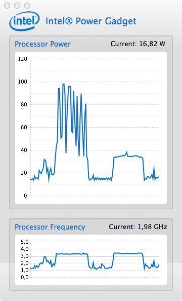

Seems like I have now finally success on my side! :thumbsup_anim:
A BIG thanks go out to Omni for his patch and also Balamut for providing the correct SSDT for 4930K.  With this one, my power gadget output looks like this:
Now, does that look OK? At least no problem now with reaching states from x12 up to x39.
So yes it is pretty clear that Pike's script is just wrong with 4930K - also a bit sad since he insisted on his blog that it works - which it does clearly not. And I thought it was my error. Sigh.
Also the PMInfo kext provided by Balamut does not crash in contrast to Pikes one, so here is the output:

With the reporting: I think both of you are right, look at the HWmonitor, AICPUPMI and IPG logs (not the graphs), the the wattage jumps which shows movement, but the multipliers and freq. have only 3 states, low, maxnoneturbo and max.

I have a 4 core CPU - I7 3820,if i just use patched kext and don't use ssdt,the cpu will stuck at 12x.
Here is the screen with the patched kext and a custom SSDT, generated by Pikes script
Frequency is actually changing, Not much, but I got frequencies from  3.6 to 3.7 GhZ while testing.
Ues MSRDumper.kext i can see 12 36 37, 3 Pstate,but most of time frequencies is just from  3.6 to 3.7 GhZ
I really dont know why i still got wrong iInformation like this:

Oswaldini: use the SSDT posted by Balamut. This works at least for me (also on 4930K)
Yangshun: Test by running Intel Power Gadget. This gives a better impression imho. AICPUPMI also did not show as many P-States as were apparently reached (of course, _if_ the output of IPG is correct)

If i use IPG 3.0.1,the frequency actually change but the IPG did not show it
If i use IPG 2.5.2,the frequency show it like this:
You also should check if your "Name (APSN, 0x02)" SSDT value is correct. Must match the number of Turbo states that your CPU model can reach. "0x02" would mean that your CPU only has 2 Turbo states. Ist that correct? Otherwise your numbers look a bit like mine before it was fully working. So I think you're almost there.
Well this is odd...
When changing in the SSDT the APSN pointer? to the 1200 MHz entry, IPG shows me all frequency values between 1200MHz and 3600MHz. However HWMon tells me that i only reach all turbo 30 to 36. AICPUPMI the same... Even the state residency is always at 0x0, so things are still not quite right. but i my opinion this is interesting...
