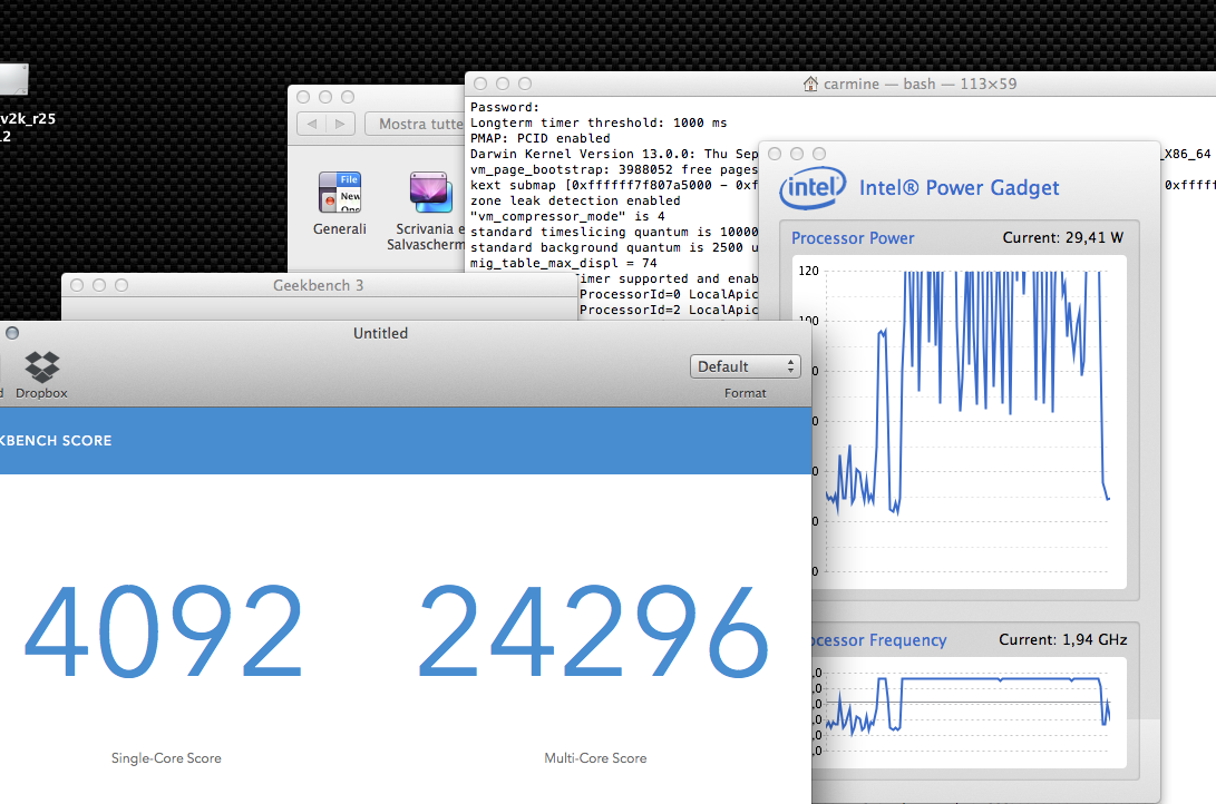

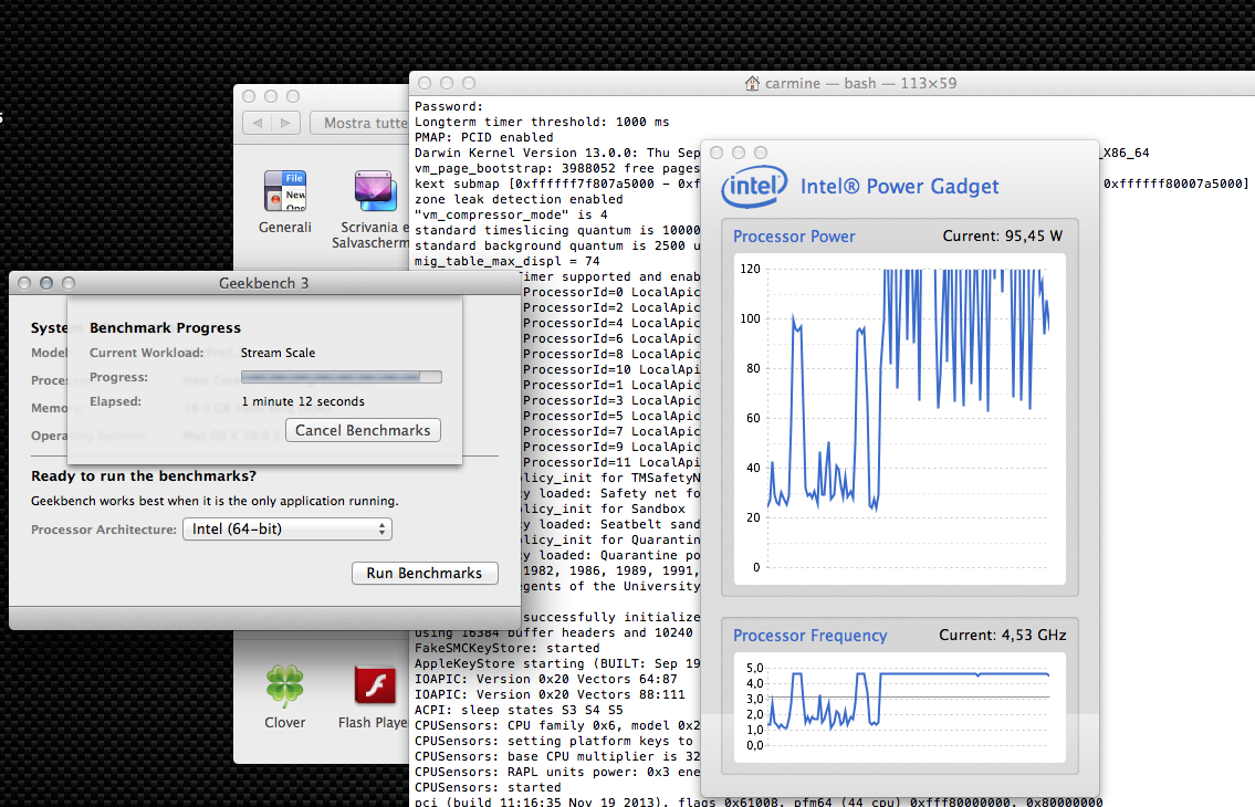

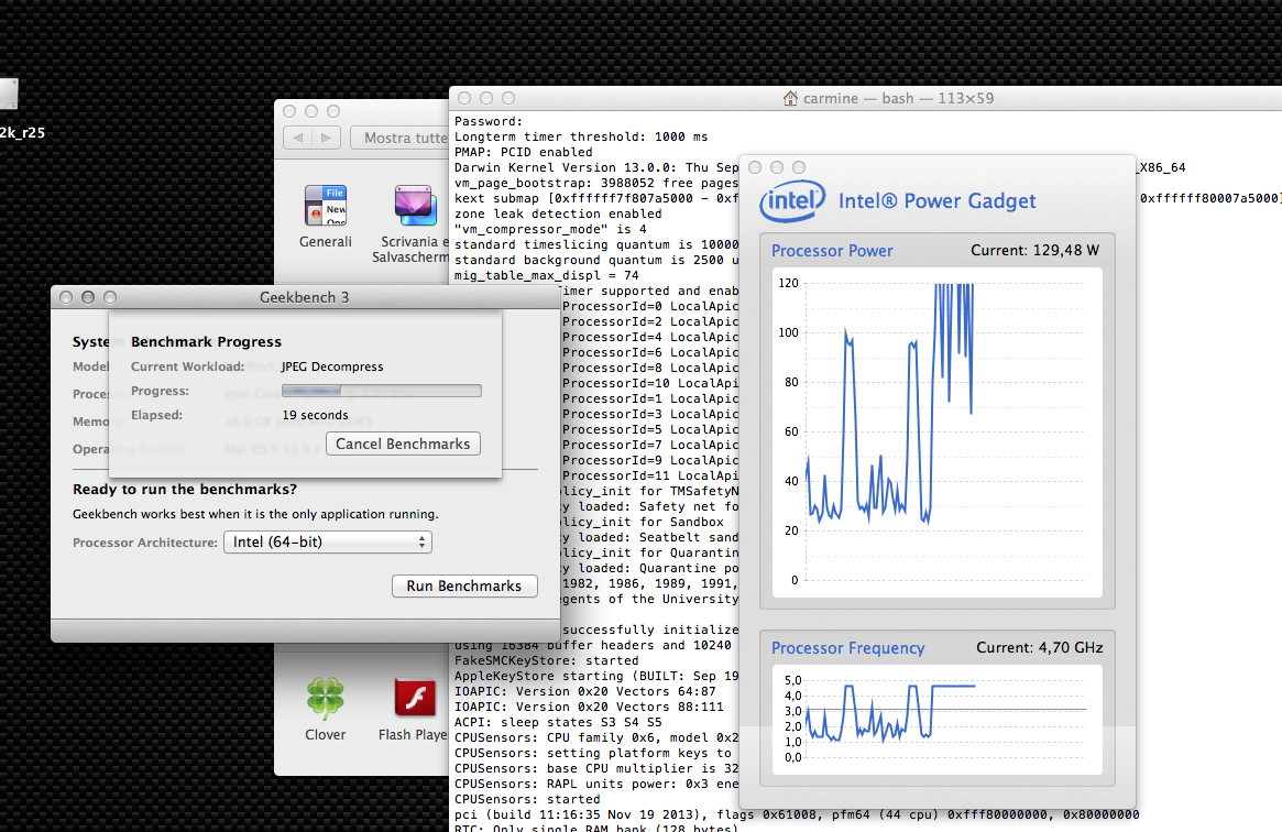

magnifico Posted January 28, 2014 Share Posted January 28, 2014 omni i do cat /var/log/system.log | grep "AICPUPMI:" but i see only two state again Jan 28 20:34:20 pro-di-carmine kernel[0]: AICPUPMI: CPU P-States [ 47 ] Jan 28 20:34:21 pro-di-carmine kernel[0]: AICPUPMI: CPU P-States [ 12 47 ] mhmmm Link to comment Share on other sites More sharing options...
yangshun1029 Posted January 28, 2014 Share Posted January 28, 2014 Here's what I get in my kernel log: kernel[0]: AppleIntelCPUPowerManagement: Turbo Ratios 1122 kernel[0]: AppleIntelCPUPowerManagement: (built 20:35:09 Oct 17 2013) initialization complete kernel[0]: SMC: successfully initialized kernel[0]: AppleIntelCPUPowerManagementClient: ready kernel[0]: X86PlatformPlugin::init() - kIOPPFBootArgs boot-args set debugLevel 3, debugFlags 3 kernel[0]: X86PlatformPlugin::start - fPanicErrors 0 kernel[0]: X86PlatformPlugin::startDelayedPlatformDatabaseRead - Mac-F60DEB81FF30ACF6.plist kernel[0]: X86PlatformPlugin::getCPUPStates - P 0: coreFreq 3800, power 130000, latency 10, busLatency 10, control 0x2600, status 0x2600 kernel[0]: X86PlatformPlugin::getCPUPStates - P 1: coreFreq 3700, power 130000, latency 10, busLatency 10, control 0x2500, status 0x2500 kernel[0]: X86PlatformPlugin::getCPUPStates - P 2: coreFreq 3600, power 130000, latency 10, busLatency 10, control 0x2400, status 0x2400 kernel[0]: X86PlatformPlugin::getCPUPStates - P 3: coreFreq 3500, power 124956, latency 10, busLatency 10, control 0x2300, status 0x2300 kernel[0]: X86PlatformPlugin::getCPUPStates - P 4: coreFreq 3400, power 120003, latency 10, busLatency 10, control 0x2200, status 0x2200 kernel[0]: X86PlatformPlugin::getCPUPStates - P 5: coreFreq 3300, power 115138, latency 10, busLatency 10, control 0x2100, status 0x2100 kernel[0]: X86PlatformPlugin::getCPUPStates - P 6: coreFreq 3200, power 110362, latency 10, busLatency 10, control 0x2000, status 0x2000 kernel[0]: X86PlatformPlugin::getCPUPStates - P 7: coreFreq 3100, power 105674, latency 10, busLatency 10, control 0x1f00, status 0x1f00 kernel[0]: X86PlatformPlugin::getCPUPStates - P 8: coreFreq 3000, power 101072, latency 10, busLatency 10, control 0x1e00, status 0x1e00 kernel[0]: X86PlatformPlugin::getCPUPStates - P 9: coreFreq 2900, power 96557, latency 10, busLatency 10, control 0x1d00, status 0x1d00 kernel[0]: X86PlatformPlugin::getCPUPStates - P10: coreFreq 2800, power 92127, latency 10, busLatency 10, control 0x1c00, status 0x1c00 kernel[0]: X86PlatformPlugin::getCPUPStates - P11: coreFreq 2700, power 87783, latency 10, busLatency 10, control 0x1b00, status 0x1b00 kernel[0]: X86PlatformPlugin::getCPUPStates - P12: coreFreq 2600, power 83522, latency 10, busLatency 10, control 0x1a00, status 0x1a00 kernel[0]: X86PlatformPlugin::getCPUPStates - P13: coreFreq 2500, power 79345, latency 10, busLatency 10, control 0x1900, status 0x1900 kernel[0]: X86PlatformPlugin::getCPUPStates - P14: coreFreq 2400, power 75251, latency 10, busLatency 10, control 0x1800, status 0x1800 kernel[0]: X86PlatformPlugin::getCPUPStates - P15: coreFreq 2300, power 71238, latency 10, busLatency 10, control 0x1700, status 0x1700 kernel[0]: X86PlatformPlugin::getCPUPStates - P16: coreFreq 2200, power 67308, latency 10, busLatency 10, control 0x1600, status 0x1600 kernel[0]: X86PlatformPlugin::getCPUPStates - P17: coreFreq 2100, power 63457, latency 10, busLatency 10, control 0x1500, status 0x1500 kernel[0]: X86PlatformPlugin::getCPUPStates - P18: coreFreq 2000, power 59687, latency 10, busLatency 10, control 0x1400, status 0x1400 kernel[0]: X86PlatformPlugin::getCPUPStates - P19: coreFreq 1900, power 55996, latency 10, busLatency 10, control 0x1300, status 0x1300 kernel[0]: X86PlatformPlugin::getCPUPStates - P20: coreFreq 1800, power 52384, latency 10, busLatency 10, control 0x1200, status 0x1200 kernel[0]: X86PlatformPlugin::getCPUPStates - P21: coreFreq 1700, power 48849, latency 10, busLatency 10, control 0x1100, status 0x1100 kernel[0]: X86PlatformPlugin::getCPUPStates - P22: coreFreq 1600, power 45392, latency 10, busLatency 10, control 0x1000, status 0x1000 kernel[0]: X86PlatformPlugin::getCPUPStates - P23: coreFreq 1500, power 42011, latency 10, busLatency 10, control 0xf00, status 0xf00 kernel[0]: X86PlatformPlugin::getCPUPStates - P24: coreFreq 1400, power 38706, latency 10, busLatency 10, control 0xe00, status 0xe00 kernel[0]: X86PlatformPlugin::getCPUPStates - P25: coreFreq 1300, power 35476, latency 10, busLatency 10, control 0xd00, status 0xd00 kernel[0]: X86PlatformPlugin::getCPUPStates - P26: coreFreq 1200, power 32320, latency 10, busLatency 10, control 0xc00, status 0xc00 kernel[0]: X86PlatformPlugin::publishACPIStates - Succeeded in getting max non-turbo PState 2 kernel[0]: X86PlatformPlugin::publishACPIStates - Succeeded in getting max efficient PState ratio difference 1 kernel[0]: X86PlatformPlugin::publishACPIStates - Found max efficient PState to be 25 kernel[0]: IOPPF: AppleIntelCPUPowerManagement mode kernel[0]: X86PlatformPlugin::cgPublishCPUStates - Got all the CPU callbacks! kernel[0]: X86PlatformPlugin::configResourceHandler - setting Thermal Profile from resource kernel[0]: X86PlatformPlugin::cgConfigResourceHandler - waiting for commandWake on num proccessors to be 0: 0 kernel[0]: X86PlatformPlugin::setRingTable - AICPM failed to load ring table with status 0x0: Get=0, Load=0, Install=0 kernel[0]: X86PlatformPlugin::configResourceHandler - Failed to set ring table! kernel[0]: X86PlatformShim::setPStateEntryInfoAICPM - PState[0]: vid 0x0, voltage 7000, frequency 3800, multiplier 038 kernel[0]: X86PlatformShim::setPStateEntryInfoAICPM - PState[1]: vid 0x0, voltage 7000, frequency 3700, multiplier 037 kernel[0]: X86PlatformShim::setPStateEntryInfoAICPM - PState[2]: vid 0x0, voltage 7000, frequency 3600, multiplier 036 kernel[0]: X86PlatformShim::setPStateEntryInfoAICPM - PState[3]: vid 0x0, voltage 7000, frequency 3500, multiplier 035 kernel[0]: X86PlatformShim::setPStateEntryInfoAICPM - PState[4]: vid 0x0, voltage 7000, frequency 3400, multiplier 034 kernel[0]: X86PlatformShim::setPStateEntryInfoAICPM - PState[5]: vid 0x0, voltage 7000, frequency 3300, multiplier 033 kernel[0]: X86PlatformShim::setPStateEntryInfoAICPM - PState[6]: vid 0x0, voltage 7000, frequency 3200, multiplier 032 kernel[0]: X86PlatformShim::setPStateEntryInfoAICPM - PState[7]: vid 0x0, voltage 7000, frequency 3100, multiplier 031 kernel[0]: X86PlatformShim::setPStateEntryInfoAICPM - PState[8]: vid 0x0, voltage 7000, frequency 3000, multiplier 030 kernel[0]: X86PlatformShim::setPStateEntryInfoAICPM - PState[9]: vid 0x0, voltage 7000, frequency 2900, multiplier 029 kernel[0]: X86PlatformShim::setPStateEntryInfoAICPM - PState[10]: vid 0x0, voltage 7000, frequency 2800, multiplier 028 kernel[0]: X86PlatformShim::setPStateEntryInfoAICPM - PState[11]: vid 0x0, voltage 7000, frequency 2700, multiplier 027 kernel[0]: X86PlatformShim::setPStateEntryInfoAICPM - PState[12]: vid 0x0, voltage 7000, frequency 2600, multiplier 026 kernel[0]: X86PlatformShim::setPStateEntryInfoAICPM - PState[13]: vid 0x0, voltage 7000, frequency 2500, multiplier 025 kernel[0]: X86PlatformShim::setPStateEntryInfoAICPM - PState[14]: vid 0x0, voltage 7000, frequency 2400, multiplier 024 kernel[0]: X86PlatformShim::setPStateEntryInfoAICPM - PState[15]: vid 0x0, voltage 7000, frequency 2300, multiplier 023 kernel[0]: X86PlatformShim::setPStateEntryInfoAICPM - PState[16]: vid 0x0, voltage 7000, frequency 2200, multiplier 022 kernel[0]: X86PlatformShim::setPStateEntryInfoAICPM - PState[17]: vid 0x0, voltage 7000, frequency 2100, multiplier 021 kernel[0]: X86PlatformShim::setPStateEntryInfoAICPM - PState[18]: vid 0x0, voltage 7000, frequency 2000, multiplier 020 kernel[0]: X86PlatformShim::setPStateEntryInfoAICPM - PState[19]: vid 0x0, voltage 7000, frequency 1900, multiplier 019 kernel[0]: X86PlatformShim::setPStateEntryInfoAICPM - PState[20]: vid 0x0, voltage 7000, frequency 1800, multiplier 018 kernel[0]: X86PlatformShim::setPStateEntryInfoAICPM - PState[21]: vid 0x0, voltage 7000, frequency 1700, multiplier 017 kernel[0]: X86PlatformShim::setPStateEntryInfoAICPM - PState[22]: vid 0x0, voltage 7000, frequency 1600, multiplier 016 kernel[0]: X86PlatformShim::setPStateEntryInfoAICPM - PState[23]: vid 0x0, voltage 7000, frequency 1500, multiplier 015 kernel[0]: X86PlatformShim::setPStateEntryInfoAICPM - PState[24]: vid 0x0, voltage 7000, frequency 1400, multiplier 014 kernel[0]: X86PlatformShim::setPStateEntryInfoAICPM - PState[25]: vid 0x0, voltage 7000, frequency 1300, multiplier 013 kernel[0]: X86PlatformShim::setPStateEntryInfoAICPM - PState[26]: vid 0x0, voltage 7000, frequency 1200, multiplier 012 kernel[0]: X86PlatformPlugin::publishACPIStates - Succeeded in getting max non-turbo PState 2 kernel[0]: X86PlatformPlugin::publishACPIStates - Succeeded in getting max efficient PState ratio difference 1 kernel[0]: X86PlatformPlugin::publishACPIStates - Found max efficient PState to be 25 kernel[0]: X86PlatformShim::start - registering pLimitNotificationCallback for cpu plimits kernel[0]: X86PlatformPlugin::setPLimitRange - CPU Limit Range [0, 26] kernel[0]: X86PlatformPlugin::cgDispatchCallback - no initial cpu-plimit-notification plimit value sent kernel[0]: X86PlatformShim::start - registering pLimitNotificationCallback for cpu idle plimitskernel[0]: X86PlatformPlugin::setPLimitRange - Force Idle Limit Range [0, 100] kernel[0]: X86PlatformPlugin::cgDispatchCallback - no initial cpu-idle-plimit-notification plimit value sent And use the AppleIntelCPUPowerManagementInfo.kext 14-1-29 14:50:40.000 kernel[0]: AICPUPMI: v3.3 Copyright © 2012-2014 Pike R. Alpha. All rights reserved 14-1-29 14:50:40.000 kernel[0]: AICPUPMI: logMSRs............................: 1 14-1-29 14:50:40.000 kernel[0]: AICPUPMI: logIGPU............................: 0 14-1-29 14:50:40.000 kernel[0]: AICPUPMI: logCStates.........................: 1 14-1-29 14:50:40.000 kernel[0]: AICPUPMI: logIPGStyle........................: 1 14-1-29 14:50:40.000 kernel[0]: AICPUPMI: MWAIT C-States.....................: 135456 14-1-29 14:50:40.000 kernel[0]: AICPUPMI: MSR_CORE_THREAD_COUNT......(0x35) : 0x40008 14-1-29 14:50:40.000 kernel[0]: AICPUPMI: MSR_PLATFORM_INFO..........(0xCE) : 0xC0070012400 14-1-29 14:50:40.000 kernel[0]: AICPUPMI: MSR_PMG_CST_CONFIG_CONTROL.(0xE2) : 0x1E000407 14-1-29 14:50:40.000 kernel[0]: AICPUPMI: MSR_PMG_IO_CAPTURE_BASE....(0xE4) : 0x10414 14-1-29 14:50:40.000 kernel[0]: AICPUPMI: IA32_MPERF.................(0xE7) : 0xEBA4EE5AC 14-1-29 14:50:40.000 kernel[0]: AICPUPMI: IA32_APERF.................(0xE8) : 0x9810C8C57 14-1-29 14:50:40.000 kernel[0]: AICPUPMI: MSR_FLEX_RATIO.............(0x194) : 0xC0000 14-1-29 14:50:40.000 kernel[0]: AICPUPMI: MSR_IA32_PERF_STATUS.......(0x198) : 0x273B00002400 14-1-29 14:50:40.000 kernel[0]: AICPUPMI: MSR_IA32_PERF_CONTROL......(0x199) : 0x2400 14-1-29 14:50:40.000 kernel[0]: AICPUPMI: IA32_CLOCK_MODULATION......(0x19A) : 0x0 14-1-29 14:50:40.000 kernel[0]: AICPUPMI: IA32_THERM_STATUS..........(0x19C) : 0x88380000 14-1-29 14:50:40.000 kernel[0]: AICPUPMI: IA32_MISC_ENABLES..........(0x1A0) : 0x850089 14-1-29 14:50:40.000 kernel[0]: AICPUPMI: MSR_MISC_PWR_MGMT..........(0x1AA) : 0x400001 14-1-29 14:50:40.000 kernel[0]: AICPUPMI: MSR_TURBO_RATIO_LIMIT......(0x1AD) : 0x2525252525252626 14-1-29 14:50:40.000 kernel[0]: AICPUPMI: IA32_ENERGY_PERF_BIAS......(0x1B0) : 0x0 14-1-29 14:50:40.000 kernel[0]: AICPUPMI: MSR_POWER_CTL..............(0x1FC) : 0x2504005B 14-1-29 14:50:40.000 kernel[0]: AICPUPMI: MSR_RAPL_POWER_UNIT........(0x606) : 0xA1003 14-1-29 14:50:40.000 kernel[0]: AICPUPMI: MSR_PKG_POWER_LIMIT........(0x610) : 0x68960005AFFFF 14-1-29 14:50:40.000 kernel[0]: AICPUPMI: MSR_PKG_ENERGY_STATUS......(0x611) : 0x29977BB 14-1-29 14:50:40.000 kernel[0]: AICPUPMI: MSR_PKGC3_IRTL.............(0x60a) : 0x0 14-1-29 14:50:40.000 kernel[0]: AICPUPMI: MSR_PKGC6_IRTL.............(0x60b) : 0x0 14-1-29 14:50:40.000 kernel[0]: AICPUPMI: MSR_PKGC7_IRTL.............(0x60c) : 0x0 14-1-29 14:50:40.000 kernel[0]: AICPUPMI: MSR_PP0_CURRENT_CONFIG.....(0x601) : 0x14149480000640 14-1-29 14:50:40.000 kernel[0]: AICPUPMI: MSR_PP0_POWER_LIMIT........(0x638) : 0x0 14-1-29 14:50:40.000 kernel[0]: AICPUPMI: MSR_PP0_ENERGY_STATUS......(0x639) : 0x1DEF427 14-1-29 14:50:40.000 kernel[0]: AICPUPMI: MSR_PP0_POLICY.............(0x63a) : 0x0 14-1-29 14:50:40.000 kernel[0]: AICPUPMI: MSR_PKG_C2_RESIDENCY.......(0x60d) : 0x0 14-1-29 14:50:40.000 kernel[0]: AICPUPMI: MSR_PKG_C3_RESIDENCY.......(0x3f8) : 0x0 14-1-29 14:50:40.000 kernel[0]: AICPUPMI: MSR_PKG_C6_RESIDENCY.......(0x3f9) : 0x0 14-1-29 14:50:40.000 kernel[0]: AICPUPMI: MSR_PKG_C7_RESIDENCY.......(0x3fa) : 0x0 14-1-29 14:50:40.000 kernel[0]: AICPUPMI: CPU Low Frequency Mode.............: 1200 MHz 14-1-29 14:50:40.000 kernel[0]: AICPUPMI: CPU Maximum non-Turbo Frequency....: 3600 MHz 14-1-29 14:50:40.000 kernel[0]: AICPUPMI: CPU Maximum Turbo Frequency........: 3800 MHz 14-1-29 14:50:40.000 kernel[0]: AICPUPMI: CPU P-States [ (12) 35 36 ] 14-1-29 14:50:40.000 kernel[0]: AICPUPMI: CPU P-States [ 12 27 35 (36) ] 14-1-29 14:50:40.000 kernel[0]: AICPUPMI: CPU P-States [ (12) 25 27 35 36 ] 14-1-29 14:50:41.000 kernel[0]: AICPUPMI: CPU P-States [ (12) 25 27 34 35 36 ] 14-1-29 14:50:44.000 kernel[0]: AICPUPMI: CPU P-States [ 12 25 27 34 35 36 (37) ] 14-1-29 14:50:44.000 kernel[0]: AICPUPMI: CPU C3-Cores [ 2 3 6 7 ] 14-1-29 14:50:44.000 kernel[0]: AICPUPMI: CPU C6-Cores [ 2 3 5 6 ] 14-1-29 14:50:44.000 kernel[0]: AICPUPMI: CPU P-States [ 12 25 27 31 34 35 36 (37) ] 14-1-29 14:50:44.000 kernel[0]: AICPUPMI: CPU C3-Cores [ 2 3 4 6 7 ] 14-1-29 14:50:44.000 kernel[0]: AICPUPMI: CPU C6-Cores [ 2 3 4 5 6 7 ] 14-1-29 14:50:45.000 kernel[0]: AICPUPMI: CPU C3-Cores [ 0 2 3 4 5 6 7 ] 14-1-29 14:50:45.000 kernel[0]: AICPUPMI: CPU C6-Cores [ 1 2 3 4 5 6 7 ] 14-1-29 14:50:46.000 kernel[0]: AICPUPMI: CPU P-States [ 12 (24) 25 27 31 34 35 36 37 ] 14-1-29 14:50:46.000 kernel[0]: AICPUPMI: CPU C3-Cores [ 0 1 2 3 4 5 6 7 ] 14-1-29 14:50:46.000 kernel[0]: AICPUPMI: CPU P-States [ 12 (13) 24 25 27 31 34 35 36 37 ] 14-1-29 14:50:47.000 kernel[0]: AICPUPMI: CPU P-States [ 12 (13) 22 24 25 27 31 34 35 36 37 ] 14-1-29 14:50:47.000 kernel[0]: AICPUPMI: CPU C6-Cores [ 0 1 2 3 4 5 6 7 ] 14-1-29 14:50:51.000 kernel[0]: AICPUPMI: CPU P-States [ 12 13 22 24 25 27 31 32 34 35 36 (37) ] 14-1-29 14:50:55.000 kernel[0]: AICPUPMI: CPU P-States [ 12 (13) 22 24 25 26 27 31 32 34 35 36 37 ] 14-1-29 14:50:56.000 kernel[0]: AICPUPMI: CPU P-States [ 12 (13) 20 22 24 25 26 27 31 32 34 35 36 37 ] 14-1-29 14:50:58.000 kernel[0]: AICPUPMI: CPU P-States [ (12) 13 20 22 24 25 26 27 31 32 33 34 35 36 37 ] 14-1-29 14:50:58.000 kernel[0]: AICPUPMI: CPU P-States [ 12 (13) 20 22 24 25 26 27 29 31 32 33 34 35 36 37 ] 14-1-29 14:51:01.000 kernel[0]: AICPUPMI: CPU P-States [ (12) 13 20 22 23 24 25 26 27 29 31 32 33 34 35 36 37 ] 14-1-29 14:51:02.000 kernel[0]: AICPUPMI: CPU P-States [ 12 (13) 20 21 22 23 24 25 26 27 29 31 32 33 34 35 36 37 ] 14-1-29 14:51:02.000 kernel[0]: AICPUPMI: CPU P-States [ 12 13 20 21 22 23 24 25 26 27 29 (30) 31 32 33 34 35 36 37 ] 14-1-29 14:51:03.000 kernel[0]: AICPUPMI: CPU P-States [ 12 13 19 20 21 22 23 24 25 26 27 29 30 31 32 33 34 35 36 (37) ] 14-1-29 14:51:03.000 kernel[0]: AICPUPMI: CPU P-States [ 12 13 19 20 21 22 23 24 25 26 27 29 30 31 32 33 34 35 36 37 (38) ] 14-1-29 14:51:05.000 kernel[0]: AICPUPMI: CPU P-States [ 12 (13) 18 19 20 21 22 23 24 25 26 27 29 30 31 32 33 34 35 36 37 38 ] 14-1-29 14:51:06.000 kernel[0]: AICPUPMI: CPU P-States [ 12 (13) 17 18 19 20 21 22 23 24 25 26 27 29 30 31 32 33 34 35 36 37 38 ] 14-1-29 14:51:06.000 kernel[0]: AICPUPMI: CPU P-States [ (12) 13 17 18 19 20 21 22 23 24 25 26 27 28 29 30 31 32 33 34 35 36 37 38 ] 14-1-29 14:51:07.000 kernel[0]: AICPUPMI: CPU P-States [ (12) 13 14 17 18 19 20 21 22 23 24 25 26 27 28 29 30 31 32 33 34 35 36 37 38 ] 14-1-29 14:51:08.000 kernel[0]: AICPUPMI: CPU P-States [ (12) 13 14 16 17 18 19 20 21 22 23 24 25 26 27 28 29 30 31 32 33 34 35 36 37 38 ] 14-1-29 14:51:13.000 kernel[0]: AICPUPMI: CPU P-States [ 12 13 14 15 16 17 18 19 20 21 22 23 (24) 25 26 27 28 29 30 31 32 33 34 35 36 37 38 ] There are any error need to fixed? Link to comment Share on other sites More sharing options...
kundica Posted January 28, 2014 Share Posted January 28, 2014 omni i do cat /var/log/system.log | grep "AICPUPMI:" but i see only two state again Jan 28 20:34:20 pro-di-carmine kernel[0]: AICPUPMI: CPU P-States [ 47 ] Jan 28 20:34:21 pro-di-carmine kernel[0]: AICPUPMI: CPU P-States [ 12 47 ] mhmmm I believe that's all you'll get with 3930k when you OC. I only get 2 unless I run stock, in which case, I also get 32 and states for each turbo multiplier that's not 38. IPG works differently than AICPUPMI so don't expect them to yield the same exact results. Link to comment Share on other sites More sharing options...
magnifico Posted January 28, 2014 Share Posted January 28, 2014 I believe that's all you'll get with 3930k when you OC. I only get 2 unless I run stock, in which case, I also get 32 and states for each turbo multiplier that's not 38. IPG works differently than AICPUPMI so don't expect them to yield the same exact results. so I have to trust only IPG ? For you work perfect my hack? Link to comment Share on other sites More sharing options...
Riley Freeman Posted January 28, 2014 Share Posted January 28, 2014 so I have to trust only IPG ? For you work perfect my hack? I just did a fresh install of 10.9.2 with MacPro5,1 SMBIOS. Replaced the AICPUPM binary with omni's patched SB one and I'm getting the same behaviour here with my 3930k. HWMonitor shows the CPU fluctuating between 12x, 32x and 38x but the Intel Power Gadget shows various speed states (and nothing close to 32x or 38x). Using my stock SSDT and Chameleon. I'd be inclined to trust IPG as I assume it's reading the hardware directly. But perhaps someone can prove this is the case. Also, HWMonitor's CPU voltage reading matches IPG's. So while the CPU states might be getting reported incorrectly, it looks like the CPU is speedstepping correctly. Link to comment Share on other sites More sharing options...
magnifico Posted January 28, 2014 Share Posted January 28, 2014 I just did a fresh install of 10.9.2 with MacPro5,1 SMBIOS. Replaced the AICPUPM binary with omni's patched SB one and I'm getting the same behaviour here with my 3930k. HWMonitor shows the CPU fluctuating between 12x, 32x and 38x but the Intel Power Gadget shows various speed states (and nothing close to 32x or 38x). Using my stock SSDT and Chameleon. I'd be inclined to trust IPG as I assume it's reading the hardware directly. But perhaps someone can prove this is the case. Also, HWMonitor's CPU voltage reading matches IPG's. Così, mentre gli stati della CPU potrebbero essere sempre riportati in modo errato, sembra che la CPU sia speedstepping correttamente. hi friend how are you? so for you all work perfect ? Friend i dont use ssdt table...i use only clover boot and no dsdt only table bios Link to comment Share on other sites More sharing options...
